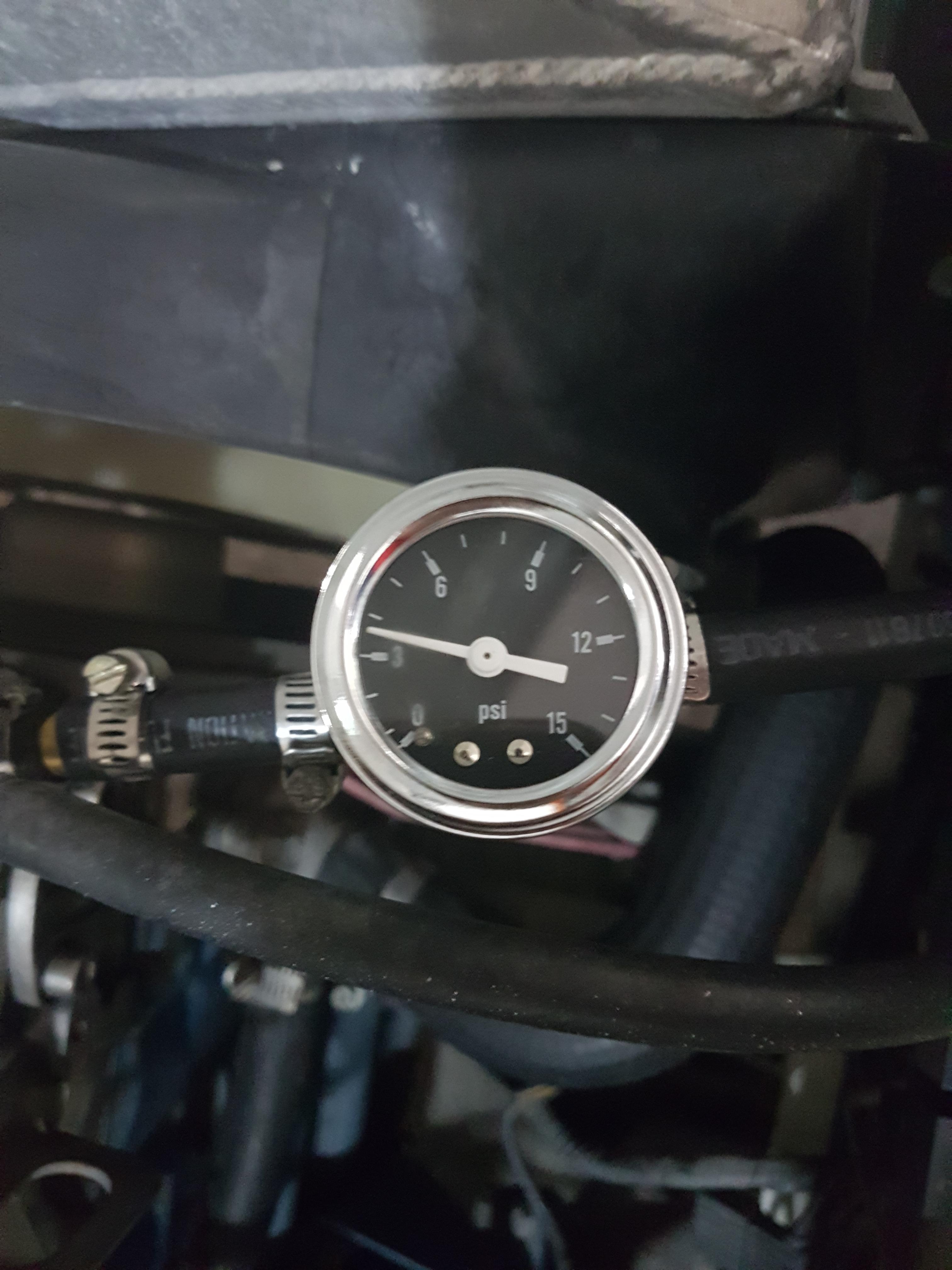

I have several questions regarding the precise fuel pressure both of the 3 screws round SU CARBS on my 240z will tolerate as i am pushing the fuel through an AIRTEX 8012S which is rated 5 to 9 PSI:
1. Should i measure the fuel pressure plugging a "T" before the front carburetor?
2. Should the pressure read no more tan 4.3 psi?
3. What if the pressure reads more than this limit but does not show any spill out of the fuel bowls? Will i need to open both fuel bowls and reset the level. THis was done by Ztherapy in 2014 and i would not like to mess with it.
1. Any spot between the carbs and the and the filter. (if there is one between the pump and carbs) should be fine.
2. 4.3 is probably at the upper pressure limits of the needle and seat (fuel valve) in the float bowl. 3 - 3.5 would be better IMO. (Back in the day, we only ran 3 lbs. of pressure in a small block Chevy dragster.)
3. If the excess pressure isn't over powering the needle and seat valve, you're probably OK for now. The excessive pressure shouldn't affect the float level setting but it could cause premature failure of the needle and seat. A potentially disastrous scenario. Remember, the carbs are placed over the hot exhaust manifold.

Question: How do i know if the needle and seat installed is indeed in good shape and working order? Anyway i can confirm that the following pressure pump which originally rated 4.2 psi did not damage the needle and seat?
https://www.summitracing.com/int/parts/atx-e8012s/overview/
 If the needle and seat are leaking the float bowl will fill to over flowing with fuel and flood the area above the nozzles with fuel. One could possibly see fuel spilling out of the intake side of the carbs too.  4.2 psi shouldn't have ruined the needle and seats and since they're relatively new, I doubt they'll be a problem. Where is the fuel height in the nozzles?
