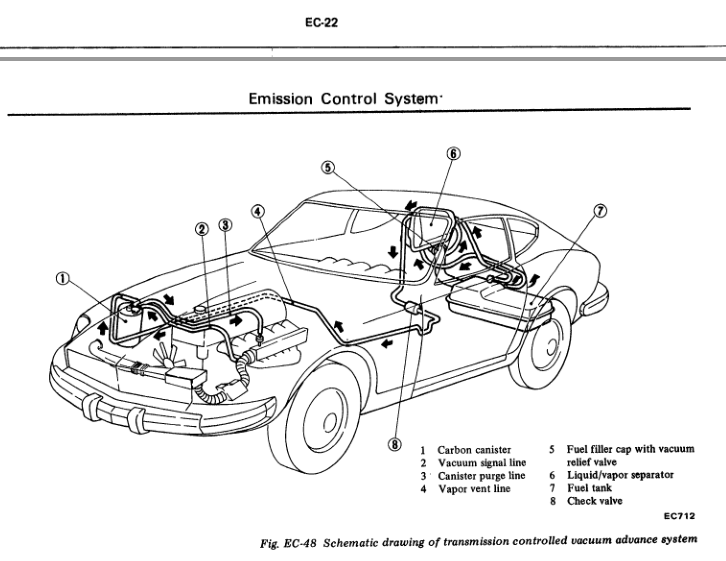

The gas cap is only supposed to let air in as gas is used.  The vent for the tank, to relieve pressure, is supposed to run through a hose up to a charcoal canister in the engine bay.  People sometimes remove them as "emissions junk" not knowing what they're doing.  That might the cause of the pressure buildup.  Maybe somebody removed the engine bay vent and was using a vented cap in its place.

Or the vent line could be plugged up with rust as mine is. FSM has a check for "stuffiness" of the vent line. Think there is a check valve in there as well, that check valve #8 can be hard to find.
