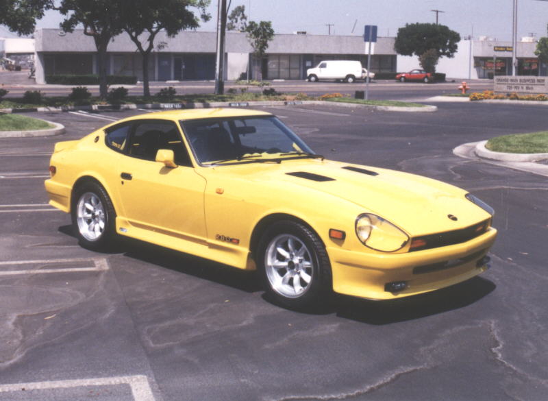

I'm getting more fired up about this every day. But I have a new problem. As I mentioned, many of the roads around here are gravelled year round (gravelled heavily in winter and too small of a highway deparment to get it all cleaned up before winter hits and they're putting more down. So I will be getting a body kit of some sort to keep the rocks off the metal. I've seen this kit on several different cars and I was wondering if anyone could point me in the right direction.
That body kit is from MSA (Motorsport Auto)
Looks to be their full kit with the front(50-1409), rear(50-1473) and the side skirts(50-1461) or similar items. You can purchase their Aero kit and pick your front air dam, side skirts, and rear skirt, as they have either urethane or fiberglass available.

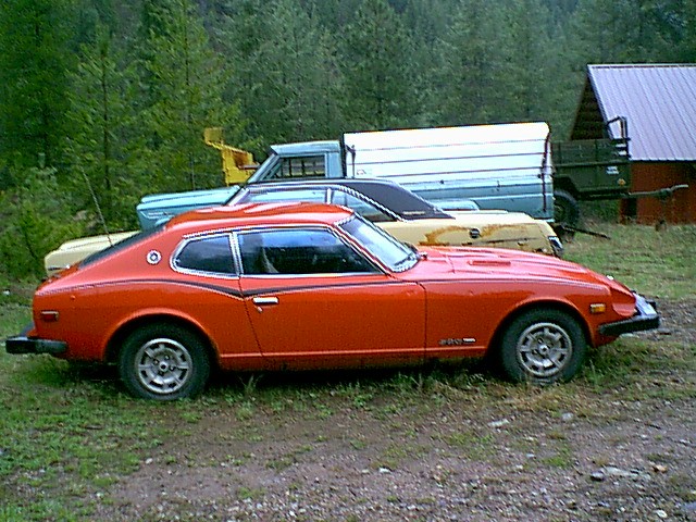

OK... low res dig pics of the car. If you think it's shiney, I would like to inform you that it was raining this morning.
