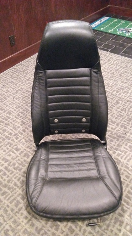

Today I put the seats back together.
I think they look ok :)  I covered them a long time ago.  I used the original foam and just added a little extra to it.

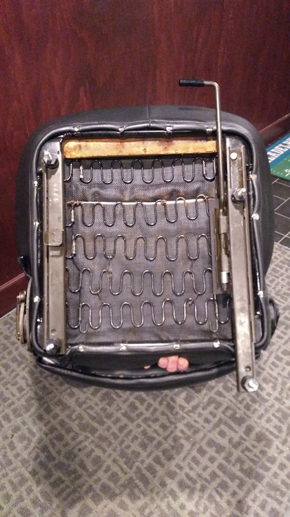

The bottom had some funkyness, I used a very heavy Nylon screen between the springs and the foam to replace whatever was there before.
I still need to add a few more rings between the springs, doing that makes the seat firmer.  I am an avid cyclist and I have a zillion used SS spokes that I can bend up for the job...
They look great.  Did you put heaters in?
