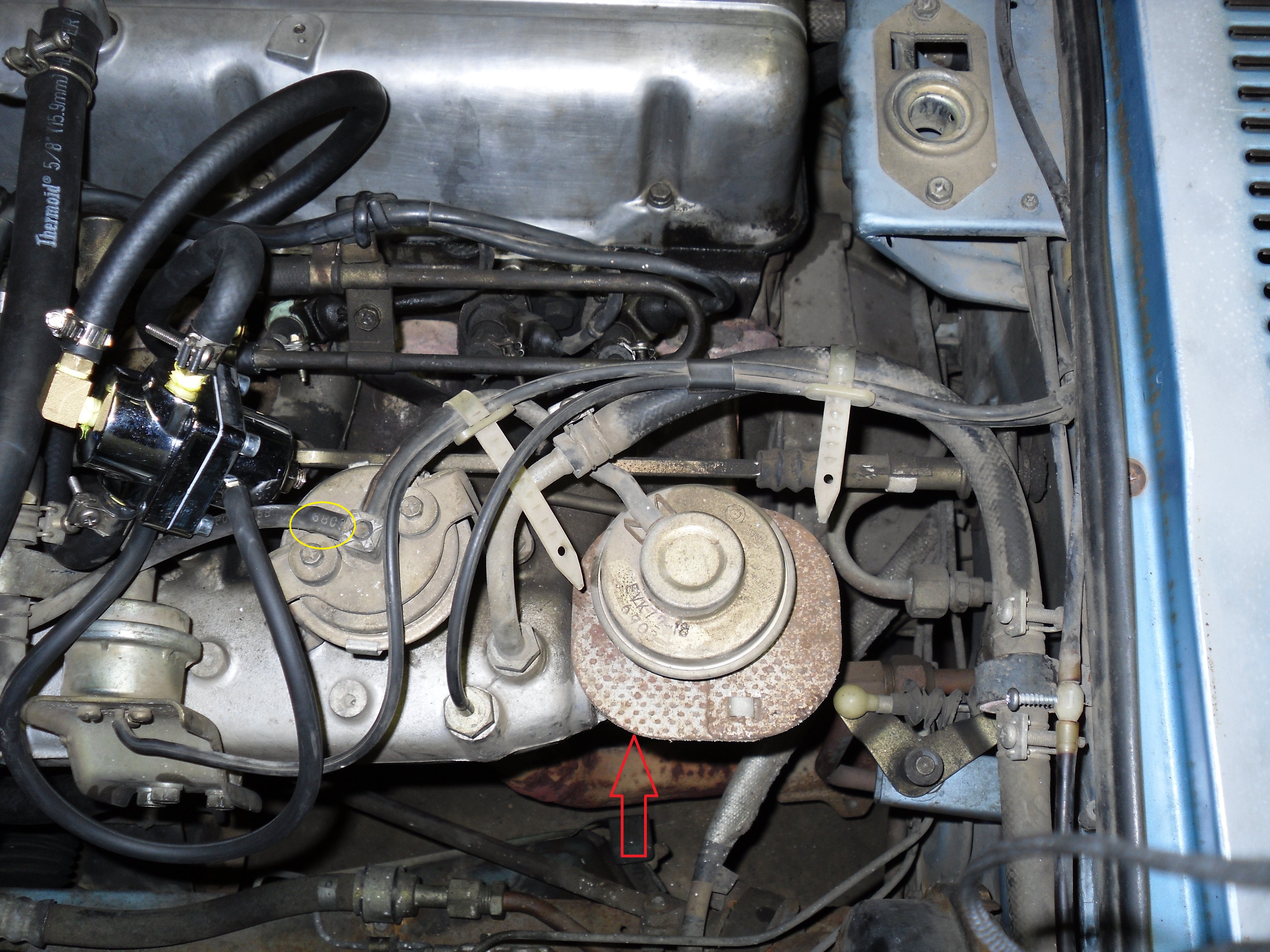

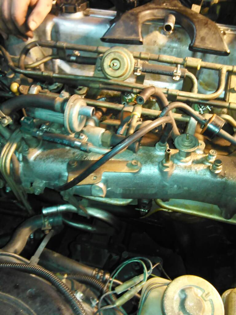

On my '77 there is an EGR tunnel on the bottom of the intake.  When I wanted to delete the EGR and all the accompanying components most every mechanic I asked about it told me the intake needs the heat from the EGR going through that tunnel to perform as designed.  Of course I did it anyway and have never had a problem BUT I live in the Deep South, it's 65 degrees outside right now.  One friend who raced his 280 told me the intake would "frost over" after the delete so he put small light bulbs over his when he raced farther up North to heat it up.  You'll need to delete the BPT valve and the warming plate with the thermal vacuum switch behind the thermostat housing.  Then plug the vacuum line under the TPS.  Yellow circles in these two pictures.

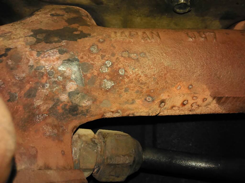

Mine has the air sensor where the flat plate on yours is. I've left that. Right now the exhaust header EGR flange nut is soaking overnight in PB blaster. It'll be plugged and back together as I have time through the week. Turns out the EGR system had 2 leaks anyway.
