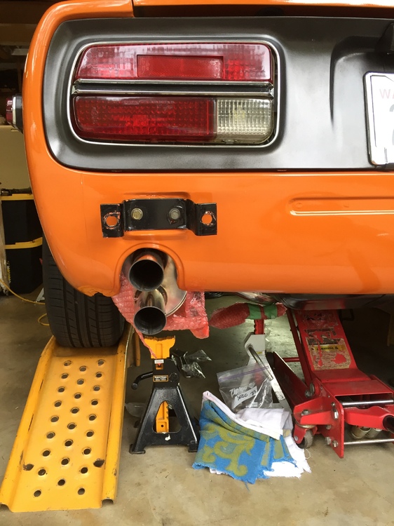

Today was the day I got around to install the Z-story exhaust'. Looks good so far. Haven't started the engine yet as the system is temporarily fitted and I still have to install the updated R200 drive shaft. Goal is to finish tonight and run on the dyno tomorrow. More photos to come.
