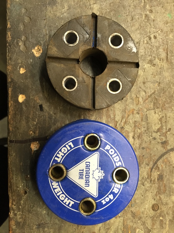

14 minutes ago, dhp123166 said:
I have heard of drivers making their own s-30 ZCAR steering couplers out of hockey pucks.
Never seen one though...
Now you have. ROFL

8 hours ago, siteunseen said:
Now you have. ROFL
When you look at the engineering on the OE coupler, a couple of things stand out: the hole in the middle and cross-shaped grooves.  I'm not an engineer and I'm strictly hypothesizing here but I suspect the hole is to allow for some torque relief.  As to the grooves, when I twisted the OE unit I just sold I realized they provided some relief for the U-joints around the coupler and could reduce the side load on the bolts and bushings.  Just guessing you understand.
7 hours ago, zKars said:
Thank you for not making me find that picture again!
I apologize for not giving you the credit. You get a standing ovation for that work of art!  I only wish it had worked. :(
