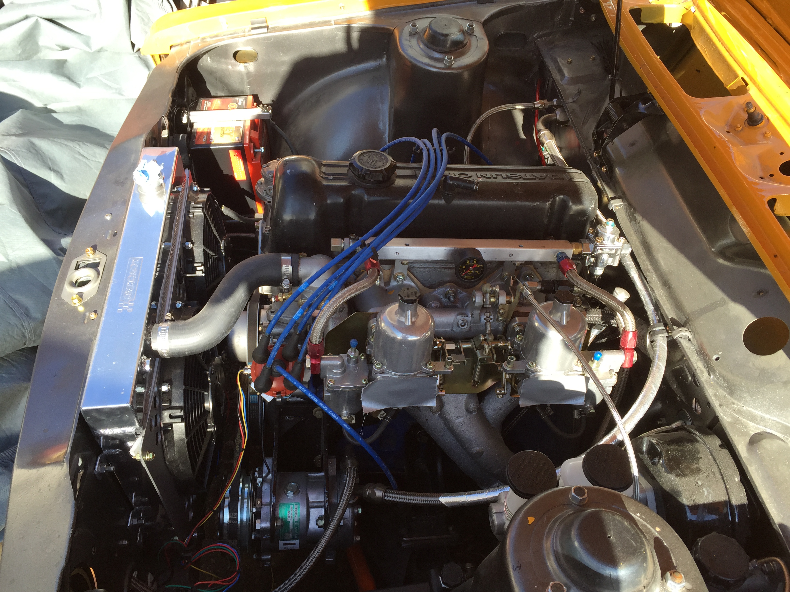

November 11, 20168 yr comment_506294 Here is a more recent picture of the engine bay. Link to comment https://www.classiczcars.com/forums/topic/56505-510-sus-and-engine-specs/#findComment-506294 Share on other sites More sharing options...
November 11, 20168 yr Author comment_506295 Sidepost battery, fuel rail, AC, electric fans. I like it! Link to comment https://www.classiczcars.com/forums/topic/56505-510-sus-and-engine-specs/#findComment-506295 Share on other sites More sharing options...
November 11, 20168 yr Author comment_506296 I think you aught to make a build thread for it. I know I could use the pointers for Cody's car... Link to comment https://www.classiczcars.com/forums/topic/56505-510-sus-and-engine-specs/#findComment-506296 Share on other sites More sharing options...
