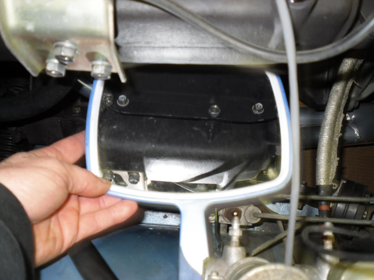

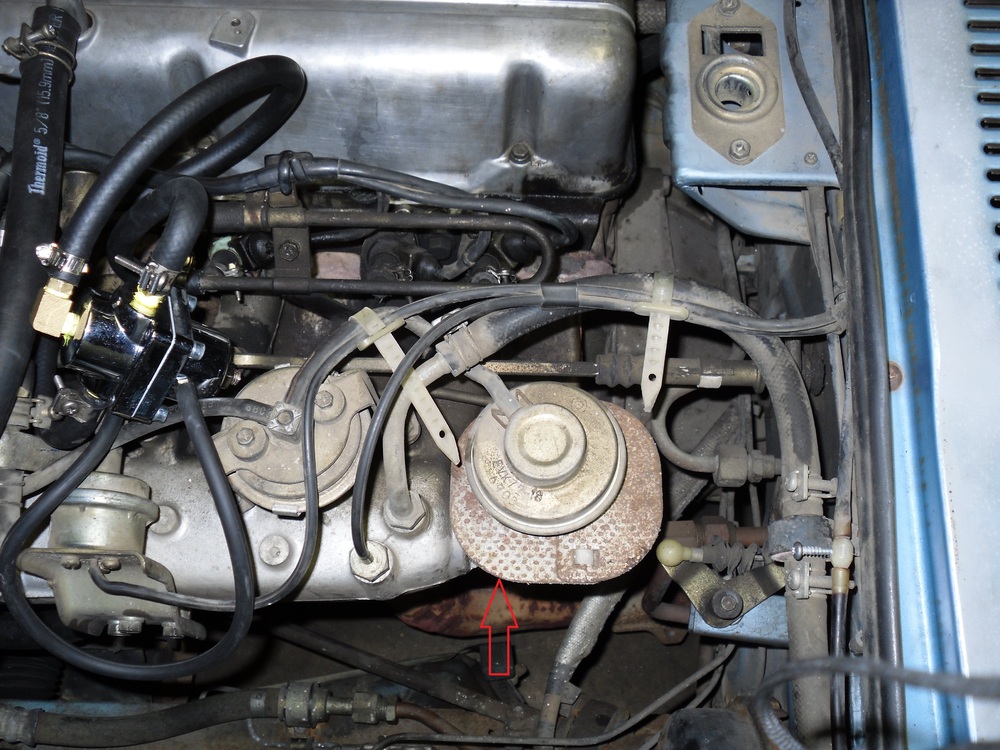

Another thing I forgot to mention.  The '77s had a recall for the EGR coupler to the intake manifold.  Mine was never corrected and caused the aluminum intake to rot out all around that thing over the years, HUGE vacuum leak.  You can take a mirror see under the back end and underside of the intake where the EGR connects to the intake.
