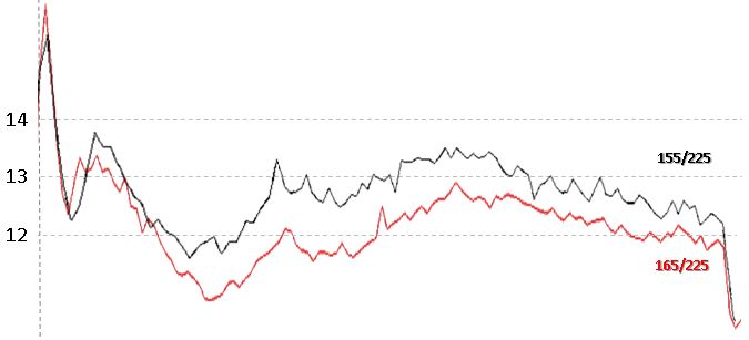

OK I think you are there.  13 AF +/- 0.5

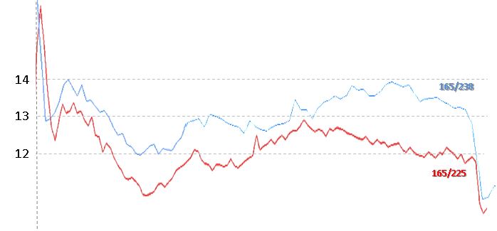

If you want to go one step further, it will take another fuel jet and air corrector based on the data below. A 160 fuel and 230 air would be as good as it could get.
You've got me tempted. Let me think about it. Might order one last setup.  I'm going to have one large collection of mains/airs/chokes/accel pump jets to get rid of when I'm done.
