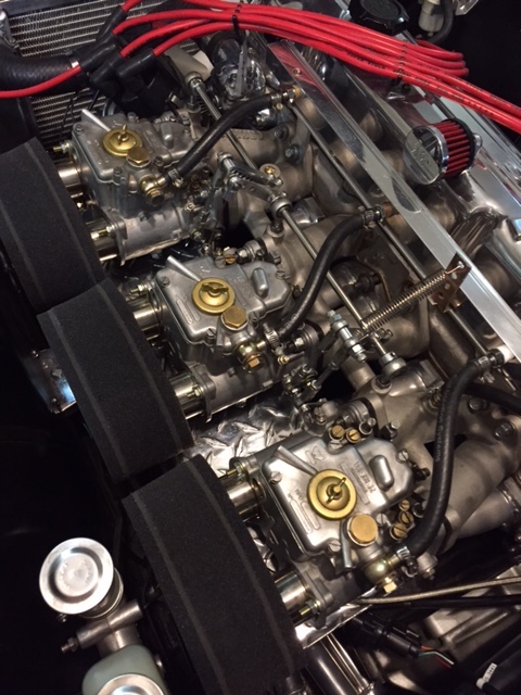

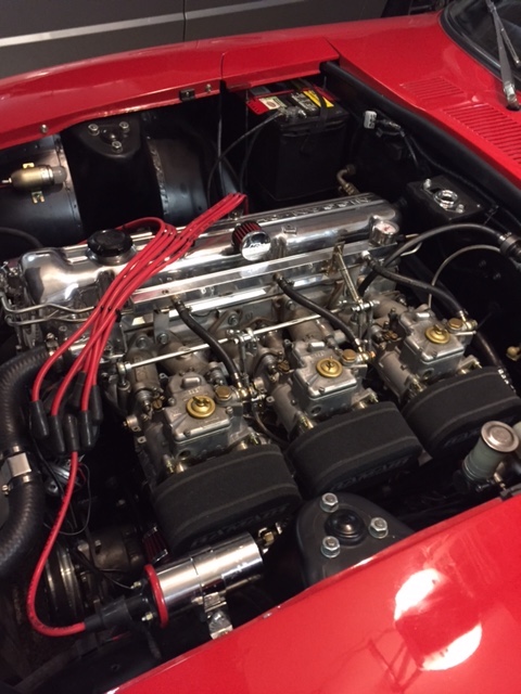

September 12, 20177 yr comment_530159 I have finally got my triples dialed in on my 70 Z with rebuilt L28, stock cam and flat top pistons. Thanks, Blodi, for posting your experience, it helped me a lot! And a big thanks to 240260280 and Chickenman for all of their help over the last number of months, it helped make sense of these wonderful carbs! Weber DCOE 40 151 current specs: Venturis - 32 mm, auxiliary - 4.5 mm, float needle valve - 1.75 mm, idle jets - 50F9, main jets - 161 (drilled), air corrector jets - 200, pump jet - 50, pump exhaust - 00, emulsion tube - F16 I am running around 12.5 to 13.5 on acceleration, with 14.5 on highway cruise (with AFR gauge). Idles very smooth at 850, but could go lower if I wasn't running AC. Life is good ... Edited September 12, 20177 yr by duffman addition Link to comment https://www.classiczcars.com/forums/topic/56375-weber-selection-and-initial-jet-tuning/?&page=11#findComment-530159 Share on other sites More sharing options...

September 13, 20177 yr Author comment_530182 Nice work duffman! I'd be curious how your afr curve looks. Do you have logging capability? Nice looking setup! Link to comment https://www.classiczcars.com/forums/topic/56375-weber-selection-and-initial-jet-tuning/?&page=11#findComment-530182 Share on other sites More sharing options...
September 13, 20177 yr comment_530184 I don't have logging software to graph my results, unfortunately, but I did the same thing you did with consistent runs from 3000 to 5500 rpm on a flat road. I was getting solid readings on my gauge.Sent from my iPhone using Classic Zcar Club mobile Link to comment https://www.classiczcars.com/forums/topic/56375-weber-selection-and-initial-jet-tuning/?&page=11#findComment-530184 Share on other sites More sharing options...
