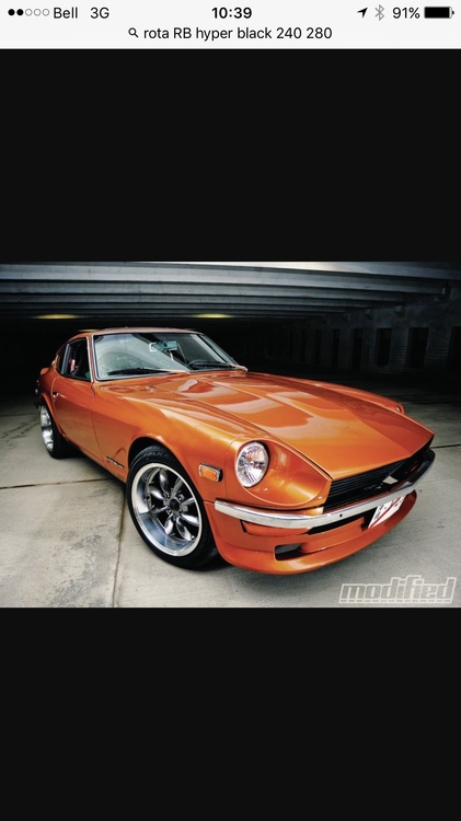

My car is on the rotisserie right now so no wheels yet, but I am in the planning stages for the wheels and tires. I am thinking of a factory order for the RB 16" wheels myself. I need the 5 x 114.3 lug pattern though.
This is the look I'm going for though.
IMG_4268.thumb.JPG.5bae9606a3a403b652441
