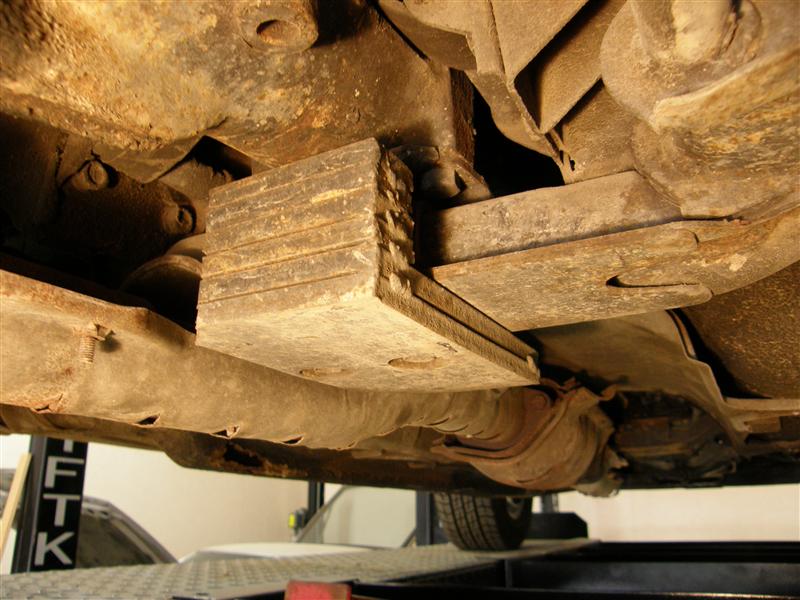

No, that's the standard factory issue damper plate.  It's actually shown in the Rear Axle chapter of the FSM.  Gary L is talking about a retrofit kit that Nissan produced,with a lead weight on top of the diff.  (Don't know why he used atop, a bit archaic there Gary L...)
No, thats the language used in Wick's book - atop; probably due to the original Japanese bulletin interpretation !

But Zed is correct, I'm not talking about the one pictured in 4 above.

Funny how many translate the "lead" in to steel and what Humble references, in to the factory issued piece shown in the FSM.  On the other hand, Humble seems to be the only person that actually knows about the parts, and he got his part numbers confounded with the early part numbers.  He did a lot of writing about it.  He has to have seen hundreds of the big L-shaped steel plates though, that bolt on to the bottom.
