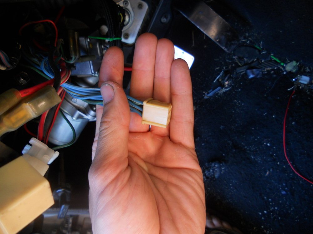

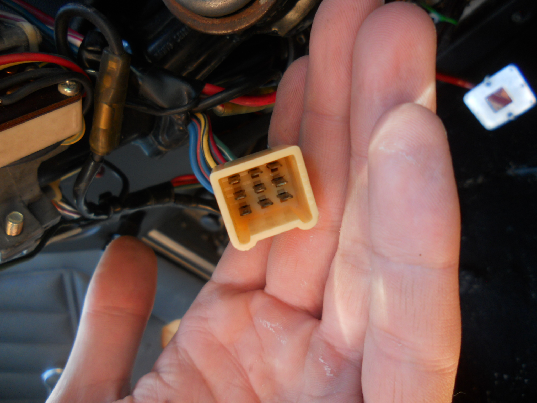

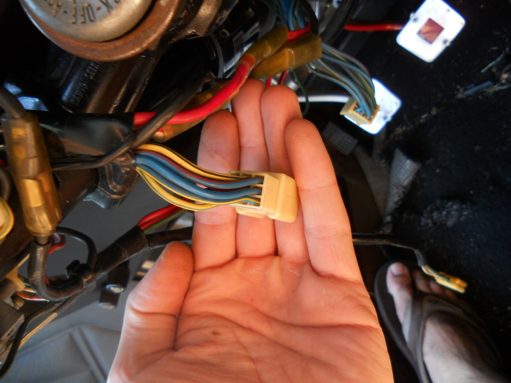

I asked you early on to post photos of a specific connector. It is because I have have see issues in that area on more than one car. If nothing else, it would help eliminate that as a cause for the issue on your car.
-Ok replies are typed in inline with your quoted text. It was easier for me to compose it that way. And here are the pictures you requested. Thankyou, I don't mean to come off as ungrateful.
Thank you. That helps. Yes, the parking light circuit was/is overloaded. The connector overheated. It may not be making good contact at that pin anymore. Mine was worse.
Check your side marker sockets and right side turn signal light sockets. One or more could have corrosion between the housing and the center pin where the positive is. That gives another path for current to flow. Take some photos of the side markers (with the bulb pulled) and the right side turn signals. You may have corrosion in the right front turn signal. That would account for the turn signal indicator lighting up in your previous experiment, that is if you didn't already discover an 1156 bulb in that socket.
