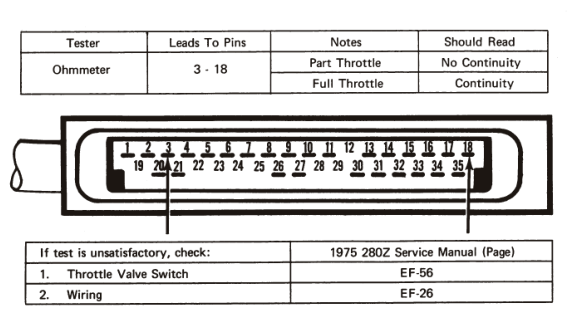

Test 1 in troubleshooting section idle resisted .3 ohms
Test 2 full throttle test, open.4 ohms/partial .4 ohms    failed, partial should have been zero
Test 3 full throttle/closed throttle 26.2 mega ohms
Test 4 air flow meter resistance #1 184.
Test 5 air flow resistance #2 238.5
Test 6 air flow meter resistance #3 103.9
Test 7 air temp sensor 1.5 k ohms
Since test 2 failed, it led us to the throttle position sensor, I guess we will start there.

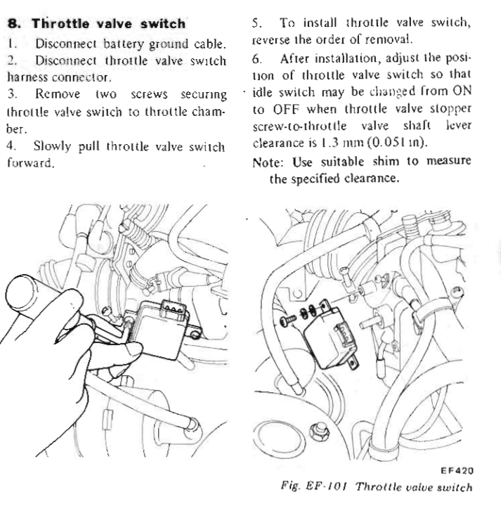

The TPS may need adjusting. One screws locks it down the other has some movement for adjusting. Pop the cover off and see what rpms it moves off the right side contact.
Actually partial should have been many many ohms, like kohms (kilo-ohms, thousands) or infinite, and full should have been low, as shown.  For Test 1 (2). But you're only saying open, not fully open.  So not clear if you had the throttle wide open or only partially open.  Either way, that measurement would show full throttle to the ECU, adding extra fuel.  When there's continuity (very low ohms) on 3-18, the ECU adds a lot of extra fuel.

You might have overlapping wrongness then.  Because the test results would be showing the ECU that you have the throttle wide open.  That adds 27% extra fuel to whatever the base calculation is, which should cause it to run better when cold and bad when warm.  Gassy smelling and rough running when warm.  But the fact that it runs better warm would indicate a lean mixture.  Which could be a shorted coolant temperature sensor circuit (page 56 in the 1975 EFI Guide), indicating a very warm engine to the ECU, and removing fuel.  That might be the popping when cold, but runs okay when warm.  The ECU thinks it's very hot and removes fuel, but the WOT (3-18 continuity) indication adds fuel.  Or you might just have low fuel pressure (lean), or clogged injectors, being compensated for by the WOT 3-18 results.

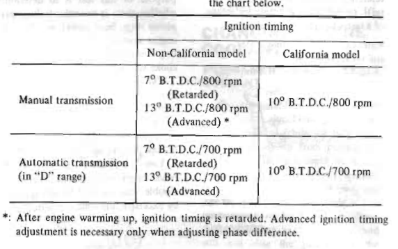

23 degrees is way advanced timing for the EFI engines.  Spec. is probably 7 or 10.  Many people run a little extra, like 12-15 to add some throttle response and a bit more power.
You have an engine that runs which is more than many.  But you have to get all of those small details right.  Once you start knocking some down it's not a bad process.  Set your timing to 7 degrees when warm for starters.  That's where it should be. Picture from the Engine Tuneup chapter.

Thankyou for response, should I replace tps to wipe that off the list? I have mentioned the coolant temp sensor to my mechanic but he seems to keep avoiding it. Will set timimg back and go from there.
Like site said, it's adjustable.  Engine Fuel chapter.  Really can't emphasize enough how one of the main things that make these cars so easy to own, fix, and maintain, is the availability of the free Factory Service Manuals.
The TPS can get dirty also.  Note that we call it the TPS but it should really be TVS.
