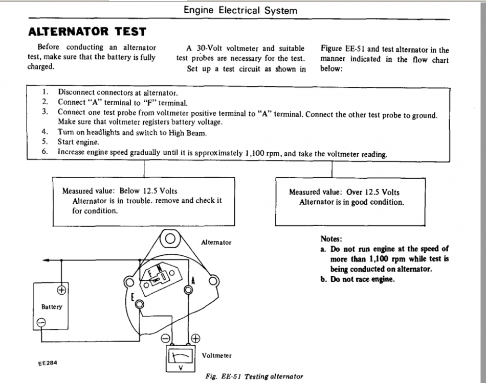

July 1, 20168 yr comment_497843 If the alternator is not charging, you should check to see that the field coil is getting voltage from the regulator, the FSM covers how to do this, a simple jumper from the Bat to the field coil will fully energize, you just want to make sure you don't rev the engine up (with the field coil un regulated the alt will put out excessive voltage likely damaging the ECU). Monitor the voltage at the battery and if it starts charging with the field jumped then the regulator or wiring to the regulator is at fault. Edited July 1, 20168 yr by Dave WM Link to comment https://www.classiczcars.com/forums/topic/55727-alternator-not-powering-battery/?&page=3#findComment-497843 Share on other sites More sharing options...

July 1, 20168 yr comment_497875 Guess I was way off on the plastic doohickey. Â F, N, S, and L will tell the story though. Â Still some concerns about what your guy was looking for . He must have been measuring at the alternator, not the regulator. Here's a test to bypass the regulator. Â At least he can see that it works and move on to other causes. Â There is a whole series of tests in the Service Manual. Also, I'm pretty sure that the external regulator suppliers out there are iffy. Â The solid state ones are sensitive, and the wiring changed over the years. Â If you find that the alternator works but you can't get a good regulator you might go for the ZX internally regulated system. Â Â Â Link to comment https://www.classiczcars.com/forums/topic/55727-alternator-not-powering-battery/?&page=3#findComment-497875 Share on other sites More sharing options...
