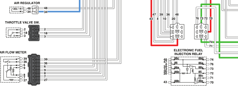

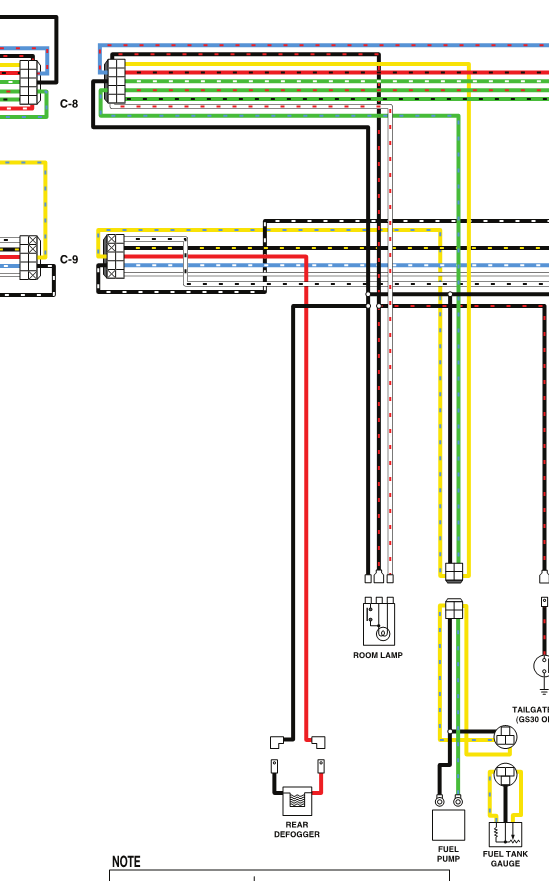

I mis-wrote, there's actually even one more connector after the one by the passenger seat.  If you open the passenger door, remove the sill plate, and peel the carpet apart at the seam, you'll see the connector.  Attached a picture with wire colors.  Notice that there's also one  farther back, probably behind one of the plastic panels.
Also attached a picture of the EFI relay wiring.  Not easy to figure out, you'll probably need a meter to be sure.

Alright, so there's a green wire with dark green stripes that runs through the whole deal on the passenger side, and that's the positive lead for the fuel pump. Alright. I'll try to track down these junctions, check their conditions, and check voltage.
Thank you for this diagram! Where did it come from?
