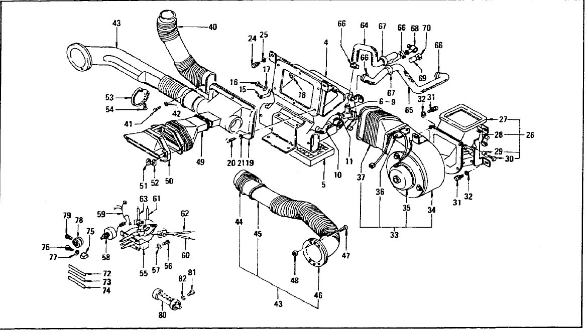

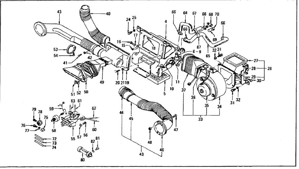

5 hours ago, Patcon said:
Is the "central air duct outlet" the one bolted to the heater box or the thinner one that connects the dash to the heater box?
Item 50 in the FSM illustration (exhausts through the rotating chrome grille, Item 80). Cutting and then gluing the foam pieces around the duct's inside surfaces is finicky work.  I can only assume that Nissan decided the benefit outweighed the additional manufacturing cost.  You need to use open-cell foam for this location.

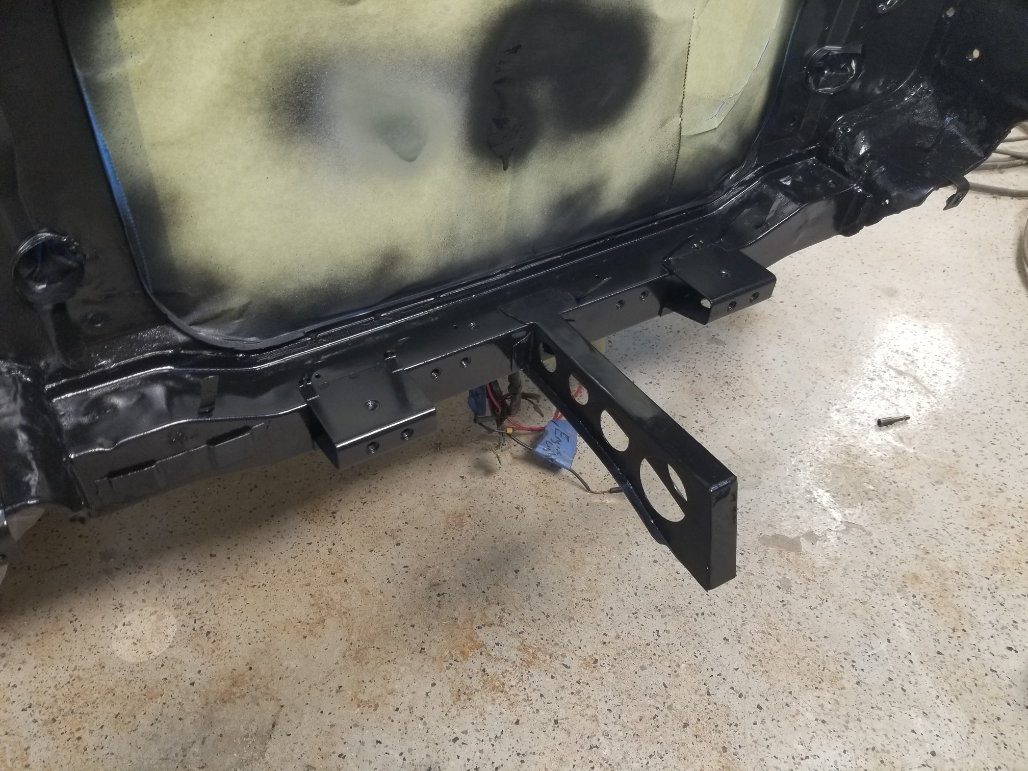

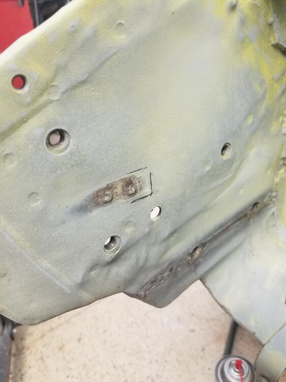

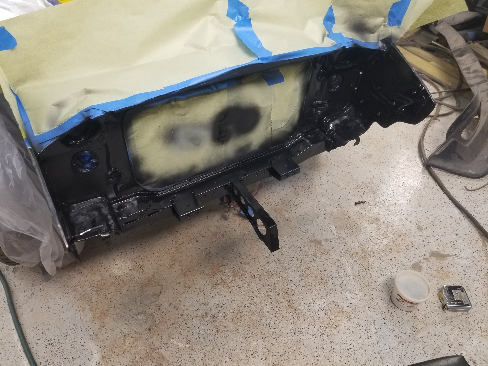

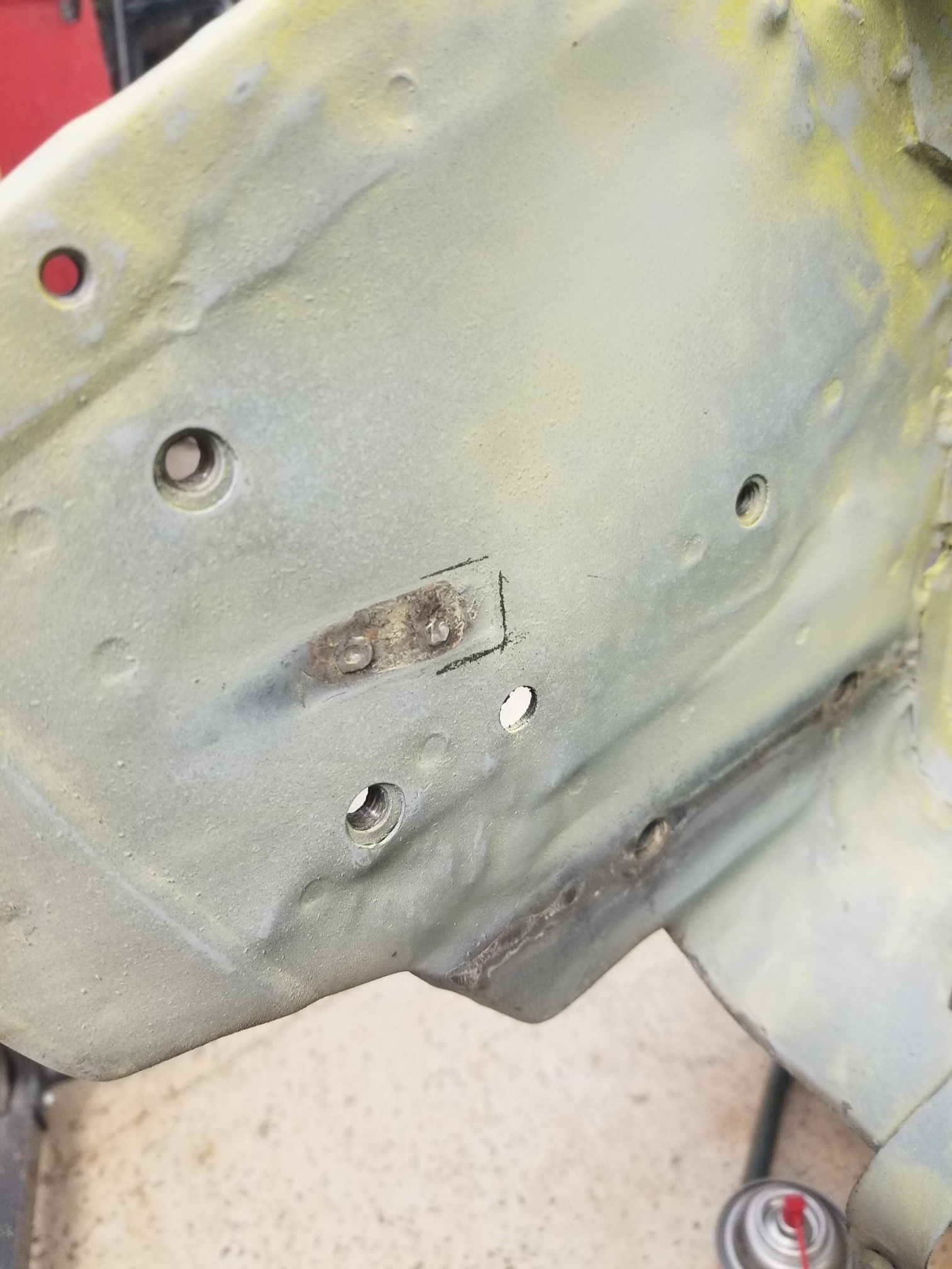

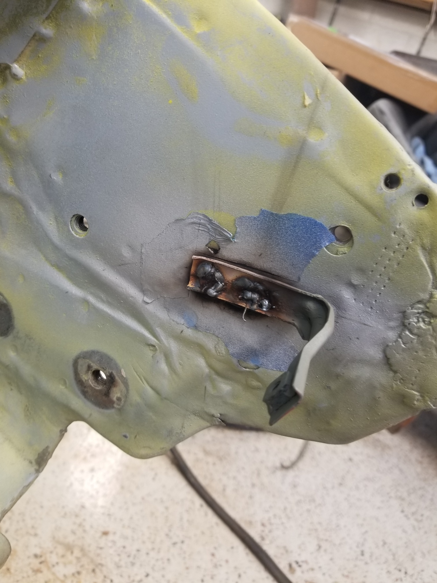

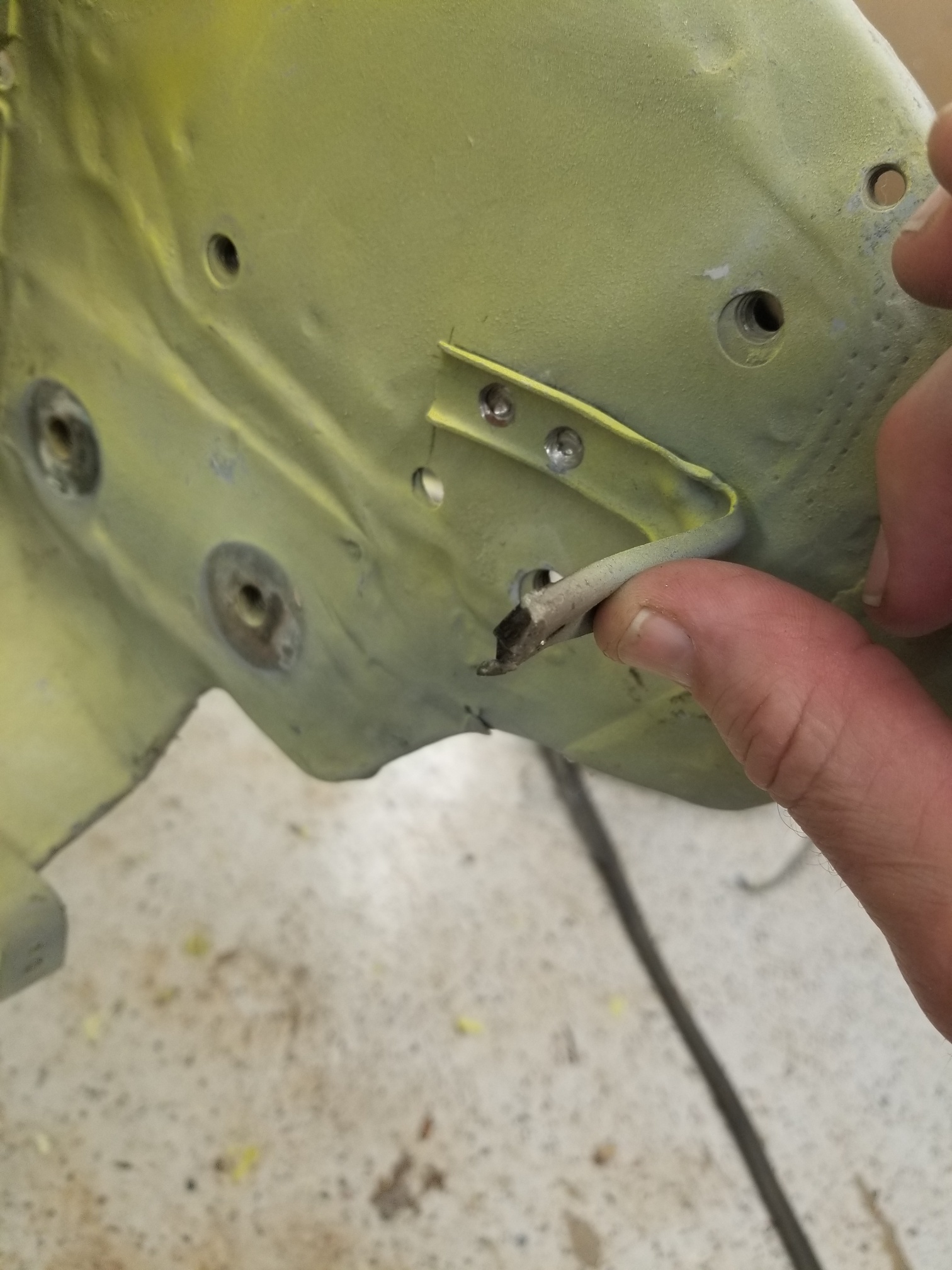

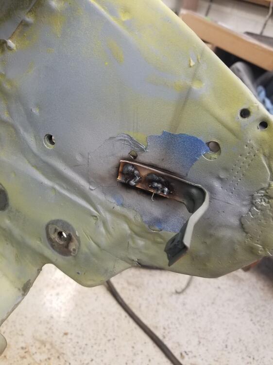

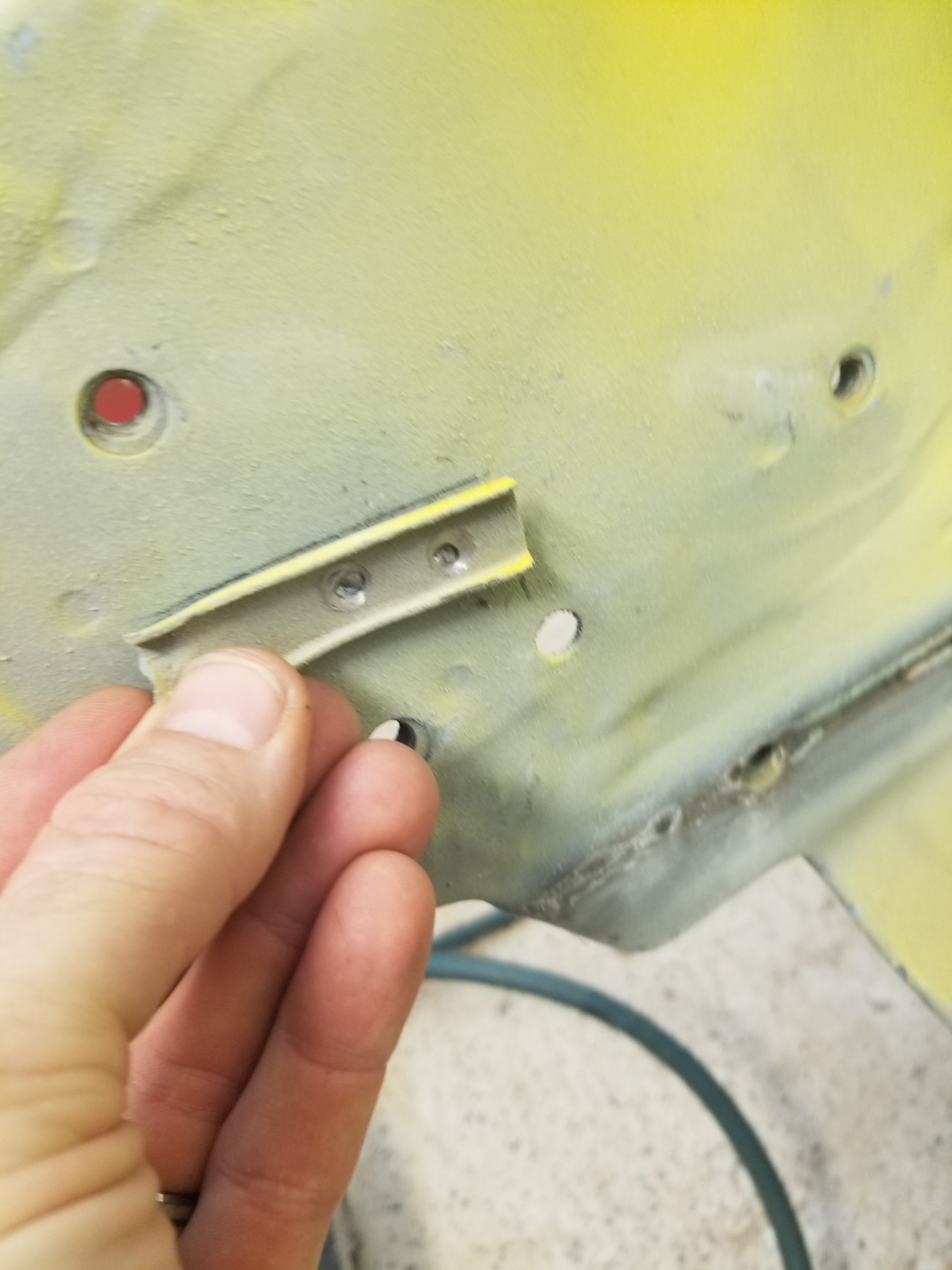

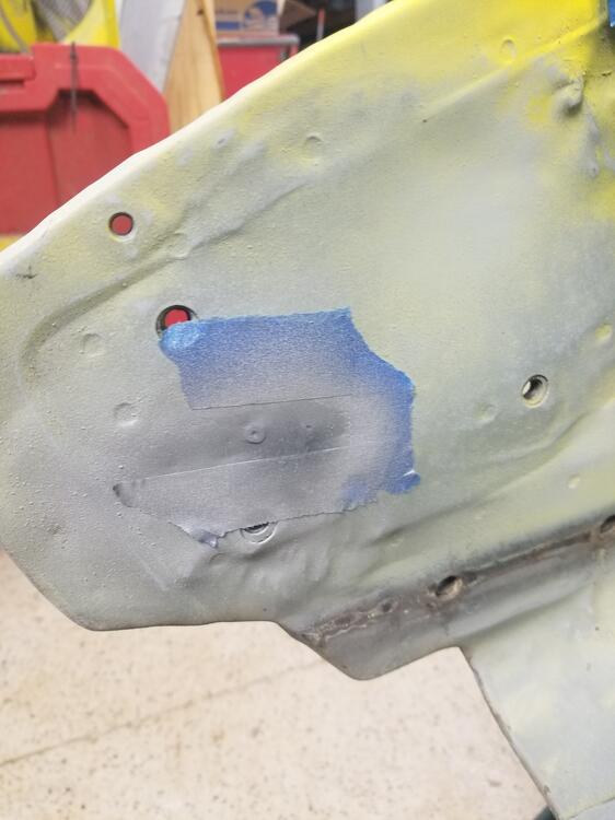

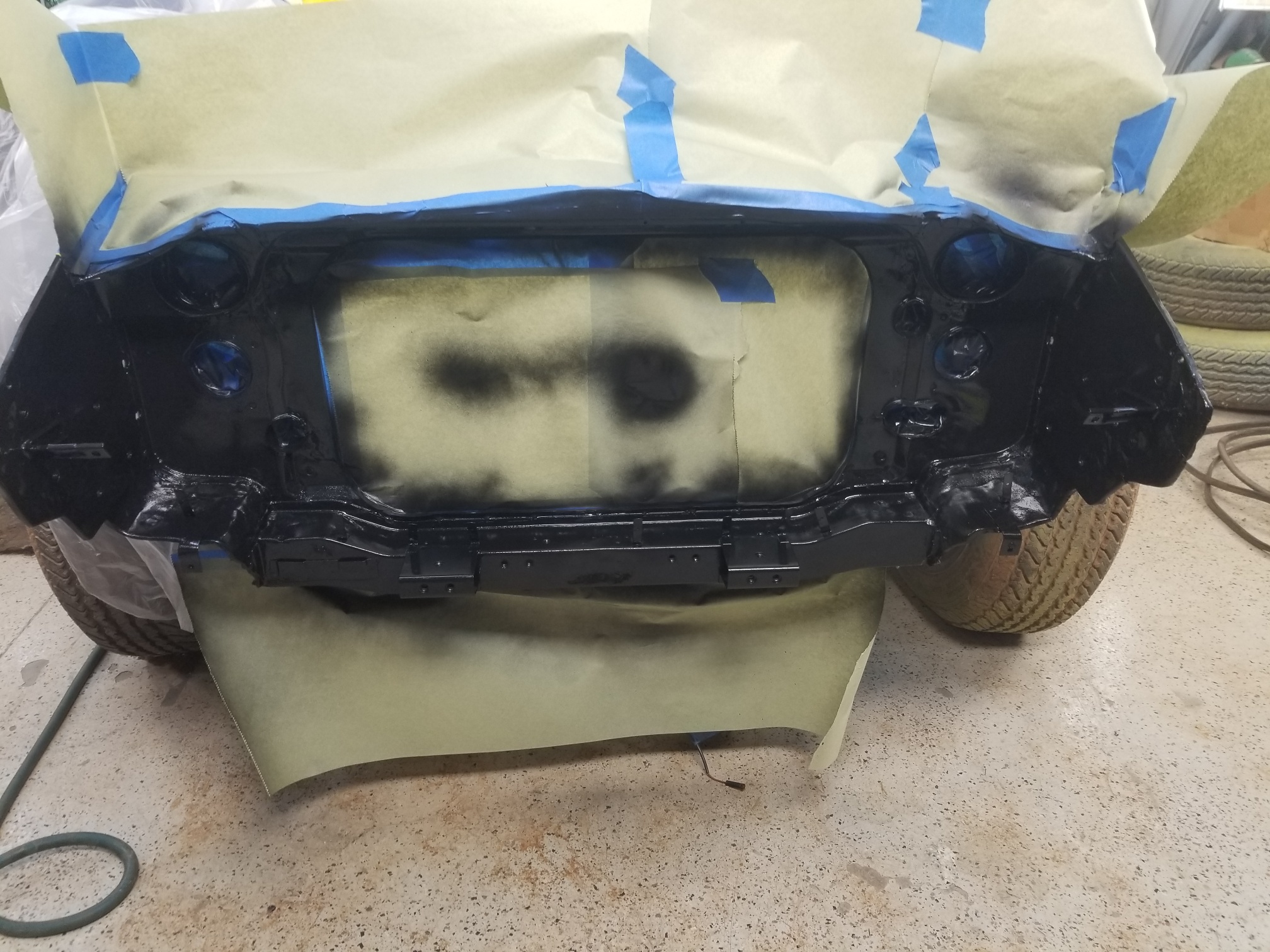

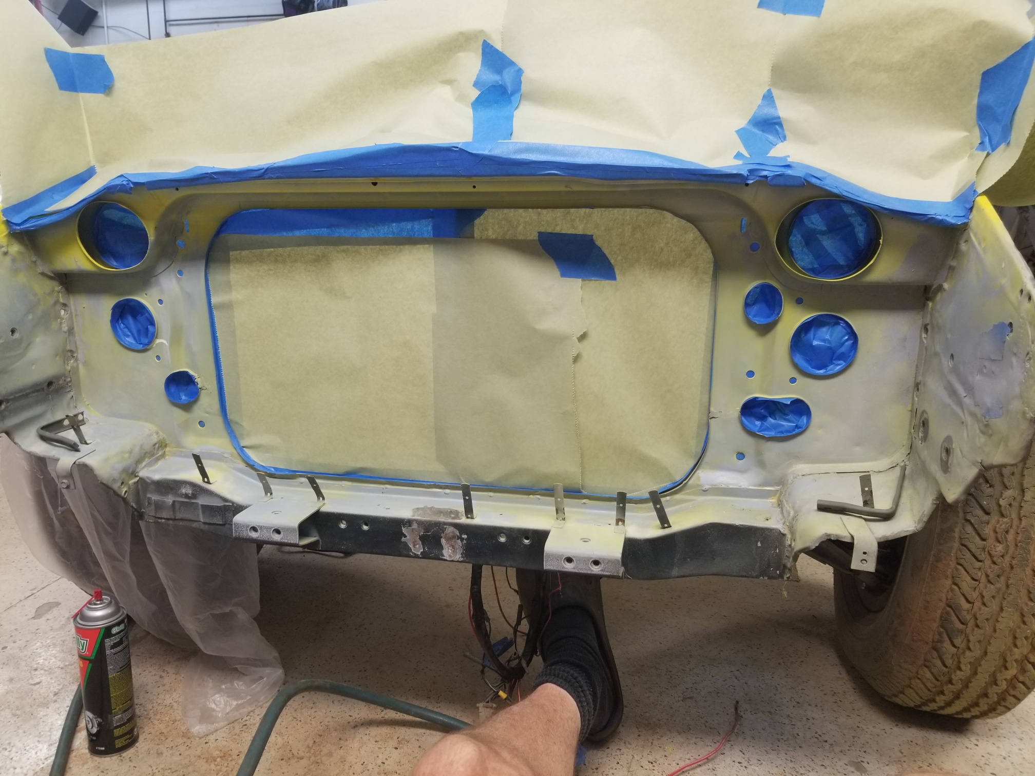

So I worked on the radiator support some this week

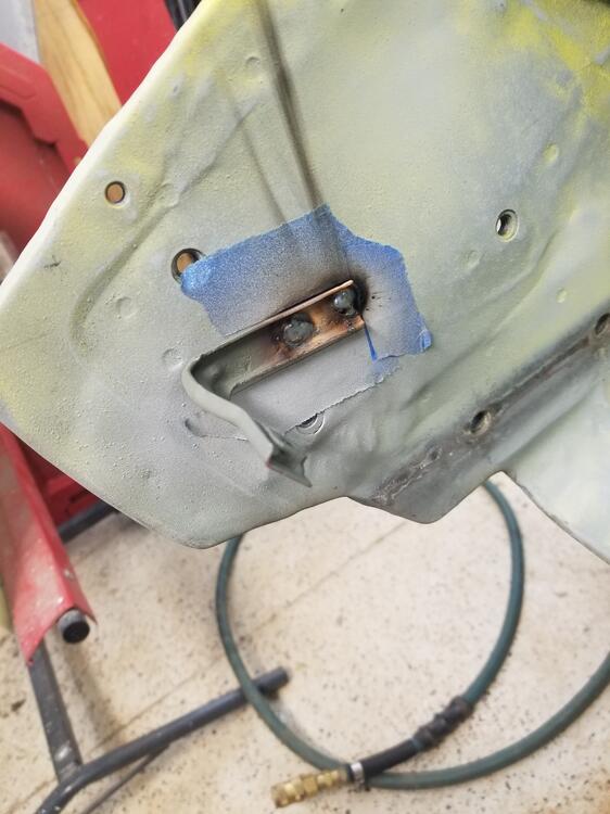

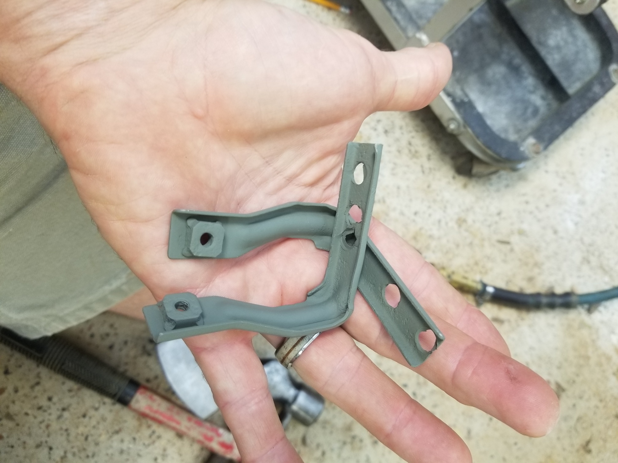

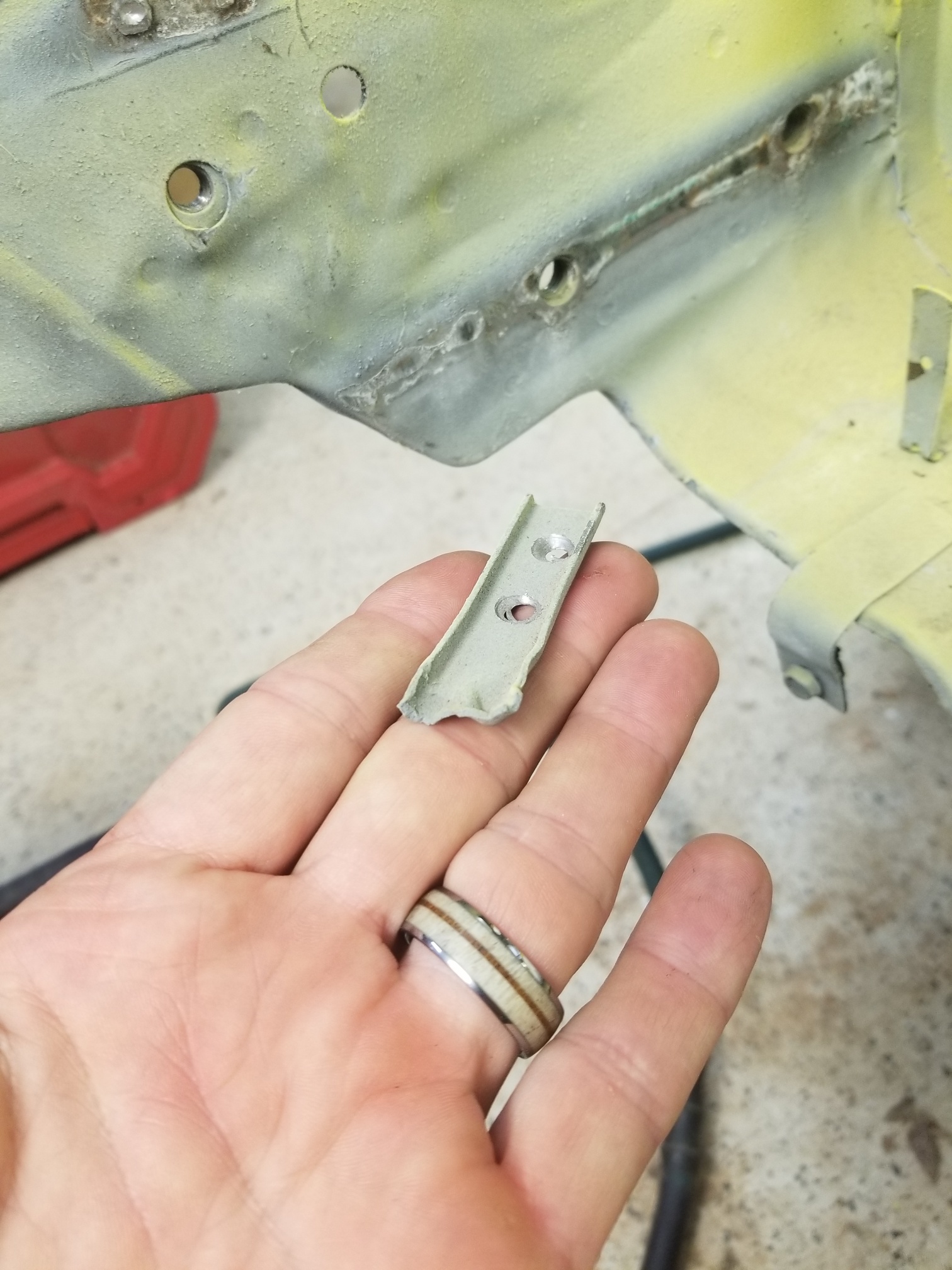

My grill brackets were either bent or broken off. So I took some off a parts car a while back. Marked around them with tape because the spot welds are in different places between the parts and the weld through primer would erase the pencil layout.

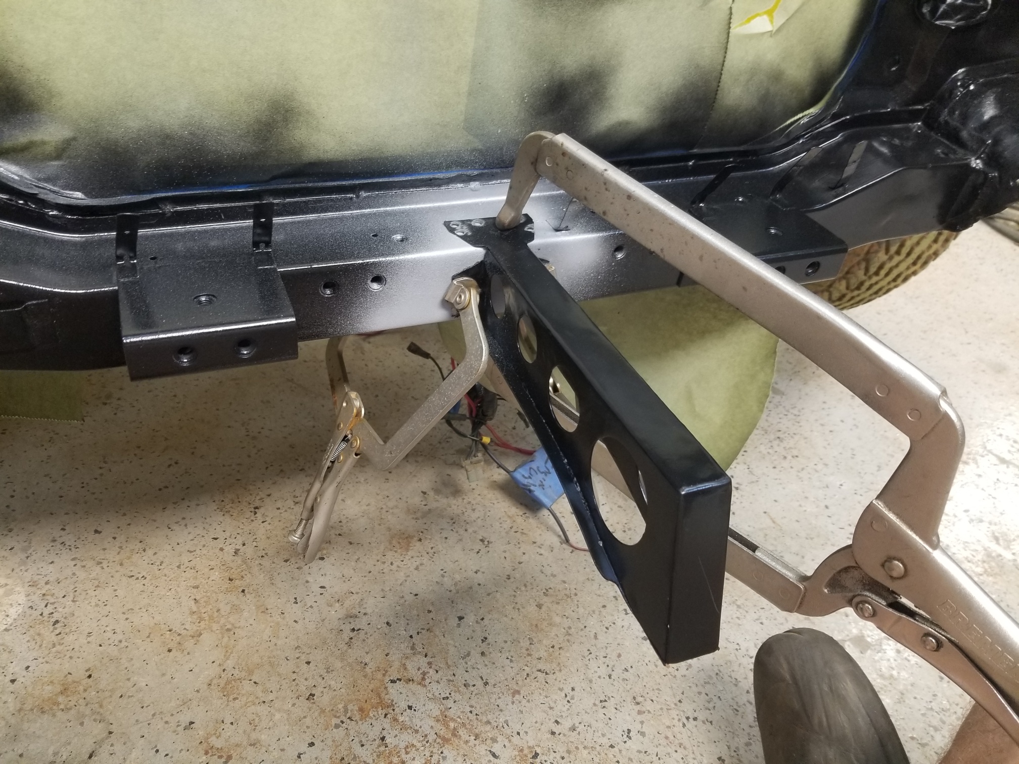

Then I seam sealed around them. Taped the car up and sprayed it black. Then I primed and blacked my air dam support and welded it on today

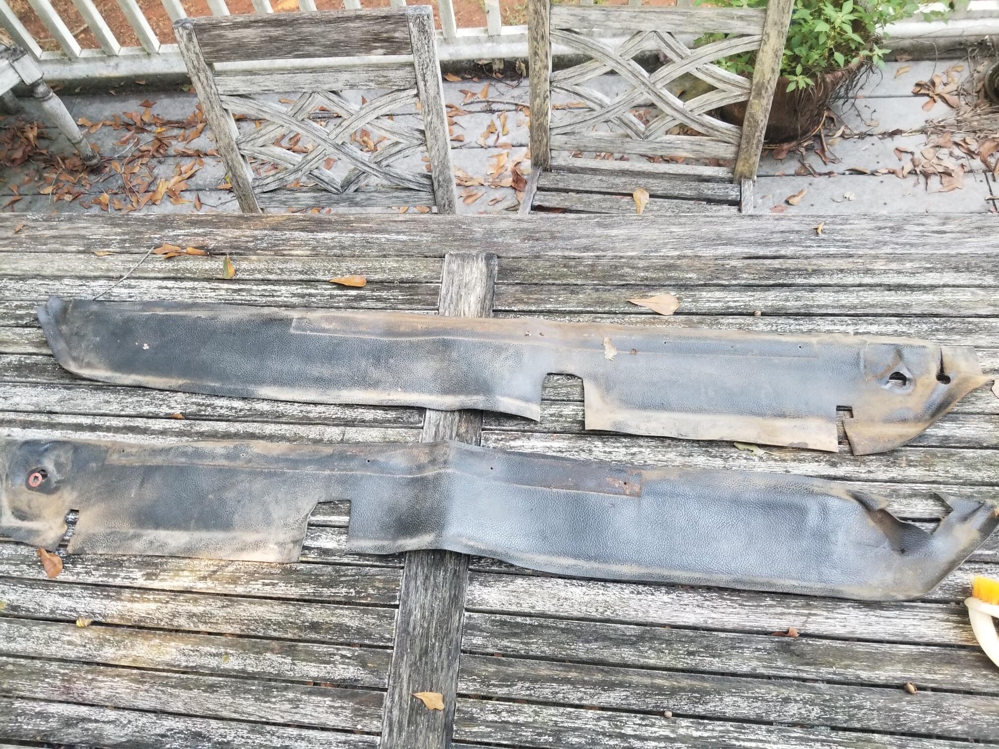

Trying to clean the rocker vinyl pieces up. I may have to vinyl black them to make them look right
I haven't seen these available any where new ?
