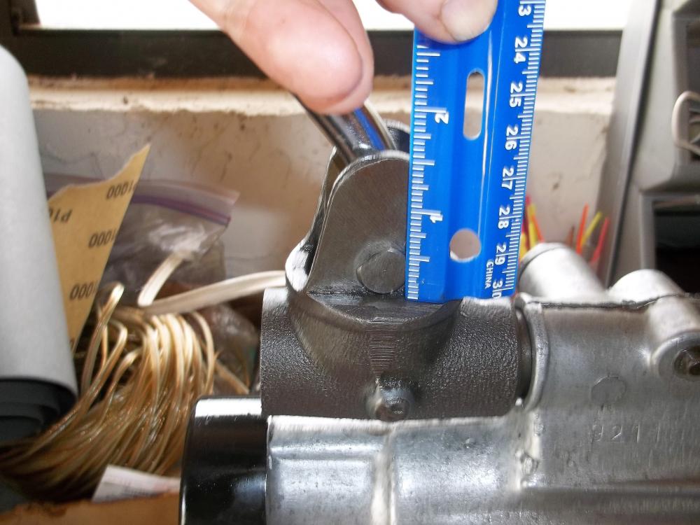

And the early, solid, shift levers tend to touch/obstruct at the base if used on the newer 5 speeds.  You'll see a little mark at the base of the lever, above the pin, in the front after some shifting in to 5th.  Some people grind or file some clearance.  Might be easiest to do while it's out.  There are pictures on the site somewhere, it's been discussed.

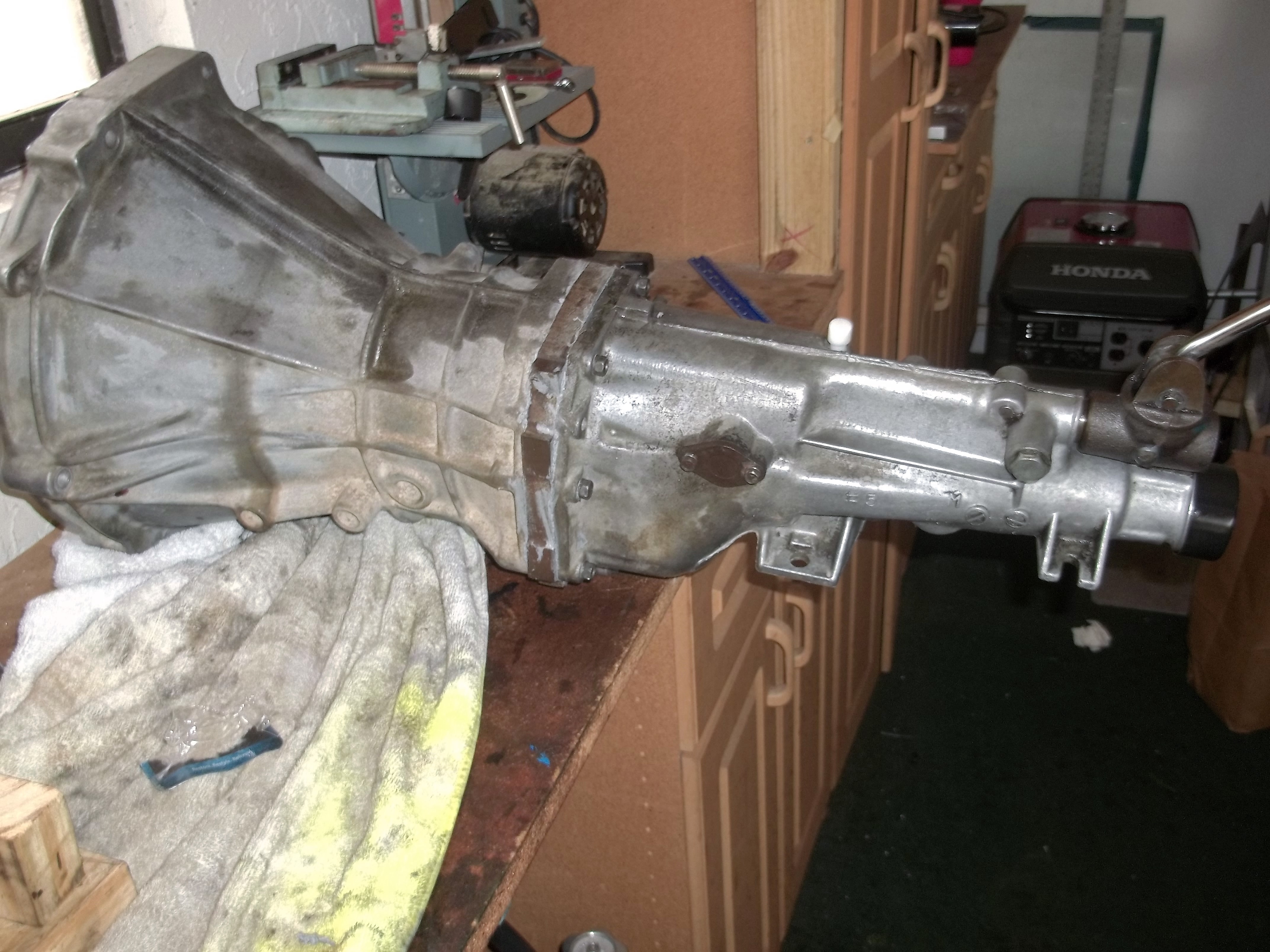

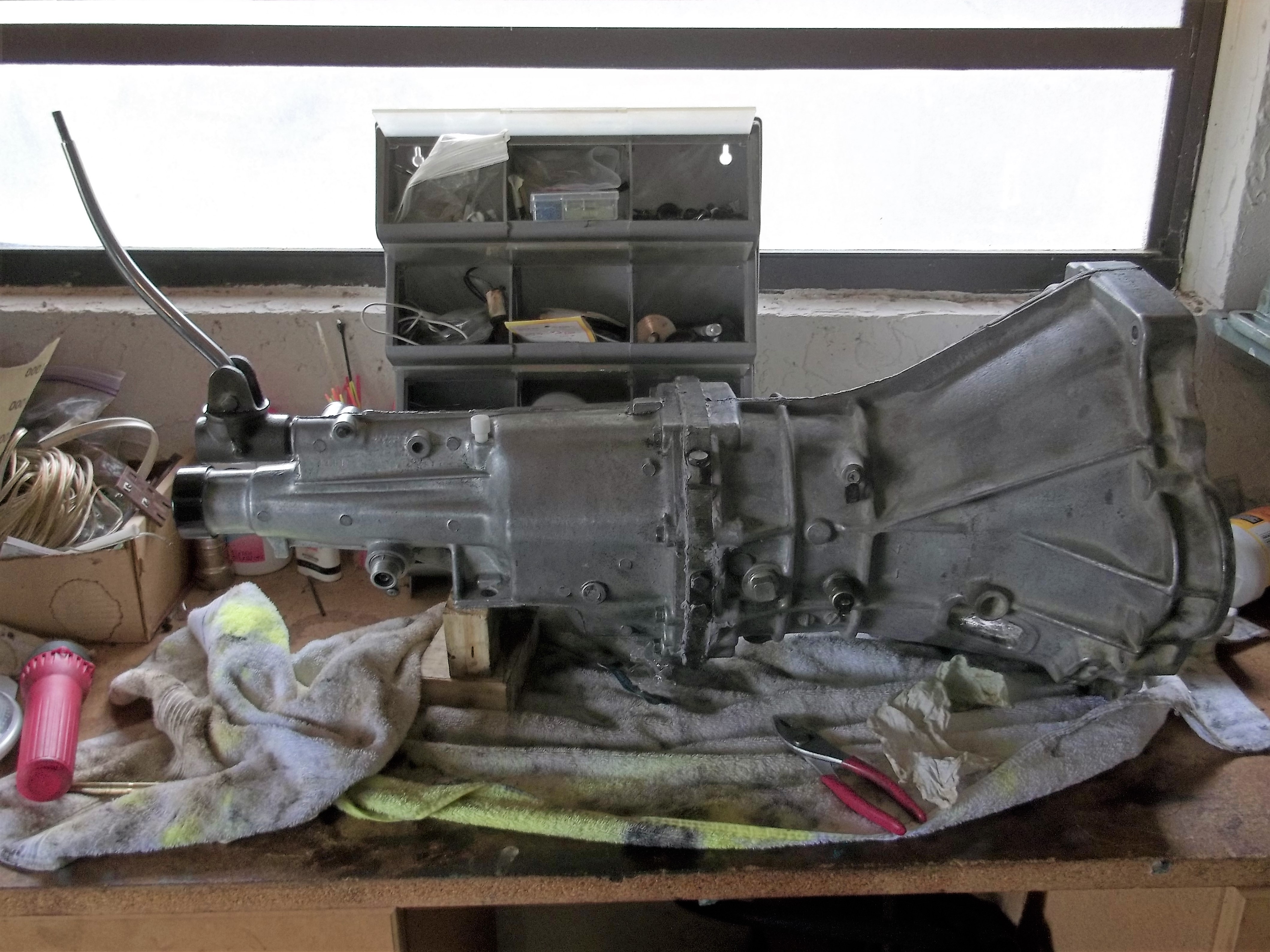

You never did show a picture of the whole unit.  Early and late have differences, easiest to see is the number of exhaust hangers on the tail housing.   I'm going to guess it's a 79 5 speed.  79 had a whole range of diff ratios available, including 3.7.
I had guess this was a 81 based on the ratios I got when turning the input shaft. Compared them to so info found on line. Key was the tall 1st (about 3.0) and OD was about .75

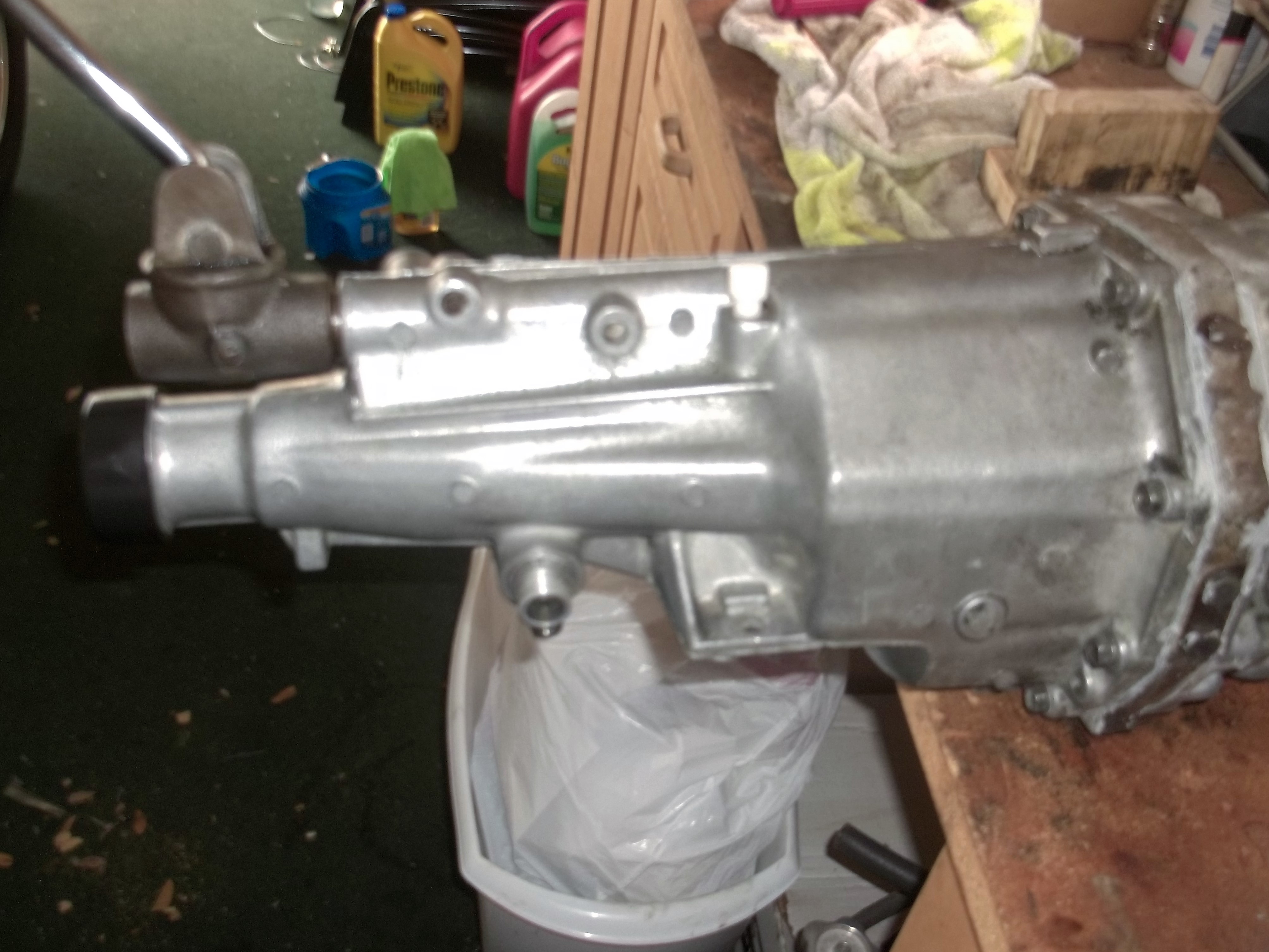

Looks like an 80's later model.  One exhaust hanger and the reverse lockout plug.  Should be a good one.  Here's a picture showing where the impingement happens.  That's not the shift lever the factory gave it, but it should work fine in your 280Z.

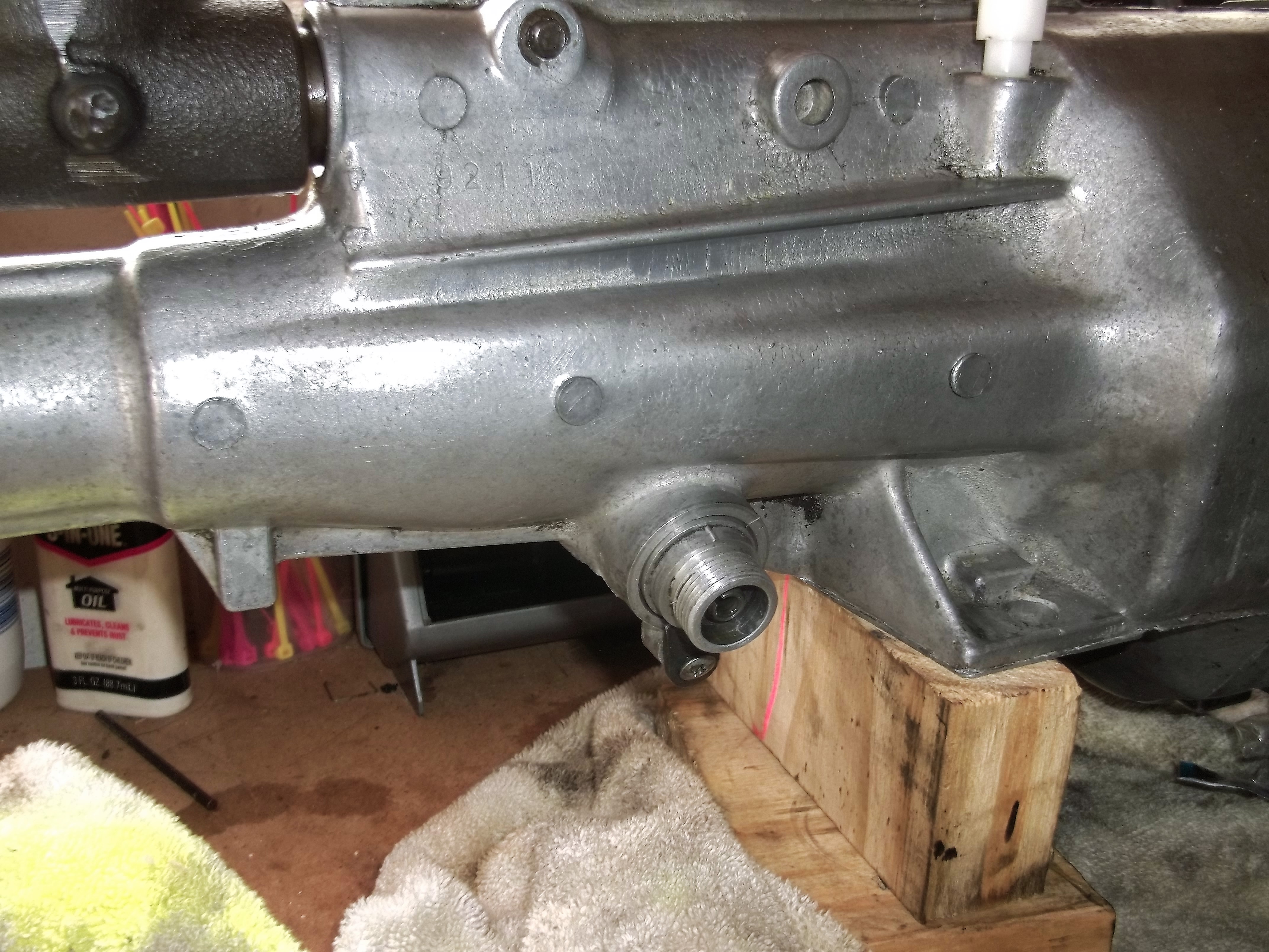

I remember reading about the low screw retainer on the speedo as well (to help id the trans). Got a new clutch fork rubber boot on the way as well. The shift bushings are good on it, and I have a good rubber on the 4speed shifter that I can transplant. I am using the paint can plastic top to keep the oil from leaking out the back, fit the ID of the seal perfect.
