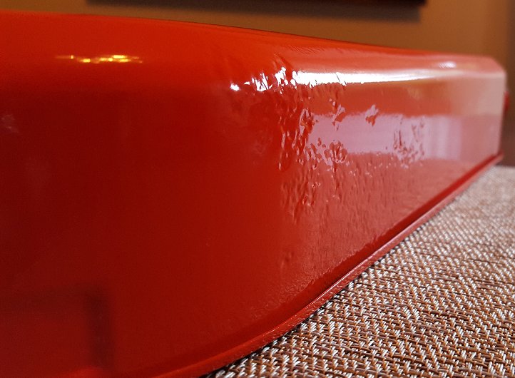

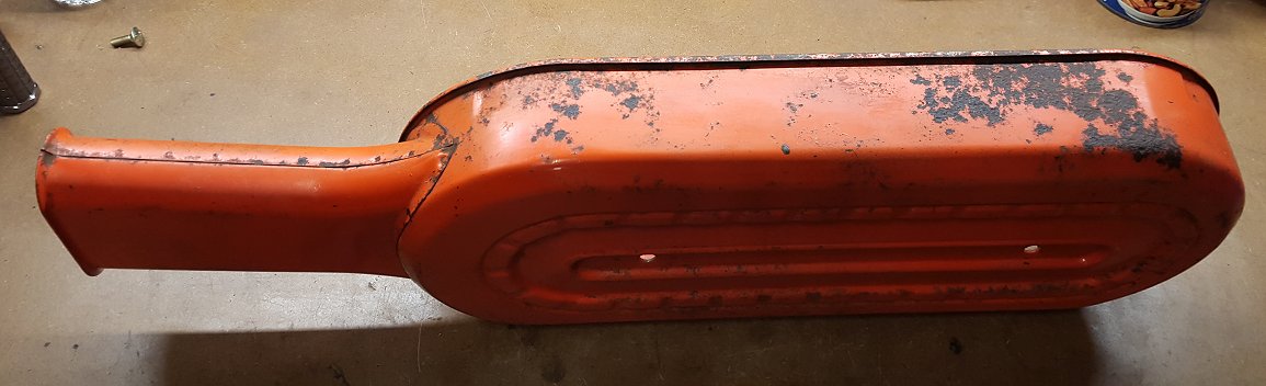

I am posting this in the Body and Paint forum since this is really a paint/finish question.  Several months ago I purchased this Series-1 air cleaner off of Ebay.  I paid a fair price for it, $150 shipped.  I was in the middle of buying a new home so when it arrived I opened it and based on a quick inspection I deemed it was good, placed it back in the box, and saved it for another day.  Recently I unboxed it with the plan of getting it blasted and powder coated.  The picture below shows the original rust and pitting before I dropped it off at the PC shop.

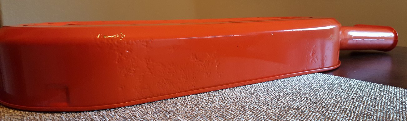

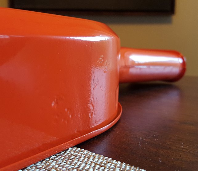

In my haste to move forward I dropped it off, not really looking at the pitting.  Hoping for the best I got it back and of course to no one’s surprise the pitting is still there.  The rest of the air cleaner looks great and the “Pumpkin” color I chose is spot on in my opinion.  Since the pitting is where the decal goes and is most visible when installed on the car I do not know what to do.  Before I do anything rash I wanted to get some owner’s opinions of where to go from here.
The primary reason I bought this air cleaner was because it is the only one I have seen in a long time that had a mint snorkel on it.  Too many are banged up from years of use.  Due to how thin the metal is, once it is damaged, it takes a very skilled person to make it look right again.
At this point I “think” my only option is to blast off the powder coat, fill in and body work the pitting to make it smooth, and then have it re-painted to match the rear cover.  I welcome everyone’s ideas and suggestions.

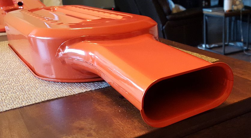

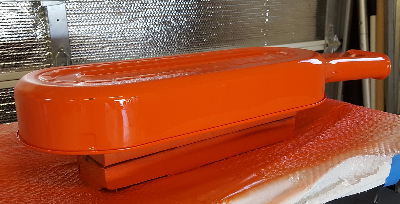

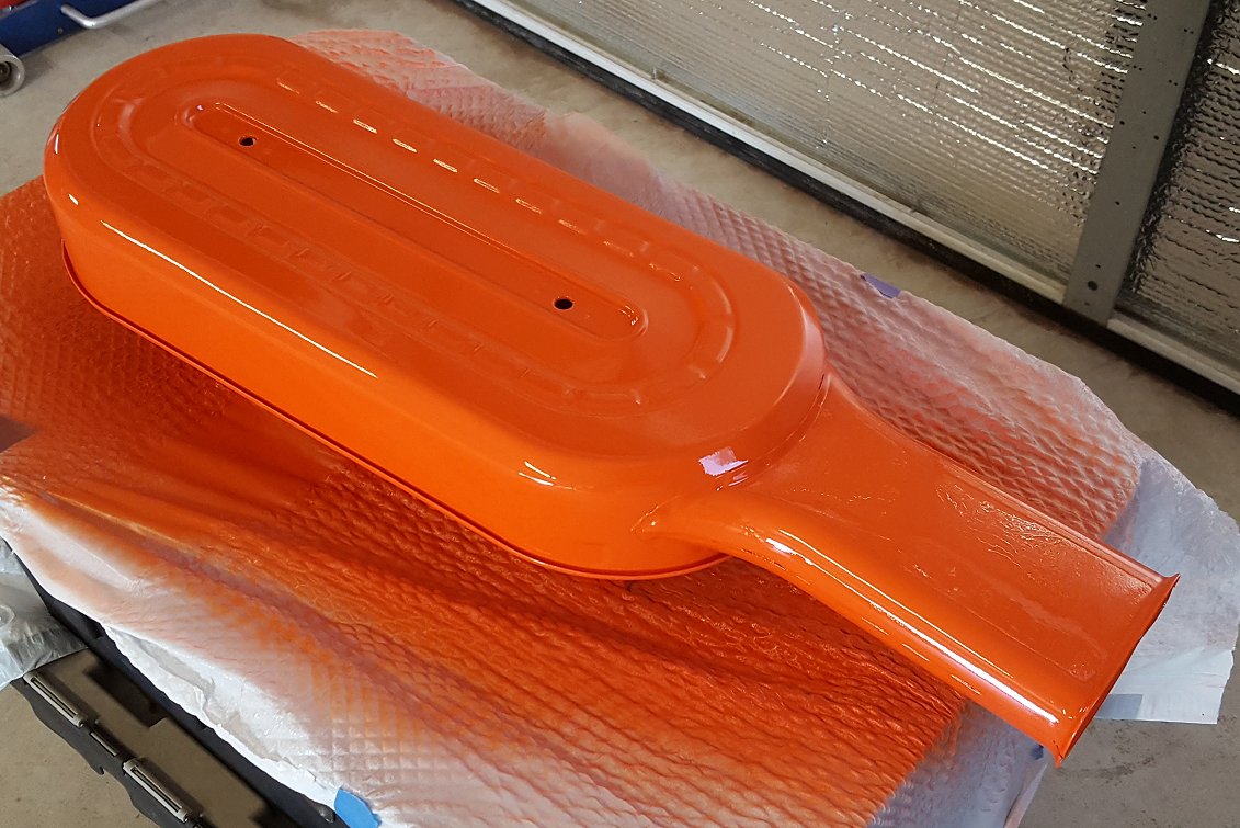

I made the most of the 3-day 4th of July weekend and got the air cleaner project wrapped up.  I plan on doing an more extensive write up on the restoration but wanted to let you guys know I took your advice and the end result exceeded my expectations.  For the filler, I bought a small tub (cat food can size) of lightweight Bondo filler as the local supply store only carries Evercoat in one gallon cans.  As I said before, this is my first real effort at paint and body work and given that fact I think I did pretty good.
