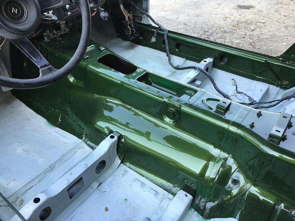

That should make it easier. On my 77, the bump into the interior for the catalytic converter (if equipped) looks larget than what you have on yours.
Here's a  pic of a 75 or 76 with the bump:
And here's a 77-78 bump, hump:

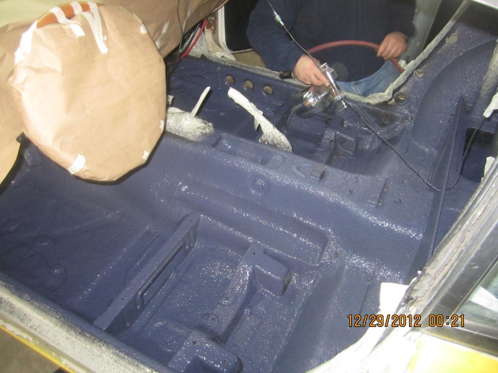

EDIT - that 75 with all that muck (stone chip protection??) sprayed inside makes me shudder 🤪
Ah - I see it now. I do have a bump.  I will have to see what happens when I take  the DS apart to fit it.
Edited by HusseinHolland
I don't know how severe the bump was in 75, but on my 77, the left side was tight dealing with the seat bolster up against the trans tunnel and converter bump.
Some people perform the catalytic converter "hump bash" (technical term). Which, as the name implies... You bash the hump down with a BFH from inside the car to make more room for the driver's seat.  LOL

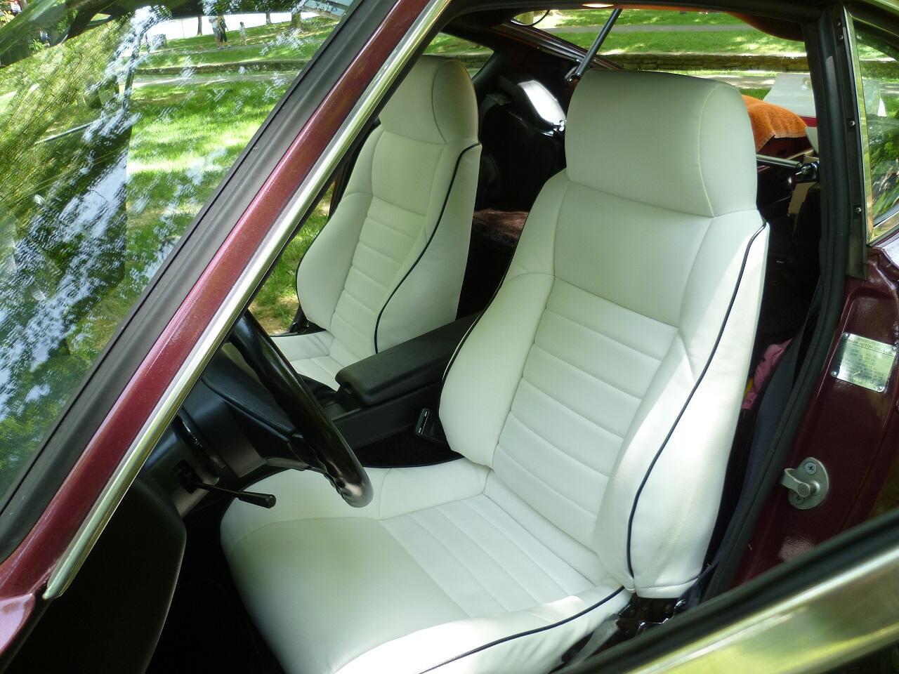

I put Fiero seats in my 77 and passenger side was a lot easier than the driver's side. I did not perform any hump bash operations because I told myself that I might want to put a pre-muffler resonator in that location some time in the future. That was ten years ago maybe? Haha!

Those look great! Very bold to put white seats in a car - would never work for me, I very often forget to change out of (auto) work before getting in.

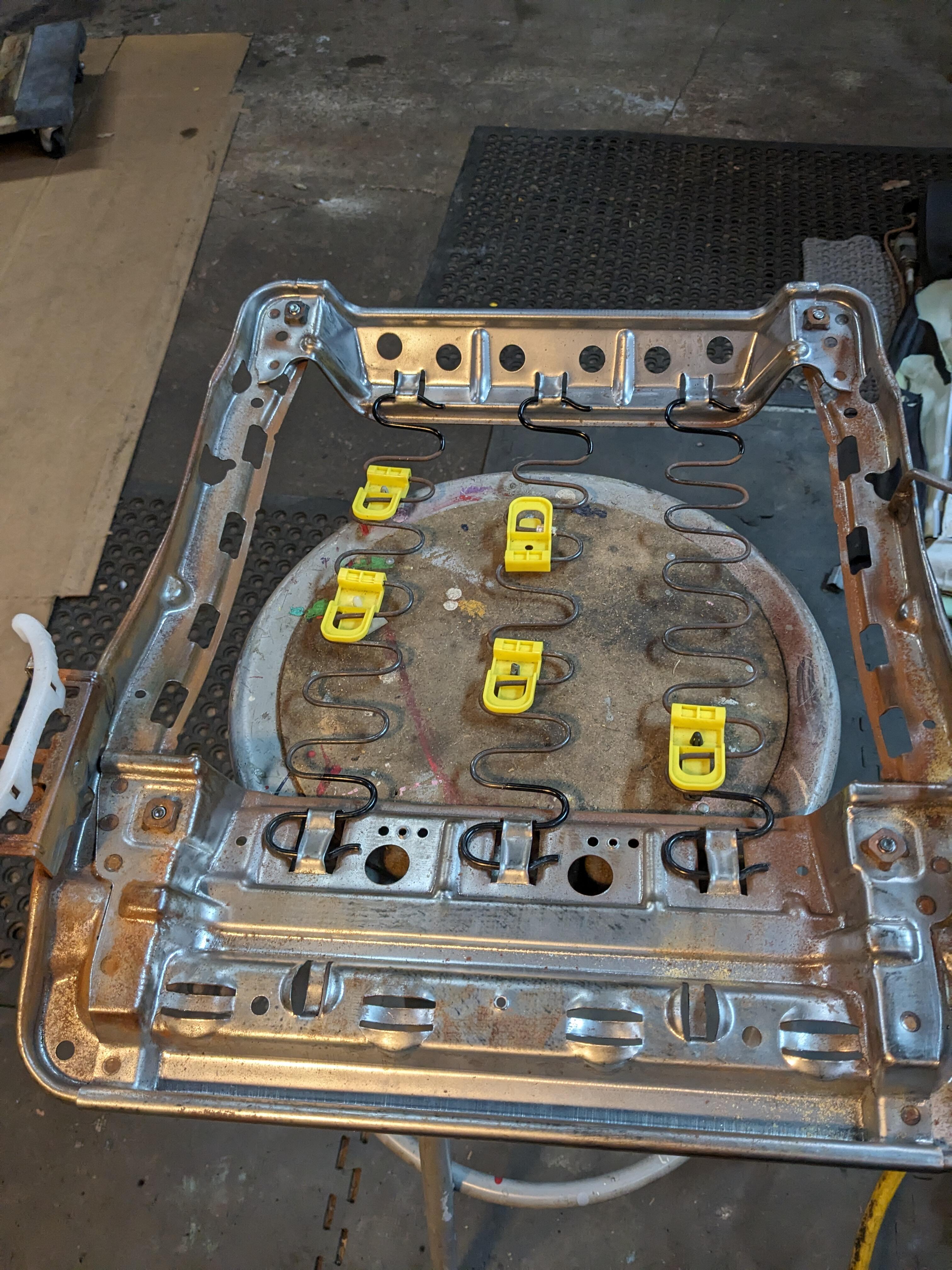

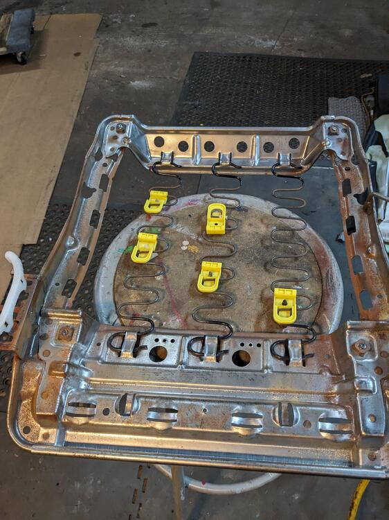

Took the airbags, seat belt receivers, and cushions off the seats
documenting wiring. I powered the seats, and made sure the seat tracks were set in the rearward position - they were.PXL_20231211_194358502.jpg
track length
16.75"
airbag bracket
4 bolts on each cushion frame.

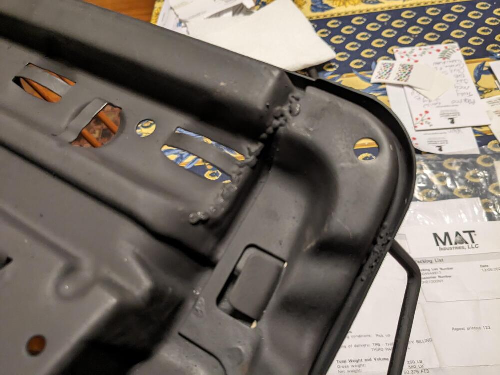

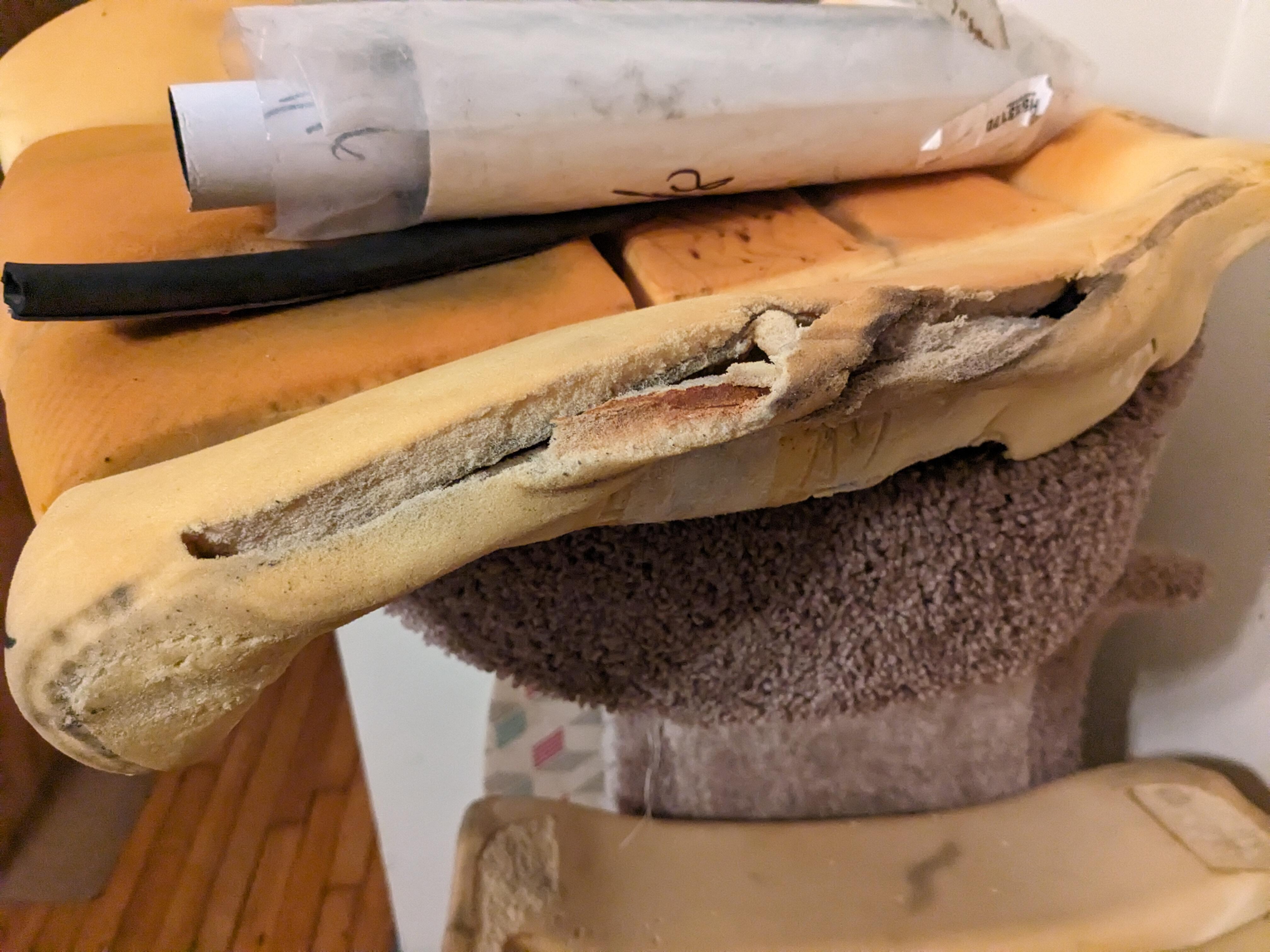

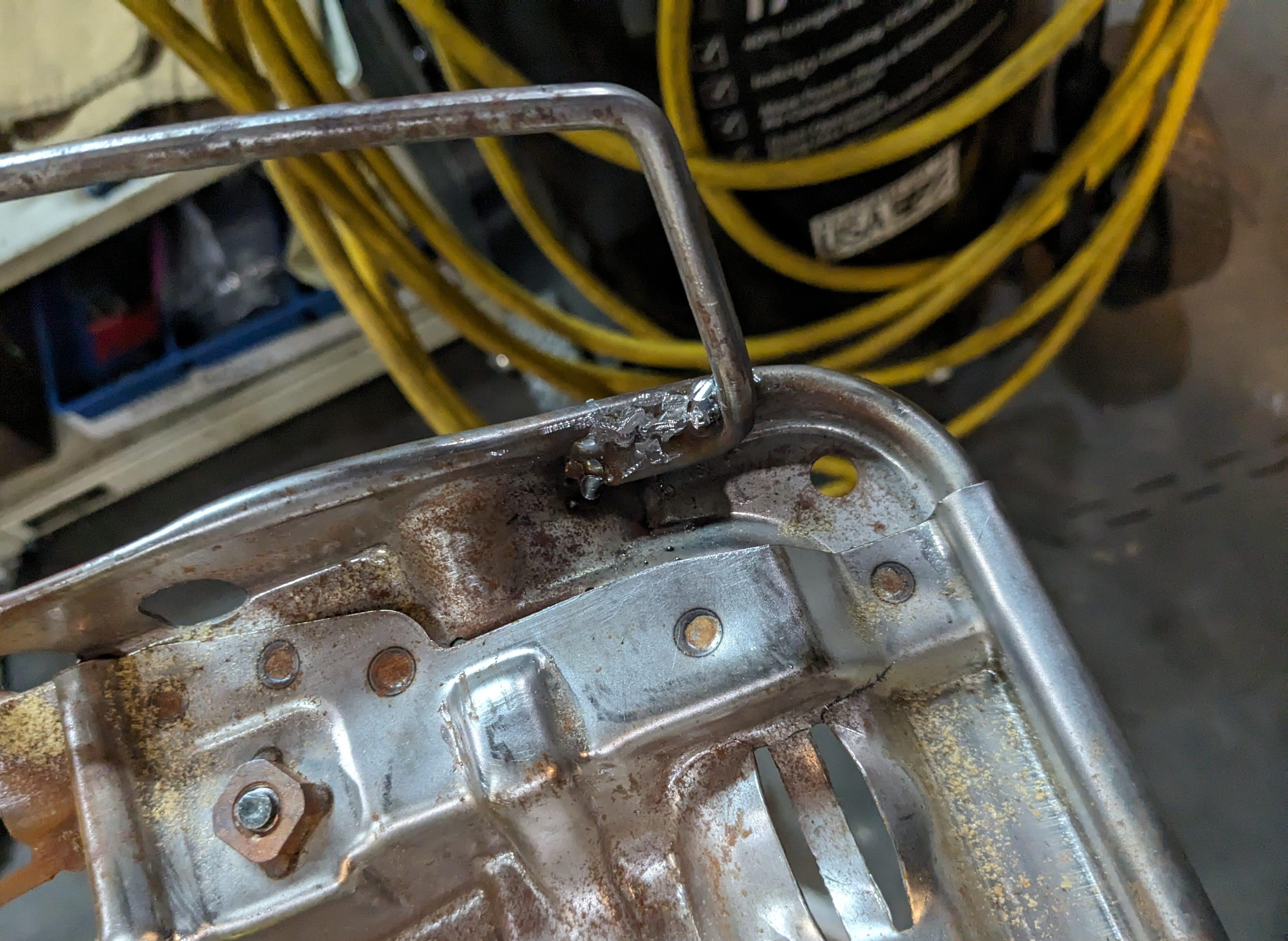

Took the drivers cushion apart. Foam is pretty screwed, not sure if I can actually repair this EDIT - found a good DS cushion complete with heater pad (mine is damaged) for reasonable (in the scheme of things) pricing. This one has cracks all over the place. Since it's the outer bolster, it's gonna look like crapola if it's not perfect. I'd have bought a pass side since they are always in better shape, but the DS has a bump out between the legs

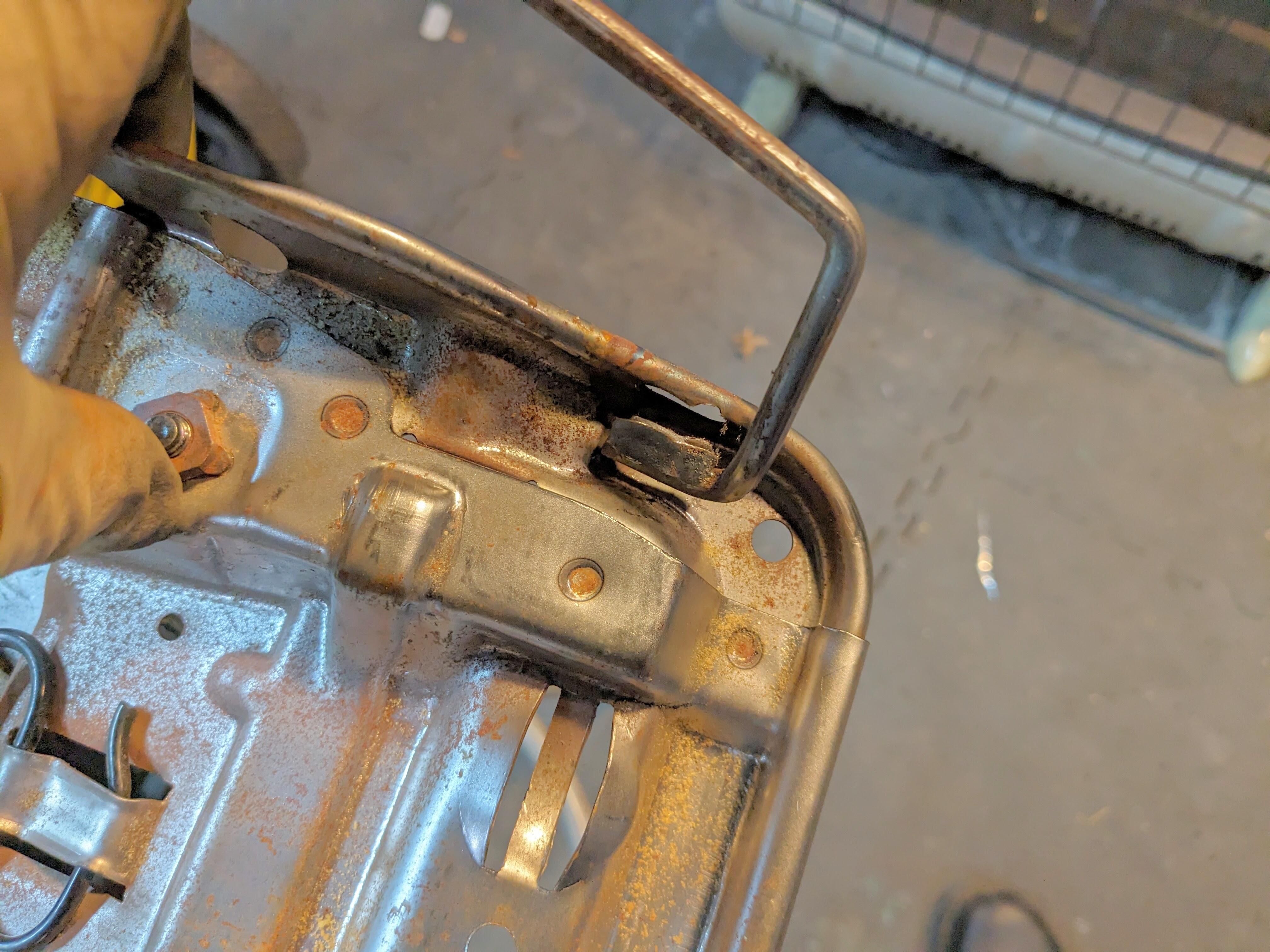

wire bolster weld was torn
Fixed that aspect - EDIT - looks like a stress crack below the spot weld ridge in line with the welded bar
Crack went pretty far.

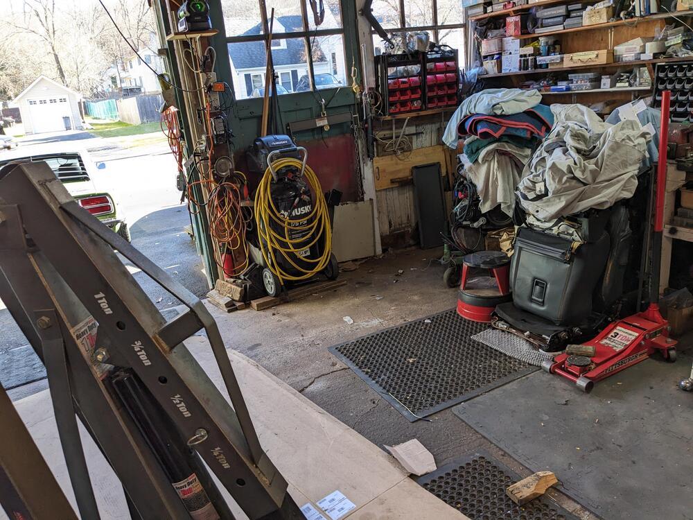

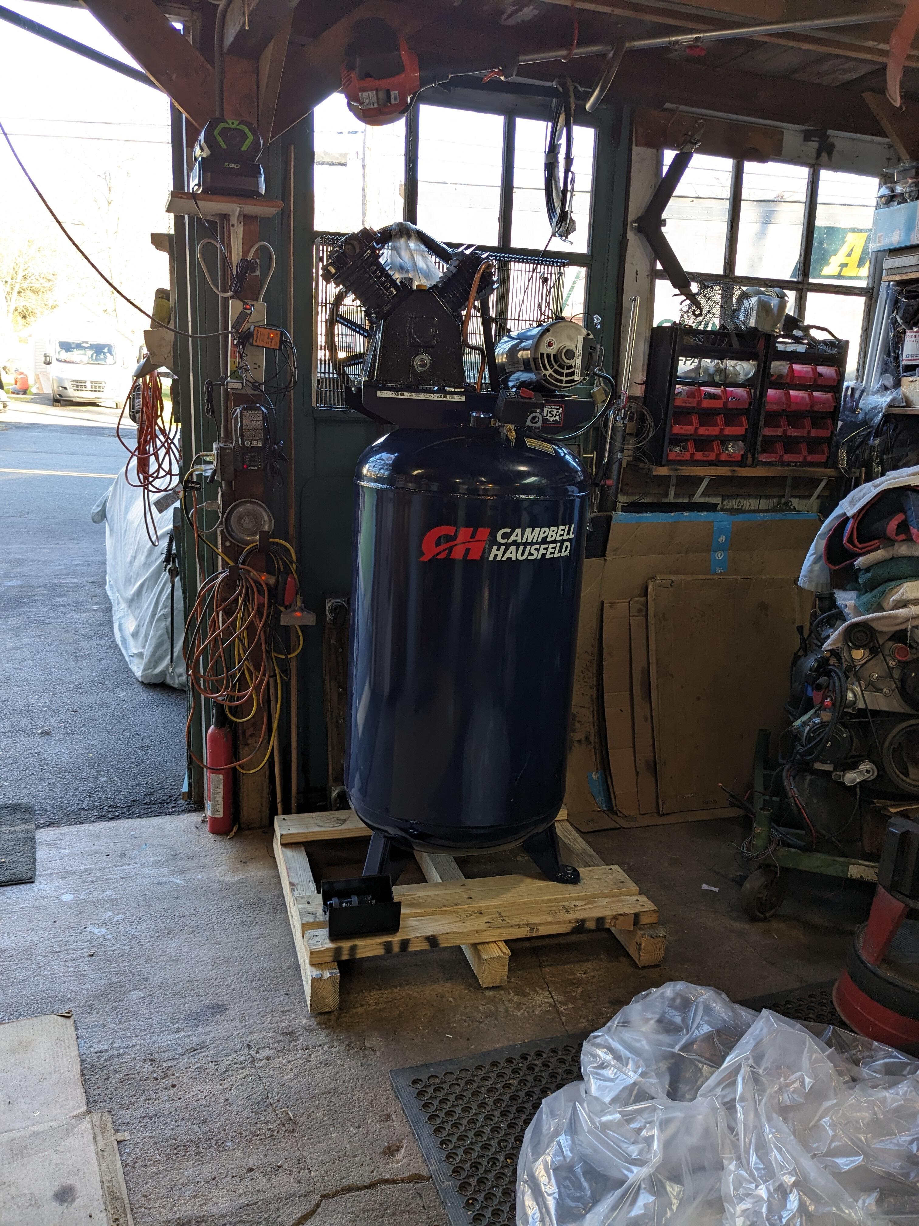

Been sided tracked on other stuff - I ordered a better sized compressor for the garage, so I can do my own paint again if I choose. Problem is, there is just too much stuff in my small garage as it is, so I had to make a platform on the back of the garage to house my engine hoist, press & other stuff that I don't need on a daily basis
should work out, eventually
