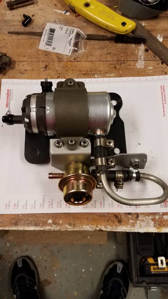

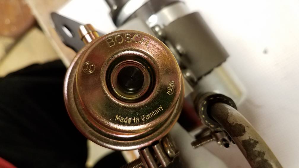

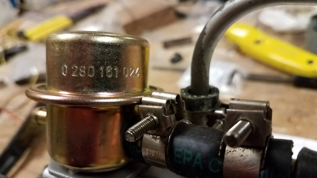

July 28, 20205 yr comment_603470 On 9/23/2018 at 7:19 PM, the_tool_man said: Update: After much searching, I ordered this one from eEuroParts: Somewhat disappointingly, it took them a week to ship it, and another four days in transit. But it fits perfectly. As you can see from the part number stamped on it, it's the same BMW part Consigli found two years ago (280161024). It just wasn't listed under the same part number. Maybe that's why they hadn't sold out yet. Just sharing in case it helps someone else. Sent from my [device_name] using http://Classic Zcar Club mobile the_tool_man Did this work for you? I found some available and would rather install this style than the one sold by Z Car Source Edited July 28, 20205 yr by UrbexExplorer added name Link to comment https://www.classiczcars.com/forums/topic/52880-official-280z-fuel-damper-thread/?&page=4#findComment-603470 Share on other sites More sharing options...
July 28, 20205 yr comment_603472 25 minutes ago, UrbexExplorer said: the_tool_man Did this work for you? I found some available and would rather install this style than the one sold by Z Car Source It physically fits. But I haven't finished with the fuel system rebuild and other stuff to get the car started. So I haven't driven the car with the damper installed as of now. Honestly, of all the things that could go wrong with my work, this is the one I'm concerned about the least. This is a simple part that is physically identical to the original one. Unless I happened to get a defective one, I'm pretty certain it will work. Link to comment https://www.classiczcars.com/forums/topic/52880-official-280z-fuel-damper-thread/?&page=4#findComment-603472 Share on other sites More sharing options...

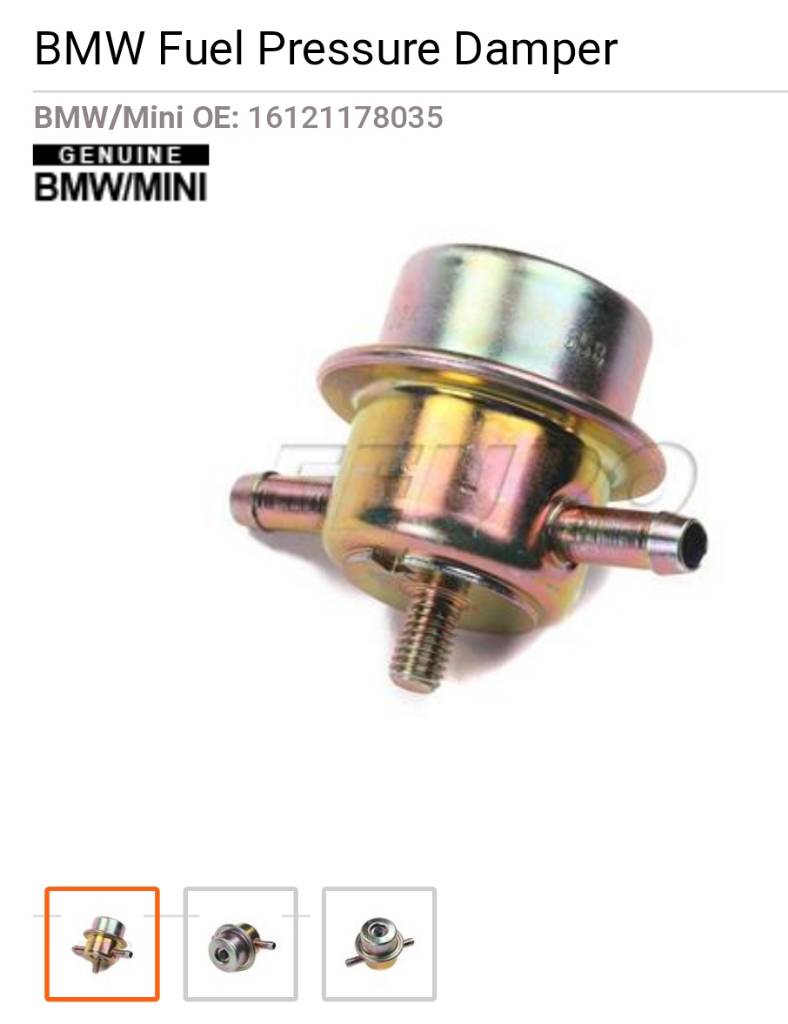

July 29, 20205 yr comment_603510 21 hours ago, the_tool_man said: It physically fits. But I haven't finished with the fuel system rebuild and other stuff to get the car started. So I haven't driven the car with the damper installed as of now. Honestly, of all the things that could go wrong with my work, this is the one I'm concerned about the least. This is a simple part that is physically identical to the original one. Unless I happened to get a defective one, I'm pretty certain it will work. Ha ha ok, I ordered one. I'll let you know what I find out Link to comment https://www.classiczcars.com/forums/topic/52880-official-280z-fuel-damper-thread/?&page=4#findComment-603510 Share on other sites More sharing options...
August 7, 20204 yr comment_603913 On 7/29/2020 at 12:45 PM, UrbexExplorer said: Ha ha ok, I ordered one. I'll let you know what I find out I just finished the installation and the good news, it works like a dream. I ordered mine from OEM BMW parts on Amazon.com. The BMW part# 16 12 1 178 035 & cost $83. Well worth it. Link to comment https://www.classiczcars.com/forums/topic/52880-official-280z-fuel-damper-thread/?&page=4#findComment-603913 Share on other sites More sharing options...
