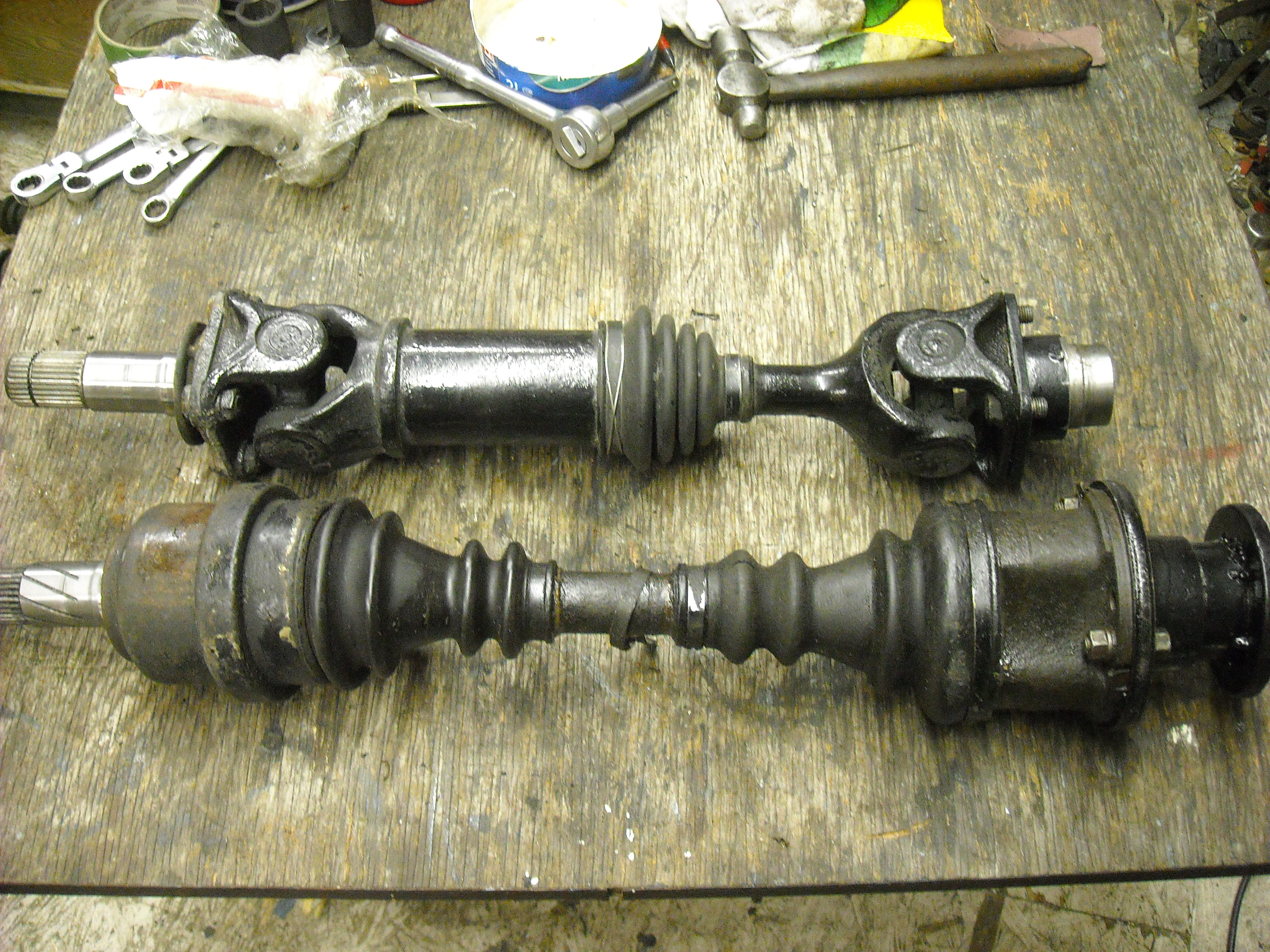

I picked up a pair of these half shafts to go with an r200 diff with an OBX.

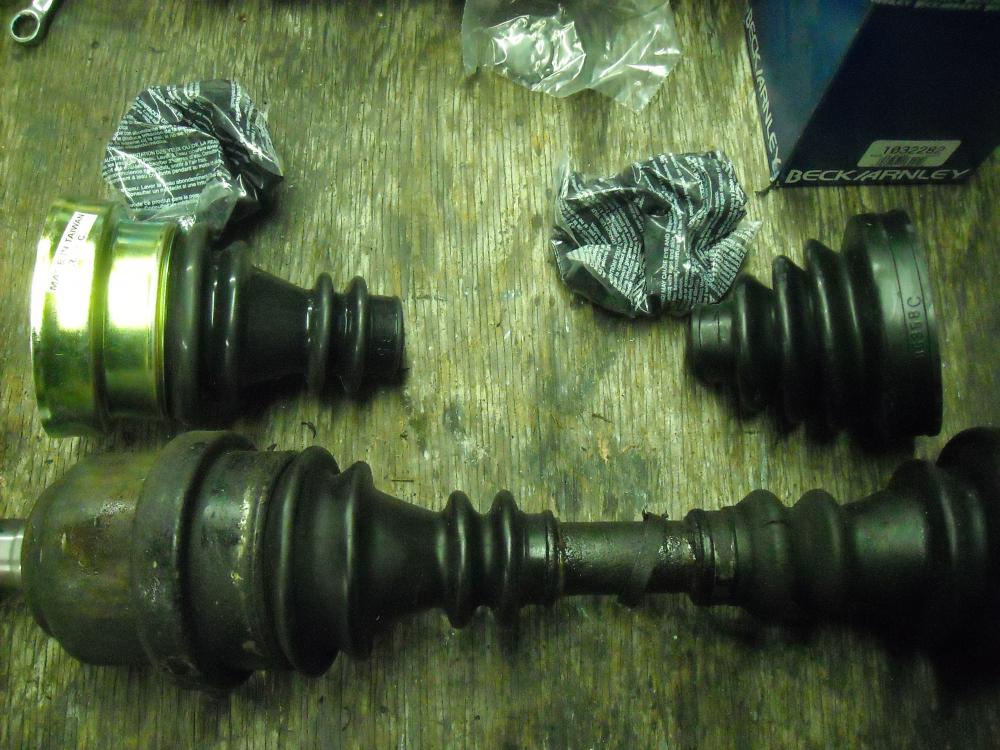

I have found a place that still carries the CV boots but wondering if this is a rebuild that can be done by a backyard mechanic?
How the heck do you get into the inner boot?

So, I finally got the rebuild kits from Summit, only took 2 months but at least they still exist.

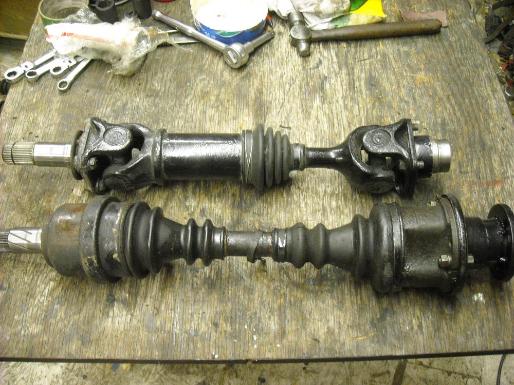

Did some measurements of the half shafts, 240z shock shaft and 280zxt shaft with modified companion flange,
D/S 240z shaft fully compressed, 21.5"
D/S 280zxt shaft fully compressed, 22"
P/S 240z shaft fully compressed, 22.250"
P/S 280zxt shaft fully compressed, 23"
So, 1/2" difference on D/S and 3/4" on P/S, doesn't sound too bad.

These are fascinating numbers because they open a very old can of worms.  Several people measured a bunch of 240Z and 280Z halfshafts and decided that they were all the same length.  You're showing a difference.  Are you sure that they were fully compressed.
The reason they measured is because when you put an R200 in  to a 240Z the halfshafts often bind at full compression.  So you're showing that your CV axles are longer than your stock u-joint axles, which should make the problem worse for you.  Maybe why Darrel went back to u-joints.
You've raised many questions.  I'll see if I can find the old info about halfshafts.  Many people even modified their u-joint half-shafts by cutting the ends off of the inner shaft.

I re-read your post and wonder where you're measuring from though.  The best measurement is from flange surface to flange surface with them squared-up to the shaft.  That gives a number to compare between shaft types.
