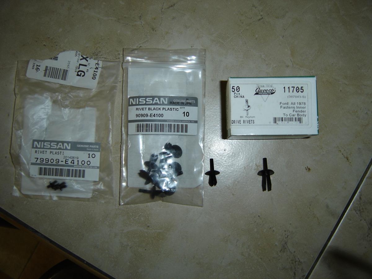

I can add my experiences with those and some information on replacements.
A #4 penny finish nail with the sharp end cut off works perfect for pushing the pins through.
Nissan still sales them for about $1 each, pack of 10 is $10 bucks.  They have the small ones too but those may be just on the rear finisher of the 240s.  Steve J found some on e-bay for the inner fender of a Ford.  I think 50 were only $15?  Anyway here they are, if you can't make out the part numbers let me know.  Oh yeah, they have black and white at Nissan parts department.

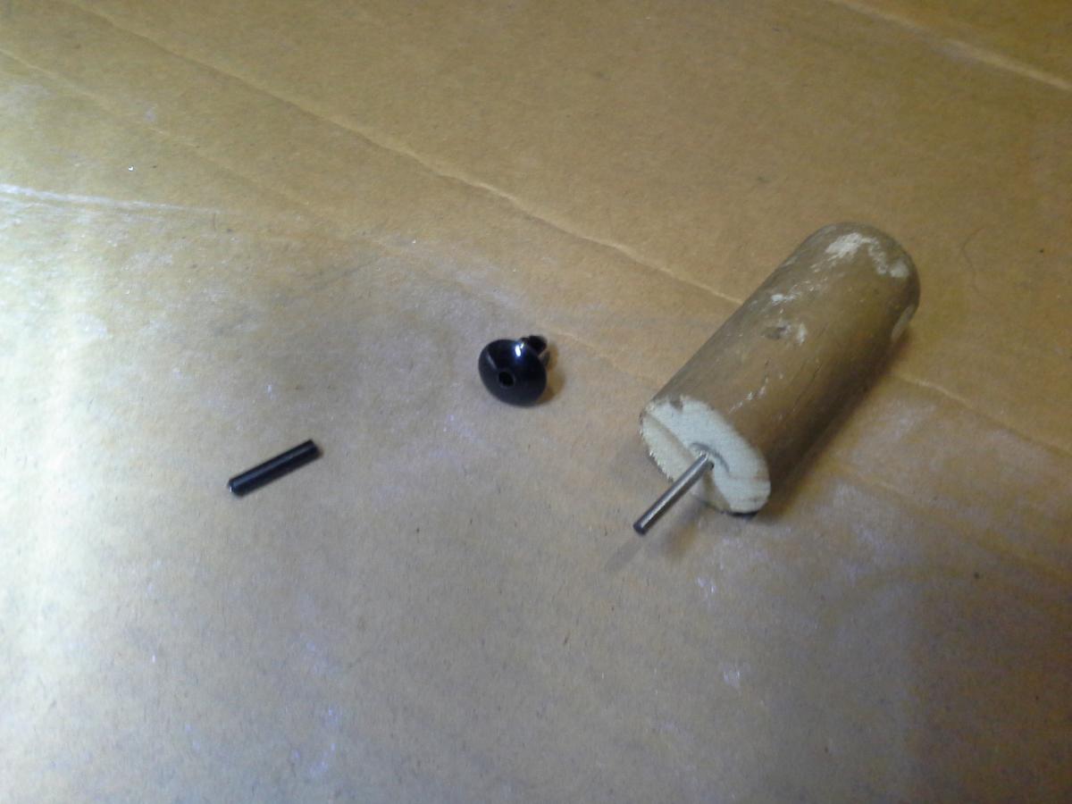

To get the rivets I made a simple tool by sawing off the end of a broom handle. Drilled into the end of it with a drill bit. The drill bit must be a smaller diameter than the locking pin. Use that to push the pin through. And Pop's advice with the vacuum cleaner works well.
You can find the nissan pin on e-bay of from nissan.
