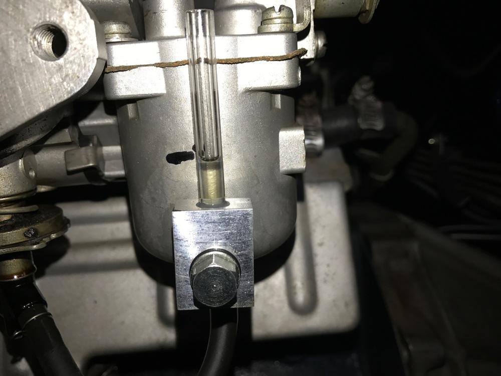

After fiddling with carbs floats for a couple of weeks I finally got them at 23mm.  Tuned the nozzles and ended up at 3 1/2 turns down.  My car finally runs like the other 240 I had, it pulls hard until the redline then I shift up.  So damn happy!

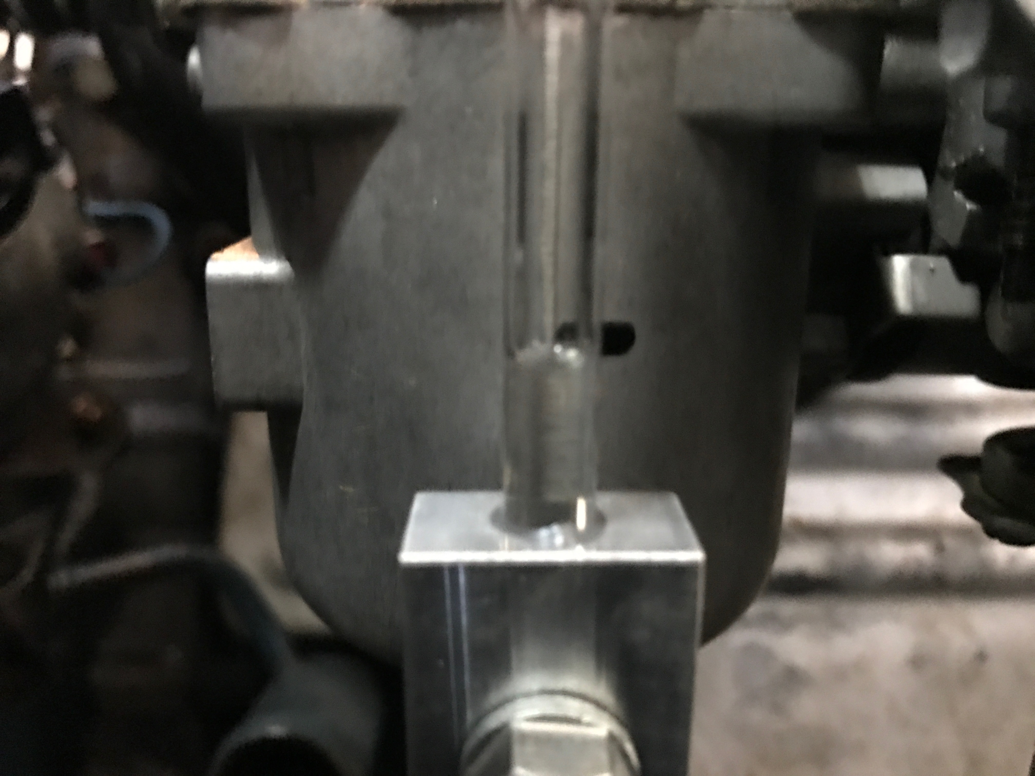

Front and rear float levels, almost 23mm. Also a video of it idling, pretty smooth. Unsure if it's charging so I had the battery maintainer on it. That's another issue to check.
