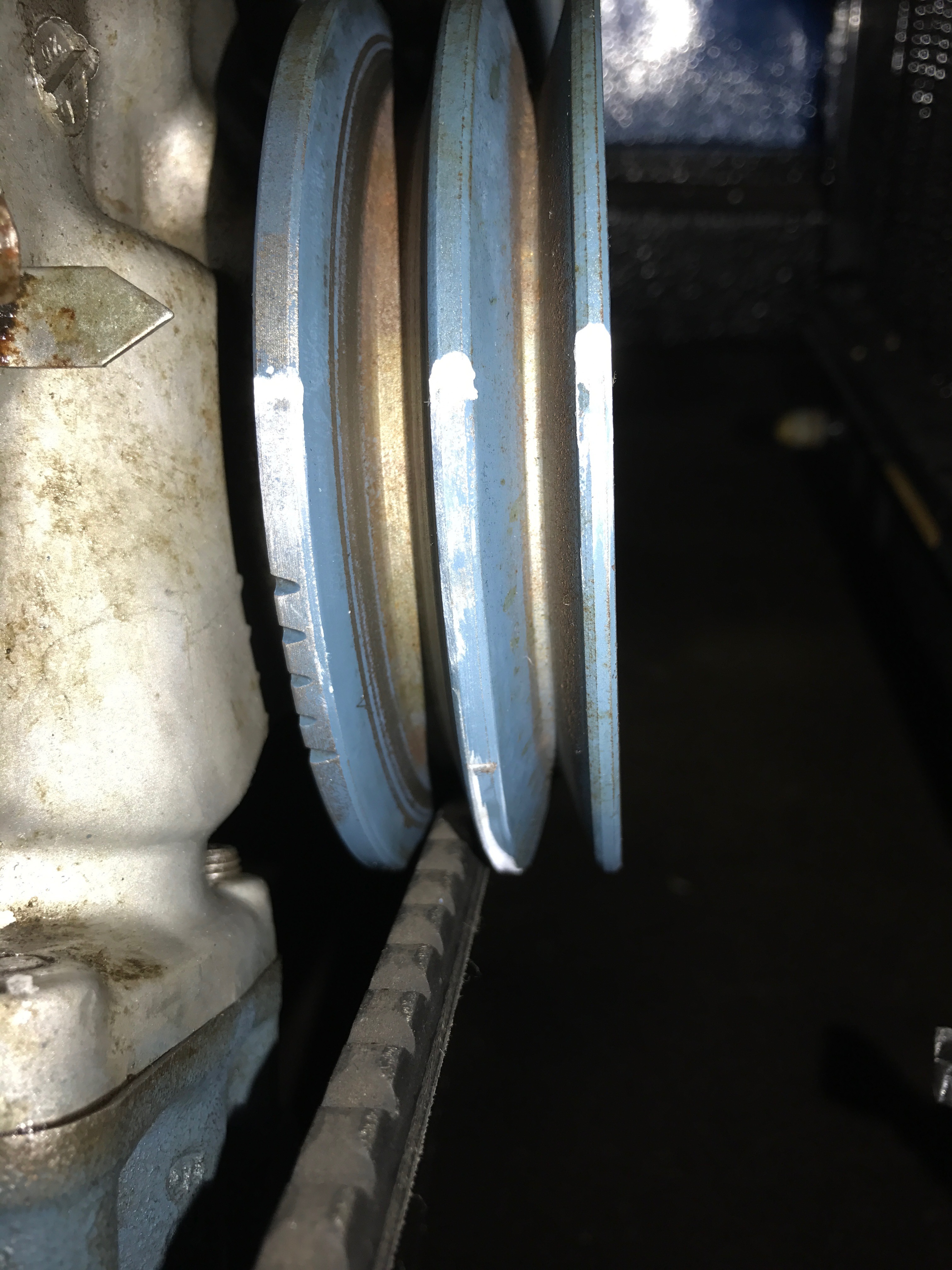

Ok some great progress today. I used a dial gauge(like a piston stop) inserted into cyl 1 spark plug hole to find absolute TDC. This worked great. But even before this I tried looking for the notch and groove on the cam plate and cam gear, no luck maybe I didn't look hard enough. Anyway it was cold so I continued, I got TDC on cyl 1, using the gauge on the compression stroke, the cam lobes were in the V orientation. I looked down on my damper and it was no where near 0 TDC, more like 50 degrees. I knew the issue right away, my damper was twisted at some point. So I used a white ink pen and made a mark to locate the new TDC mark. I also saw my distributor tang was at 12 not 11:25. Went on to the distributor locked it down and tried to start it, had to play with the distributor a little bit and then it ran. I was able to set the distributor where there was no backfiring and the engine revved easily. I then used the timing light which is useless as my damper has incorrect measurements. I noticed the timing was maybe at 10-15 degrees, this is a very rough estimate.  As of now i'm done with the timing, I will have to one weekend thoroughly go over the timing. I'll look for the notch and groove, check to see at what pin my cam gear was installed on, check crank to cam timing,  drop the oil pump and realign the distributor drive, install a new damper.

You might have a later model damper, with the timing tab on the passenger side, or vice versa.  You need to find out what's going on, because if your damper has spun then it's failing, and could cause more damage than just a misplaced timing mark when it lets go for good (bad).

That's the same as my early '72, pointer and pulley.  I think it would be worth the time figuring out if your timing chain sprocket lines up with the TDC markings.  I've got that stuff outside in a storage building and if I took each piece and took a picture of them separate then you would be able to figure it out.  I'll try and get that together for you asap but it's COLD!!! down here. :hello:
A quick way to look and see if it's close is look at the front of the pulley at TDC.  The notch on the crank's nose where the "key lock"? slides in should be pointed straight up.

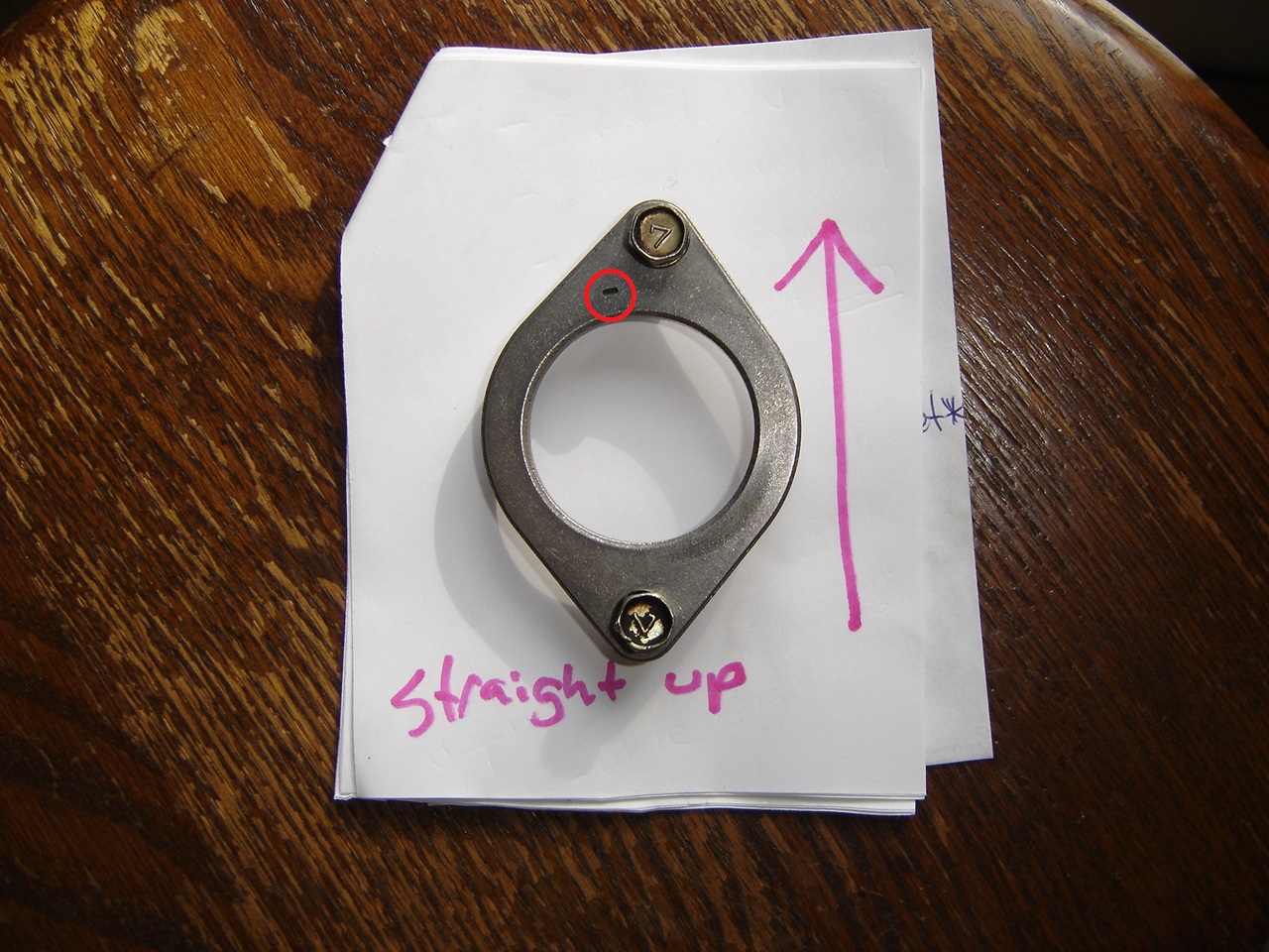

I found a thrust plate in my guest/junk room.  If you'll look through the hole on the cam sprocket, to the left you'll see a notch on the backside of the sprocket and in that notch you should see a small line to the left of the bolt on the thrust plate.
The whole reason I'm saying this is because it may be as easy as moving the cam sprocket to the next hole.  They have #1, #2 and #3 for adjusting out the chain stretch.

I'm thinking that the camshaft gear might be a aftermarket unit and the hub is larger than the OE which might cover the groove on the plate.
Edited by hatepotholez
I seem to recall that some aftermarket timing chain sprockets don't have notches.  It's the sprocket that has the notch.
