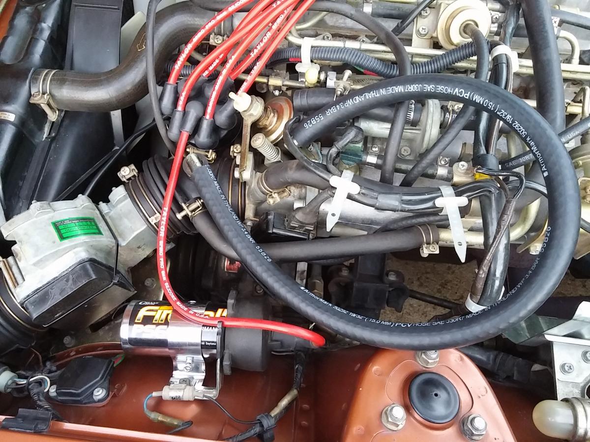

3.  Actually, I'm not sure what will happen with that setup.  Looks like the AAR is directly to air.  You'll get a lot of unfiltered air if it's open, might get the high RPM.  Or you'll get nothing if it's closed.  The loop on the throttle body to the big hose probably has no affect.
2.  Moved to front!~ - BUT.  Your picture shows that you completely bypassed the throttle blade.  The engine might go to sky-high RPM right away.  Don't start it like that.

Did that hose nipple on the big hose have a plug on it or was it open to air?  It should be plugged, I believe.
Anyway, I think that your problem is a simple one, don't do anything crazy like adjust the AFM or change timing or what you showed in that picture.
I looked in the FSM and see what you did in your picture and where your hose ends are.  Sorry, I couldn't tell what you were doing.  My mistake.  Haven't looked at AAR connections for a while.
All that "bypass" will do is confirm that your AAR was never opening or closing,  Not moving at all.  All you've done is open the passage permanently.  You'll be stuck with an idle that's too low, then gets right, or just right then gets too high.  Best to fix the AAR.

I'm not sure where your concern is coming from Zed Head. Right now it is isolated (air wise) from the engine. When the AAR is operating correctly during inital start up and is wide open, than it acts exactly like the hose I connected. The one end of the hose is connected before the throttle body to pick up the air, just like the AAR assembly does. Then istead of flowing through the assembly: the rubber hose--->metal pipe--->again to a short rubber hose---> to AAR valve---> to another short rubber hose--->to the emettal niple---> into the intake manifold PASSED the throttle body, I simply connected the two points prior to throttle body and passed the throttle body with just a continues hose. I was NOT going to drive it this way. I was going to ONLY start in the mornig to see how it would go. There is no signal to the ECU from the AAR at all, as you know.It's a dumb air passage with heating element to close it when things get warm.
"2.  Moved to front!~ - BUT.  Your picture shows that you completely bypassed the throttle blade.  The engine might go to sky-high RPM right away.  Don't start it like that." That's exactly what the AAR does, it bypasses the throttle blade. From the EFI Bible:
"You know that idle speed can be raised by simply bypassing throttle plate. During warm up, we do exactly that by using an air valve, called an Auxillary Air Regulator.(...)When the engine is cold the valve is open;so when the engine starts, ari can bypass the throttle plate and go through the valve."
I'm not sure what you mean by: "Did that hose nipple on the big hose have a plug on it or was it open to air?  It should be plugged, I believe."
Ha, you must have posted your last message as I was writing my response :) No biggy.  I will let you know tomorrow if bypassing AAR helped to start the engine right up.
