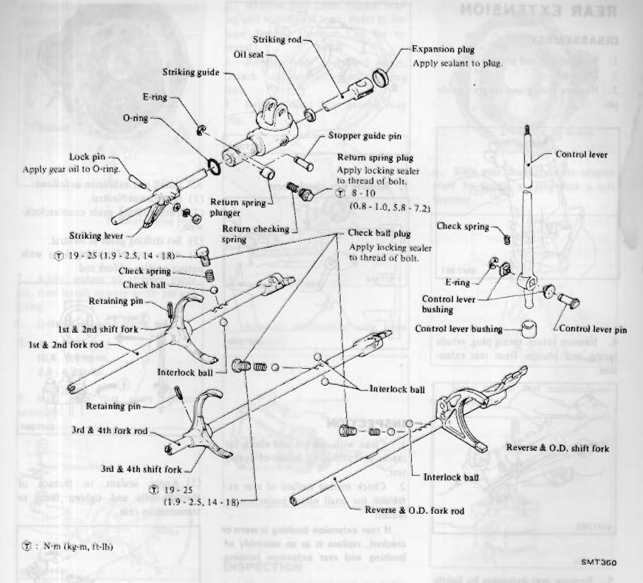

came with an engine that i re-built, was said to be fine, so all i did was replace the front & rear seals before installing. noticed 2 things during install:
1 - the return spring plug was removed and in a bag of misc parts along with the shift lever pin & boot. the plunger was missing, so i poached the one from my '78 4sp along with the matching springs & plug.
2 - when i checked shifting (before putting in boot cover) the striking rod pulled out exposing the o-ring seal. the stopper guide pin was out (i found it in the aforementioned bag of goodies). i rotated it back/forth a bit until i could jigger it back in, then installed the pin & e-ring.

Most people don't even know those plugs and springs, return or check, even exist, and only find out after they have problems and get on the forums.  The fact that yours was out is a bad sign.  Along with the stopper guide pin.  Nobody ever removes those  unless they're trying to fix something.  They are the first two steps of transmission disassembly.

You mentioned exposing the o-ring and you also mentioned a shifter lever pin, but was the stopper guide pin in place? It stops the striking guide from coming out. The striking guide should rotate and return to centre by the return plunger on the left side. It shouldn't move back and forward. Sounds like your stopper pin is missing or damaged in some way.
I have posted a this in a couple of threads. I would start by replacing all the check balls and springs and return checker plunger and spring. You can't change the interlocks without dismantling, so don't worry about ordering them.
While you are at it. Buy all the shifter bushes (2x side bushes and the end cup). All this stuff will set you back $20 at your local Nissan dealer.
Its all "do"able without dropping the transmission. The top check ball and spring are a pita. I bent a ring spanner to get to it easier. You will need to remove the console to get to the shifter.
I know some people will say that there could be wear inside the transmission. True, but this is often enough to return the system within spec and eliviate the problem.
Parts list
2x Shift lever side bushes.
2x Shift lever lower (cup) bush
1x Shifter lever pin (Optional)
3x Check balls
3x Check springs
1x Set Return checker springs
1x Return checker plunger (Optional)
Don't bother ordering the o-ring or the little oil seal on the striking rod. You need to dismantle the shifter assemble/transmission to get to them and I don't think you need to do that at this stage.
There are more things that can cause shifting problems, but your description of the state it was in when you got it, I would start with these easy/cheap fixes.
Another thing is to use a sealant on the the spring caps to prevent them leaking and coming loose. Doesn't hurt to use silicone sealant around the stopper guide pin. Its on the transmission side of the o-ring an can leak a little oil.
An hours work and your should done. An aircraft technician managed it :). Zed will understand that LOL.

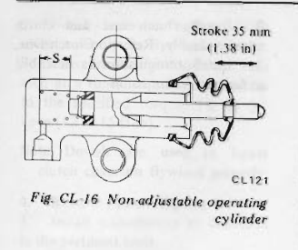

On the throw - the later slave cylinders automatically adjust to max throw since its hydraulic.  The fork can only push it back so far, to its new starting point.  If the rod was too short the hydraulics would just push the cylinder out of the bore.  The rubber boot is the only thing holding the cylinder in the bore with the newer slave cylinders.  I don't know how the old ones are designed.  Loss of potential throw would be at the MC rod and pedal adjustment.  Pretty sure that's right, from my memory of past clutch problems.
Posted a picture of a 1978 nonadjustable.
post-19298-0-17727700-1435956568_thumb.p
