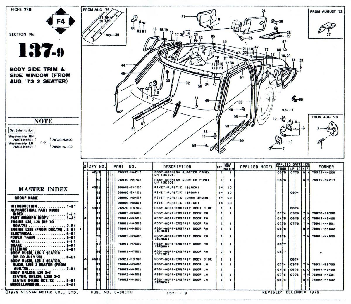

Presuming this is for a 280Z coupe, rather than a 2+2, I think this is the relevant fiche page (item #44), unless you mean the weatherstripping around the door sash itself. The attached fiche illustrates a couple of part numbers (assuming the weatherstripping is black), from 08/76 onwards, which can be used interchangeably. From the scan these look like 76801-N4600 and 76803-N3400.

Thank you so much, jerz!  That definitely clears up that doubt. I will immediately purchase the OEM seal from Courtesy Nissan.
Thanks so much, jerz! That information definitely clears up any doubts: 77 and 78 280Z coupe door seals are the interchangeable.
I will buy that seal at Courtesy Nissan right away.
