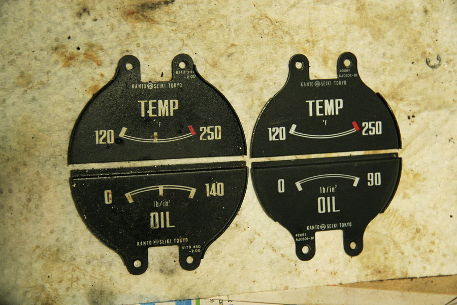

Considering the sensor was simply modified to use a weaker spring, is it possible that the only difference in the gauges was the 90 painted on the face in lieu of 140?
If this was the case, we could simply interpolate readings using a 0-90 scale.
Does anyone have both set of gauges to make the comparison?
Here is a picture showing the two gauge faces side by side
post-7818-0-66887900-1432576636_thumb.jp

I have a dash from a later series one parts car S/N HLS30 16531, it has the 90 psi gauge.  I have had the dash for over 20 years but don't know the full history, I've wondered if this was a case where the 140 psi gauge was replaced.
It would be interesting see the actual reading differences for both gauges with a 6 bar sending unit, this would show if interpolated readings could be used.
