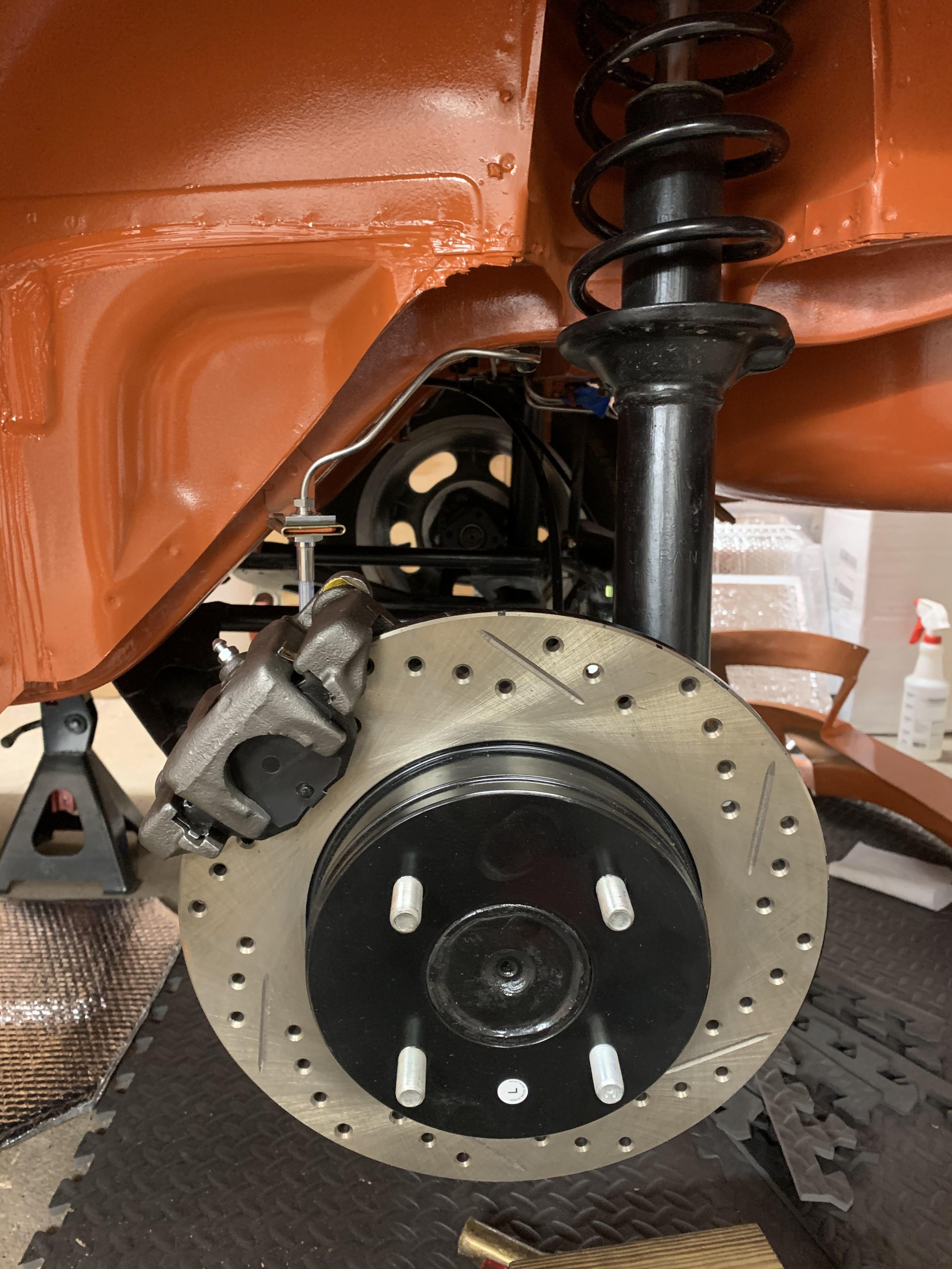

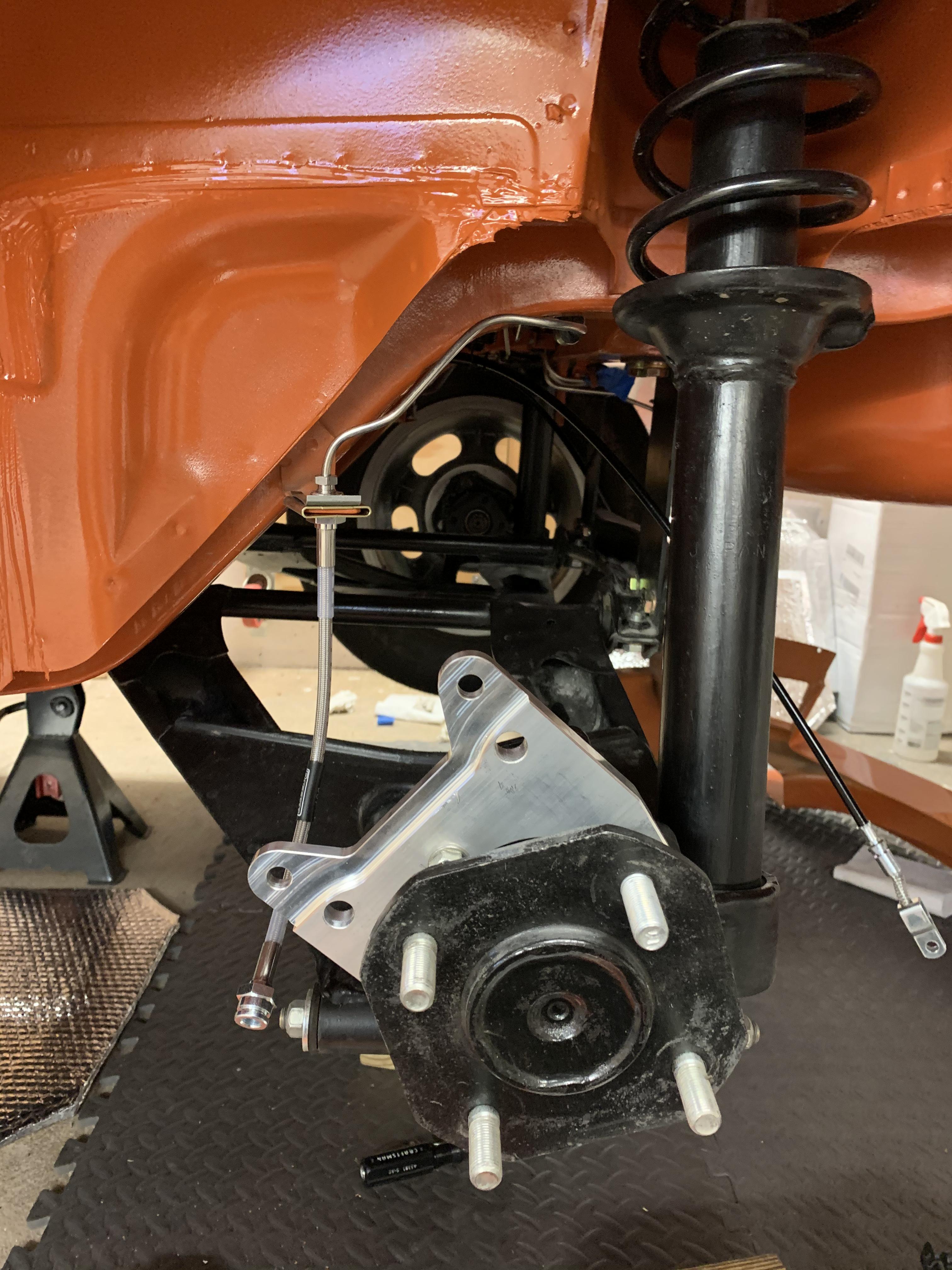

December 22, 20204 yr Author comment_613043 Rear left disc progress: Edited December 23, 20204 yr by Matthew Abate Link to comment https://www.classiczcars.com/forums/topic/51541-1973-rebuild/?&page=79#findComment-613043 Share on other sites More sharing options...
December 22, 20204 yr Author comment_613046 Well, I got the caliper on and then realized I don’t have the e-brake brackets. Cant find them anywhere, and I ordered the kit so long ago there’s no way I’m getting them to send free ones, so I had to order another set. And of course the balancing weights on the inside of the rim are hitting the caliper. Edited December 25, 20204 yr by Matthew Abate Link to comment https://www.classiczcars.com/forums/topic/51541-1973-rebuild/?&page=79#findComment-613046 Share on other sites More sharing options...

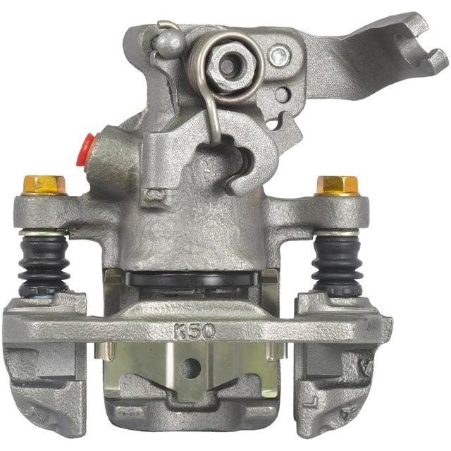

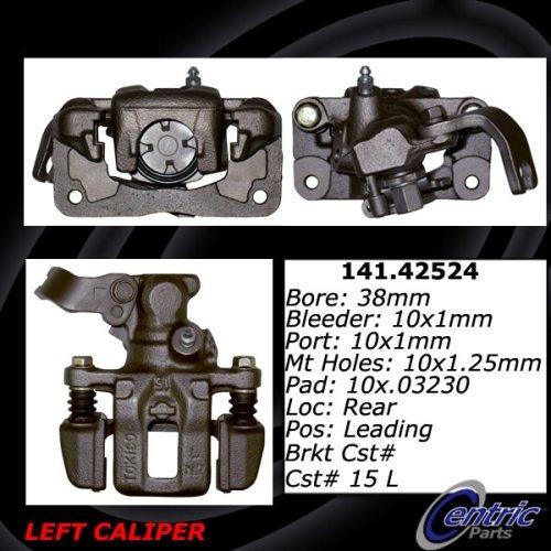

December 29, 20204 yr Author comment_613453 Looks like all that is available is the 240sx version or the ones from Silvermine. Anyone got any tips on how to get the e-brake cable guides for the maxima calipers? Edited December 29, 20204 yr by Matthew Abate Link to comment https://www.classiczcars.com/forums/topic/51541-1973-rebuild/?&page=79#findComment-613453 Share on other sites More sharing options...
December 29, 20204 yr comment_613459 Picture? Link to comment https://www.classiczcars.com/forums/topic/51541-1973-rebuild/?&page=79#findComment-613459 Share on other sites More sharing options...

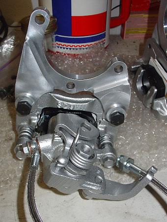

December 29, 20204 yr Author comment_613461 You can see one curving up and holding a cable on the bottom right corner of the image above. Here’s another one: Note that it puts the cable in line with the hook. Original Nissan PNs are 44196-08E12 and 44195-08E12. One more: Edited December 29, 20204 yr by Matthew Abate Link to comment https://www.classiczcars.com/forums/topic/51541-1973-rebuild/?&page=79#findComment-613461 Share on other sites More sharing options...
December 29, 20204 yr comment_613473 So you are missing the thick bent brackets. Do you have a torch and a way to shape them? I can probably provide dimensions Link to comment https://www.classiczcars.com/forums/topic/51541-1973-rebuild/?&page=79#findComment-613473 Share on other sites More sharing options...
December 29, 20204 yr Author comment_613475 Yes, the curved piece with the forked end that the cable goes in and is held down by a spring clip. I have a torch, a vice with an anvil top, and various hammers. I could probably make the if I have to, but am trying to find factory parts before I go there. Edited December 29, 20204 yr by Matthew Abate Link to comment https://www.classiczcars.com/forums/topic/51541-1973-rebuild/?&page=79#findComment-613475 Share on other sites More sharing options...
December 29, 20204 yr comment_613477 I did that same rear brake swap about 7 yrs ago and those curved parking brake brackets were very hard to source then, you may have to make them. Link to comment https://www.classiczcars.com/forums/topic/51541-1973-rebuild/?&page=79#findComment-613477 Share on other sites More sharing options...
December 29, 20204 yr Author comment_613480 19 hours ago, grannyknot said: I did that same rear brake swap about 7 yrs ago and those curved parking brake brackets were very hard to source then, you may have to make them. Yeah, I have a feeling that’s gonna happen. However, I think the 84-86 300zx also used this caliper, so I am going to call some yards before I go down that route. Also, MSA has a kit with these. I am going to try to get them to sell me just the brackets. Long shot, but worth it. Edited December 30, 20204 yr by Matthew Abate Link to comment https://www.classiczcars.com/forums/topic/51541-1973-rebuild/?&page=79#findComment-613480 Share on other sites More sharing options...

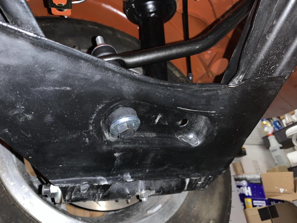

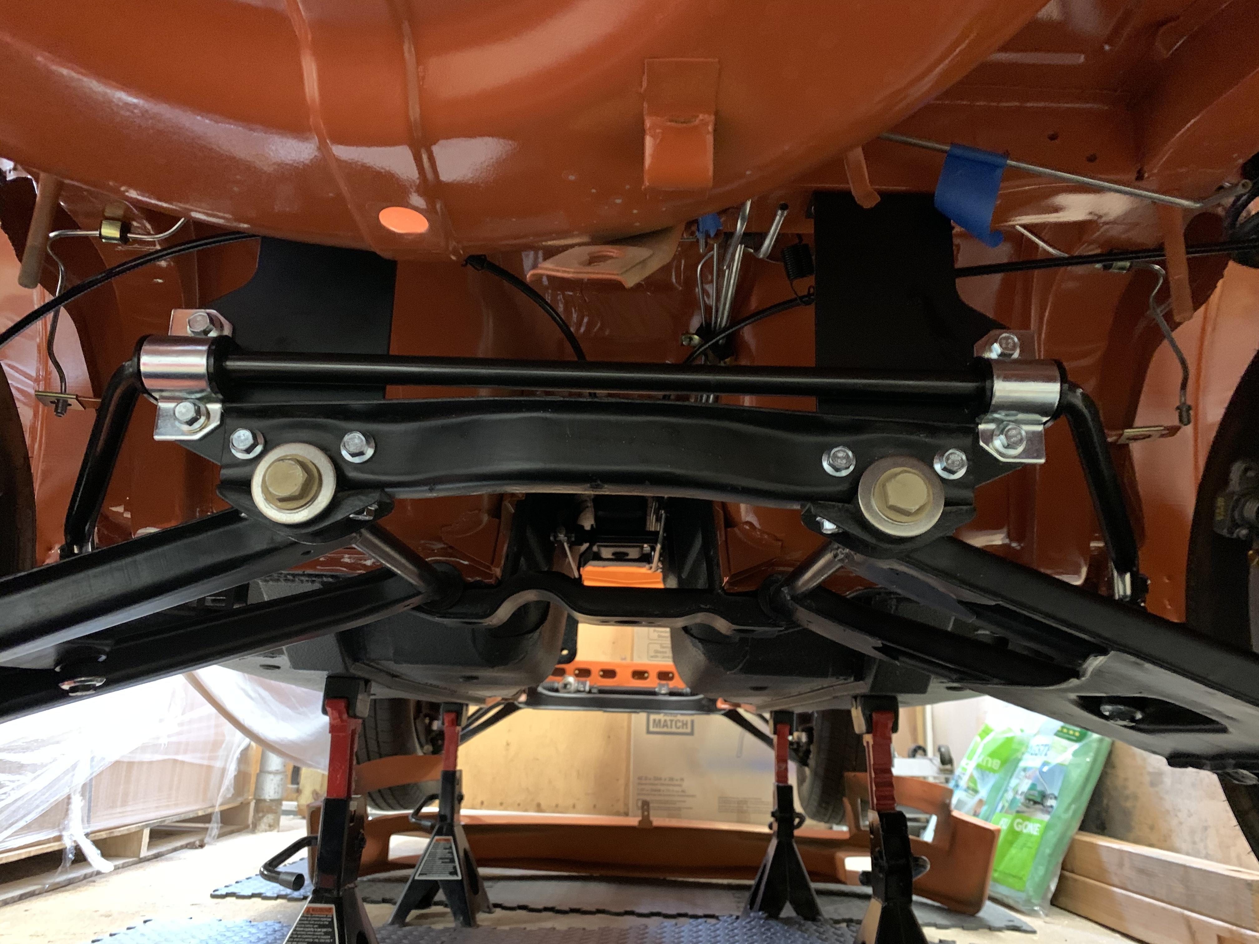

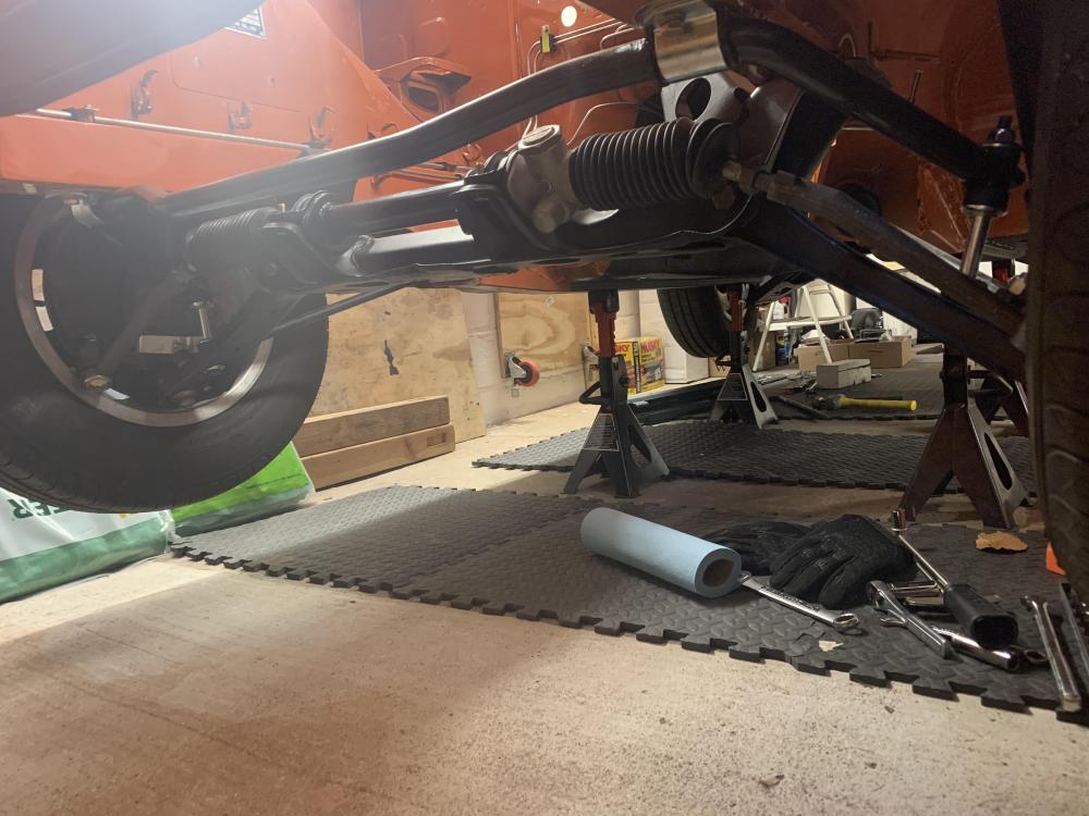

January 12, 20214 yr Author comment_614282 ST Suspension front and rear sway bars are in: One thing I thought was odd... the instructions said to leave a 1/16th gap on one of the bracket bolts where they mount to the body. I wrote the manufacturer and asked for clarification. Right now they are torqued to the specs in the FSM, but they do look a tad over compressed. Edited January 12, 20214 yr by Matthew Abate Link to comment https://www.classiczcars.com/forums/topic/51541-1973-rebuild/?&page=79#findComment-614282 Share on other sites More sharing options...
January 12, 20214 yr comment_614297 12 hours ago, Matthew Abate said: One thing I thought was odd... the instructions said to leave a 1/16th gap on one of the bracket bolts where they mount to the body. The rear sway bar doesn't mount to the body so could they be referring to the front sway bar? Quite often the front sway bar will actually hit the body frame rail when in full compression unless you include a 1/16-1/8" spacer above the bushing. Link to comment https://www.classiczcars.com/forums/topic/51541-1973-rebuild/?&page=79#findComment-614297 Share on other sites More sharing options...
January 12, 20214 yr Author comment_614298 I was speaking generally because I was too lazy to type it out on my phone. 🤣 I’m not referring to the oval shaped washer that goes between the front sway bar and the frame. The instructions say to leave a 1/16th “ gap on both the front and the back brackets. Literally, an air gap. This seems like a bad idea. I can see maybe putting washer in there, but then why not just make the bracket the right size? Edited January 12, 20214 yr by Matthew Abate Link to comment https://www.classiczcars.com/forums/topic/51541-1973-rebuild/?&page=79#findComment-614298 Share on other sites More sharing options...
