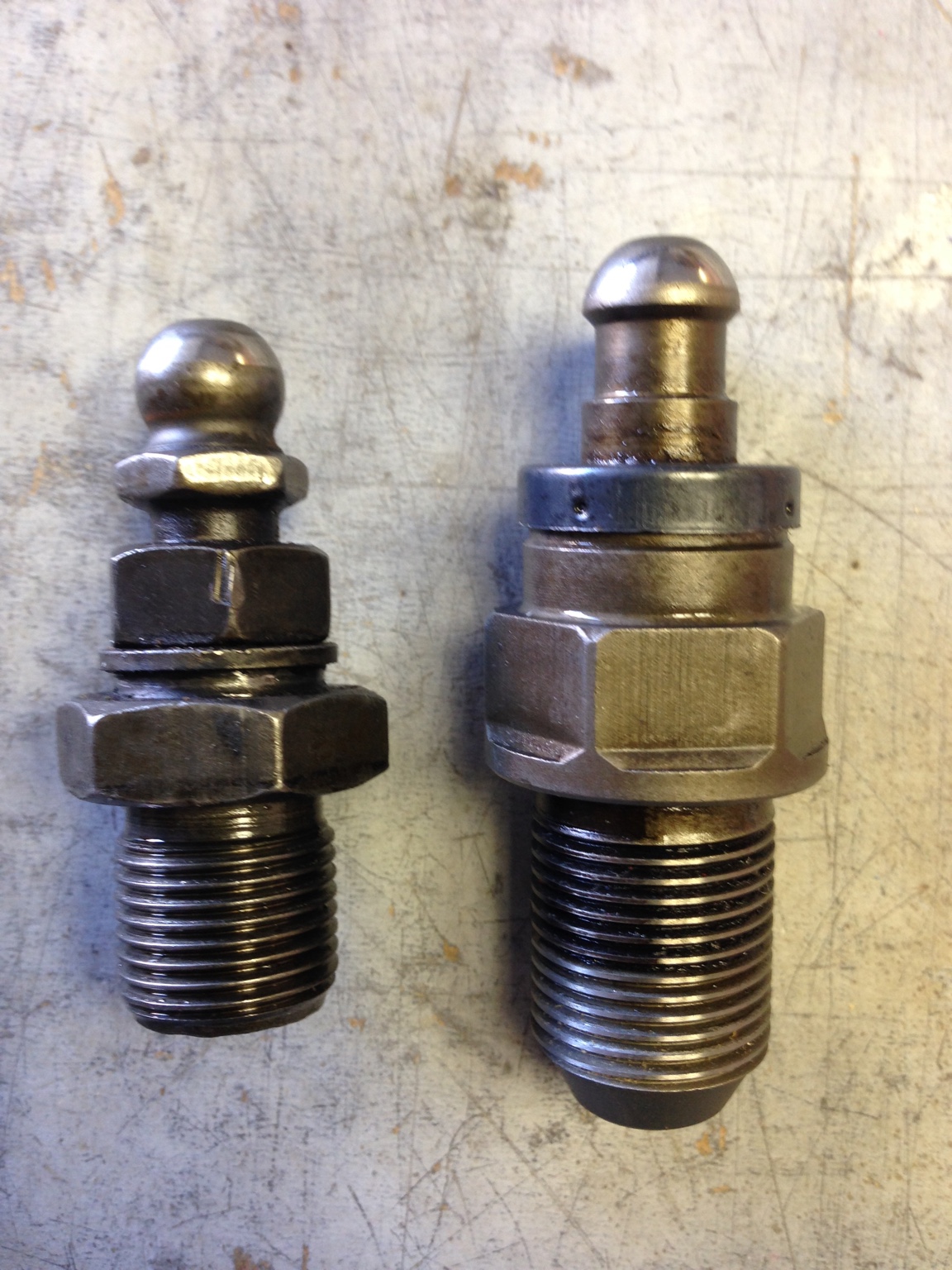

The long and short of it is that we rounded the hex on three of our mechanical lifters when we stripped our p90 head, so I'm looking for replacements. I and trying to figure out WTF is going on with the parts on courtesy Nissan's site because they've been closed. I'll call them tomorrow to see if this is in fact the complete lifter or if it's just the skinny threaded part that pushes the rocker arm.

Aaahhh...you fell in to the "lifter" trap.  People have been mis-identifying the hydraulic pivots as lifters because they come from pushrod valve train world, where the common US-designed engine has hydraulic lifters.  They're not lifters.  I wouldn't use the words lifter or tappet at all when talking about these engines.  Nissan calls it a pivot, and the adjustable ones they call "oil pivots":  They don't move, therefore not lifters,  Not lifting.

You can see they have the full spread of numbers for the entire valve mechanism, so I think I'm good on that front. It's the Rocker Pivot Nut-lock (13235-U0100) that I need to replace.

Edit: looks like this fixed my immediate problem. Courtesy and Zcardepot both seem to have the screw, the nut, and the spring in stock. Let me know if you guys have any pro tips I should consider, but I'll probably buy a full set of all three plus lash pads once I talk to them.
Update: it's not the rocker pivot nut lock. That's just the jam nut that keeps the pivot in place. I need the cylindrical base that the pivot threads into and the jam nut pressed against, which is the pivot bushing (13215-A8600) and NLA.
The one on the left is the assembly in talking about:
