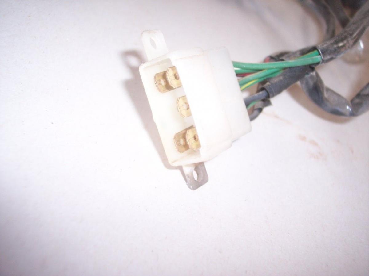

Here is a photo for you.  I think they are the same connector  for both. There are some notches in the corners to orient the connector.  I'd like two of these.

Are the two mounting ears necessary? I (thankfully?) have never yet had to mess with the the tail lamps.
Anyway, if the two mounting ears aren't important, it looks like Cycle Terminal has something close.

I have used Vintage Connections. Looks like the following will work- except for no mounts.
MP6N Non-Latching Set
6-pin 6.3mm (1/4") spade-based non-latching M/F Connector Shell Pair, with 7 each 18-16 AWG, M63/F63 crimp terminals. White Nylon. Directly replaces original Hitachi shells from the 1960s-1980s.
http://vintageconnections.com/
Click on the Prices button and scroll down to the MP6N item.

I have not noticed any ears on the tail lamp connectors, but I think the ones for the gauges have them.
Yes, I think those will be compatible, and I could even use one for the new center console wiring.

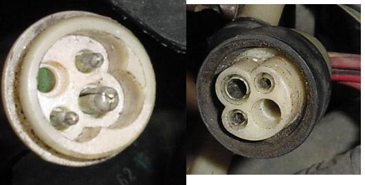

Thanks for the  help.  If only you could get the 3-pin round connectors  for the headlamps.  Then you could make a truly 'plug-and-play' relay setup for the headlamps, instead of sacrificing the factory headlamp connectors.

No they don't. The later roundish style headlight connectors are actually FOUR cavity connector shells which only have three positions populated. And to make matters worse, two of the cavities accept a smaller crimp on contact, while the other two accept a larger contact. Cycle terminal does not offer that style, and I've not found it anywhere.
The only thing I HAVE found (new) for sale is the smaller of the two crimp contacts. I got a couple spares of each (male and female) from Cycle Terminal a little while ago, but I've not turned up a source for the larger contact. I did buy some easily available larger contacts from Digi-key and while they might work in a pinch, they're not quite right. I can get them to click in and hold into the old contact shells, but they're not as good a fit as the original Yazaki contacts.

Yeah, I think you're right.  What would you call that?  It's not the usual 4-pin connector, like the one for the vacuum solenoids.

 I was thinking that  I might have to go to the JY to snip some headlamp connectors from a modern car...  Then I could even get a set of spares, or order spares.

Cool Got any pics of what you nabbed at the yard? Your intention is to swap them out for the original roundish headlight connectors?
I toyed with the idea of getting rid of those roundish connectors completely and hardwiring the headlight connector pigtails right to the main harness. I was trying to minimize voltage drop and power losses in my headlight circuit and any connector is a source of some drop. The fewer connectors the better. In the end I kept them, but can get rid of them in the future if I change my mind.
