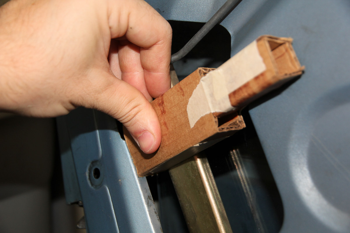

June 22, 20178 yr comment_523627 5 hours ago, David F said: What about mounting the actuator in the bottom of the door or away from the window track and using a bellcrank to redirect the linear motion as needed. excellent idea! take that idea 1 step forward, any reason something like the heater control cables wouldnt work? Link to comment https://www.classiczcars.com/forums/topic/51367-project-boondoggle-or-so-i-went-and-bought-a-z/?&page=34#findComment-523627 Share on other sites More sharing options...

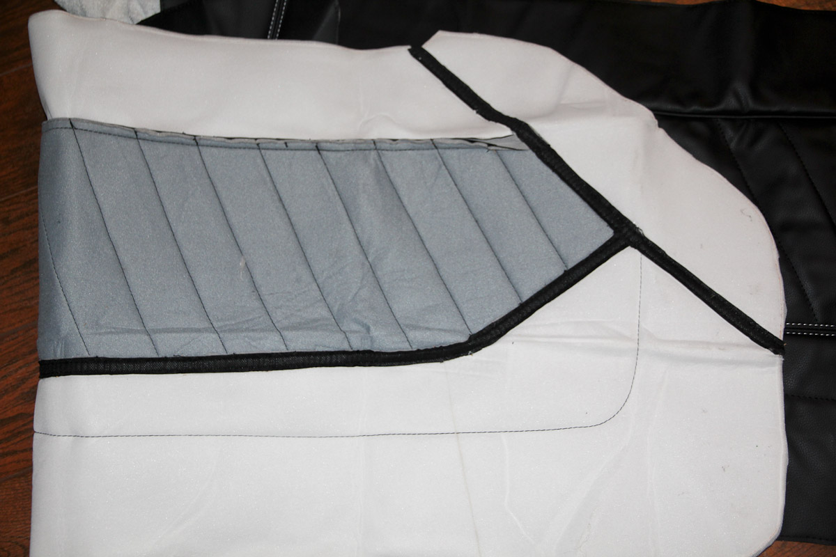

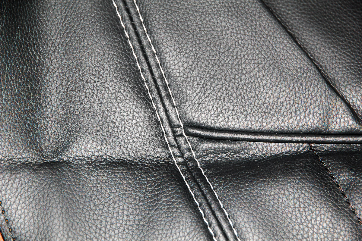

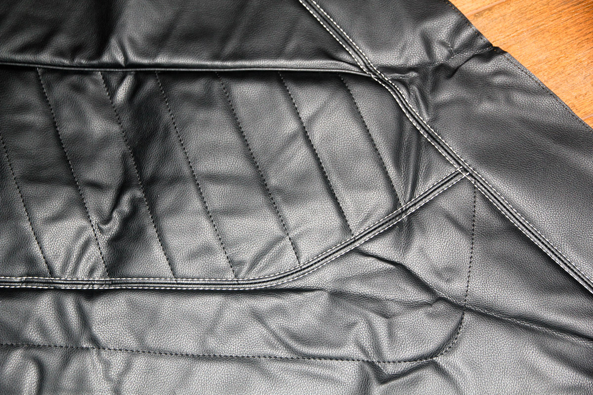

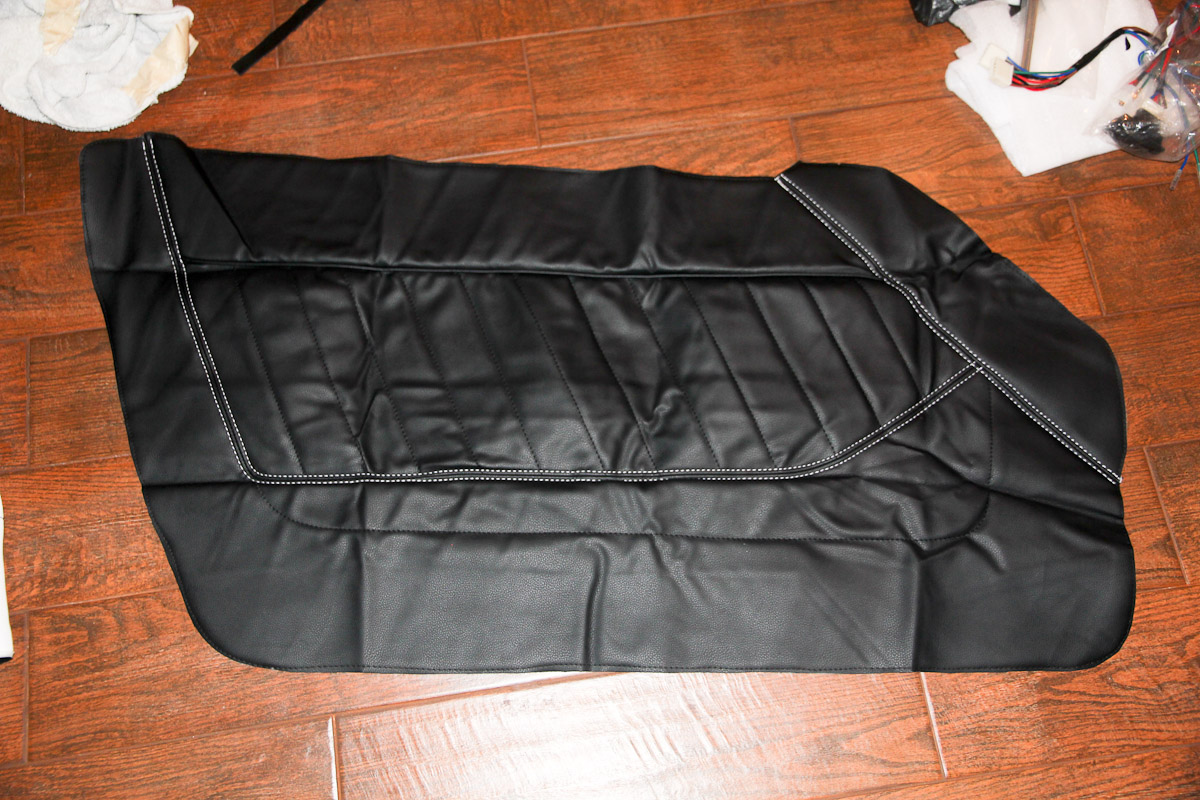

June 23, 20178 yr Author comment_523804 These just arrived today. I asked for the same stitching that I have on my seat covers (white on the French seams, black on the single-row stitching), which is exactly what I got. Just looking at them on the floor, I'm super happy with these. Link to comment https://www.classiczcars.com/forums/topic/51367-project-boondoggle-or-so-i-went-and-bought-a-z/?&page=34#findComment-523804 Share on other sites More sharing options...
June 24, 20178 yr comment_523849 15 hours ago, charliekwin said: These just arrived today. I asked for the same stitching that I have on my seat covers (white on the French seams, black on the single-row stitching), which is exactly what I got. Just looking at them on the floor, I'm super happy with these. Those look really nice. No missed stitches, very clean. Might seem like a crazy question but, do they actually smell like leather? Link to comment https://www.classiczcars.com/forums/topic/51367-project-boondoggle-or-so-i-went-and-bought-a-z/?&page=34#findComment-523849 Share on other sites More sharing options...
June 24, 20178 yr Author comment_523867 No, they don't smell like anything. Interior Innovations sells a set made from genuine leather for $260 shipped ($180 shipped for vinyl). I think one of the members here got leather seat covers from them and gave them high marks. Obviously these aren't original, but I think they'll be a nice upgrade that's still consistent with the style of the originals. Link to comment https://www.classiczcars.com/forums/topic/51367-project-boondoggle-or-so-i-went-and-bought-a-z/?&page=34#findComment-523867 Share on other sites More sharing options...
June 25, 20178 yr comment_523988 22 hours ago, charliekwin said: No, they don't smell like anything. Interior Innovations sells a set made from genuine leather for $260 shipped ($180 shipped for vinyl). I think one of the members here got leather seat covers from them and gave them high marks. Obviously these aren't original, but I think they'll be a nice upgrade that's still consistent with the style of the originals. Yes, I also went with vinyl myself for the sake of durability and in keeping with the spirit of originality but I've always second guessed myself about the aroma of leather. Link to comment https://www.classiczcars.com/forums/topic/51367-project-boondoggle-or-so-i-went-and-bought-a-z/?&page=34#findComment-523988 Share on other sites More sharing options...
June 25, 20178 yr comment_523991 On 6/23/2017 at 3:21 PM, charliekwin said: These just arrived today. I asked for the same stitching that I have on my seat covers (white on the French seams, black on the single-row stitching), which is exactly what I got. Just looking at them on the floor, I'm super happy with these. very nice. do they get glued on? Link to comment https://www.classiczcars.com/forums/topic/51367-project-boondoggle-or-so-i-went-and-bought-a-z/?&page=34#findComment-523991 Share on other sites More sharing options...
June 26, 20178 yr Author comment_524037 That's the plan. I still have almost a half gallon left of the Weldwood high-heat contact cement that I used for the headliner and other interior pieces. That stuff works great, but doesn't leave much margin for error. Link to comment https://www.classiczcars.com/forums/topic/51367-project-boondoggle-or-so-i-went-and-bought-a-z/?&page=34#findComment-524037 Share on other sites More sharing options...

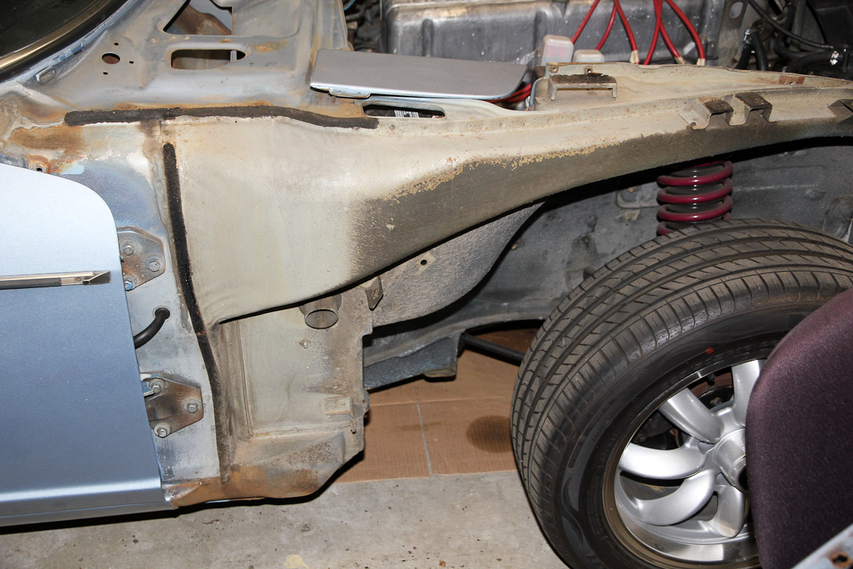

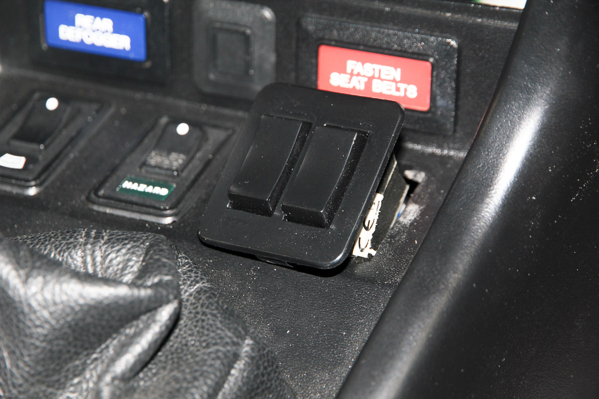

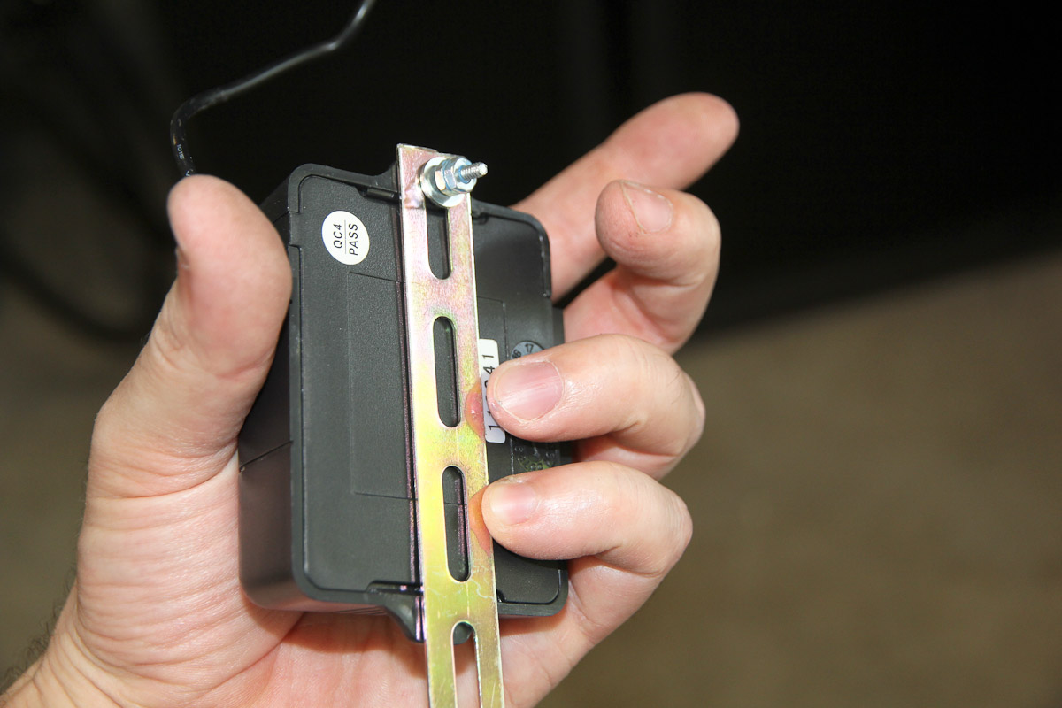

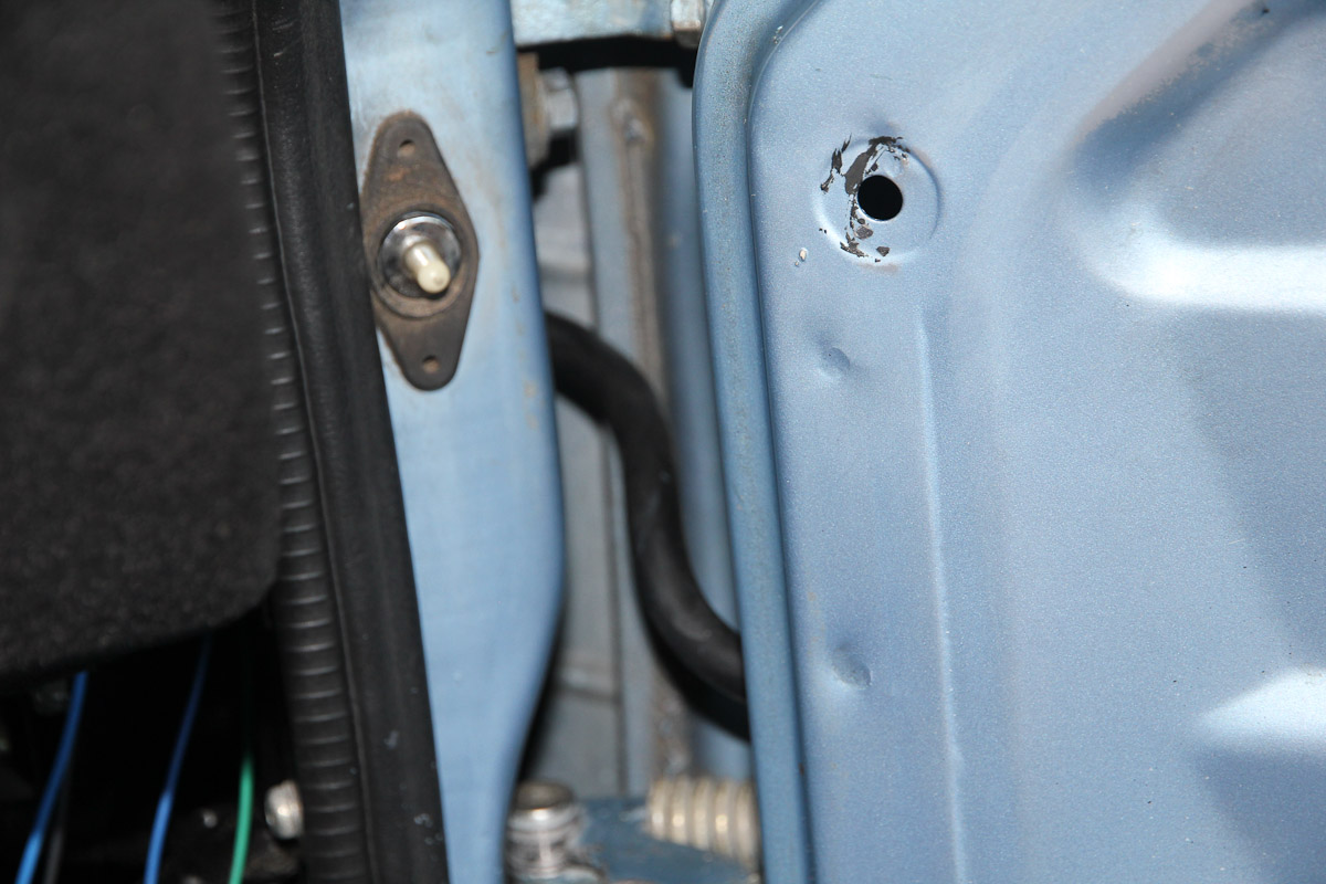

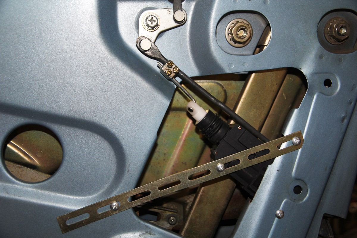

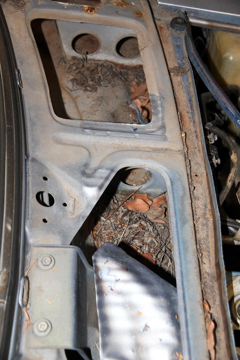

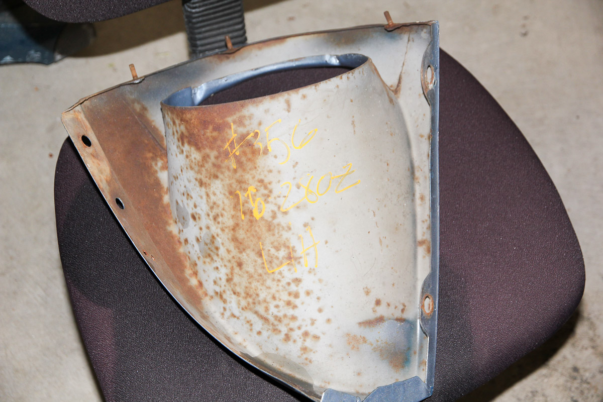

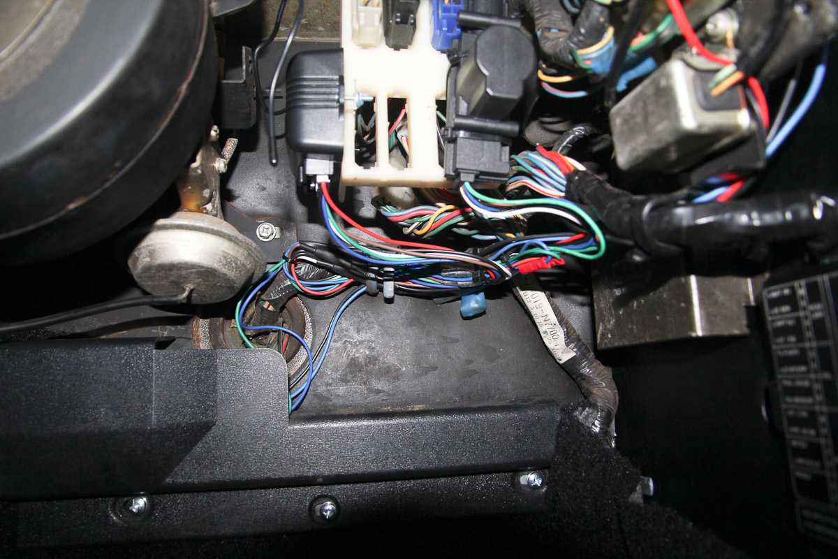

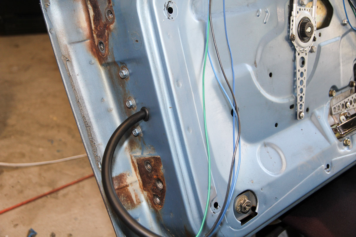

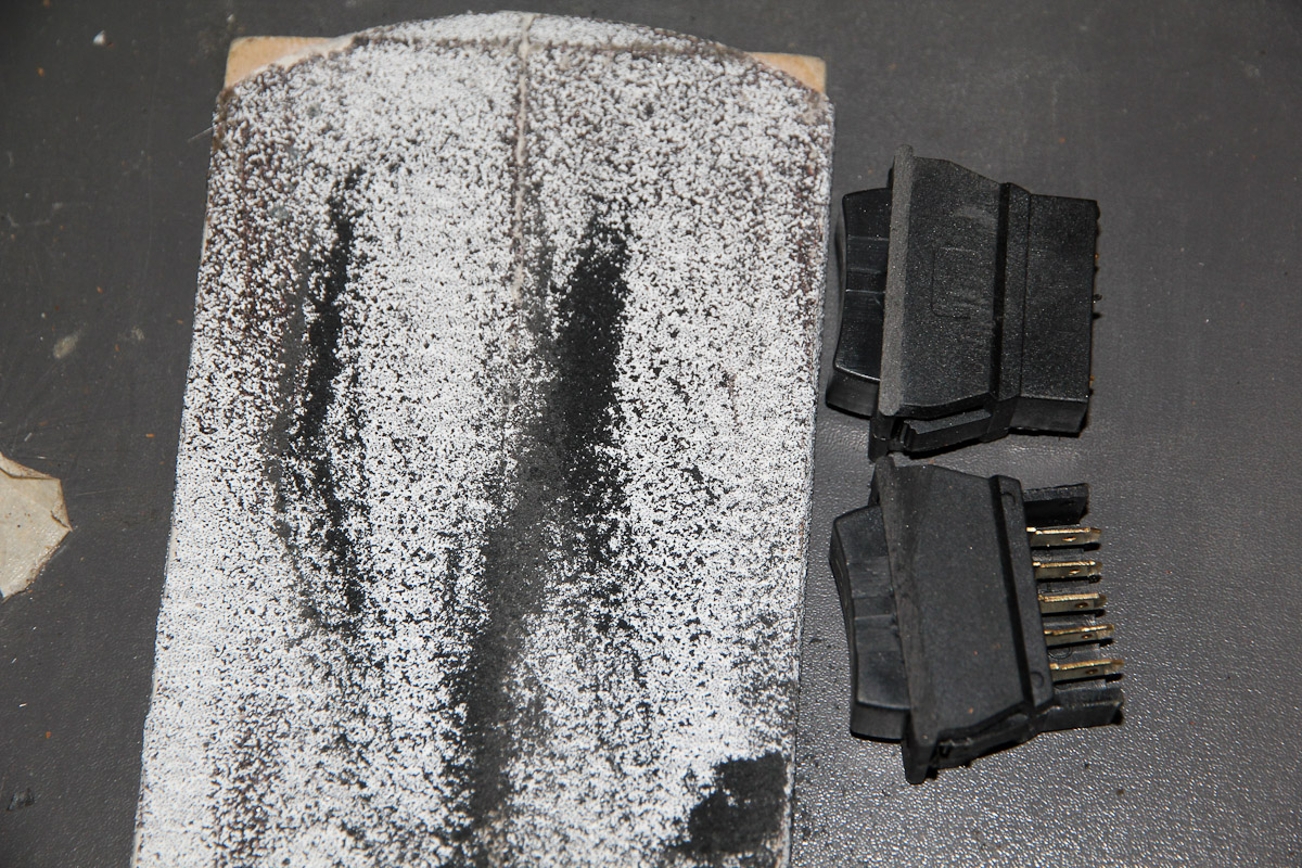

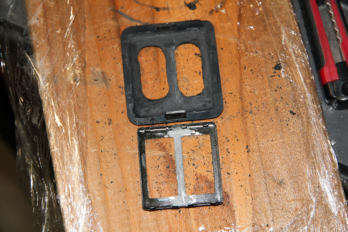

July 27, 20178 yr Author comment_526708 Kind of a scattershot update here, but that's basically been my approach to things the last few weeks. Power locks and windows ended up being a small fiasco. Pulled the doors to get the wiring in, which led to removing the hinges for inspection/cleaning and replacing the detent rollers. Then things went sideways...the passenger door went back on without a problem, but I couldn't get the driver side to align with the fender. I played with it for about an hour before giving up and pulling the fender. That led to more cleaning, but at least I found that with the exception of some very minor surface rust, it's all rust free under there. I also found out that the hood is supposed to have a set of torsion bars. And apparently something happened to the original headlight bucket at some point. Adjusting the hinges never got the alignment any better than it was originally, but some persuading on the fender got the job done, so that was some work I could have avoided. Wiring was easy enough. There's a factory hole on the body that goes into the cabin, and I drilled a matching hole in the door. The rest is grommets and some leftover vacuum hose. I made some cardboard mockups of the low-profile door actuators before buying them, and that was $11 well spent: I only had to cut out a small notch on the door panel and they slid right in; mounting and connecting to the door pull was similarly easy. They do hit the door card, so some shaping and trimming will need to be done there. One hiccup: the original kit I bought has one actuator that works as a master, so it still needed to be in the system somewhere for the slaves to work. I mounted both under the dash with some zip ties and leftover mounting hardware. It's not beautiful, but they work great! Let me talk now about the power window switches, for I hope to never deal with them again. The first set of switches had a broken bezel, but I didn't much like the look of them anyway. The second set came nicely chowdered up and with chipped paint, which made it an easy decision to hack them up. I glued them together, painted everything to match the rest of the console, and stuck it in the blank switch panel next to the hazard switch. Then found out that the harness was too big to get the whole thing to sit flush. I re-did the wiring without the harness, and then one of the switches fell apart and blew the fuse (twice). I ended up using parts from the first switch kit (they seem to be of higher quality, thankfully) and everything -- for now! -- works as it should. Link to comment https://www.classiczcars.com/forums/topic/51367-project-boondoggle-or-so-i-went-and-bought-a-z/?&page=34#findComment-526708 Share on other sites More sharing options...
