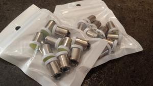

These are the bulbs I ordered. Of the two, the full yellow/domed style was a hair smaller in diameter than the four diode bulbs, but both fit and left a tonne of room between the socket and green plastic domes. The domed style is also slightly brighter than the other, or so it appeared. Dimmer switch is full bright in any position due to the insignificant current draw.
The color appears as a white/blue tone, even through the lens ~8000K ish. Much brighter than stock bulbs, though the speedo still seems like it could use more lumens. This is the auction I purchased them from on eBay.
10 of them for $3.64 USD and free shipping.
