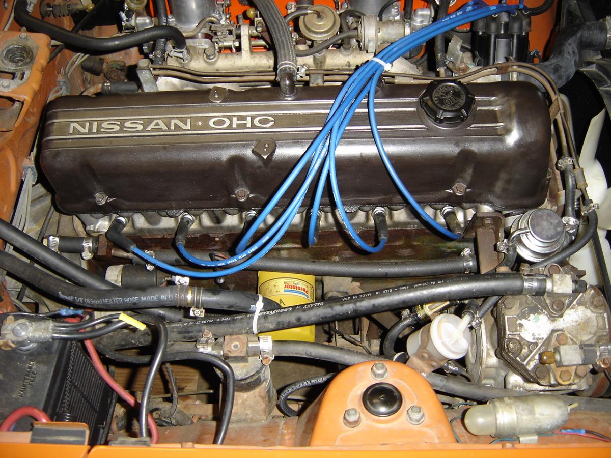

What size plugs do i use to plug the cylinder head outlet to heater core and heater core to water pump inlet? Im bypassing my heater core and cant seem to find the sizes in any thread.d9881925675e83ccbd4b3b6a7ce51b19.jpg52f8b8975fc9f699df95a7ff9d6e1210.jpg

Im blocking it because my heater core is leaky, my valve is leaky, my transfer between engine bay and behind dash is leaky LOL and i just do not feel like dealing with it when there are more important things to do to get it on the road.
I went to homedepot this morning and bought 2 1/2 pipe plugs ill plug up the two areas in the pic and hopefully it eill work.
Not sure what you plan to do with 1/2" but the threads are metric.  You can also connect the return hose to the supply line and put a kink in it, or clamp it.  It doesn't need to be completely blocked, just mostly.
Threads right in to the spot. Found this after some googling.

Just one of those lucky cases where thread sizes overlap.  Be careful, since you're not getting full, proper, thread contact.  You could damage the aluminum head.
Actually, those threads may not be metric.  But they would still be British.  McMaster Carr has BSPT.  1/2" pipe plugs too.

The next challenge is figuring the water pump inlet. It has the barb that goes to it the. A smaller one comes off it and snakes its way to the intake manifold before finally ending up at the thermostat.

On my 240z the outlet on the head (for the hose to the heater) is 3/8" BSPT, and the one on the bottom of the thermostat housing is 1/4" BSPT. BSPT fasteners screw into BSPT holes way nicer than NPT or metric. NPT sort of works except for threaded BSPT fuel fittings, where they don't work at all.
Interesting that the 280z has a threaded hose barb on the main water inlet, and there's a pipe that goes around the front of the engine, through the intake and over to the thermostat housing. Didn't know any of that. Is there a thermostat in that line? The 240z manifold heater goes around the back of the engine. Maybe you should keep that part hooked up per some of the HybridZ posts.
