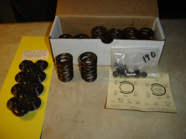

March 1, 201510 yr Author comment_464609 Still feeling like crap but this made me feel a little better. Â We've had some bad weather so UPS has been 2 days behind but Saturday around lunch I got my regrind and the components that go with it. Â I must say they ground it down to nothing! $400 for everything, regrind, springs and retainers and .190" lash pads. Â Link to comment https://www.classiczcars.com/forums/topic/50909-72-240z-rebuild/?&page=6#findComment-464609 Share on other sites More sharing options...

March 2, 201510 yr comment_464748 looks cool - let us know how the geometry works out w/those lash pads and the rockers you're using. based on my recent experience, i'll be interested to see how a "one size fits all" set works out. Link to comment https://www.classiczcars.com/forums/topic/50909-72-240z-rebuild/?&page=6#findComment-464748 Share on other sites More sharing options...

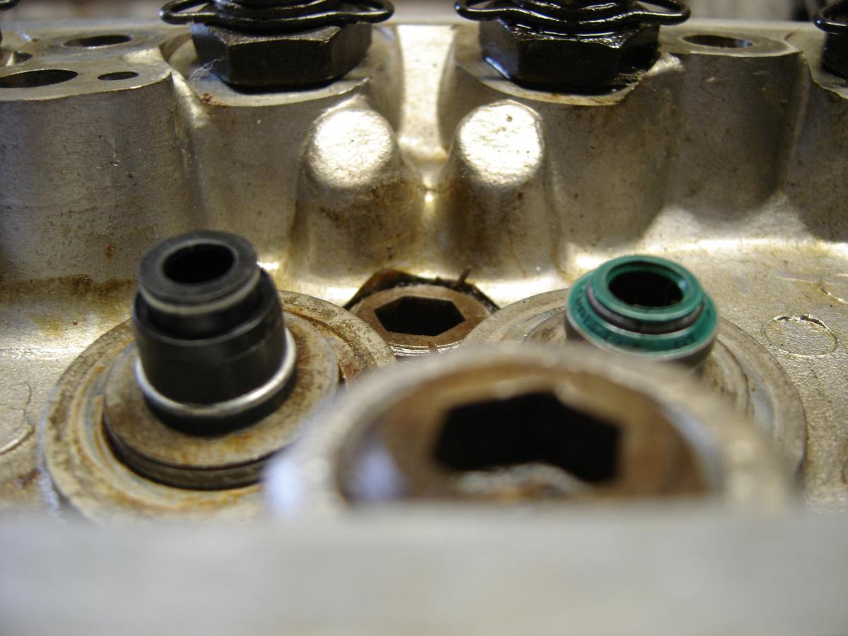

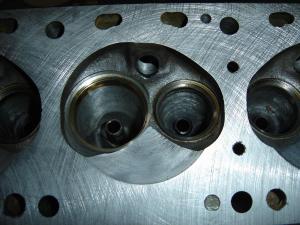

March 5, 201510 yr Author comment_464925 I decided to take apart my E31 before I give it to the machinest, trying to save him some time. Â Well there was a couple of surprises. Â It looks like someone has already ground the area around the valve guides and they are steel, checked with a magnet. Â The intake valve seats are brass and the exhaust are steel. Â It had the shorter Ford valve seals which I ruined when I removed them, I'll get a new set. Â I've got a Felpro beside the Viton for height comparison. Â Should I get steel intake seats or leave the brass? Â I'm not going to the racetrack and when I run it up it'll only be quick and short. Â The police know me and where I live with my orange 240, small town. Â Thanks for any advice, Cliff. Link to comment https://www.classiczcars.com/forums/topic/50909-72-240z-rebuild/?&page=6#findComment-464925 Share on other sites More sharing options...

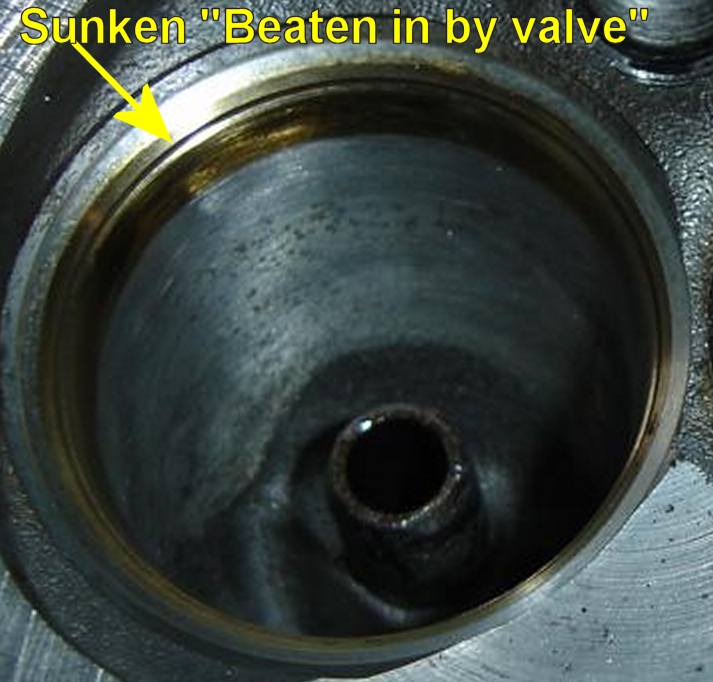

March 7, 201510 yr comment_465014 It looks like the steel valve has sunken into the bronze seat already. You can see the ridge left by it. It would be good to change the intake seats. Link to comment https://www.classiczcars.com/forums/topic/50909-72-240z-rebuild/?&page=6#findComment-465014 Share on other sites More sharing options...
March 7, 201510 yr comment_465018 Definitely change the bronze to steel........and get the new low profile Felpro Ford seals.....you'll be lucky if the .190's work correctly for all twelve valves. The head looks good....nice water jackets. Edited March 7, 201510 yr by Diseazd Link to comment https://www.classiczcars.com/forums/topic/50909-72-240z-rebuild/?&page=6#findComment-465018 Share on other sites More sharing options...
