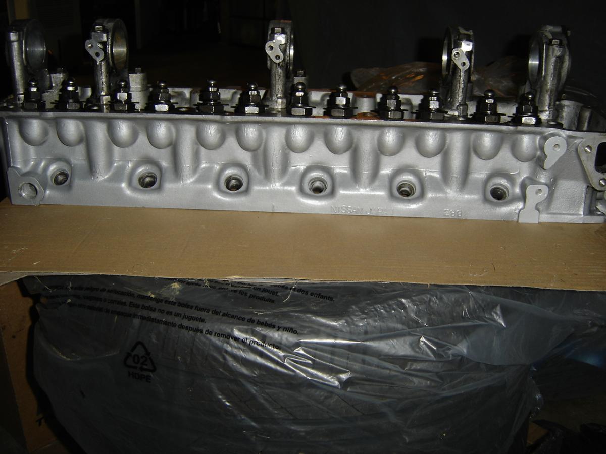

July 30, 201510 yr Author comment_474815 I need advice, reassurance on my valves. I took all the rockers off so they were sealing with the springs tension. I blew into the exhaust holes on the manifold side. Tight! No leaking. The intakes were tight but I could tell air was getting past them, just the intake valves. Is that okay? My thinking thinks it is, just no leaking through the exhaust on the combustion stroke. Right?Thanks for any thoughts.Cliff Link to comment https://www.classiczcars.com/forums/topic/50909-72-240z-rebuild/?&page=14#findComment-474815 Share on other sites More sharing options...
July 31, 201510 yr comment_474852 you can check sealing by flipping the head chambers-up and pour some isopropyl alcohol into the chambers then look into the ports with a flashlight to see if they are leaking. if there's cruddy buildup on the back of the valves, you can soak 'em in solvent then use some masking tape on the stem, chuck 'em up in the drill press and use scotchbright 00 steel wool to get 'em clean & shiny. if they still leak, you can try lapping them, then next step is a valve job. Link to comment https://www.classiczcars.com/forums/topic/50909-72-240z-rebuild/?&page=14#findComment-474852 Share on other sites More sharing options...
July 31, 201510 yr Author comment_474864 Thank you! Sounds easy enough.Quite a bit of carbon on the valves. After a good cleaning they have to seal better. Link to comment https://www.classiczcars.com/forums/topic/50909-72-240z-rebuild/?&page=14#findComment-474864 Share on other sites More sharing options...

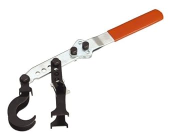

July 31, 201510 yr Author comment_474870 That cam hook spring compressor would make centering the cam lobes onto the rocker pad a helluva lot easier, right? And you do them one at a time until you get it right, then go back and install the right lash pads and button it up? I'm gonna start with the .190s they sent with the cam then use .175s and some cut up pieces of a feeler gauge to stack under the lash caps for the right height to get them to hit the center, thanks for that tip Rossiz. I bead blasted them today with good results, to me. Link to comment https://www.classiczcars.com/forums/topic/50909-72-240z-rebuild/?&page=14#findComment-474870 Share on other sites More sharing options...

August 1, 201510 yr Author comment_474921 Which spring compressor do you use madkaw? I think the one that hooks on the cam would be best for centering each lobe on the rocker pads. Seems like it would be a lot quicker but I've never done it so I'm looking for ideas/tips from you and the others that have done this before. Like this one, Thanks, Oh yeah, I got my heads sealed with Eastwoods clear satin for bare metal. I used a 1/2" China bristle brush rather than spraying it on. After reading a good many threads, if you put on too much it will yellow and flake from the heat. The best thing is to put some on and work it in with a brush, until it quits soaking in. You can barely tell it's on there but I dripped some water on them and it beaded up like wax. I'm happy so far. Edited August 1, 201510 yr by siteunseen Link to comment https://www.classiczcars.com/forums/topic/50909-72-240z-rebuild/?&page=14#findComment-474921 Share on other sites More sharing options...
August 1, 201510 yr comment_474936 The compressor in your pic would be ideal. I just used a pry bar. Link to comment https://www.classiczcars.com/forums/topic/50909-72-240z-rebuild/?&page=14#findComment-474936 Share on other sites More sharing options...

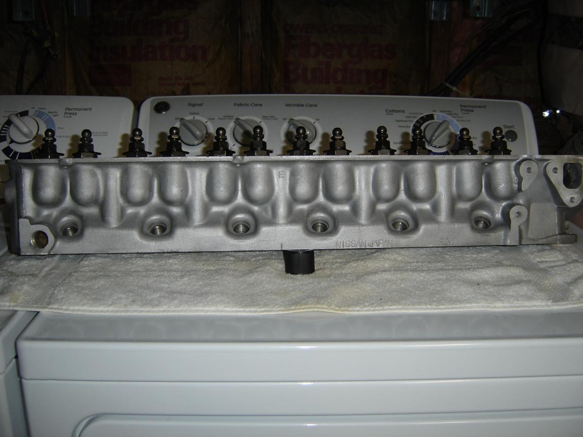

August 13, 20159 yr Author comment_475701 Want any opinions on these seals before I go any further. Are they bulging too much? The valves will stay up by themselves so they are sealing pretty tight, I guess. I did #1 exhaust last night with a plastic piece of tubing to drive it down, bad decision. A 13mm deep socket works better, more control and the socket is perfectly even top and bottom. Thanks for looking. Link to comment https://www.classiczcars.com/forums/topic/50909-72-240z-rebuild/?&page=14#findComment-475701 Share on other sites More sharing options...
August 14, 20159 yr comment_475710 Cliff,When you say bulging to what are you referring? I don't see any distortion. Can you point it out.C Link to comment https://www.classiczcars.com/forums/topic/50909-72-240z-rebuild/?&page=14#findComment-475710 Share on other sites More sharing options...
August 14, 20159 yr Author comment_475723 Those aren't made for an L head and if you drive them down too far the valve guide will cause them to "bulge" out between the little spring and the metal base of the seal. You can see the gap at the very bottom between the inner spring seat and the metal base of the seals. I'm worried I went too far. I'll put another, uninstalled one beside these and take a closeup picture to help judge, my eyes are finally showing their age. Link to comment https://www.classiczcars.com/forums/topic/50909-72-240z-rebuild/?&page=14#findComment-475723 Share on other sites More sharing options...
