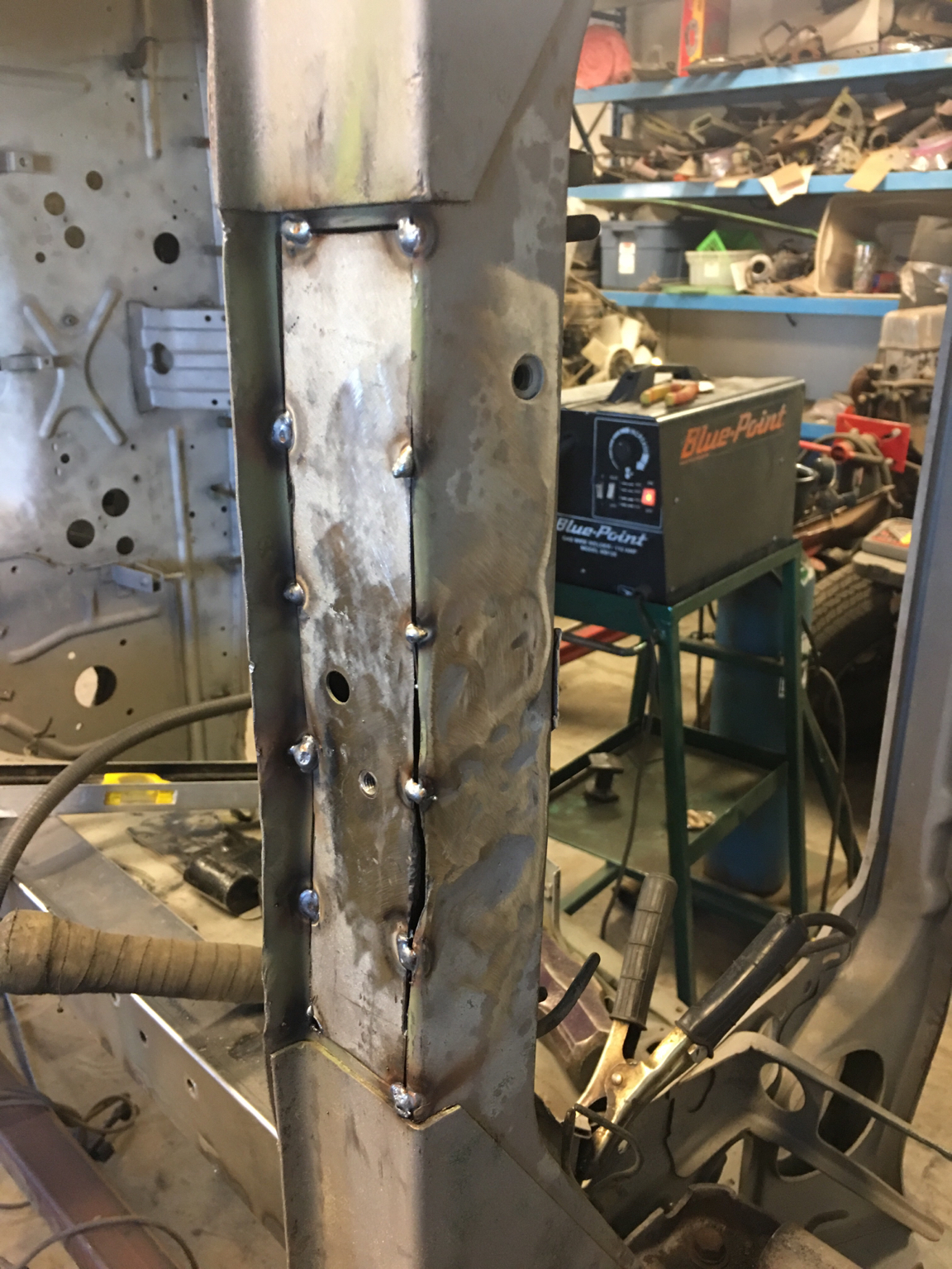

The welds are supposed to be seam welds but are the closest I could get inside the piece with my mig gun. They are there to "gusset" the corners or "folds" to reinforce them. Remember, I had to score the folds with a cutoff disc in order to bend them first. This way, they will be stronger and will withstand more pressure or small impacts and hold their shapes better and longer.
I also have an anvil for pounding the sheet metal into shape. It isn't perfect, but it will be functional and with a little bodywork and paint, they should look good!
So I have left this opening between the rails to hopefully drain any moisture that gets into the frame rails. This will be the lowest point on the frame and the connecting panel has 1/16" of space facing the rear of the vehicle between the floor rail and connecting rail. This should allow an egress point without giving it an ingress point...
IMG_4137.thumb.JPG.885a6282fb1e89f0865f1
Fitted... with space for drain over 3/16" jack plate welded in place.
IMG_4138.thumb.JPG.56b0e51de0b68a32e8f13
IMG_4139.thumb.JPG.478c3ca05b0e53200034a
Half welded! Spot welds went thru perfect. Now I have to go buy more wire LOL
IMG_4140.thumb.JPG.753008edcc08f362378cf
Enough for today. I will flip the car and finish the welding tomorrow. Looks way better than I thought it would!....

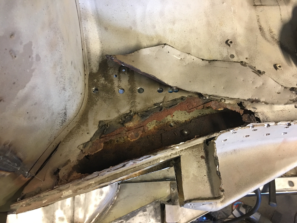

Opened up this can of worms...
IMG_4147.thumb.JPG.b37647815b97ffca3df1e
Good thing I am replacing all of that!
Next up..., the passenger frame rail!
