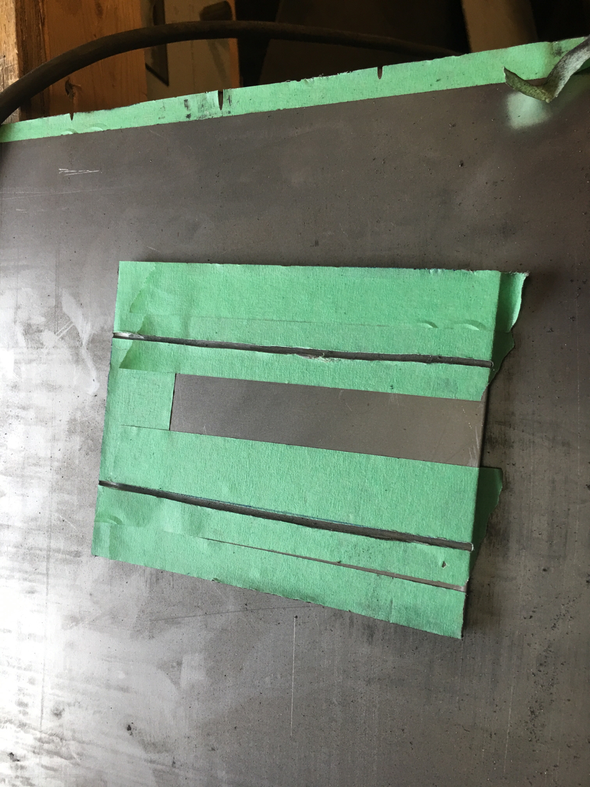

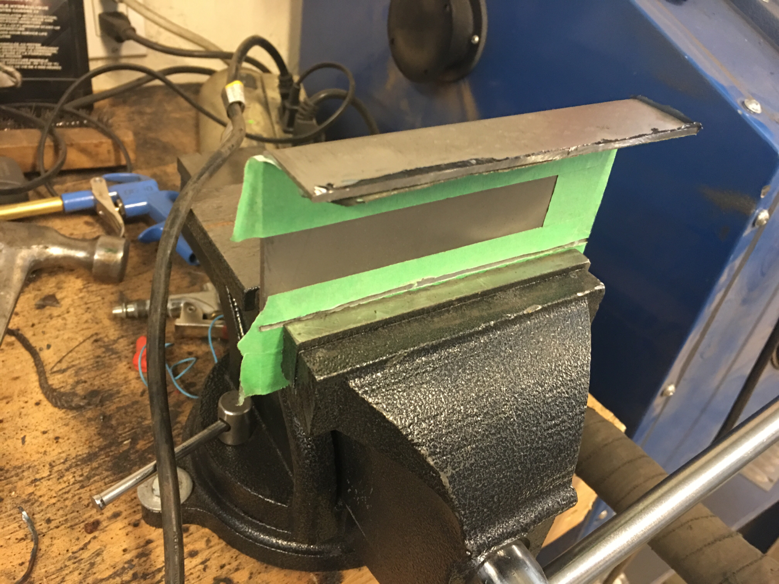

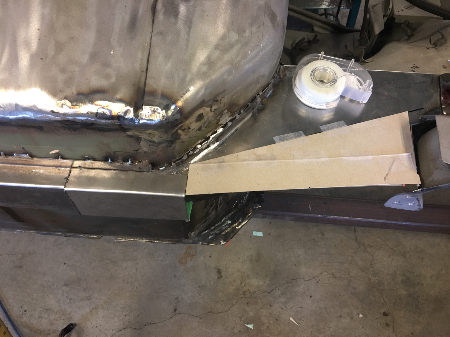

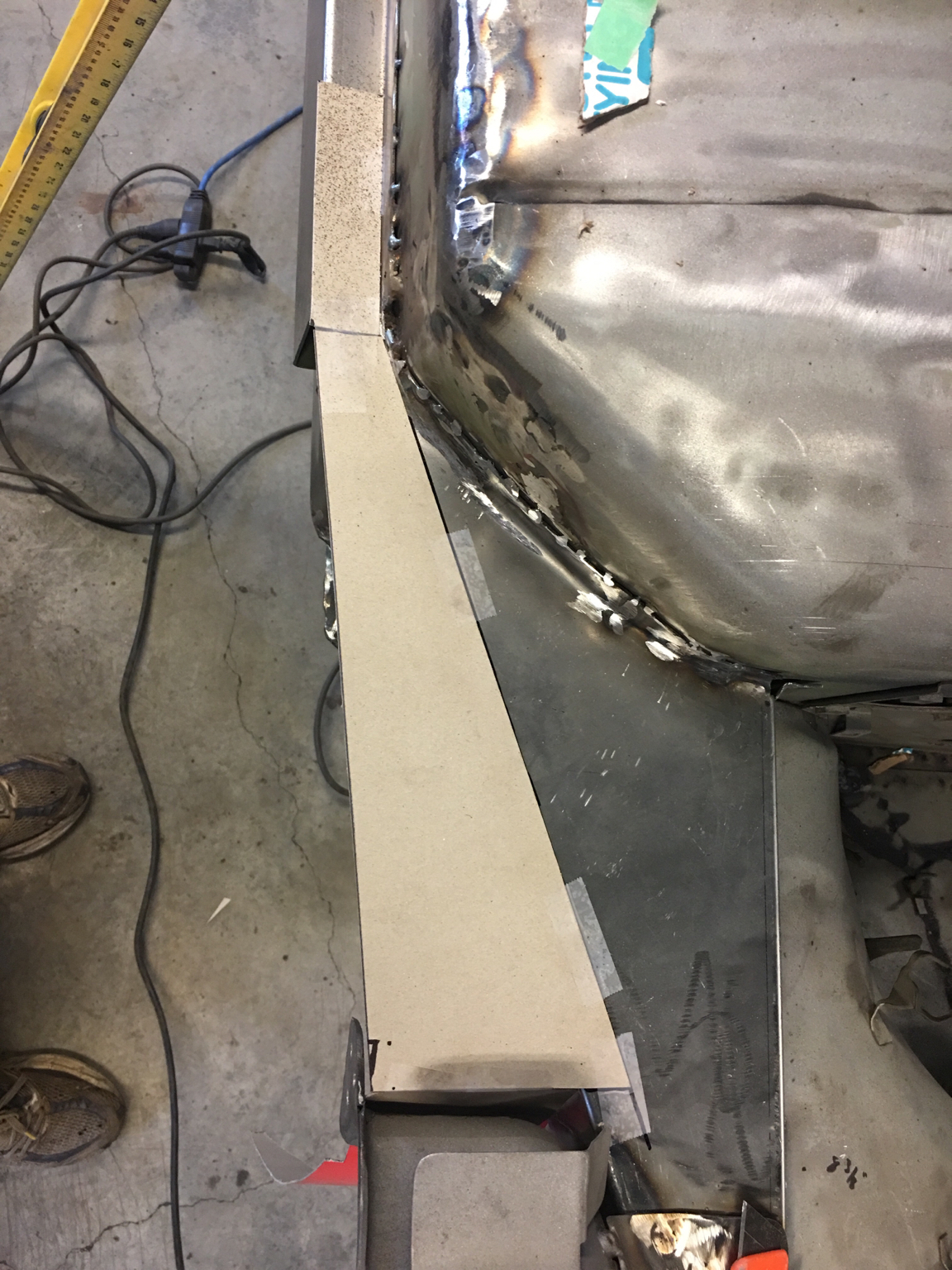

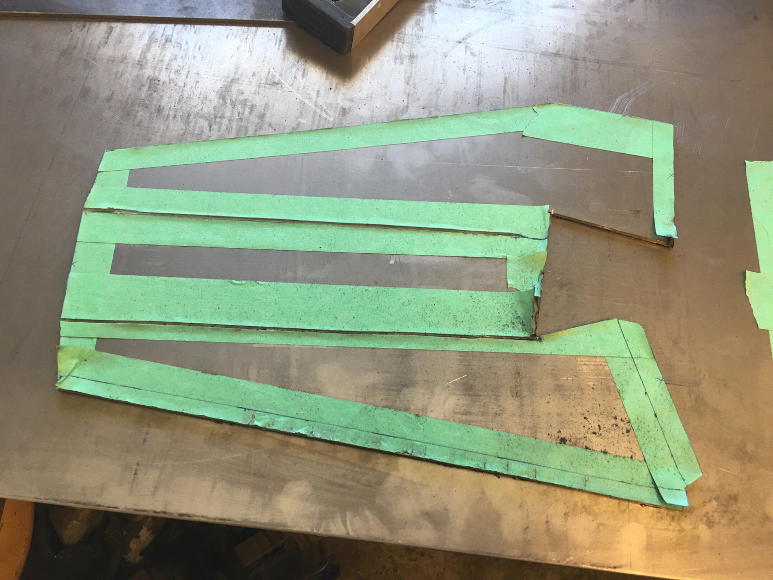

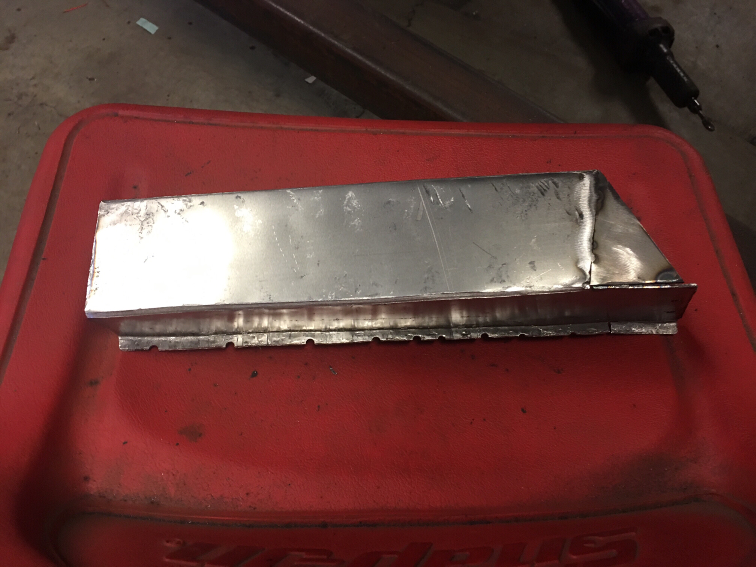

Well, I worked on the structural joining piece between the front frame rails and the floor pan rails today. I used the mock up cardboard method plus a lot of measuring and test fitting. The parts turned out pretty good and I am close to getting it all welded up together.

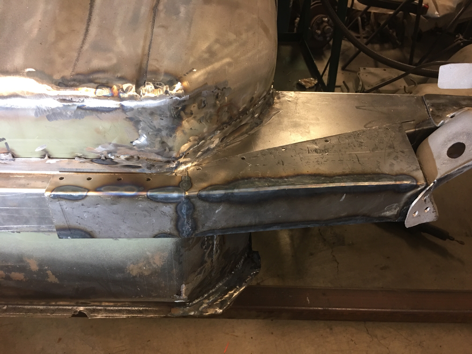

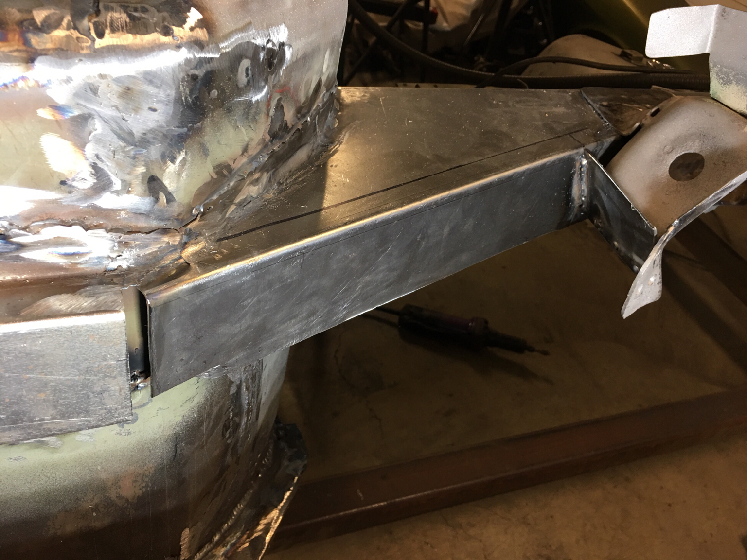

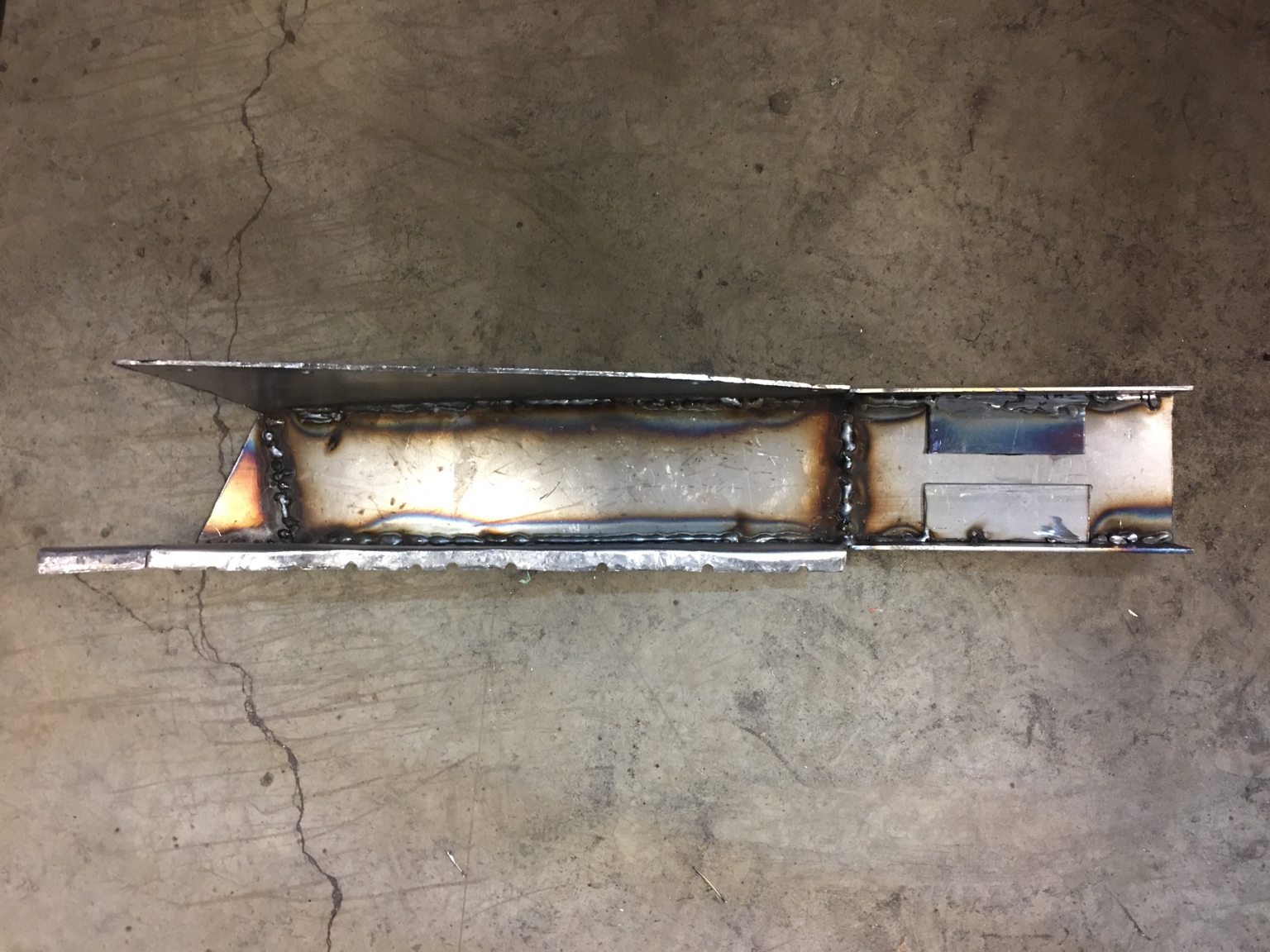

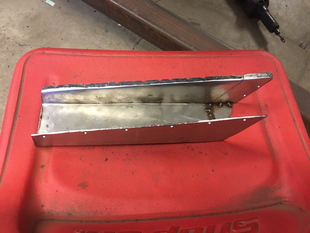

In your most recent photos, one (or perhaps both) of your set of frame repair sections has stitch welds running full length along the inside of the long folds.  Why?  Did you fit a doubler piece inside for extra strength?

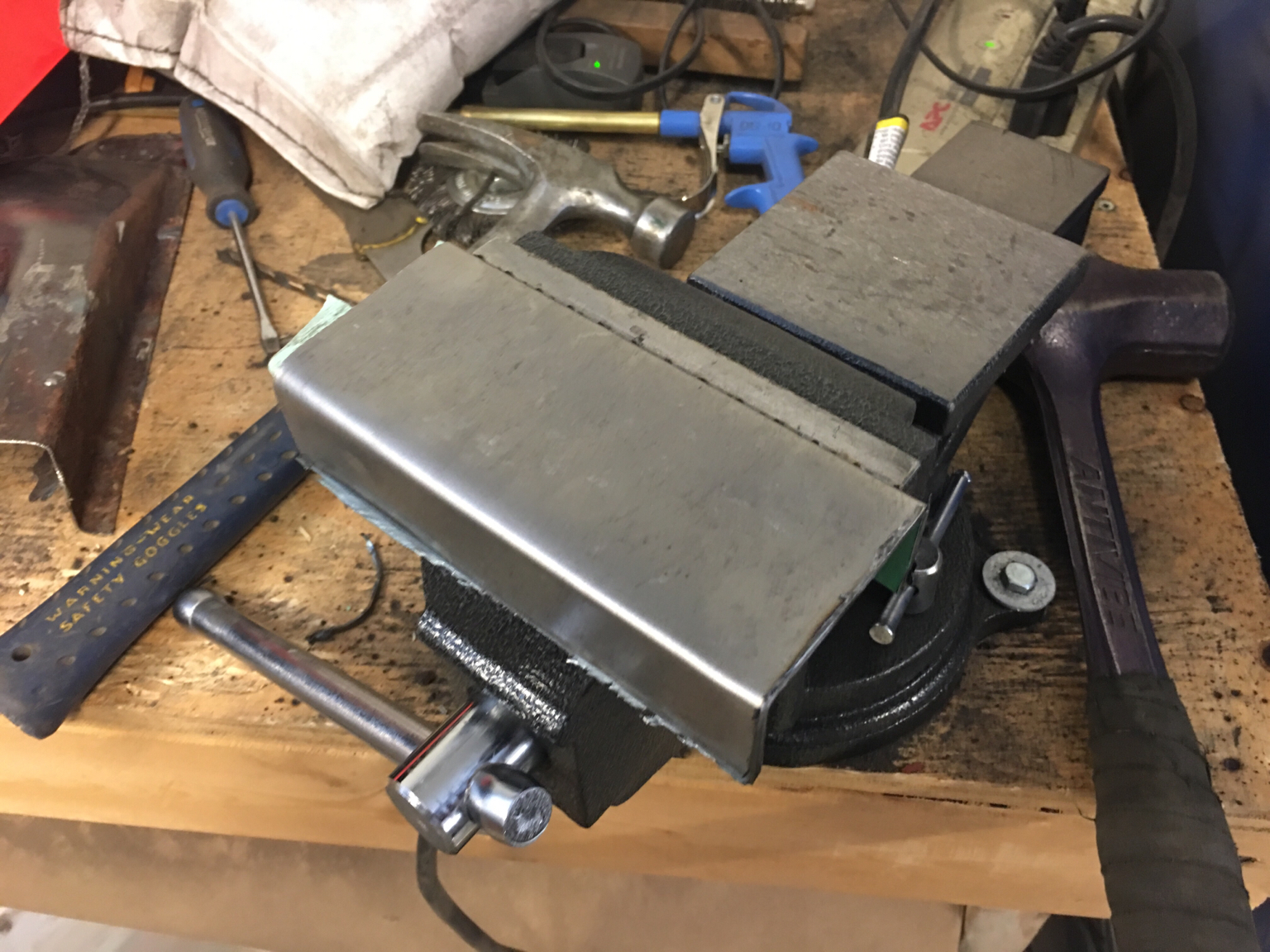

BTW, I admire your efforts in constructing these repair pieces from scratch and without the benefit of having a sheet-metal brake in your shop.  That's a pretty nice result achieved from forming your bends over the jaws of a mechanic's vise!
