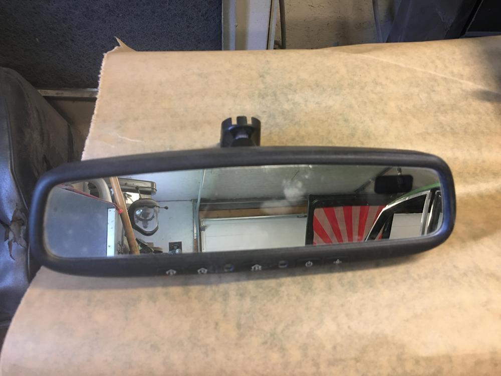

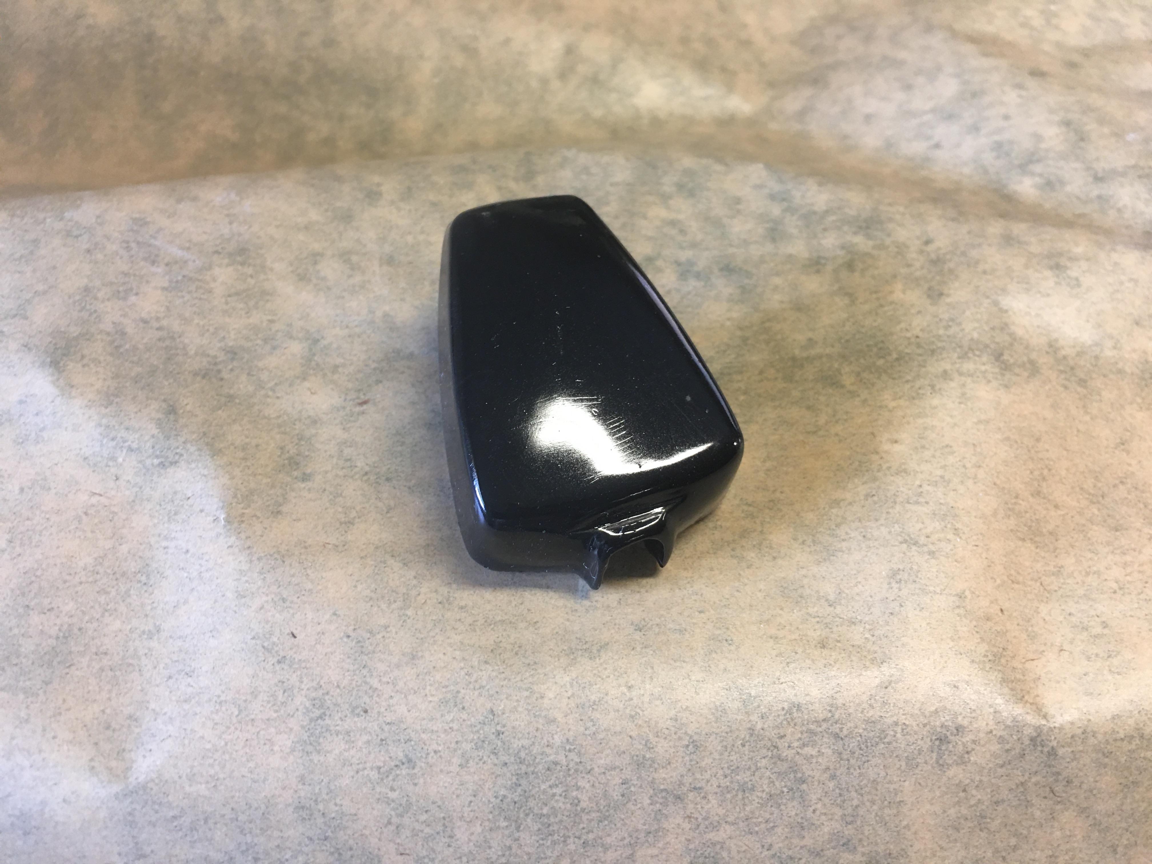

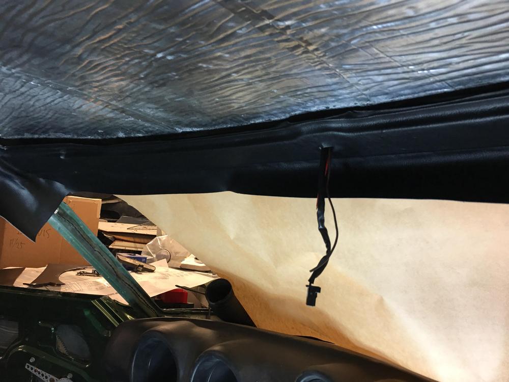

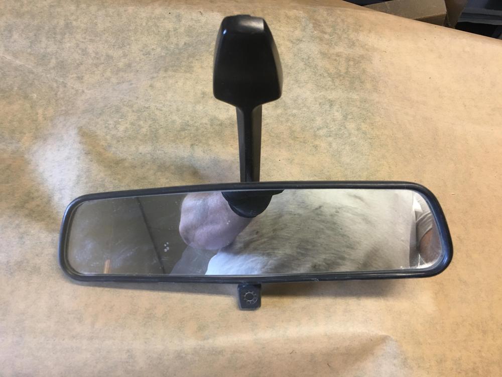

May 31, 20205 yr Author comment_600558 I decided to modify the mirror mount in the car. I picked up another mirror stalk from Jim @zKars and shaped it to allow the wires in the headliner come through the middle and out towards the windshield. Now I have a perfect cap to cover the wires and make the whole unit look stock! Looking forward to having this complete with the glass in. Link to comment https://www.classiczcars.com/forums/topic/50908-1976-280z-restoration-project/?&page=272#findComment-600558 Share on other sites More sharing options...

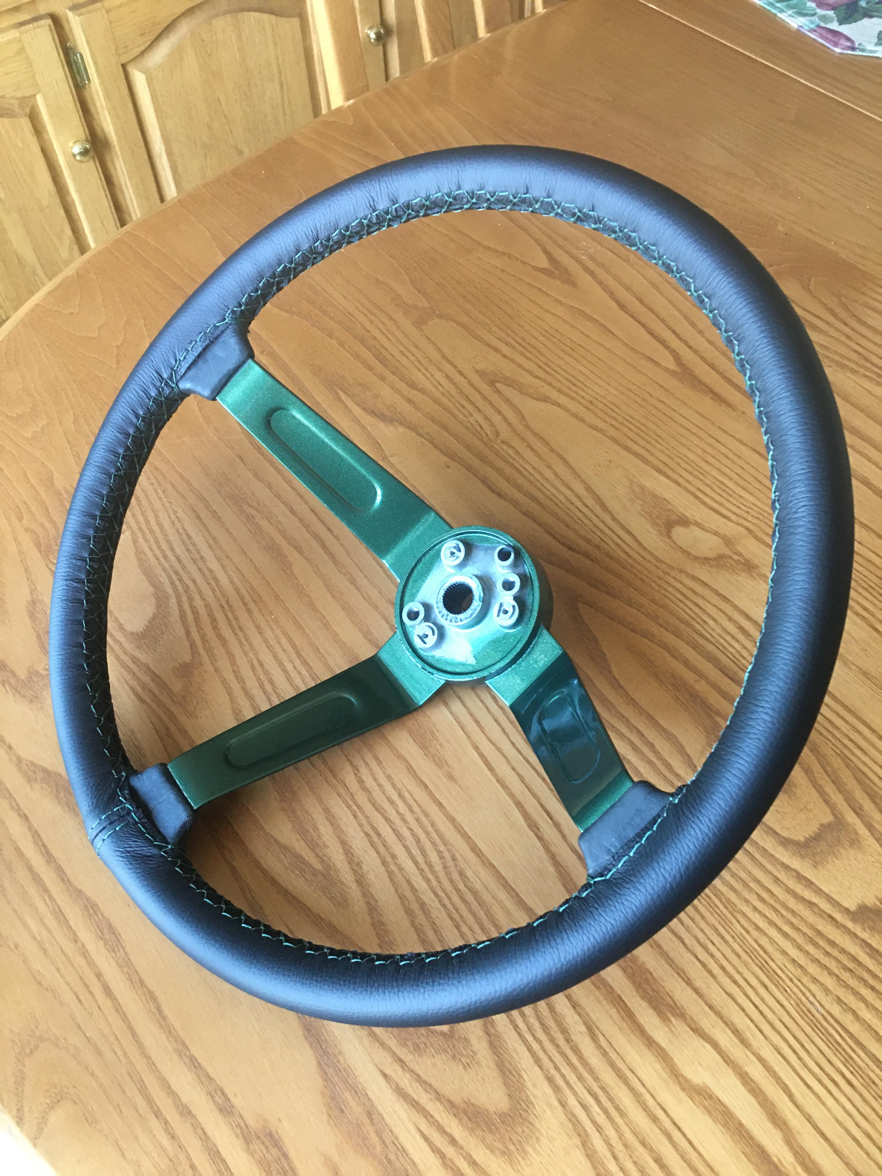

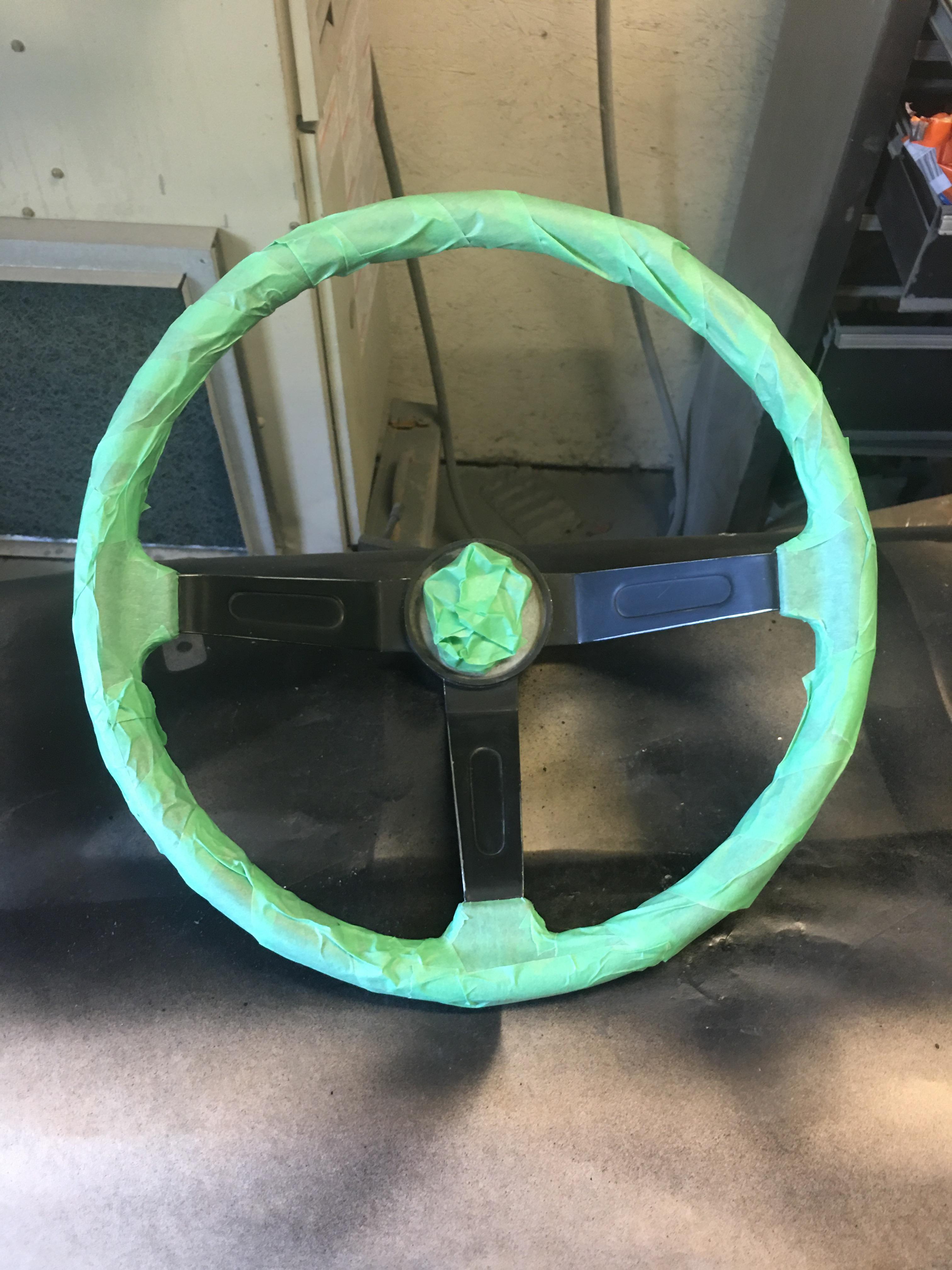

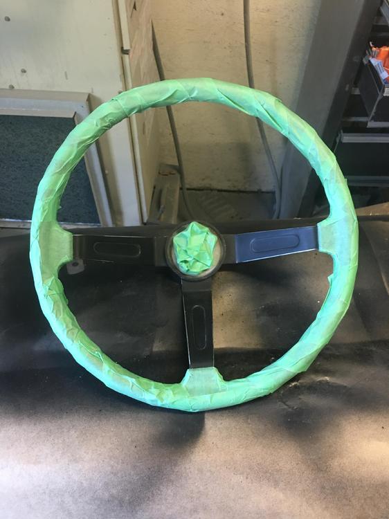

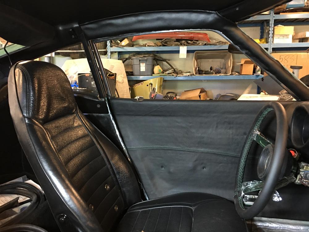

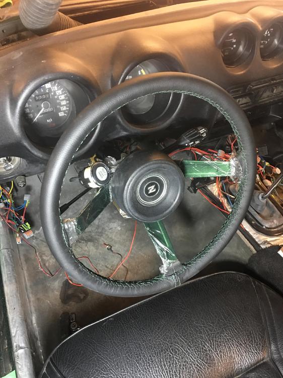

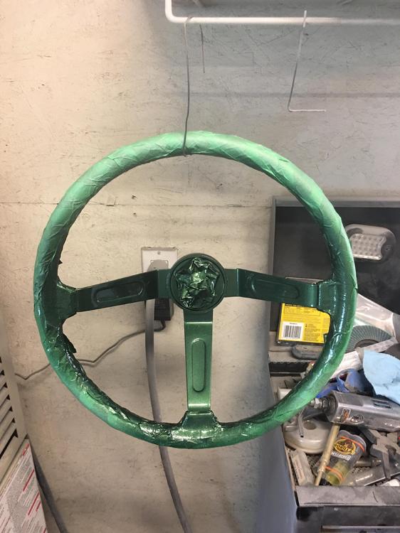

June 1, 20205 yr Author comment_600603 On to the next project. I wanted to redo the original steering wheel as it just felt like the right way to go. I sanded the spikes down and painted them body colour then hit them with a nice coat of gloss. Next, I wrapped a custom leather cover over the wheel and baseball stitched it up in dark green thread. The cover was off an eBay seller in the UK. Link to comment https://www.classiczcars.com/forums/topic/50908-1976-280z-restoration-project/?&page=272#findComment-600603 Share on other sites More sharing options...
June 1, 20205 yr Author comment_600624 Reassembled the horn components and placed the wheel for effect. The cling wrap is just there to protect the paint for now. Link to comment https://www.classiczcars.com/forums/topic/50908-1976-280z-restoration-project/?&page=272#findComment-600624 Share on other sites More sharing options...

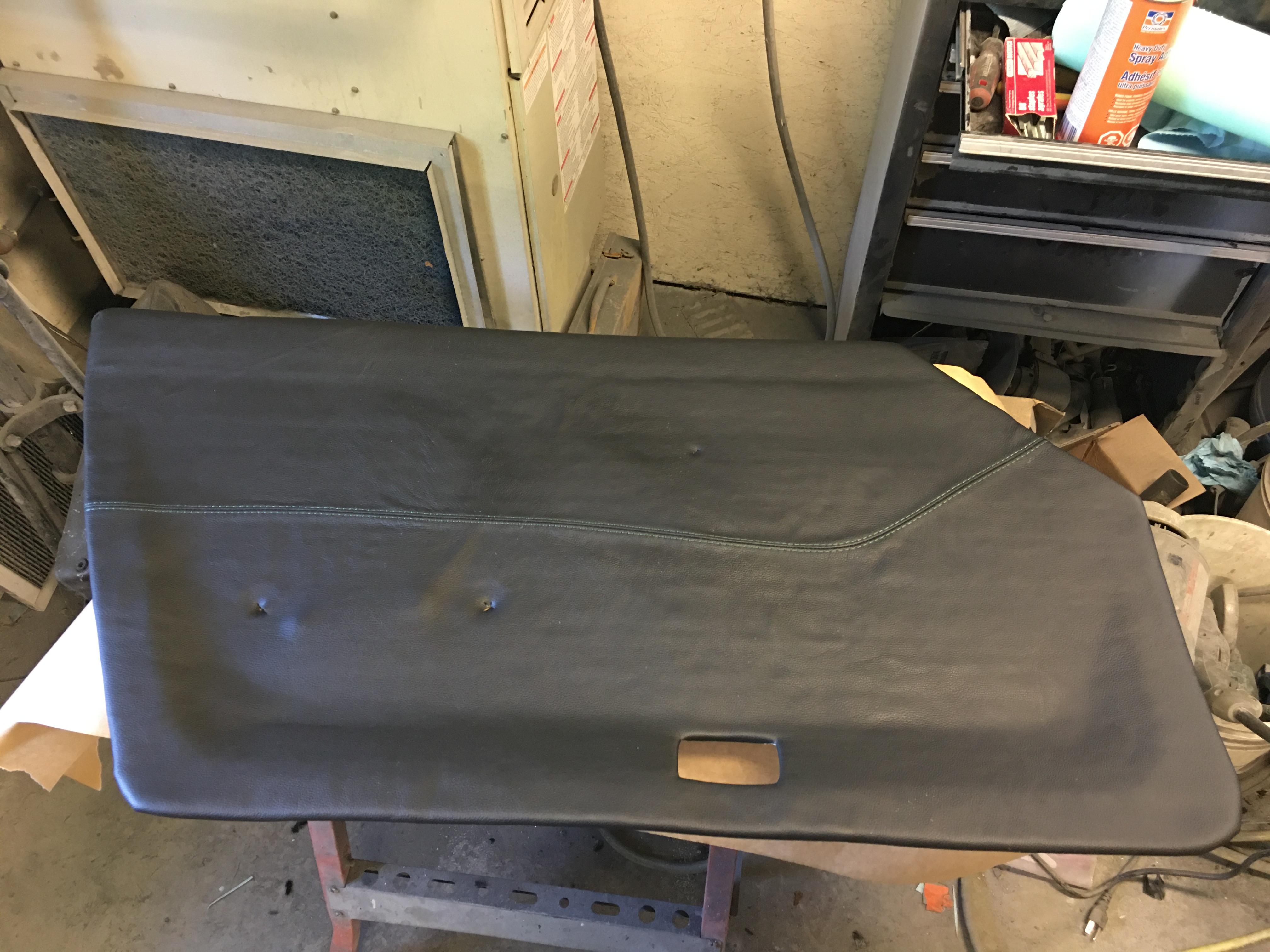

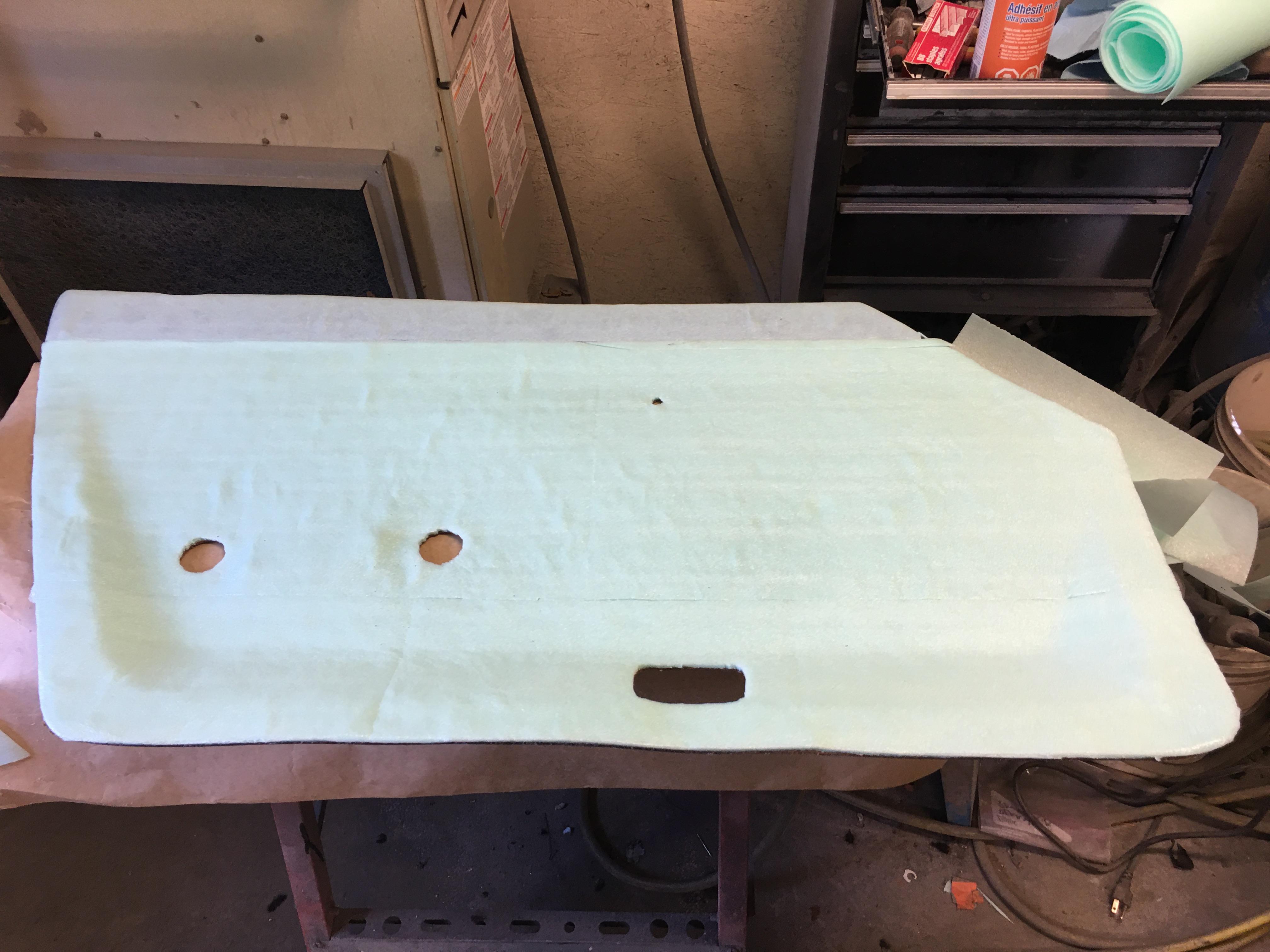

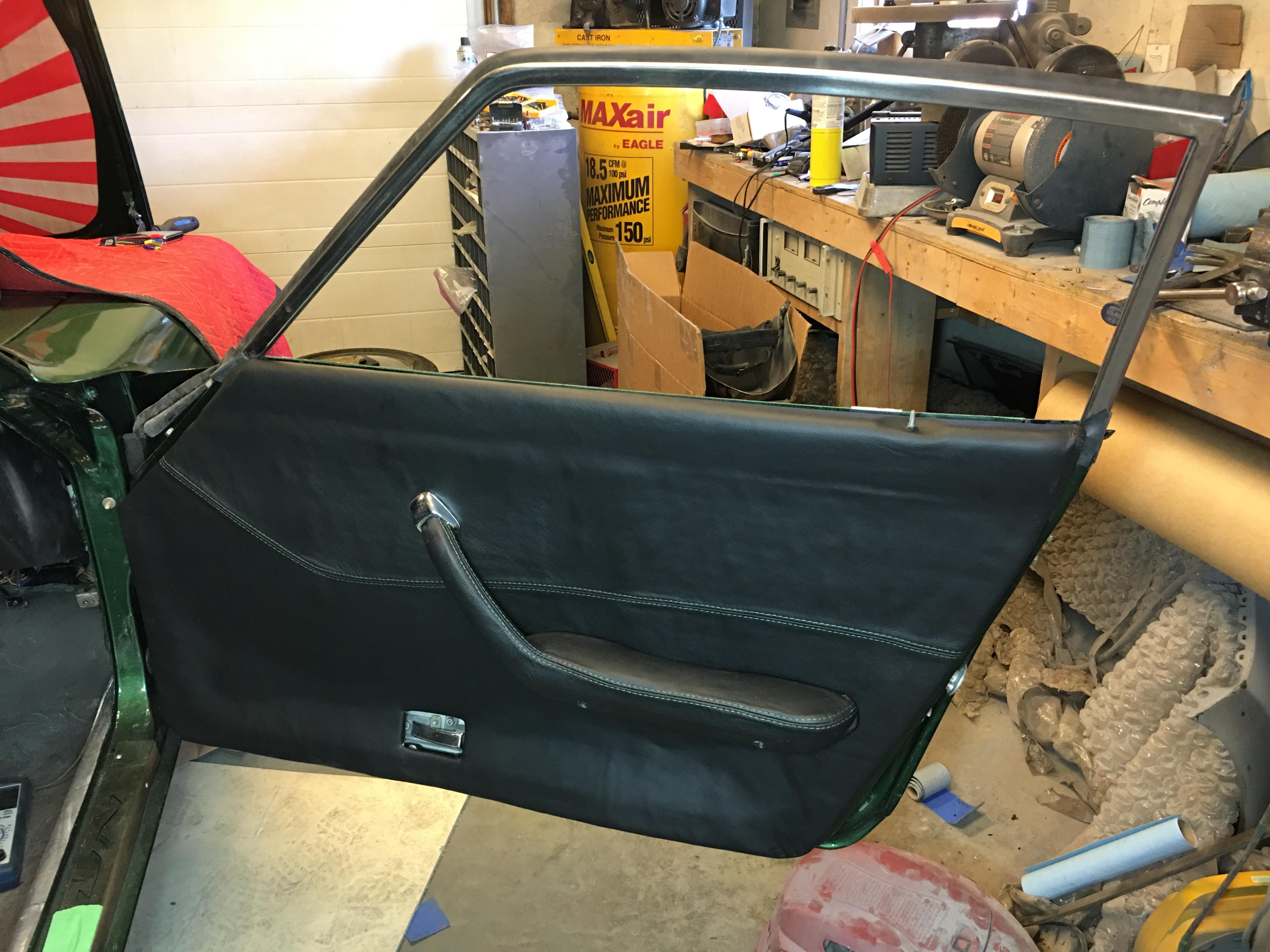

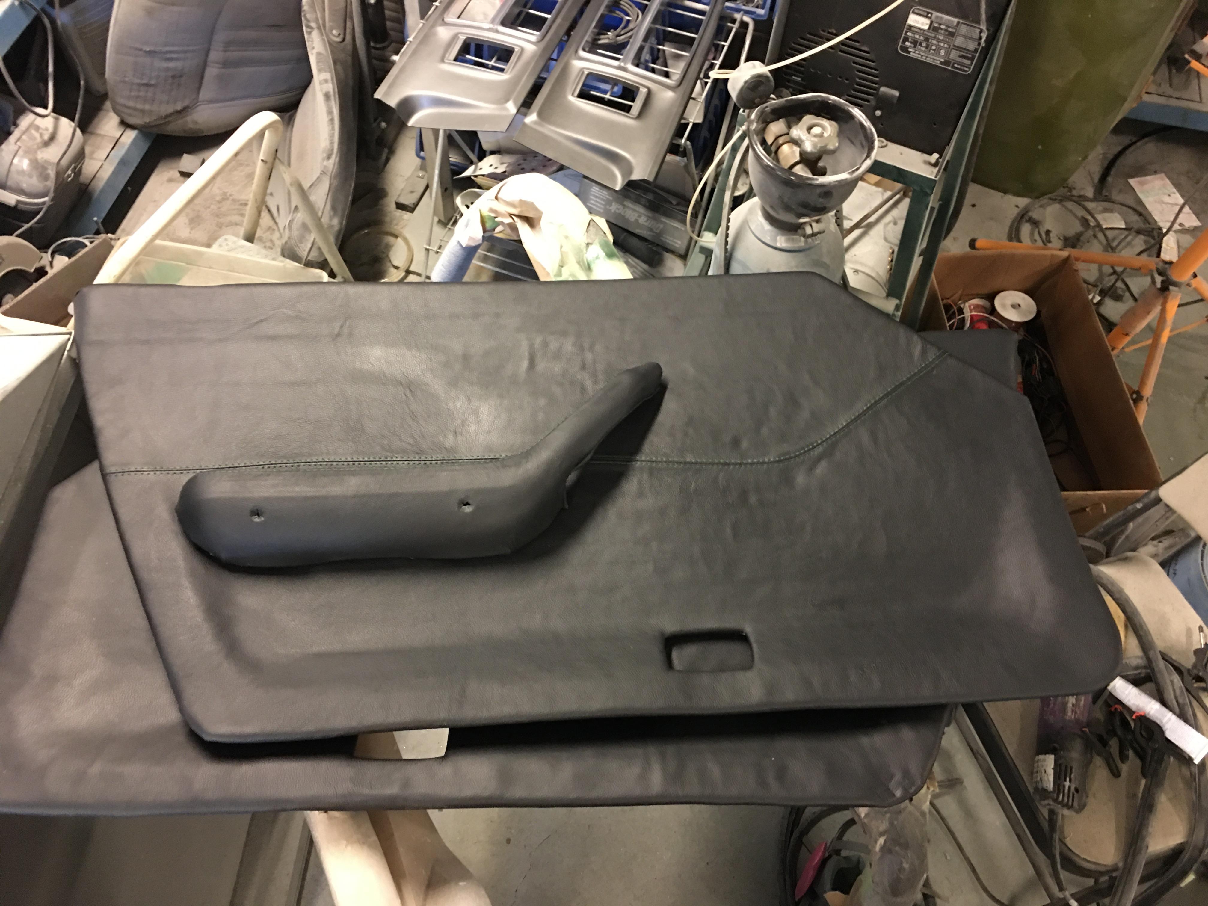

June 3, 20205 yr Author comment_600718 Door panel skins arrived today! Time to build some doors... Leather panels with leather covers for the armrests and green stitching. Final pics in car not fully installed. Link to comment https://www.classiczcars.com/forums/topic/50908-1976-280z-restoration-project/?&page=272#findComment-600718 Share on other sites More sharing options...

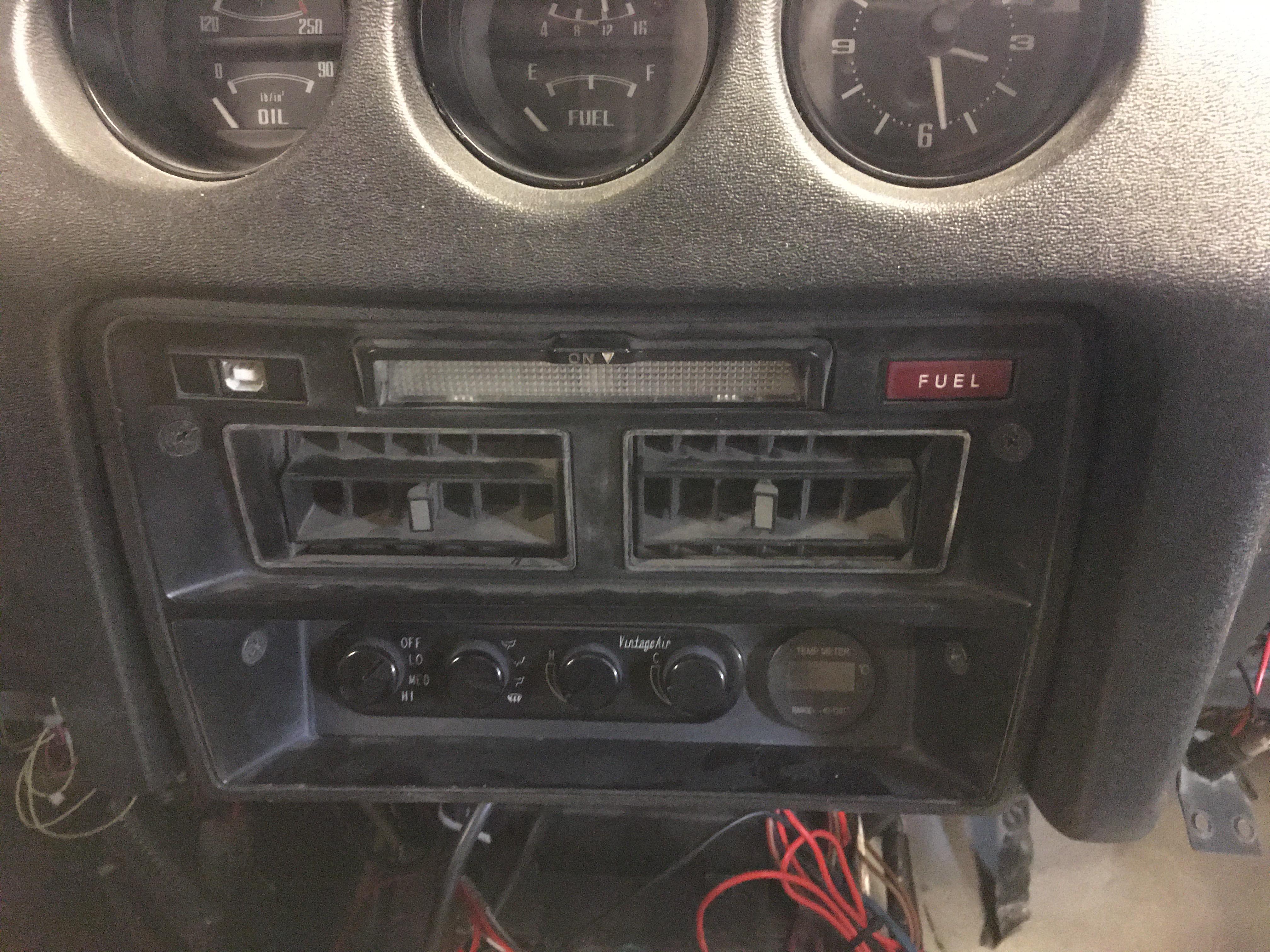

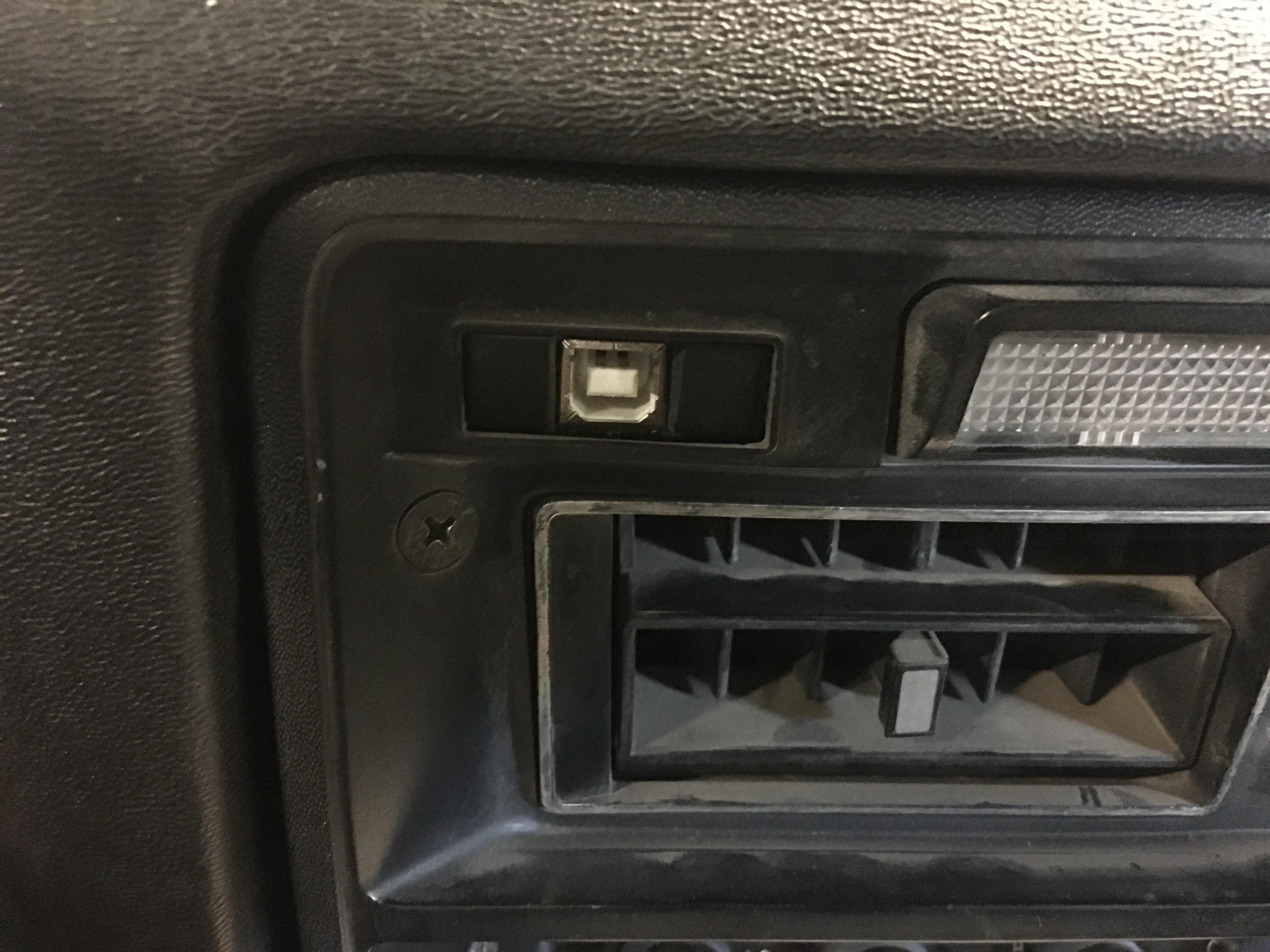

June 4, 20205 yr Author comment_600784 Added a port on the console for the Haltech connection. This is unobtrusive and easy to connect. Edited June 4, 20205 yr by wheee! Link to comment https://www.classiczcars.com/forums/topic/50908-1976-280z-restoration-project/?&page=272#findComment-600784 Share on other sites More sharing options...

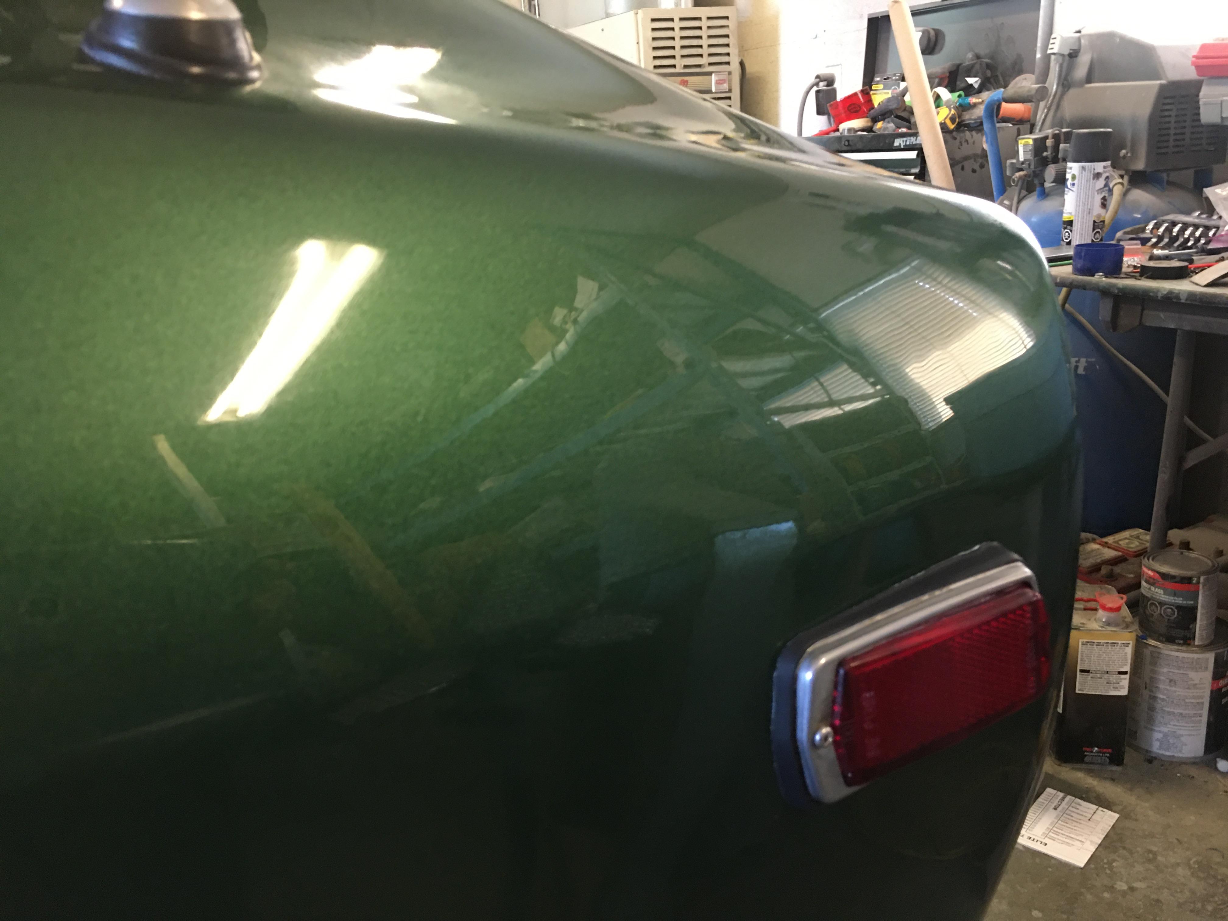

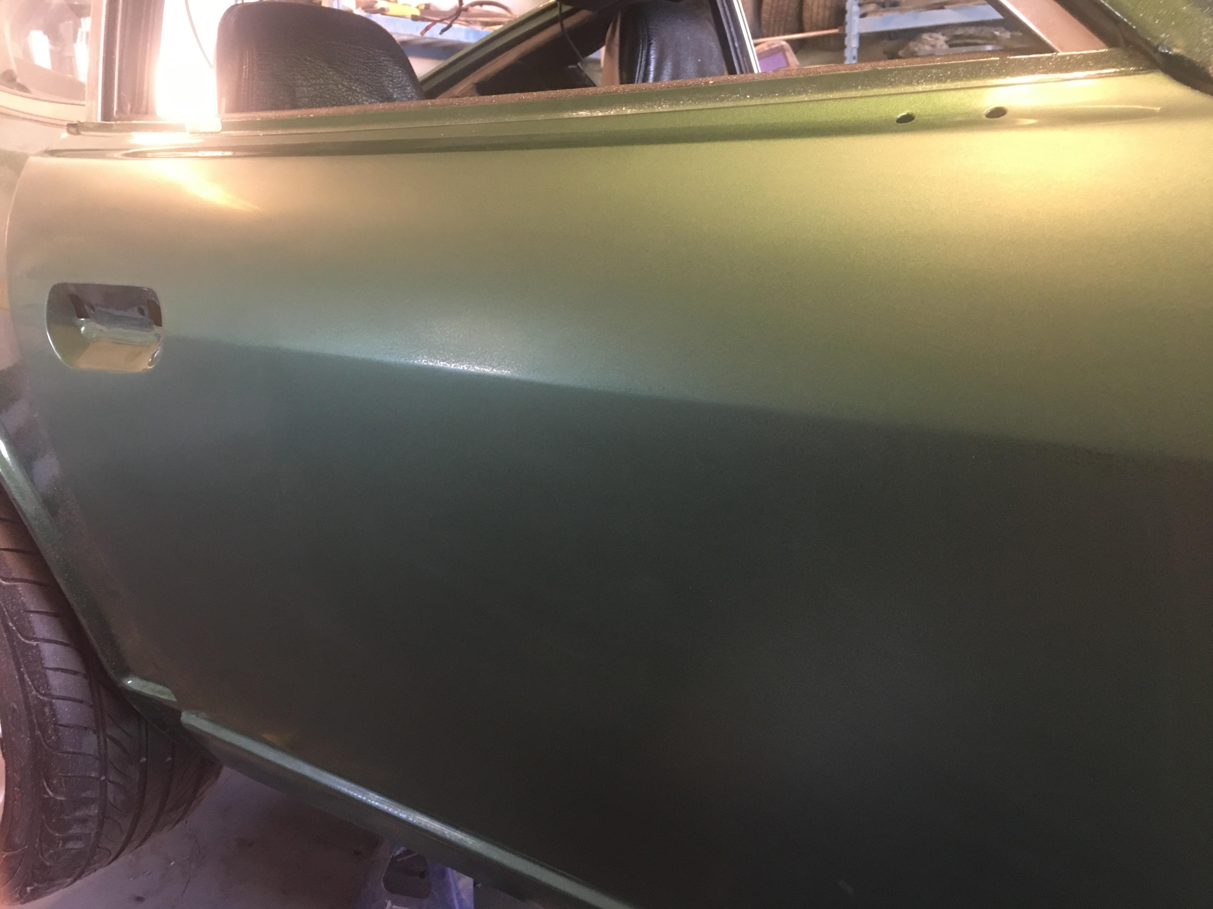

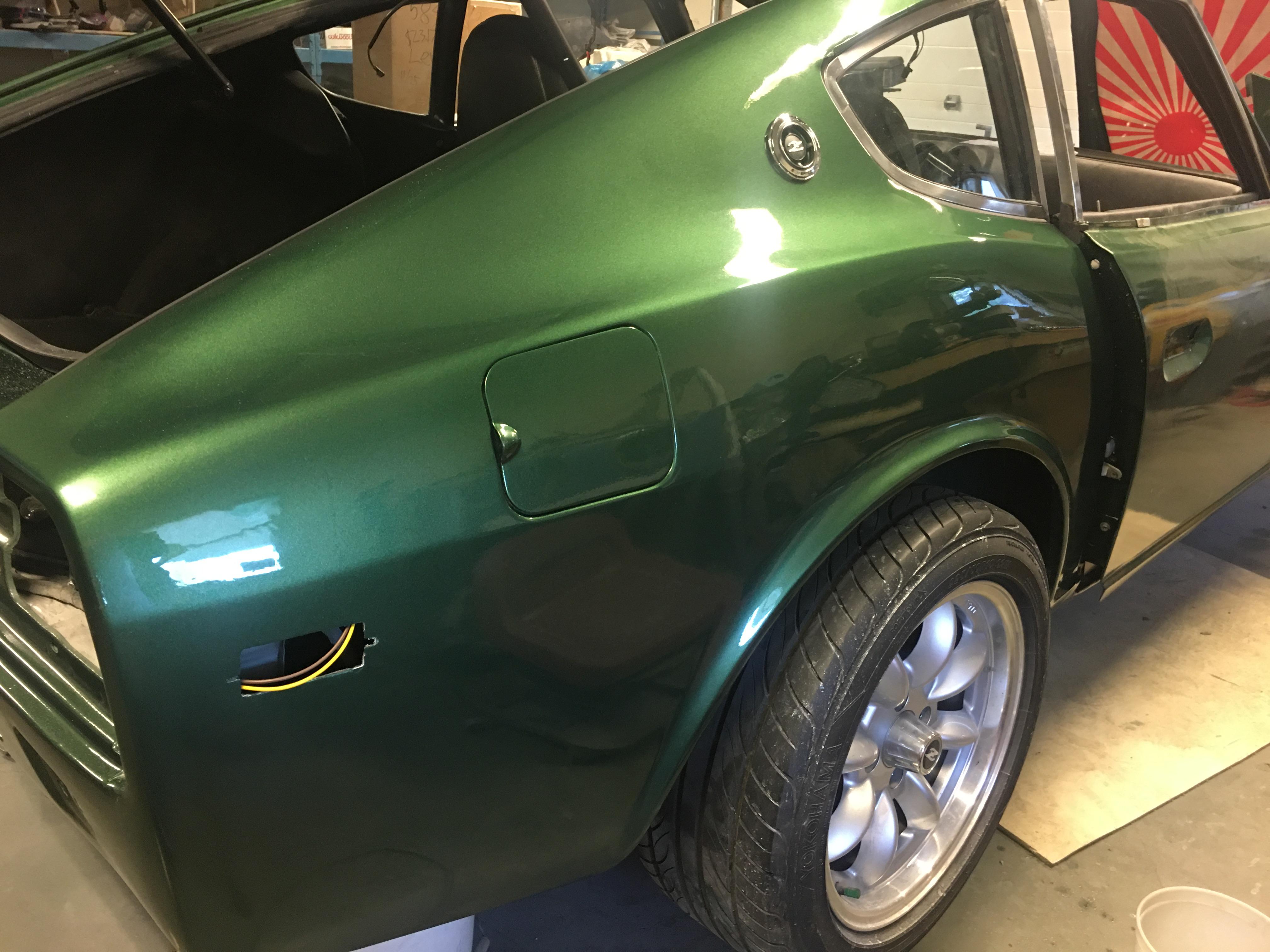

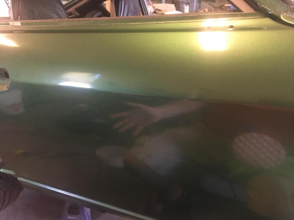

June 13, 20205 yr Author comment_601098 Did some paint repair while I wait for parts to show up. Some wet sanding and polishing. Link to comment https://www.classiczcars.com/forums/topic/50908-1976-280z-restoration-project/?&page=272#findComment-601098 Share on other sites More sharing options...

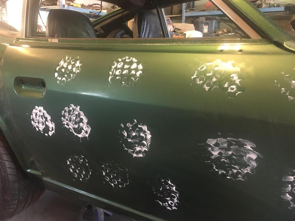

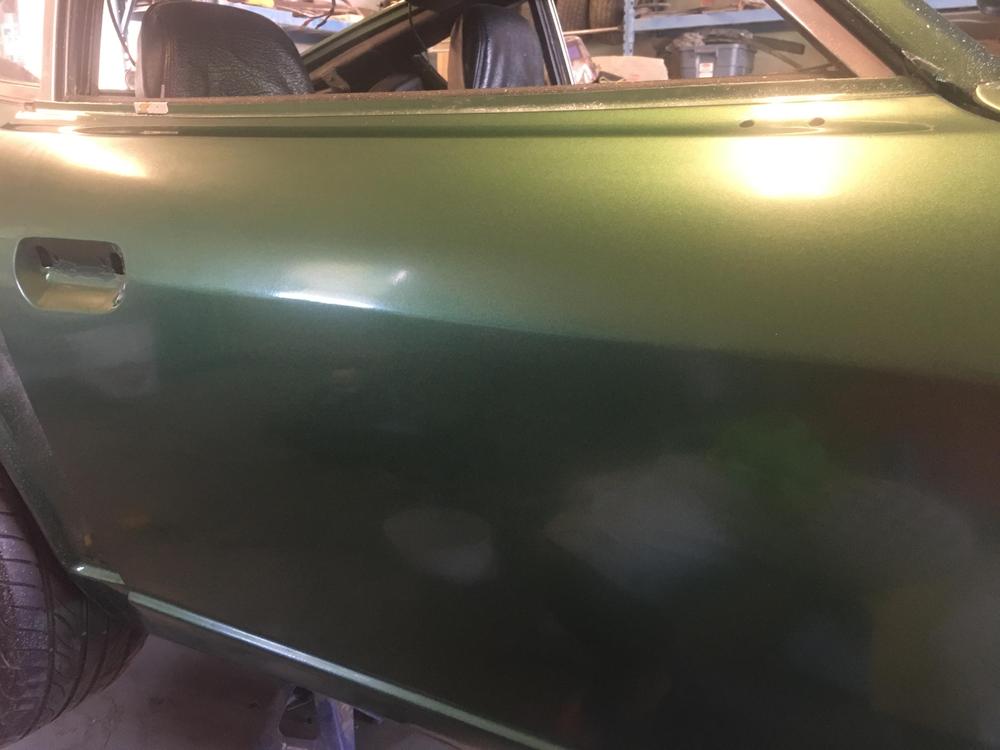

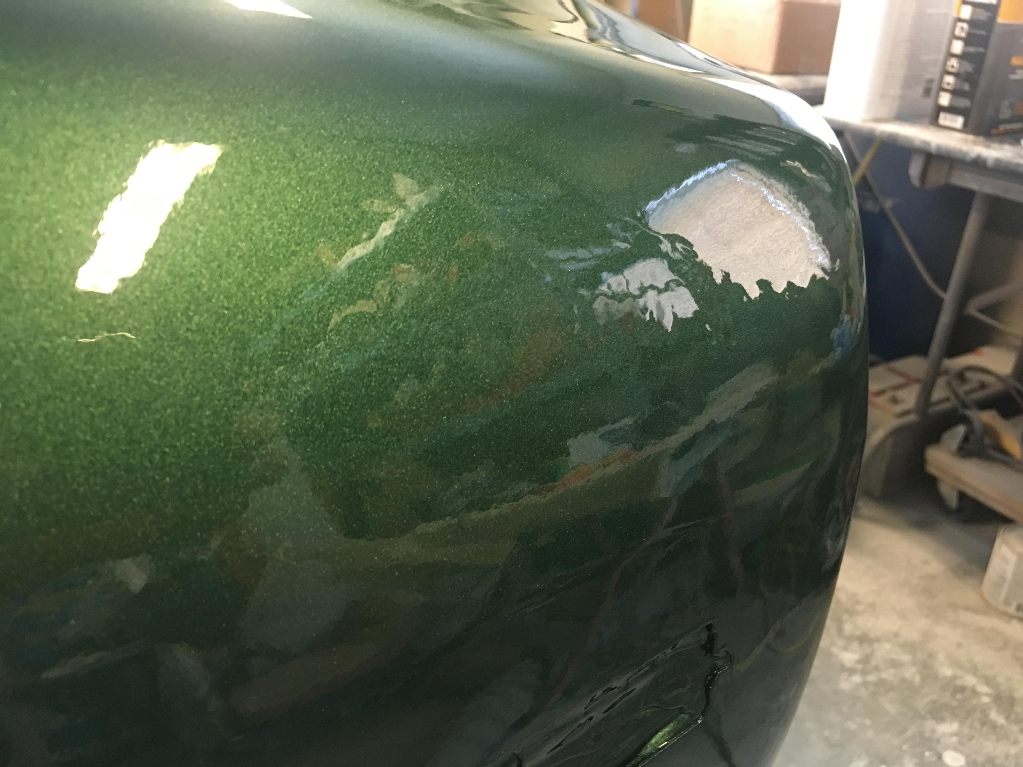

June 13, 20205 yr comment_601106 I hope the second pic is before? What grit did you start with? Link to comment https://www.classiczcars.com/forums/topic/50908-1976-280z-restoration-project/?&page=272#findComment-601106 Share on other sites More sharing options...
June 13, 20205 yr Author comment_601109 I had some clearcoat run in the cold. It didn’t set up as fast and by the third coat it hard started to sag. I used 1500 then 2000 then 2500 then 3000 then random orbital dual action polisher. Link to comment https://www.classiczcars.com/forums/topic/50908-1976-280z-restoration-project/?&page=272#findComment-601109 Share on other sites More sharing options...

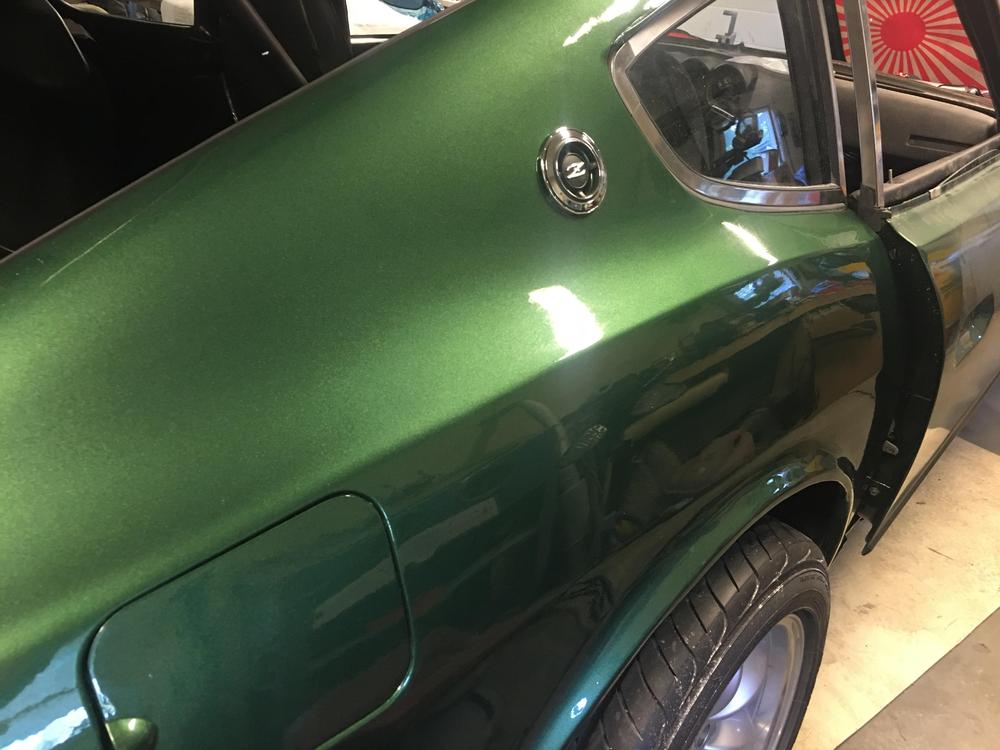

June 16, 20205 yr Author comment_601299 A little more wet sanding and paint correction tonight. Link to comment https://www.classiczcars.com/forums/topic/50908-1976-280z-restoration-project/?&page=272#findComment-601299 Share on other sites More sharing options...
June 17, 20205 yr Author comment_601357 1000/1500/2000/3000 grit then cutting pad and swirl and haze remover. This is about an 80% solution to the finished panel. I will do a complete polish after the car is all sanded. Edited June 17, 20205 yr by wheee! Link to comment https://www.classiczcars.com/forums/topic/50908-1976-280z-restoration-project/?&page=272#findComment-601357 Share on other sites More sharing options...

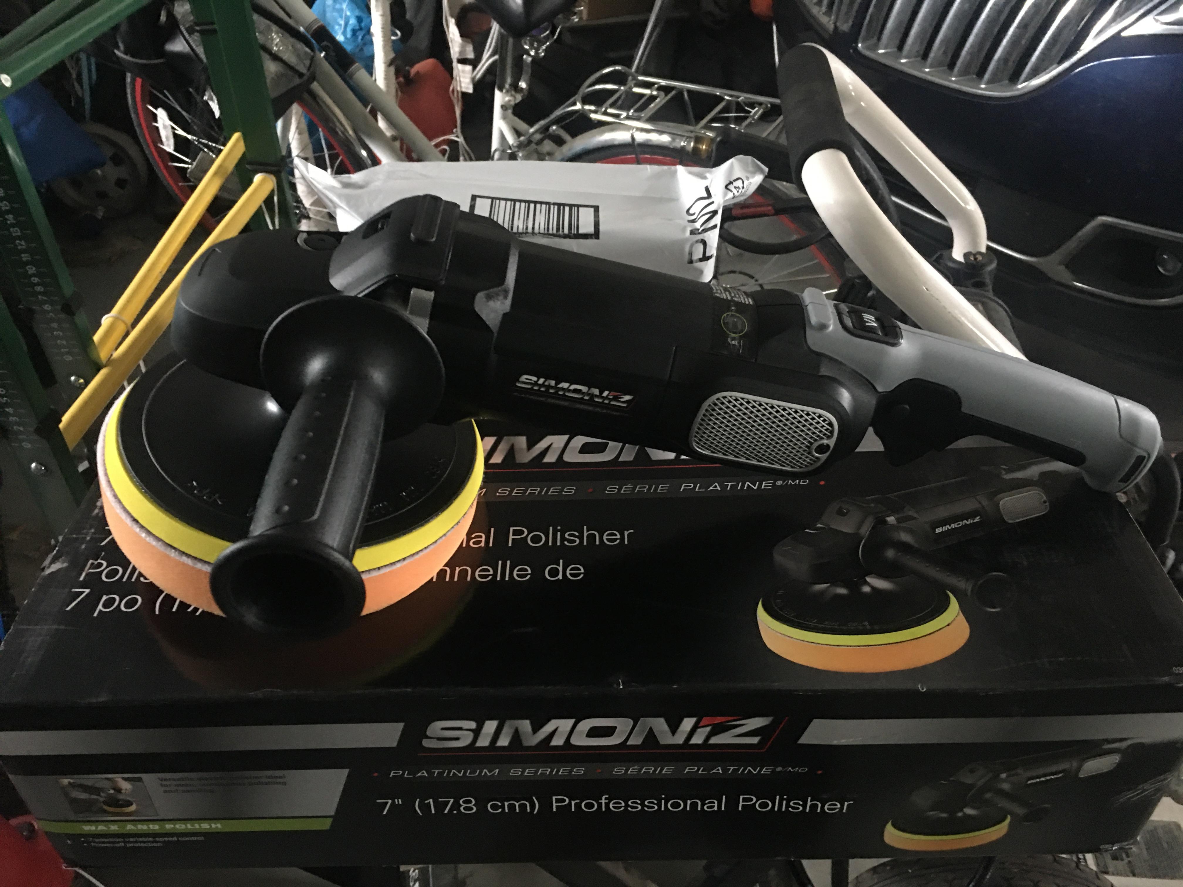

June 18, 20205 yr Author comment_601405 Couldn’t resist picking up this polisher today. It was on sale and will go nicely with the DA I already have. Link to comment https://www.classiczcars.com/forums/topic/50908-1976-280z-restoration-project/?&page=272#findComment-601405 Share on other sites More sharing options...
