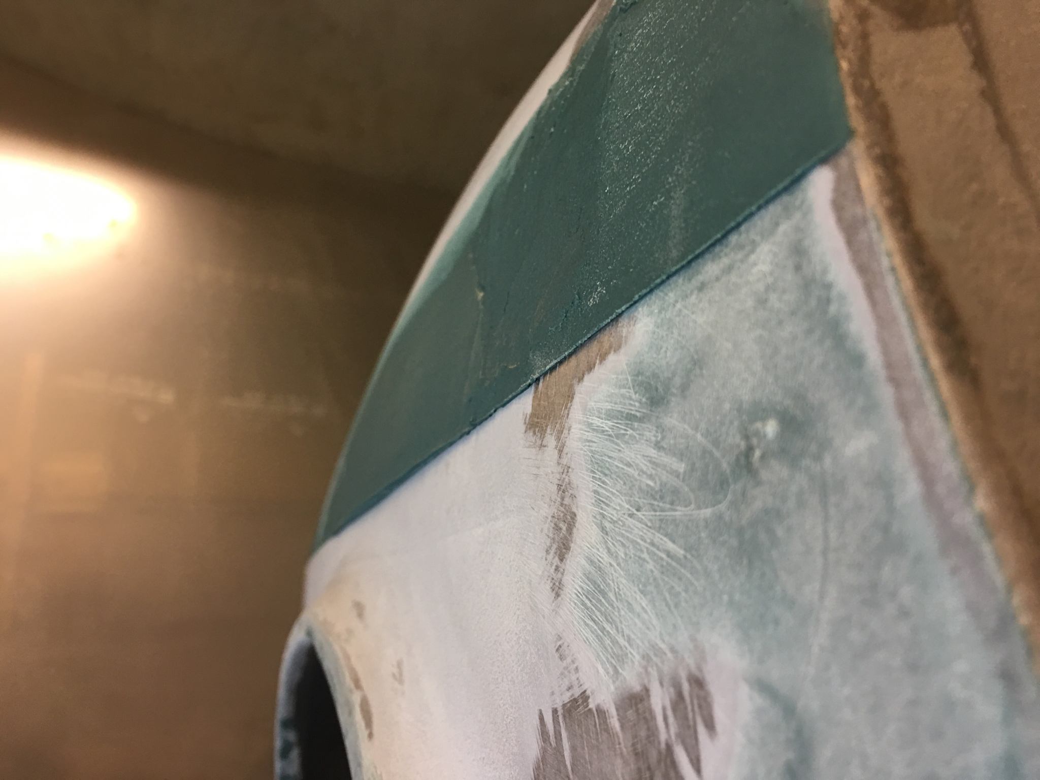

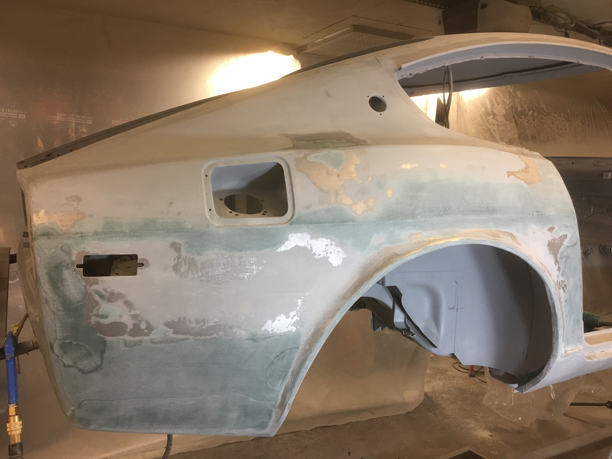

April 24, 20178 yr Author comment_518973 Prepping the passenger side for the crease redefining...Did some work on the wheel well lip outside edge to help define it better too. Link to comment https://www.classiczcars.com/forums/topic/50908-1976-280z-restoration-project/?&page=106#findComment-518973 Share on other sites More sharing options...

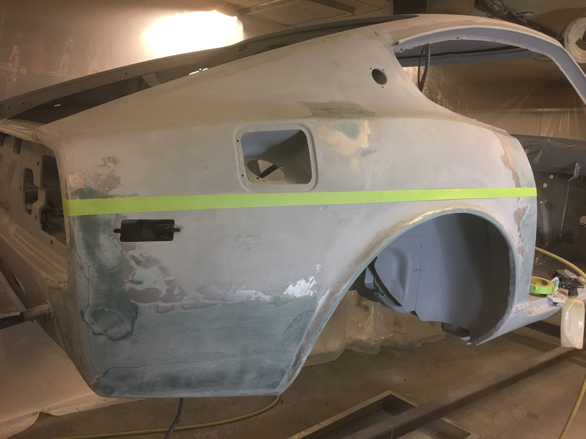

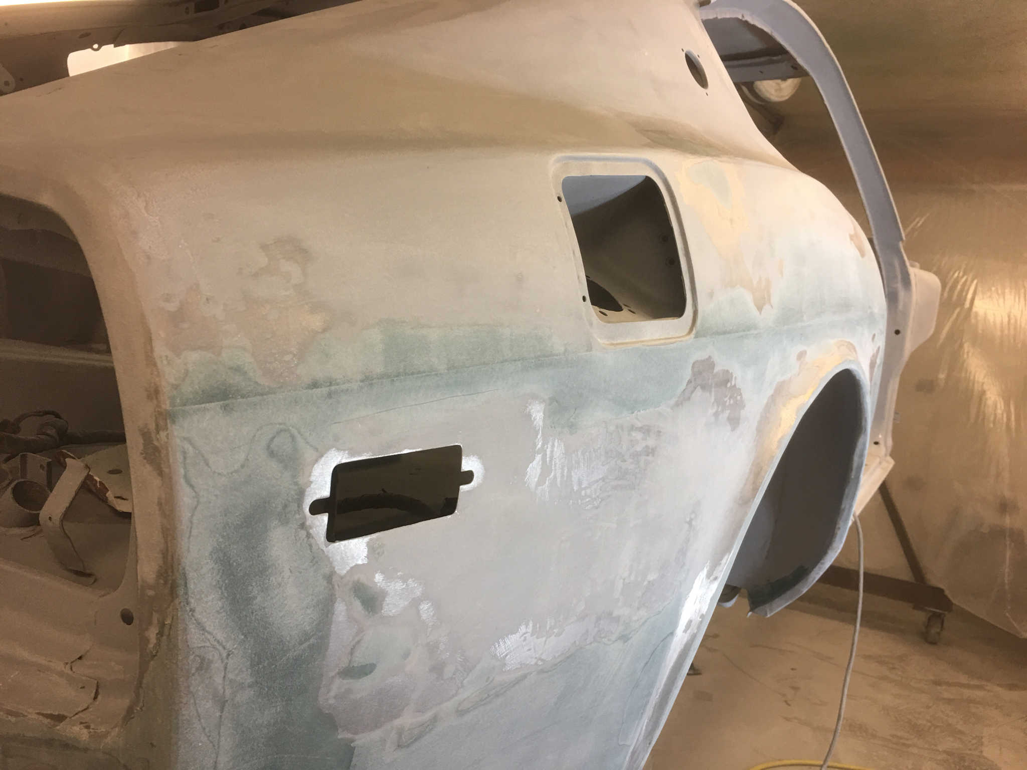

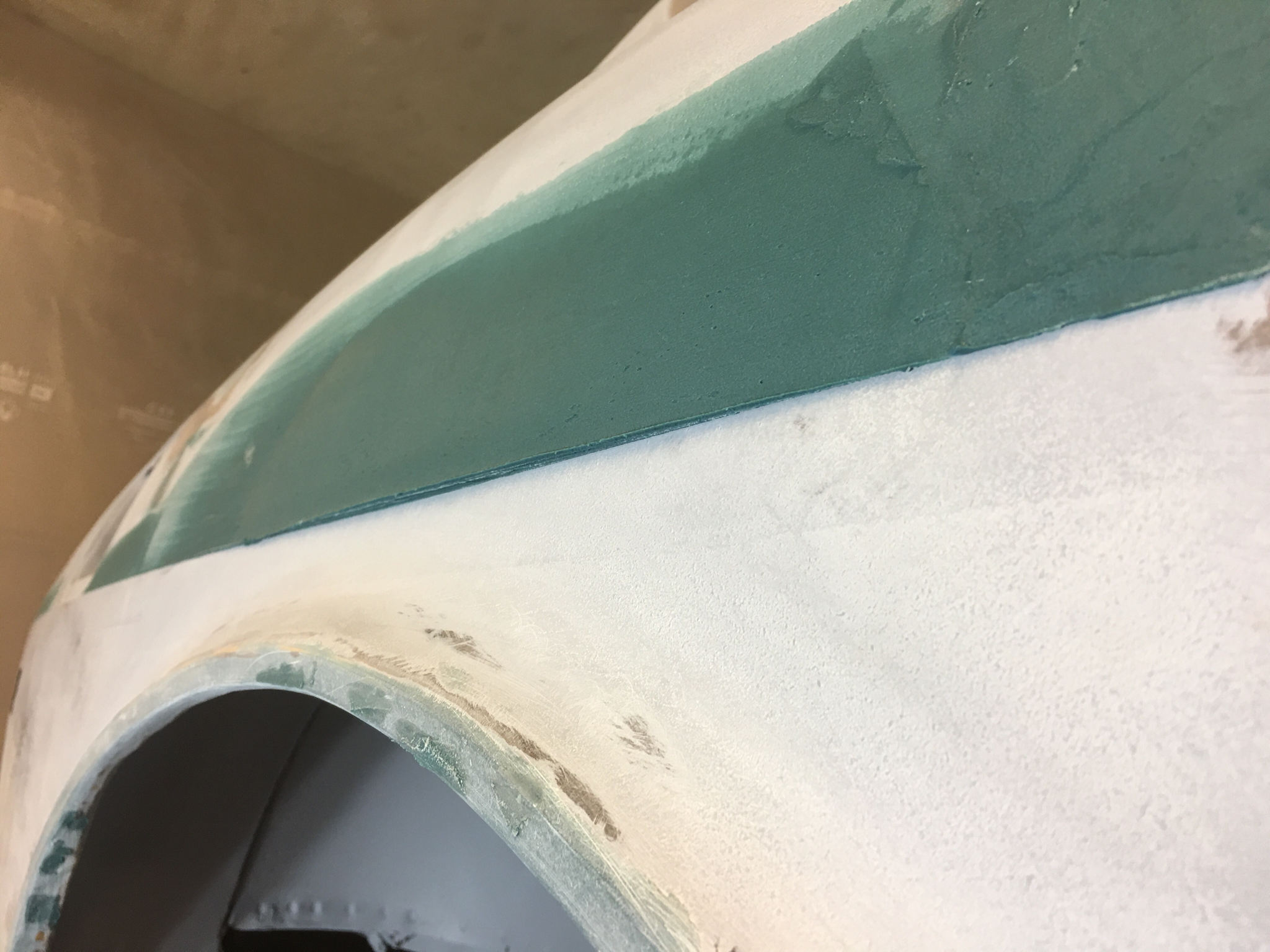

April 25, 20178 yr Author comment_519075 Crease work! Like Oilers goalie Cam Talbot! Some pics showing the build up I did on the tape line. I layer the tape in areas that are low. When the tape looks like the right shape or close, I fill to the tape. Then I tape over the new fill before sanding and fill to the tape line from below. This gives me a nice shape and curve to do final work to. Link to comment https://www.classiczcars.com/forums/topic/50908-1976-280z-restoration-project/?&page=106#findComment-519075 Share on other sites More sharing options...
April 25, 20178 yr comment_519085 Nice work! Â Are you working the filler when it is just starting to setup and it's still a little soft or waiting until it's fully cured? Â That dark green stuff is hard to sand! Â Are you using the eastwood stuff? Link to comment https://www.classiczcars.com/forums/topic/50908-1976-280z-restoration-project/?&page=106#findComment-519085 Share on other sites More sharing options...
April 25, 20178 yr Author comment_519090 I'm using a Pro-glass/Kevlar blend. It sets up quick, 2-3 minutes so I get the small batches on quick, smooth it out and let it harden for 10 minutes before sanding with a 120 grit RO electric sander. It is hard to get a nice flat surface with the RO, so I get it close and will finish the surface later with a smooth Pro filler, no glass. Â Link to comment https://www.classiczcars.com/forums/topic/50908-1976-280z-restoration-project/?&page=106#findComment-519090 Share on other sites More sharing options...
