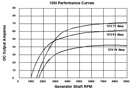

Your numbers look normal and don't show any functional problems with the system.  Your alternator is just on the weak side.  They don't put out their rated current at low RPM, only at high (see attached).  Pretty common.  A different alternator, same style, might solve the problem.  It's kind of a crap shoot unfortunately.

I've found also that the numerous corroded/old/dirty connections each draw a little bit more current than they were designed to.  Cleaning them up will help a little bit.  Also, as you can see from the chart I attached above, another 50-100 RPM in idle speed can get quite a bit more juice flowing.  You might get to a happy spot with just a few tweaks.
