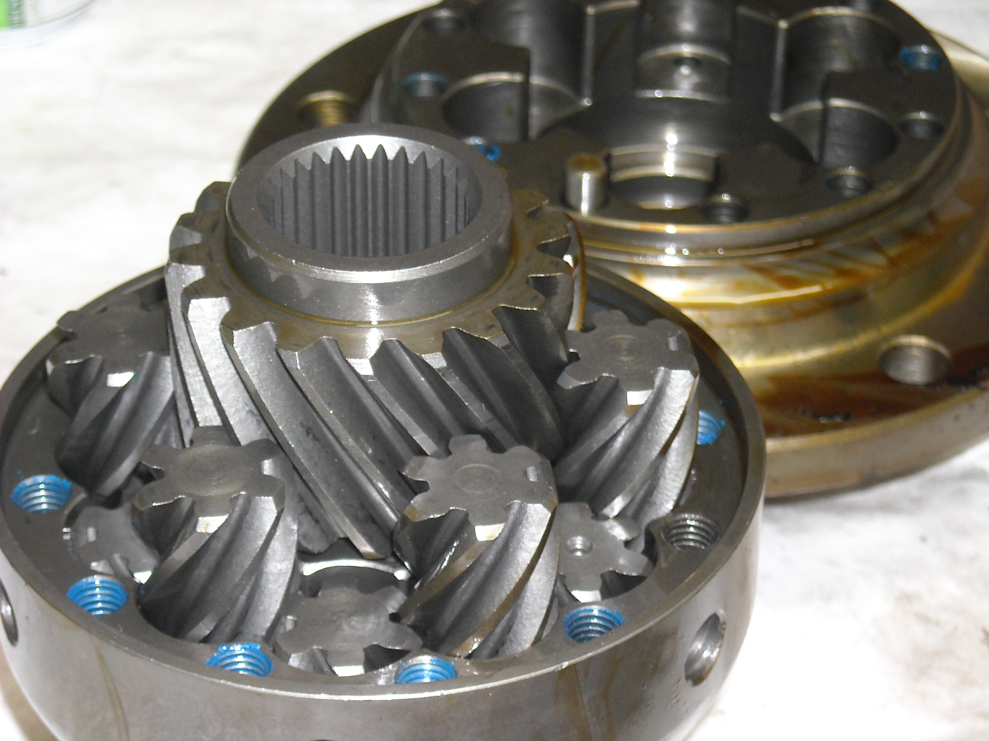

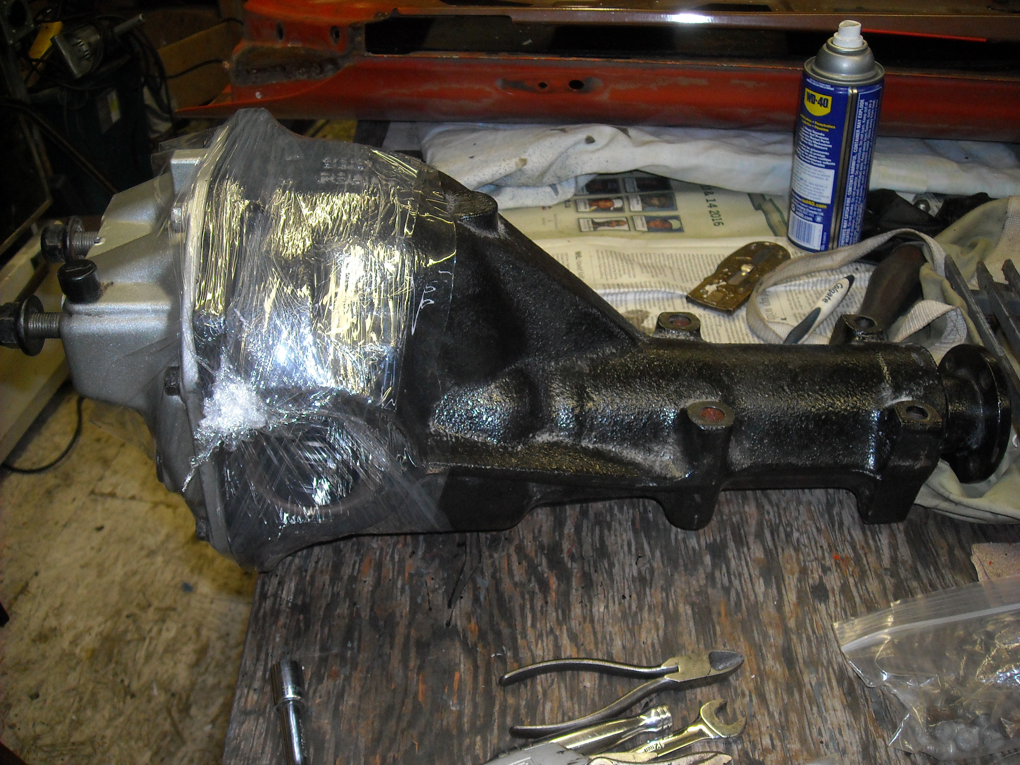

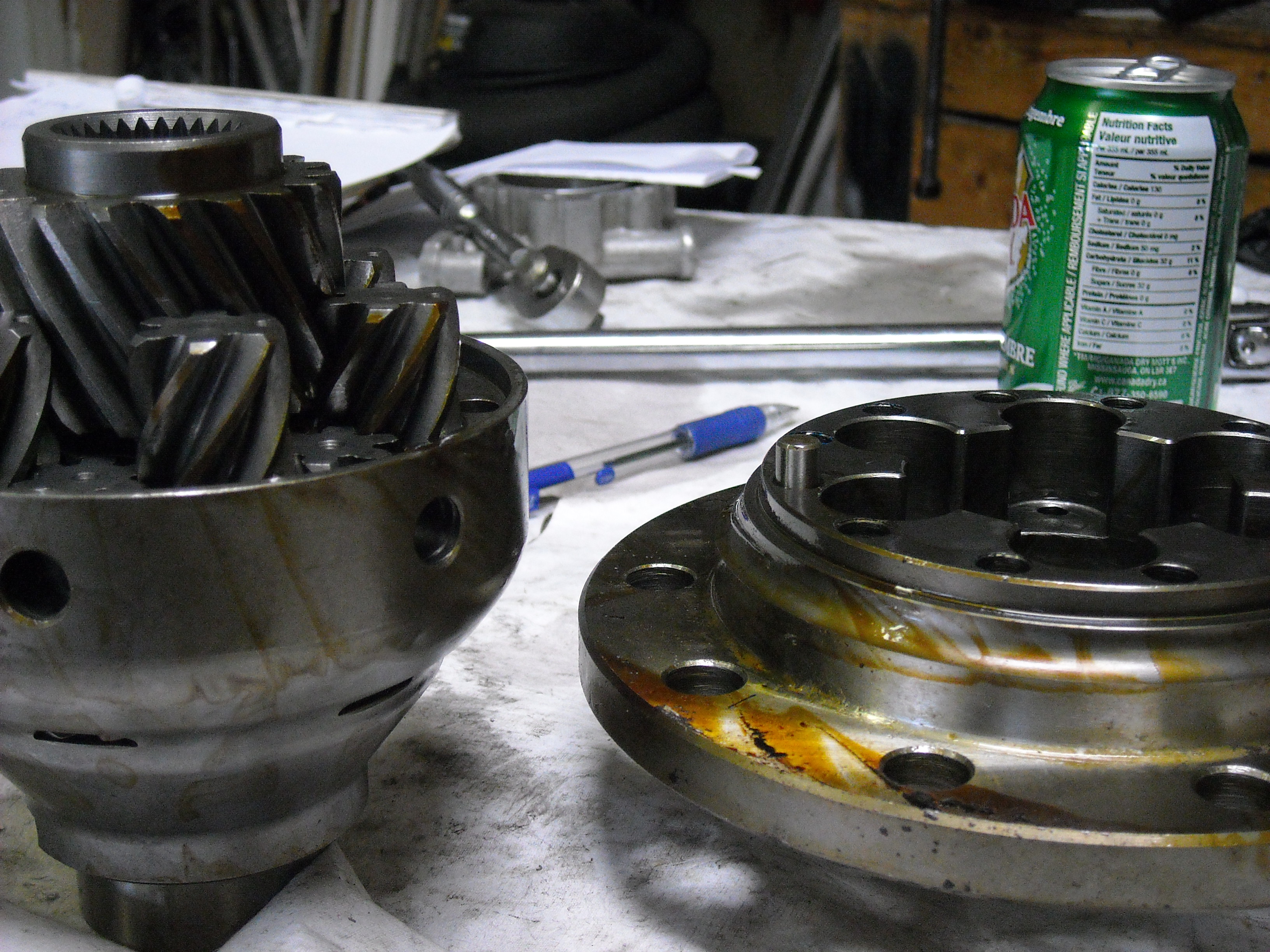

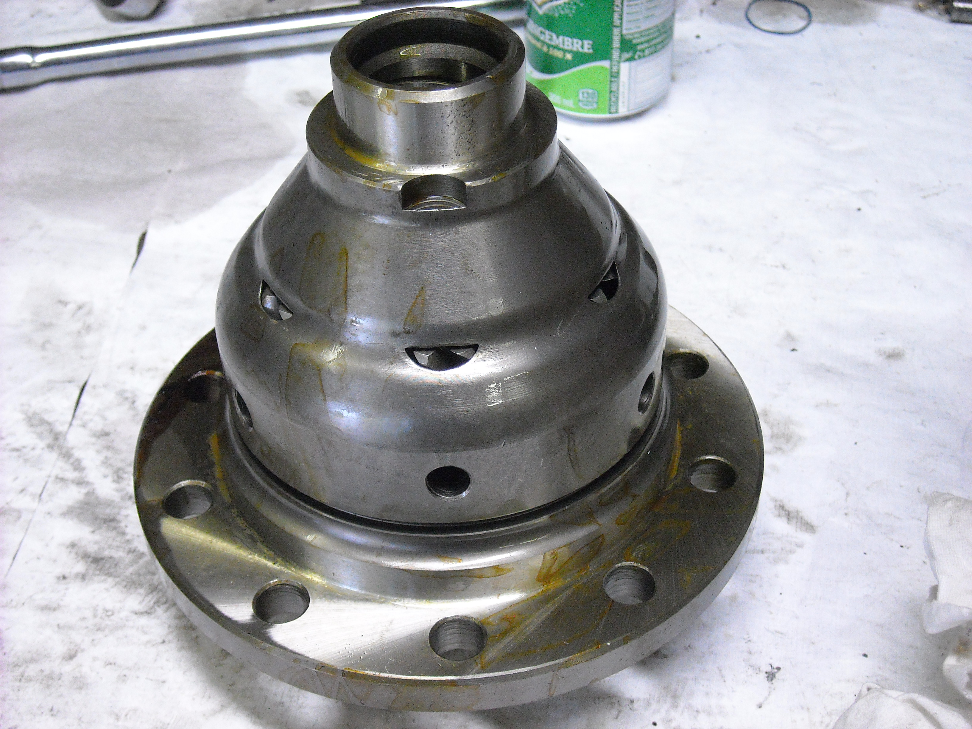

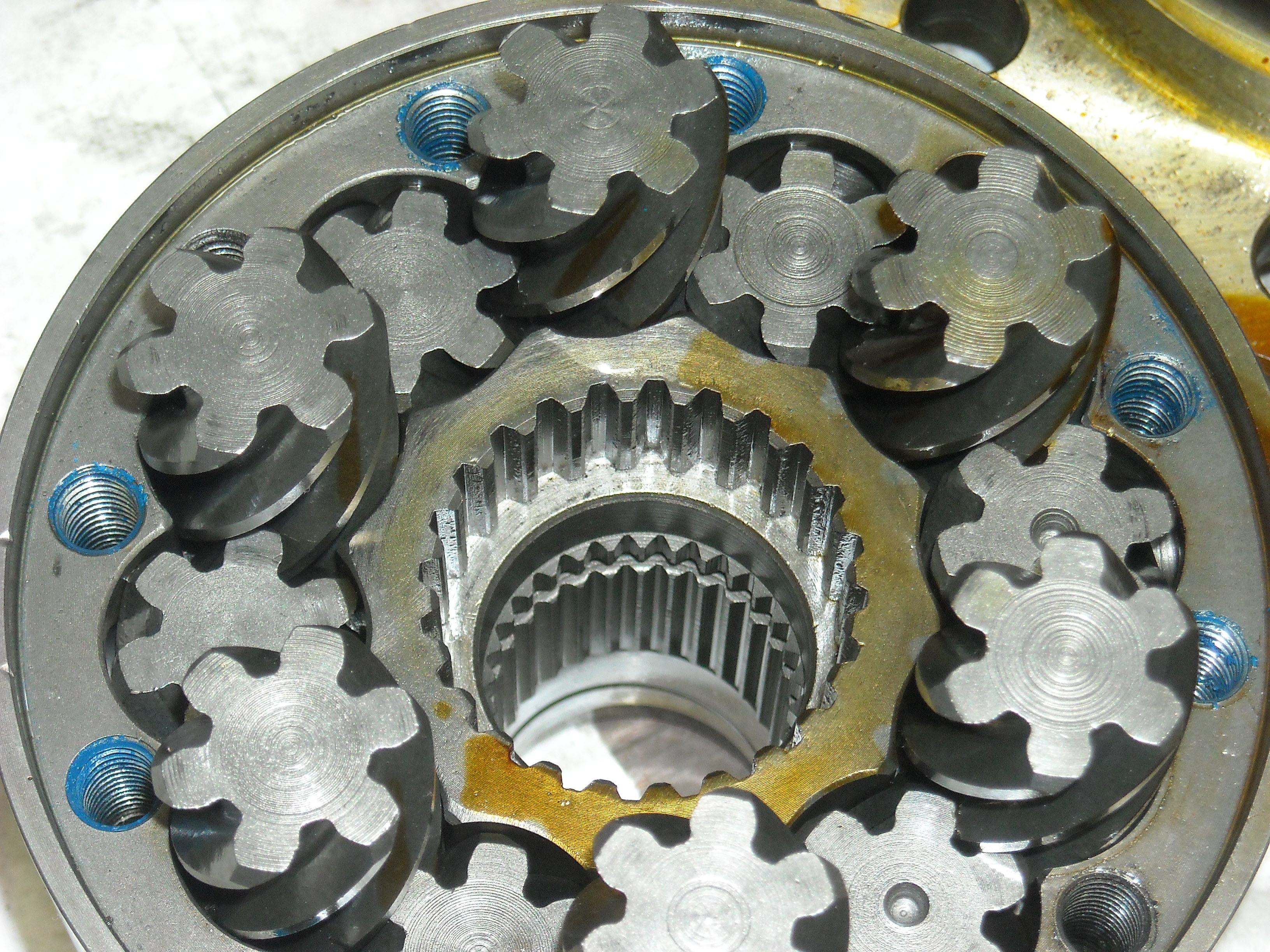

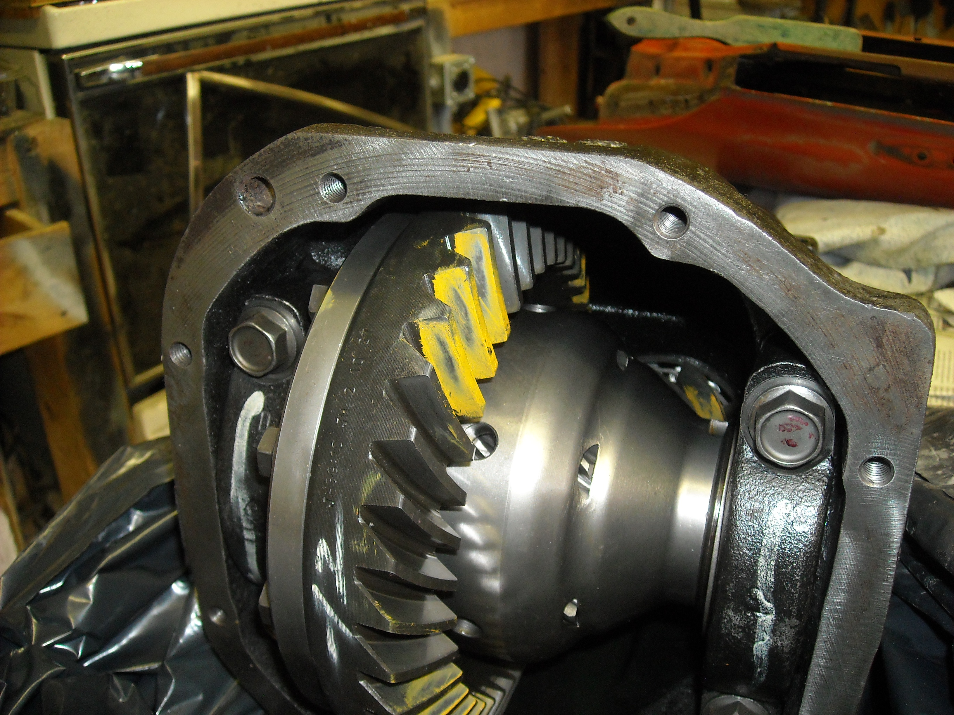

February 11, 20169 yr Author comment_486342 Oh it's still happening, just trying to get the 1970 Z finished and ready for sale in the spring, when that is gone I'll have some money and space to work on the ///MZ. I was just looking at this lovely 240Z, http://www.speedhunters.com/2016/02/os-giken-power-americas-exotic-240z/    I'm having a hard time believing those numbers, 376hp, 281 ftlb torque at rear wheels from a 3.3L with carbs. Granted, you have a team of very talented guys and probably a bottomless budget and I suppose the torque number could be accurate but the hp sounds a bit puffed up. This engine that I'm using is the same configuration with 3.5L and FI through 6 independent TB and could get near that hp without a turbo. Rossiz, these pics of the OBX limited slip diff are for you, I had to disassemble it and clean up the hardened on lube they use at the factory, flip the gears 180 degrees and replace the soft cone washers but it's already to install in the R200 diff now. Chris  Link to comment https://www.classiczcars.com/forums/topic/50240-thinking-about-installing-an-bmw-m6-engine-in-my-z/?&page=7#findComment-486342 Share on other sites More sharing options...

April 23, 20169 yr Author comment_493369 The other Z is almost sold and then it is full speed ahead on this build. Picked up some new bearings and stub axle clip rings for the OBX, got as much done as I could then took it up to the Differential shop to have them install the OBX unit in the R200 and adjust the free play, very pleased with the wipe pattern. I'll tuck it away on the shelf now ready for installation, hopefully it will be a quite unit. Link to comment https://www.classiczcars.com/forums/topic/50240-thinking-about-installing-an-bmw-m6-engine-in-my-z/?&page=7#findComment-493369 Share on other sites More sharing options...
April 23, 20169 yr comment_493409 Thats a very nice wipe pattern Chris. It should be a nice diff when its in. Link to comment https://www.classiczcars.com/forums/topic/50240-thinking-about-installing-an-bmw-m6-engine-in-my-z/?&page=7#findComment-493409 Share on other sites More sharing options...

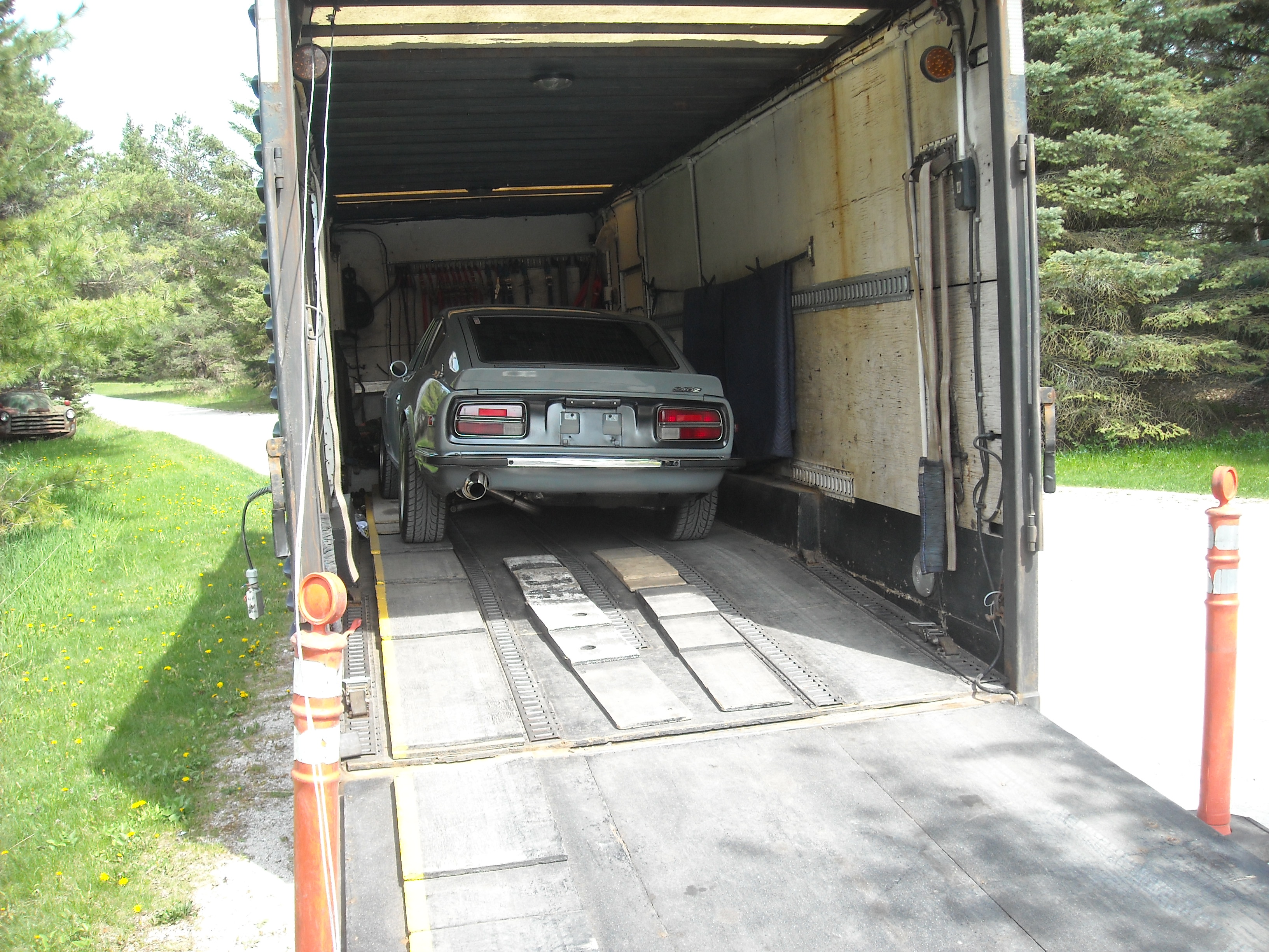

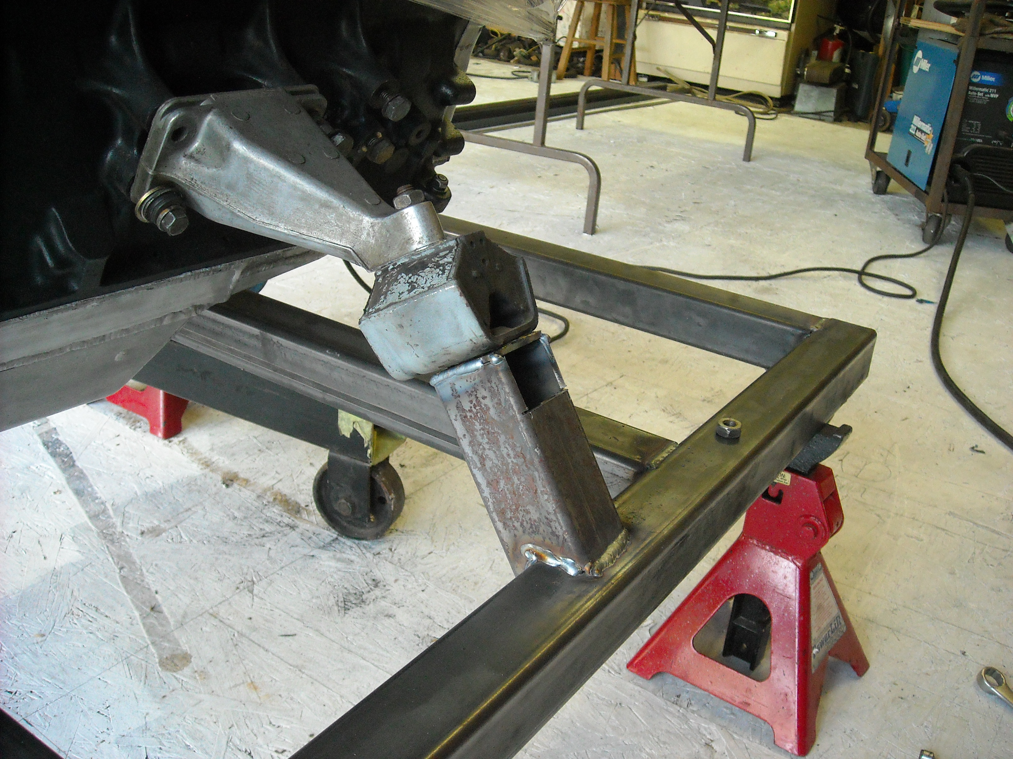

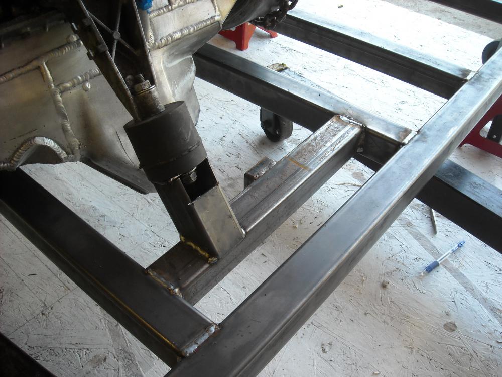

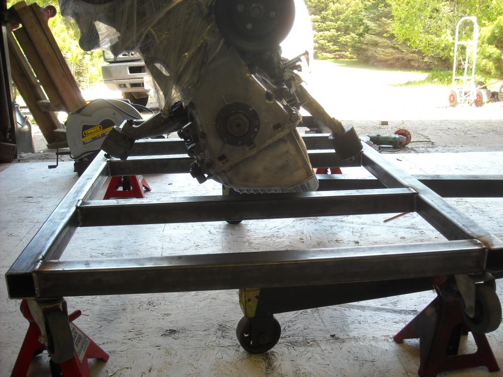

May 12, 20168 yr Author comment_494892 And the show is on again! With the 1970 Z on its way to California now, I finally have my garage space back and a few pennys to rub together for a change. First order of the build is to weld together an engine stand that will also hold the Z dash so I can integrate both of the wiring harnesses and instrument cluster. Good bye old friend. Â Link to comment https://www.classiczcars.com/forums/topic/50240-thinking-about-installing-an-bmw-m6-engine-in-my-z/?&page=7#findComment-494892 Share on other sites More sharing options...

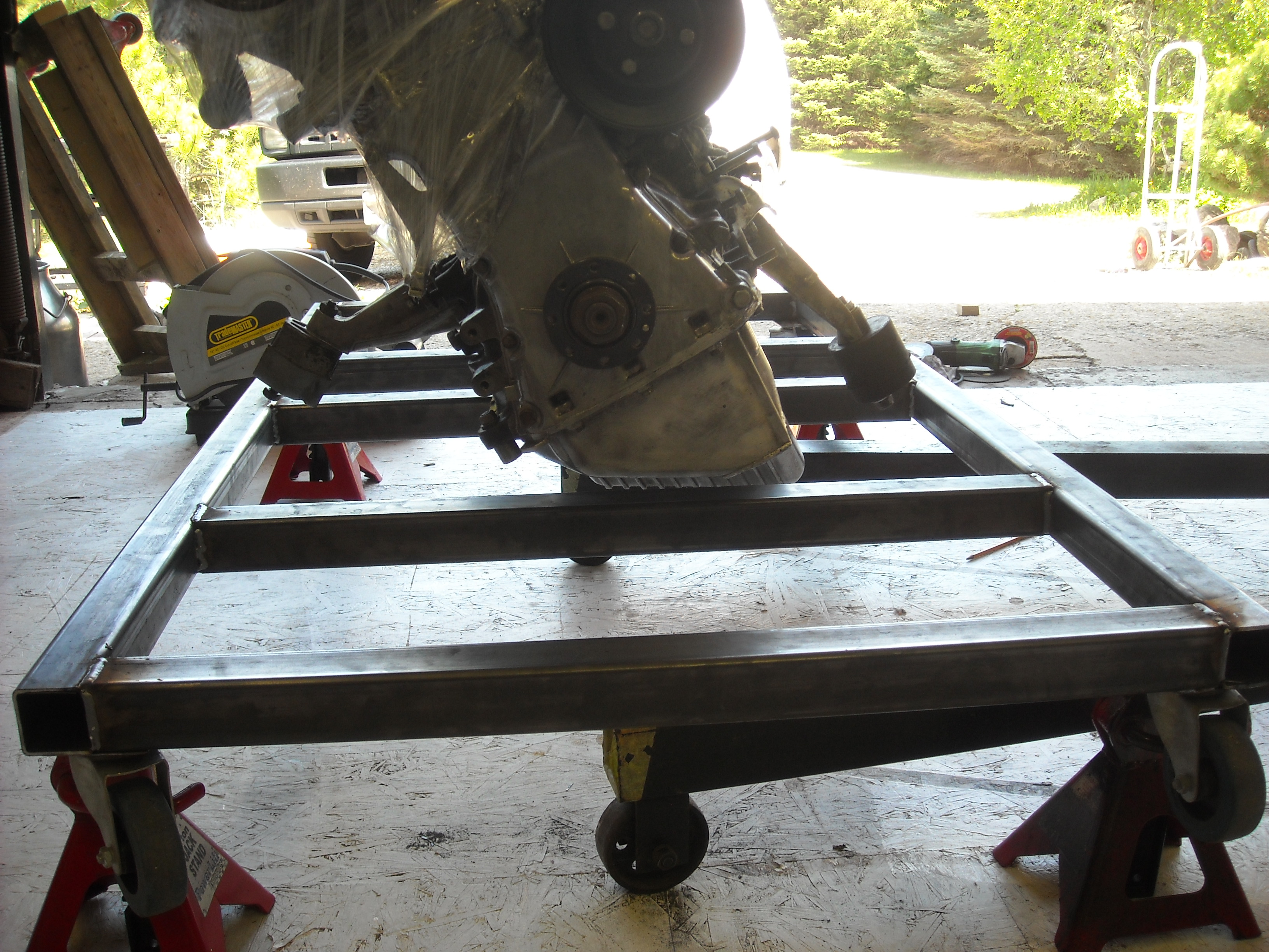

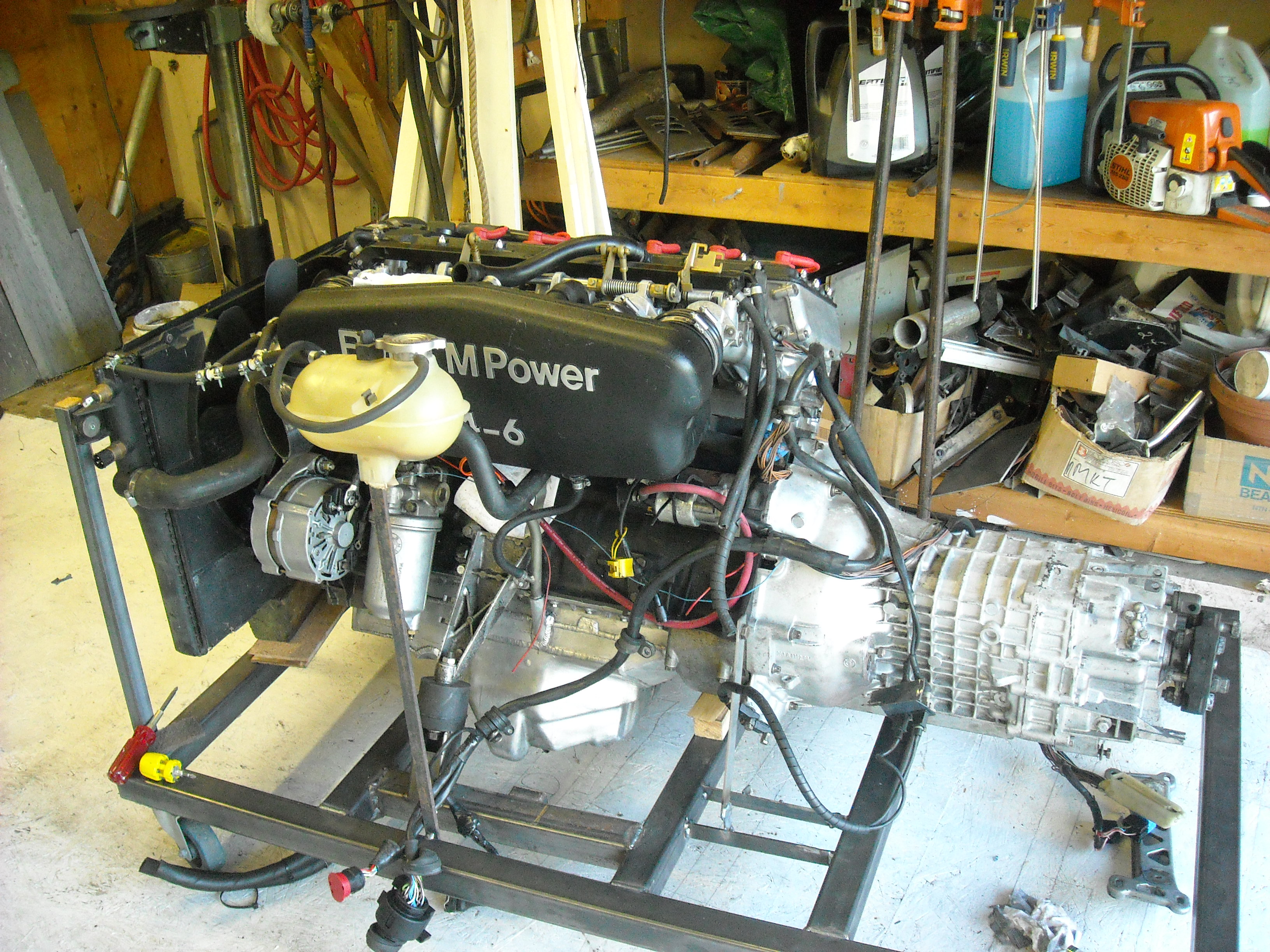

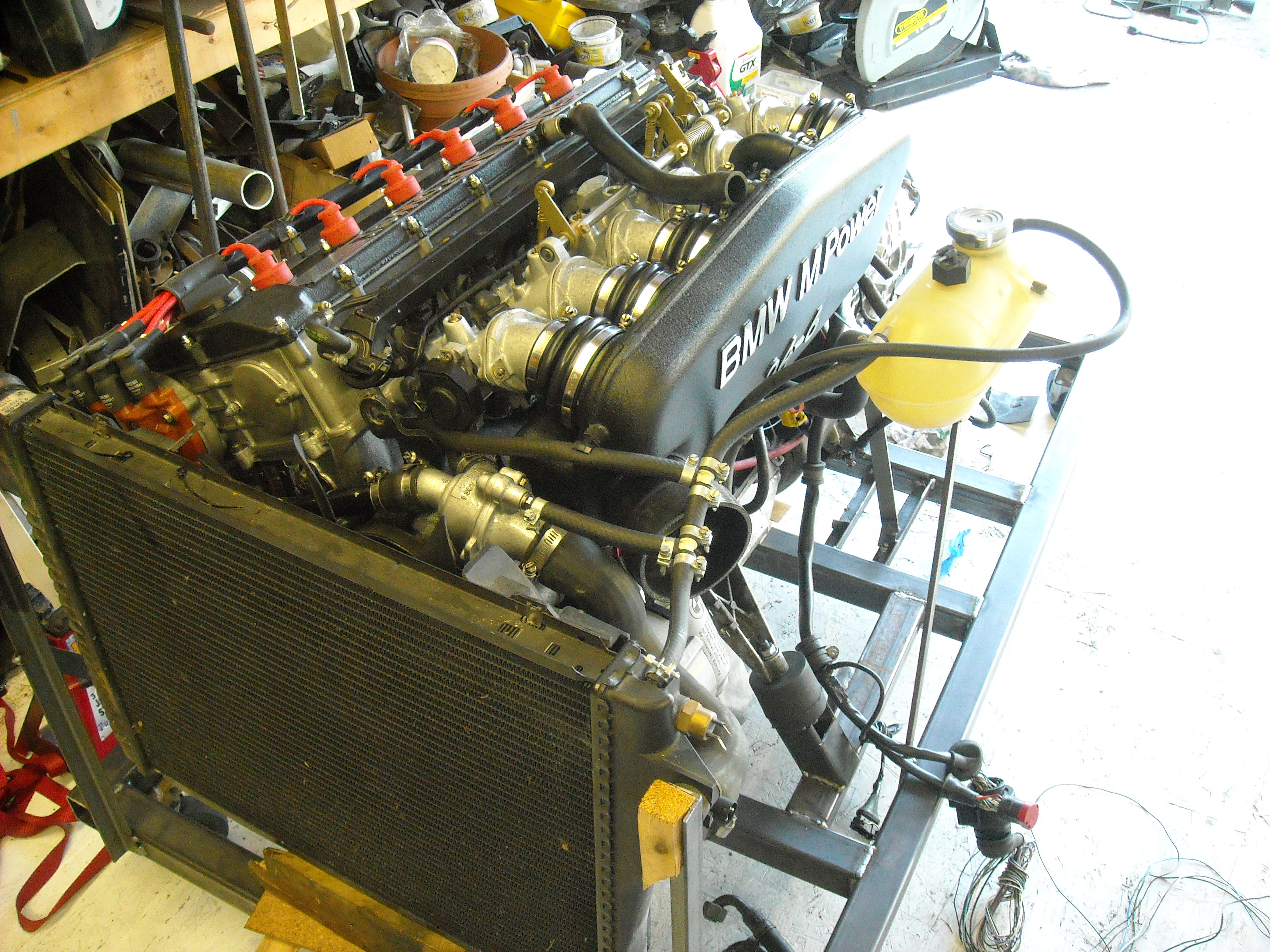

May 22, 20168 yr Author comment_495515 The shop is empty now so it got a fresh coat of paint on the floor, starting to build the test stand. Once the new gauges arrive from Speedhut I'll mount the dash right behind engine so I can get the wiring laid out properly. After I get the engine running with all the systems working and ready to install I'll cut off all the uprights on the test stand and use the base as the dolly for the shell. Link to comment https://www.classiczcars.com/forums/topic/50240-thinking-about-installing-an-bmw-m6-engine-in-my-z/?&page=7#findComment-495515 Share on other sites More sharing options...

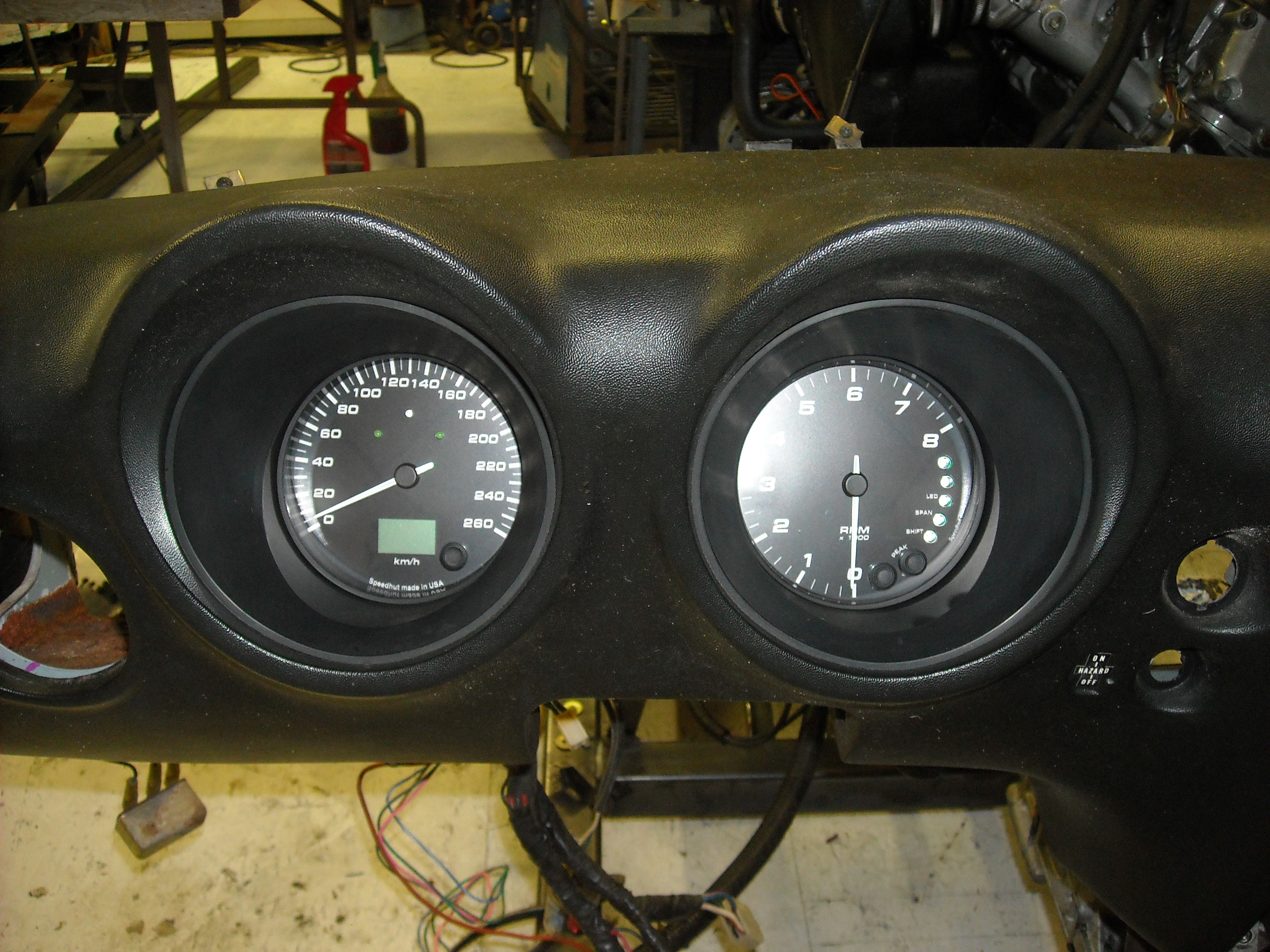

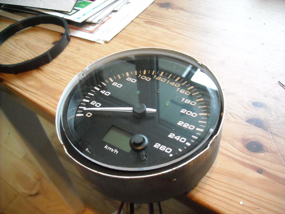

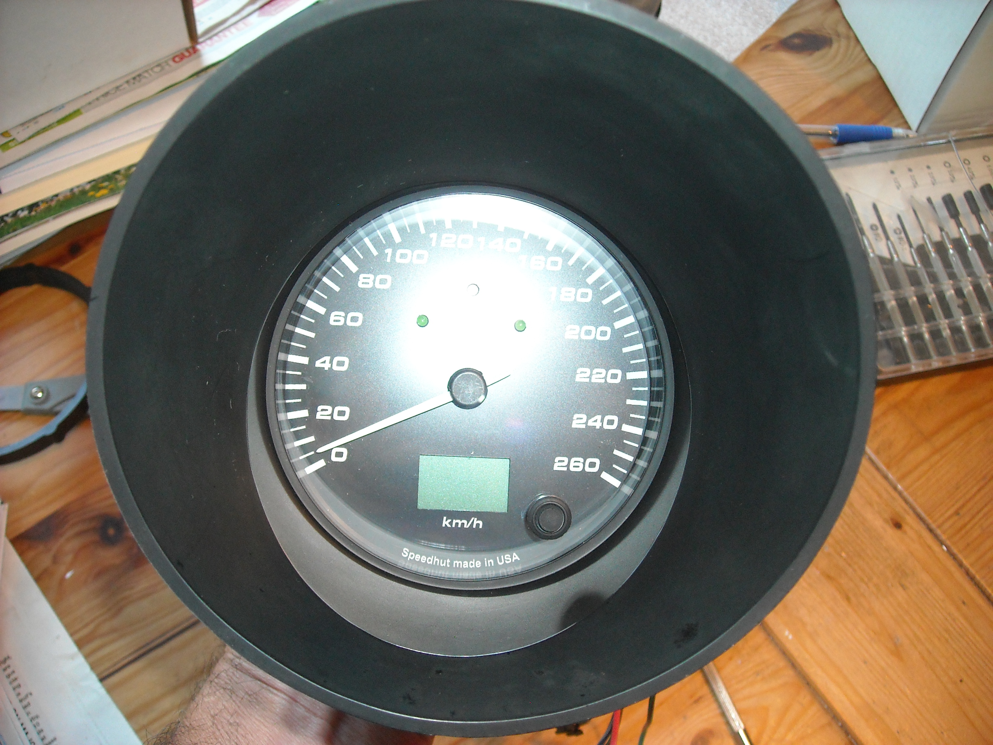

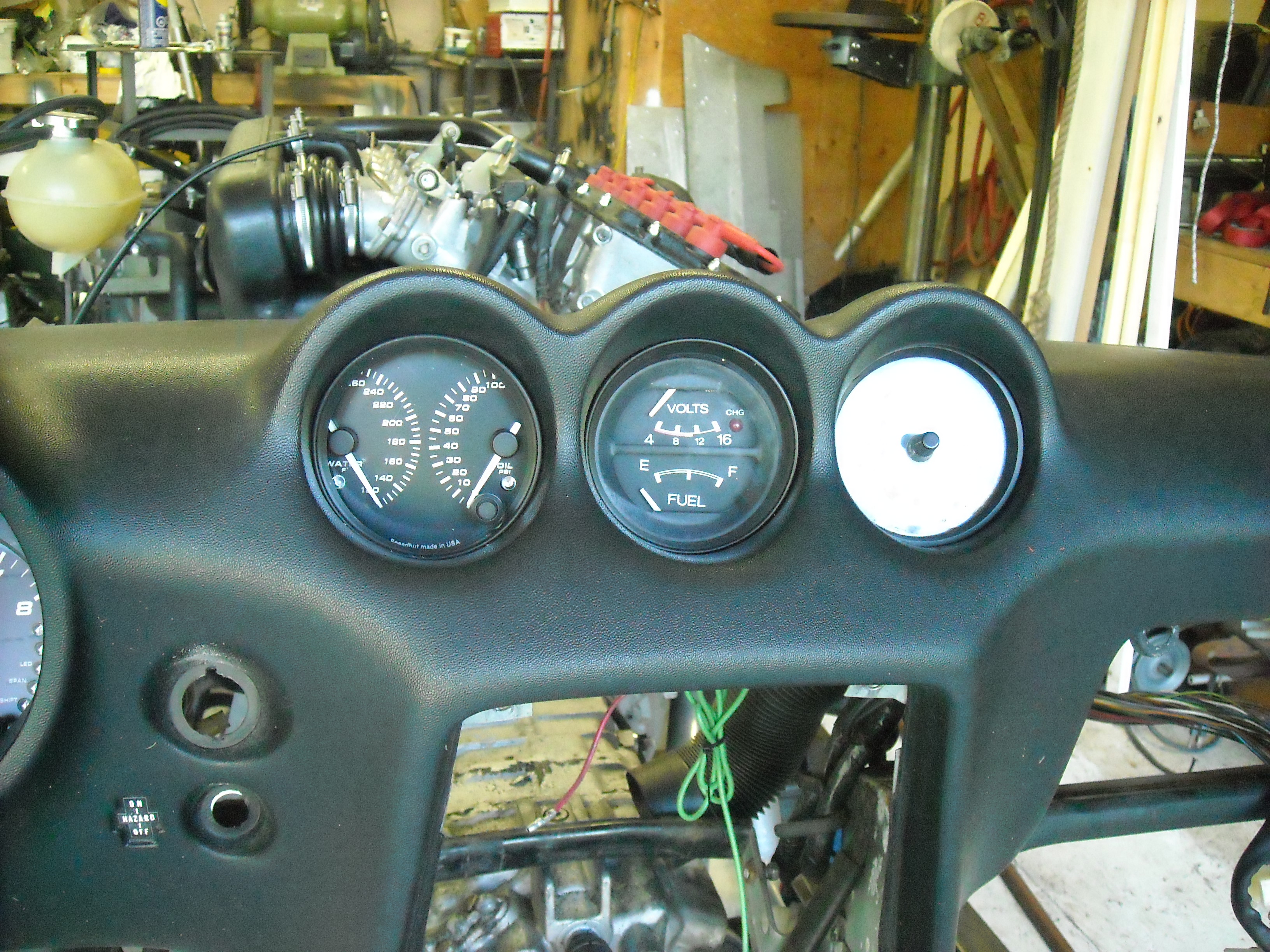

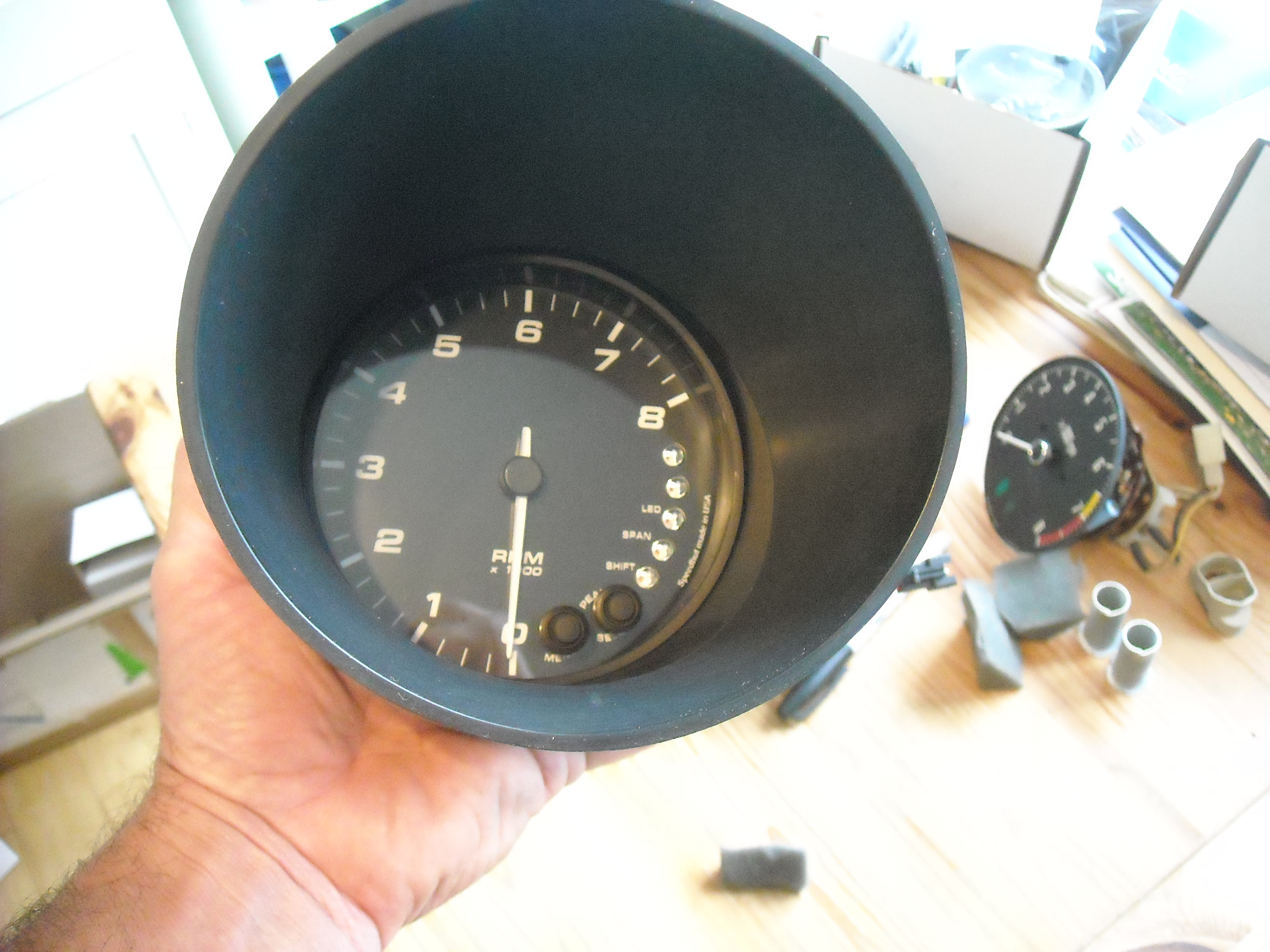

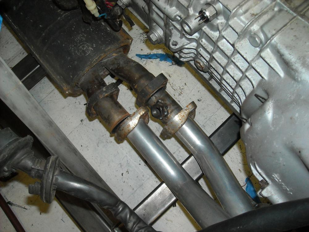

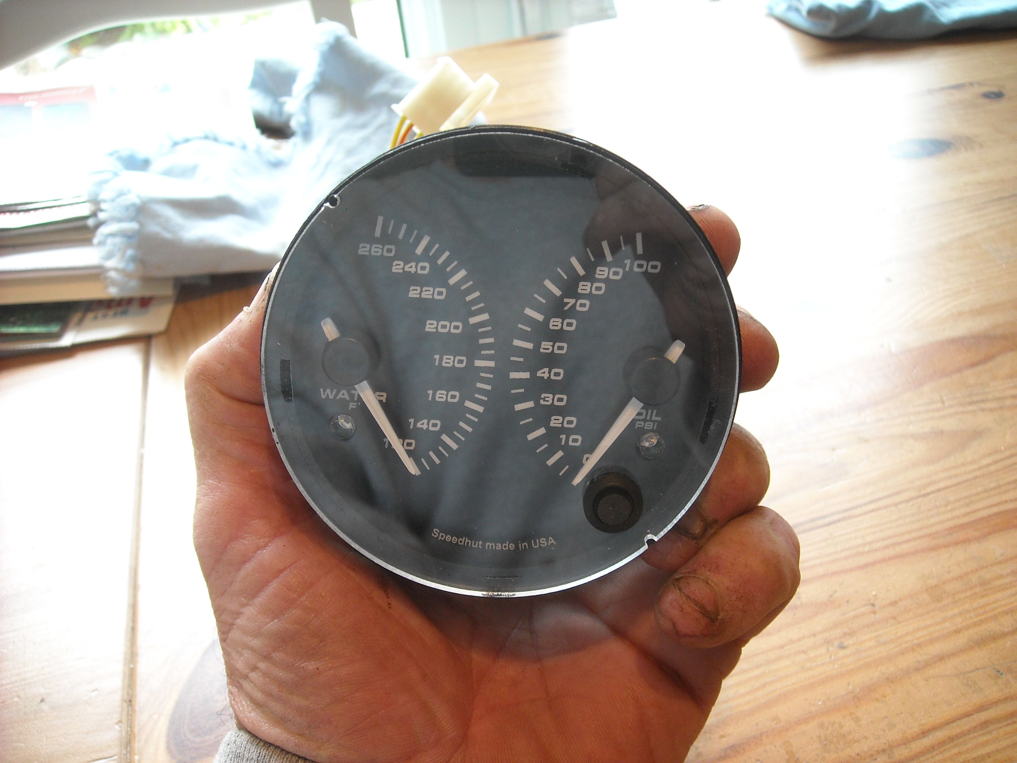

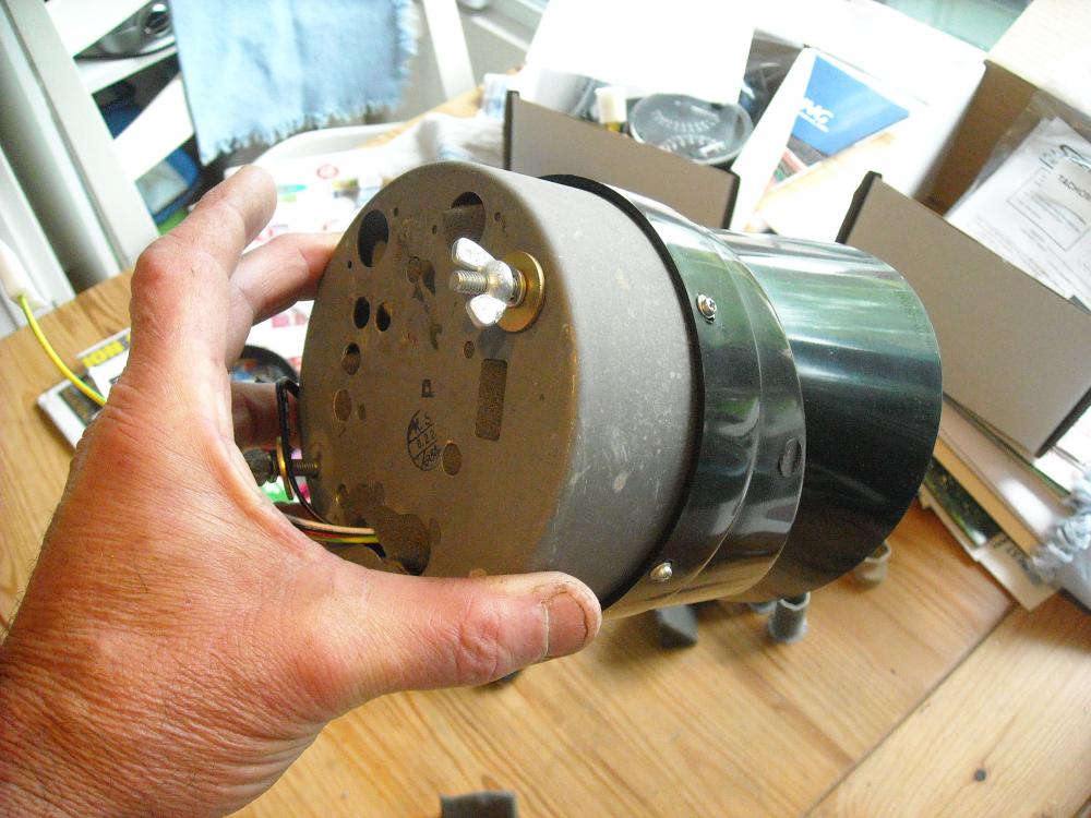

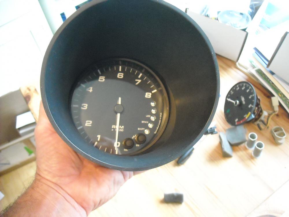

June 8, 20168 yr Author comment_496551 Made a little progress, got the dash rigged up but having a bugger of a time trying hook up the old M6 exhaust so I can use it for the test rig, it does not want to cooperate. The Speedhut gauges arrived, I love them. They let you customize the gauges from very old school to as glitzy as you like and you can dismantle the entire unit without having to fight glue and bizarre fasteners. I went for a look as close to the original gauges as I could, the 4.5" size tach and speedo fit perfectly inside the cannibalized original gauge housing, the water/oil gauge I will have to work on some more to get it to look right. Link to comment https://www.classiczcars.com/forums/topic/50240-thinking-about-installing-an-bmw-m6-engine-in-my-z/?&page=7#findComment-496551 Share on other sites More sharing options...

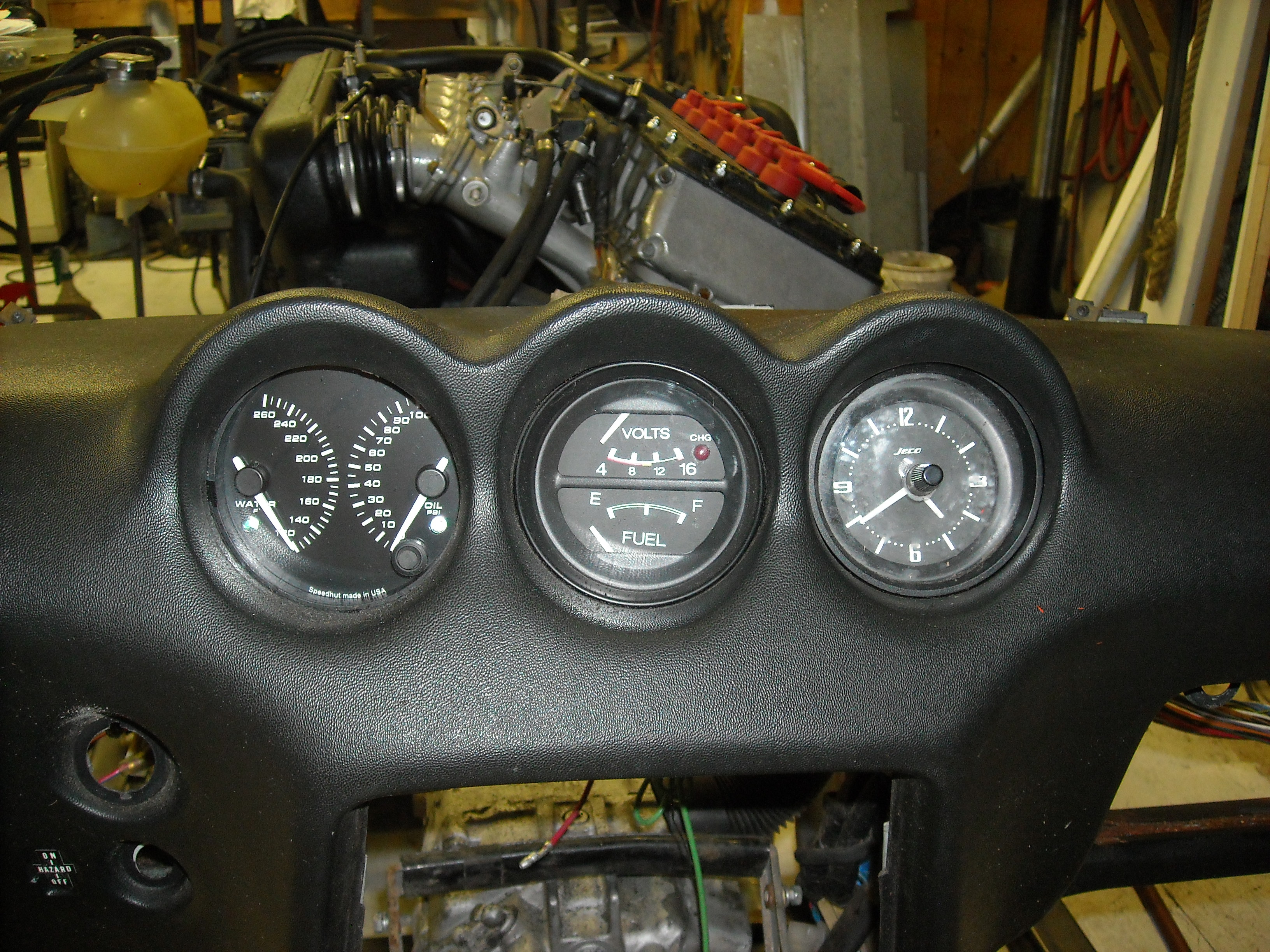

June 13, 20168 yr Author comment_496846 Got the water temp/oil pressure gauge to look a little better, Link to comment https://www.classiczcars.com/forums/topic/50240-thinking-about-installing-an-bmw-m6-engine-in-my-z/?&page=7#findComment-496846 Share on other sites More sharing options...
