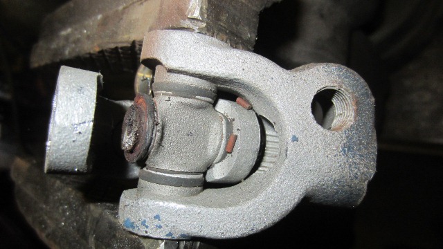

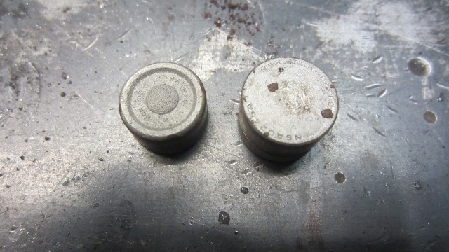

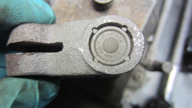

To add to my post about fitment of the ATV700 u-joint. There are at least two quite different styles of steering shaft u-joints. The kind with retaining "C" clips an those that are staked in place.
I believe this has been discussed previously. It appears the early cars got the c clip retained ones, then they moved to the staked style.
The staked style are easy to get apart. Well, not if you want to save the old u-joint, but you don't right? That's not the issue.
The problem is the staked ujoints have a 15mm cap, the C clip style caps are 16mm..
The other dimensions appear the same. The ATV700 u-joints cannot work with those yokes. There is even no provision for the C-clip is you could get them in place.
I pulled all my steering shafts and found that most are the staked later style, no surprise there. So back to the search for a u-joint that is the smaller size. Or get the yoke holes bored to 16mm...
Cap difference on the left, staked u-joint picture on the right.
I also tried to drill through one of the u-joint yokes to get a grease injection port. Don't know what that stuff if made of, but none of my excellent quality drill bits would do more then scatch it..... Somehow a plazma torch didn't seem right....
Anyone have some early steering shaft assemblies they don't want?
Edited by zKars
Seeing as how the yoke is actually the inner race for the rollers, I'm sure it's hardened.
