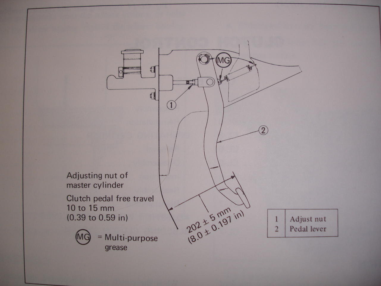

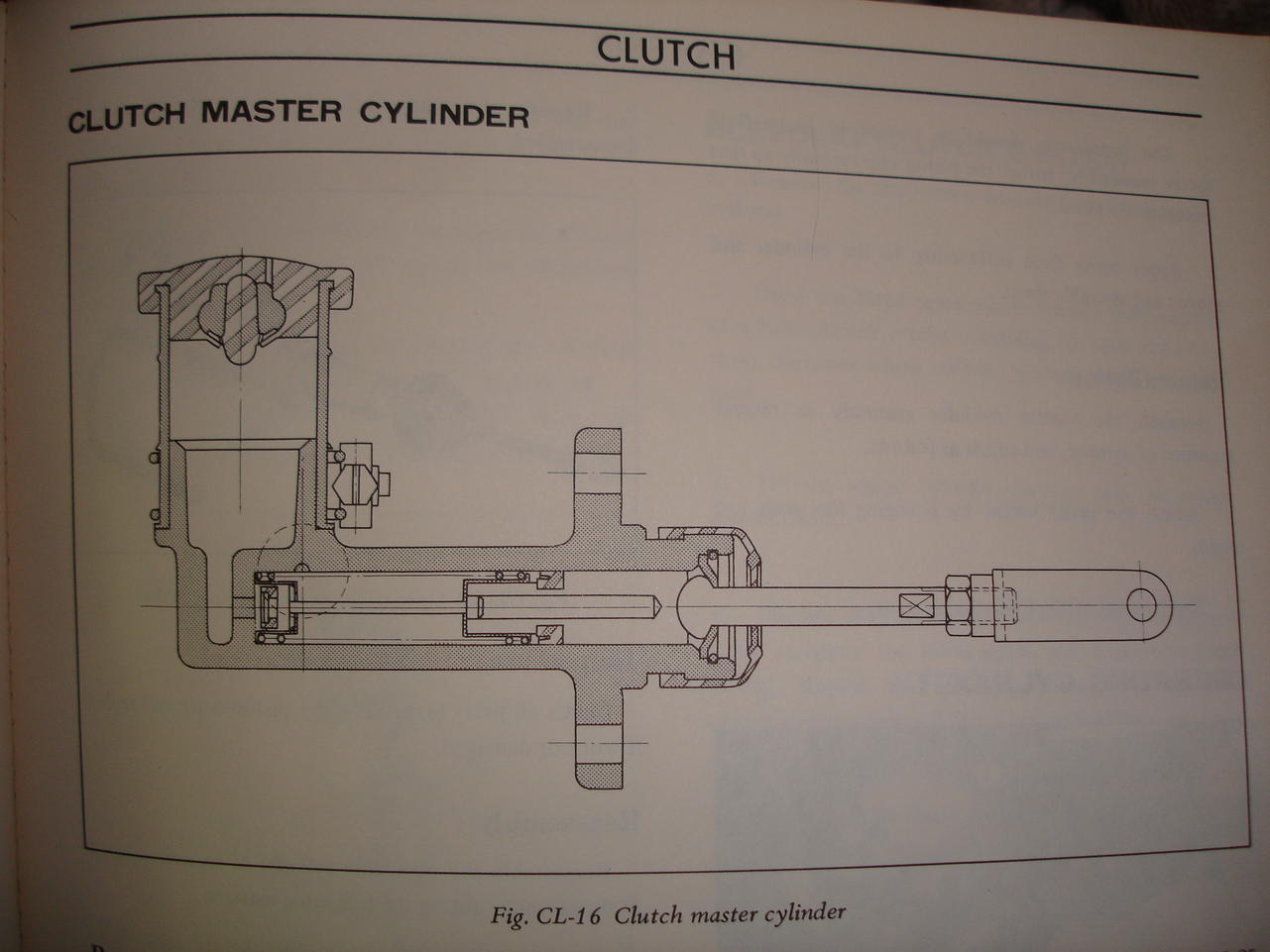

I have rebuilt what I think is a Series I 240Z Clutch Master Cylinder made by Nabco (5/8" bore) for my 12/70 built car. After rebuilding and installing I noticed that it touches the Windshield Washer Bottle. Having said that, I consulted the Factory Service Manual and it shows a cross section illustration for two separate and distinct profiles (see attached images). On page CL-6, Figure CL-15, the reservoir is shown being located in the center area of the Master Cylinder. Yet if you refer to page CL-7, Figure CL-16, you will note that the reservoir is at the frontmost portion of the Master Cylinder.
I have tried to research other threads, but there seems to be an absence of good images to refer to. I have understood that a 260Z Clutch Master Cylinder may be slightly longer than than of the 240Z units, is it possible it might be for a 260Z? I was always led to believe that the 260Z units moved the reservoir towards the center. Could someone please chime in on the known differences between model years.

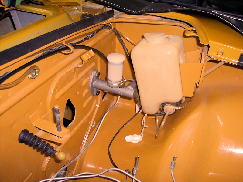

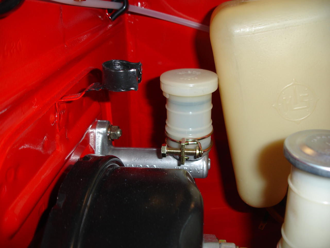

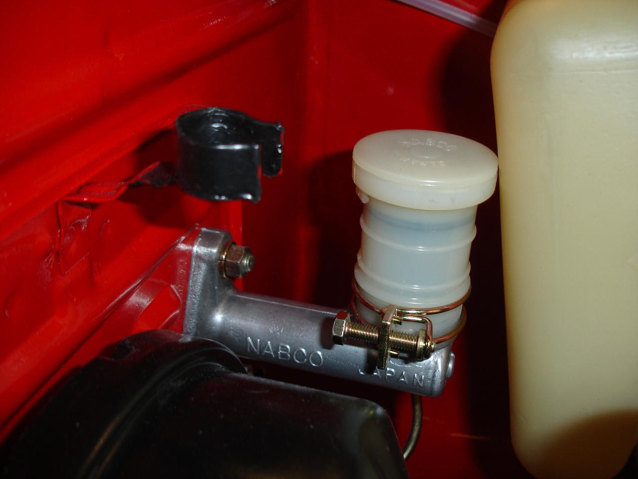

Here's my replacement clutch master, also a 5/8" bore - visible on the side. Unfortunately there is no mfr. brand on the casting. It was purchased from RockAuto about 3 years ago.
This looks nice and clean. Just having the reservoir towards the firewall in this design greatly improves the clearance. I wonder if any other members have had similiar issues with the early Clutch Master Cylinder.
Perhaps it might be better judgement to get a newer CMC, whatwith the Nissan recall, and gain the clearance desired. Thanks for your response!

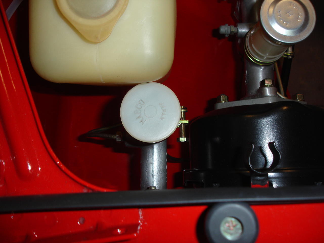

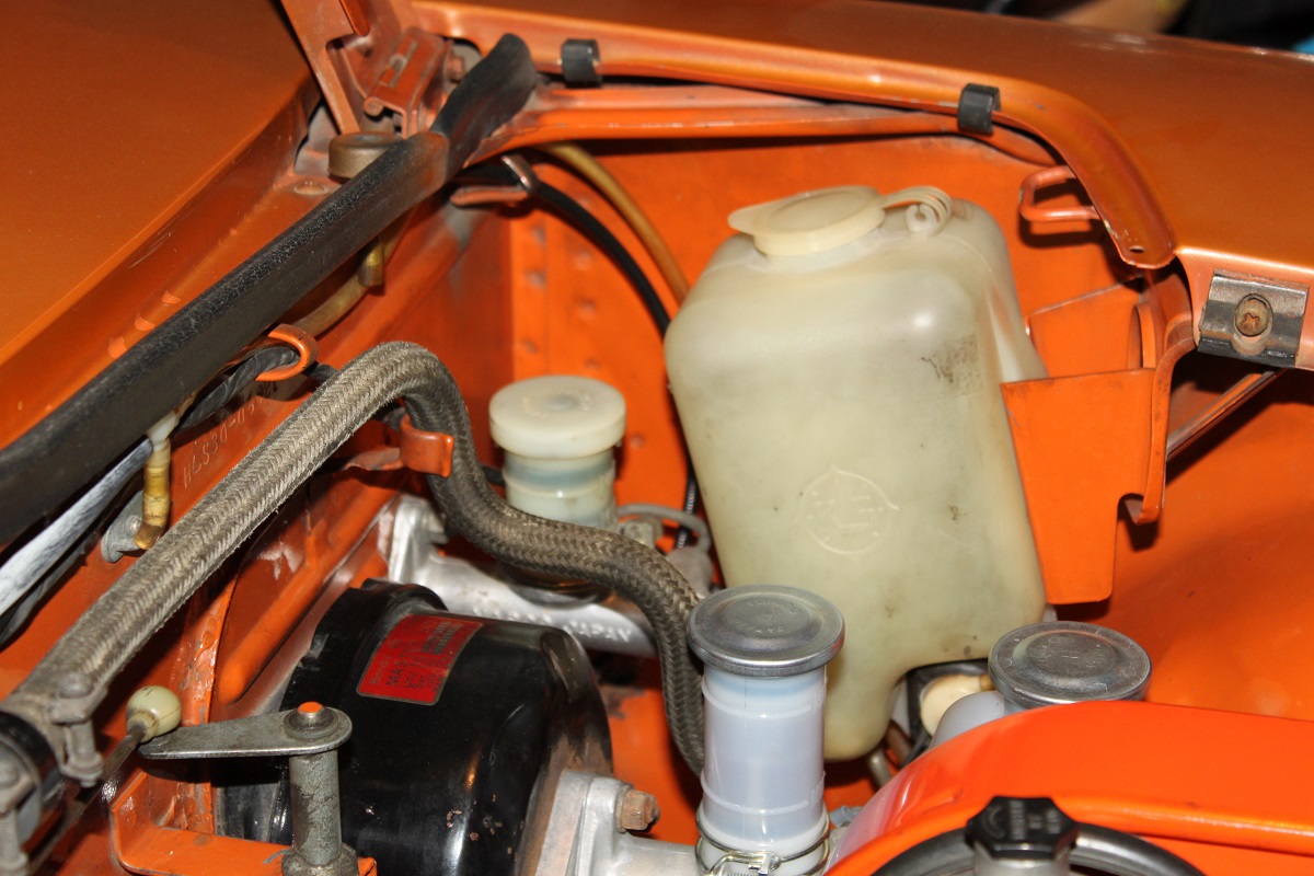

My CMC was replaced in 1983 with a center reservoir style, the dealer invoice shows P/N 30610-Y4401. I'm not sure why there is a "Y" in the part number? It's a Nabco and the overall length of the alum. body measures 4.5". Here's a pic showing the clearance with the WS washer reservoir. The clearance between the end of the CMC alum. body and the WS washer reservoir is almost 3/8".
HTH Mike
I did a little more digging in my old parts invoices and it looks like the CMC P/N 30610-Y4401 might be from one of my 510's. However I do have an invoice from 1979 where I had the local Datsun dealer replace my CMC with P/N 30610-N4001, IIRC that was the only time it was changed. Sorry for the confusion.
