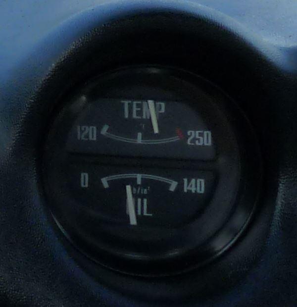

@kats Here is a Jan 1971 240z on first drive after a rebuild with stock sender and gauge. The oil pump is a turbo with the spring shimmed with washers to increase pressure.

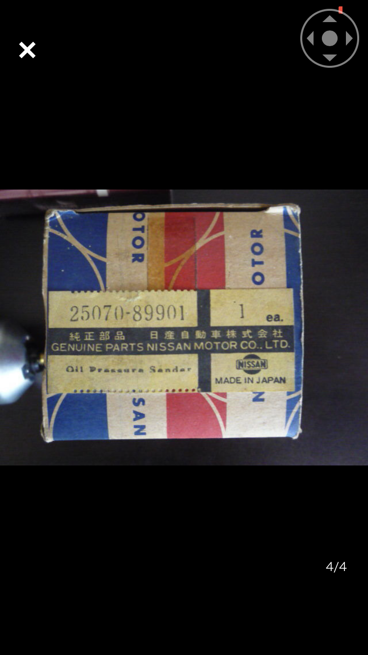

OK I'll try to find one. Ebay only has this substitute currently:
https://www.ebay.com/itm/MANUFACT-GEN-Engine-Oil-Pressure-Switch-25070-89972/272853013165?epid=140384145&hash=item3f874e92ad:g:VMkAAOSw4Z5aMHt6

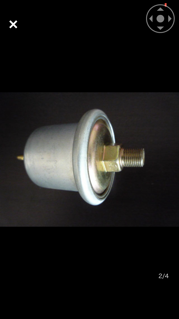

I forgot to put this , my 1972( 12/71 made ) Datsun 240Z . I think a 6kg switch cooperated with a 6kg / 90lb scale work pretty good, it makes me feel happy .
Kats
Hi Kats,
I am glad that my experience with a car originally purchased new on 3/25/71 helped confirm the reasons
a redesign of the oil pressure gage/sender combination was needed.  I had used the 90psi/6kg combination
with the good results that you describe, but I needed to use the 140psi/10kg combination to retain the originality
of my series 1 car.  During periodic maintenance, my mechanic, who has worked on these car since the mid
1970s, confirms my oil pressure with a direct reading gage knowing that this was a problem from the start.
It also, as you say, gives me peace of mind.
