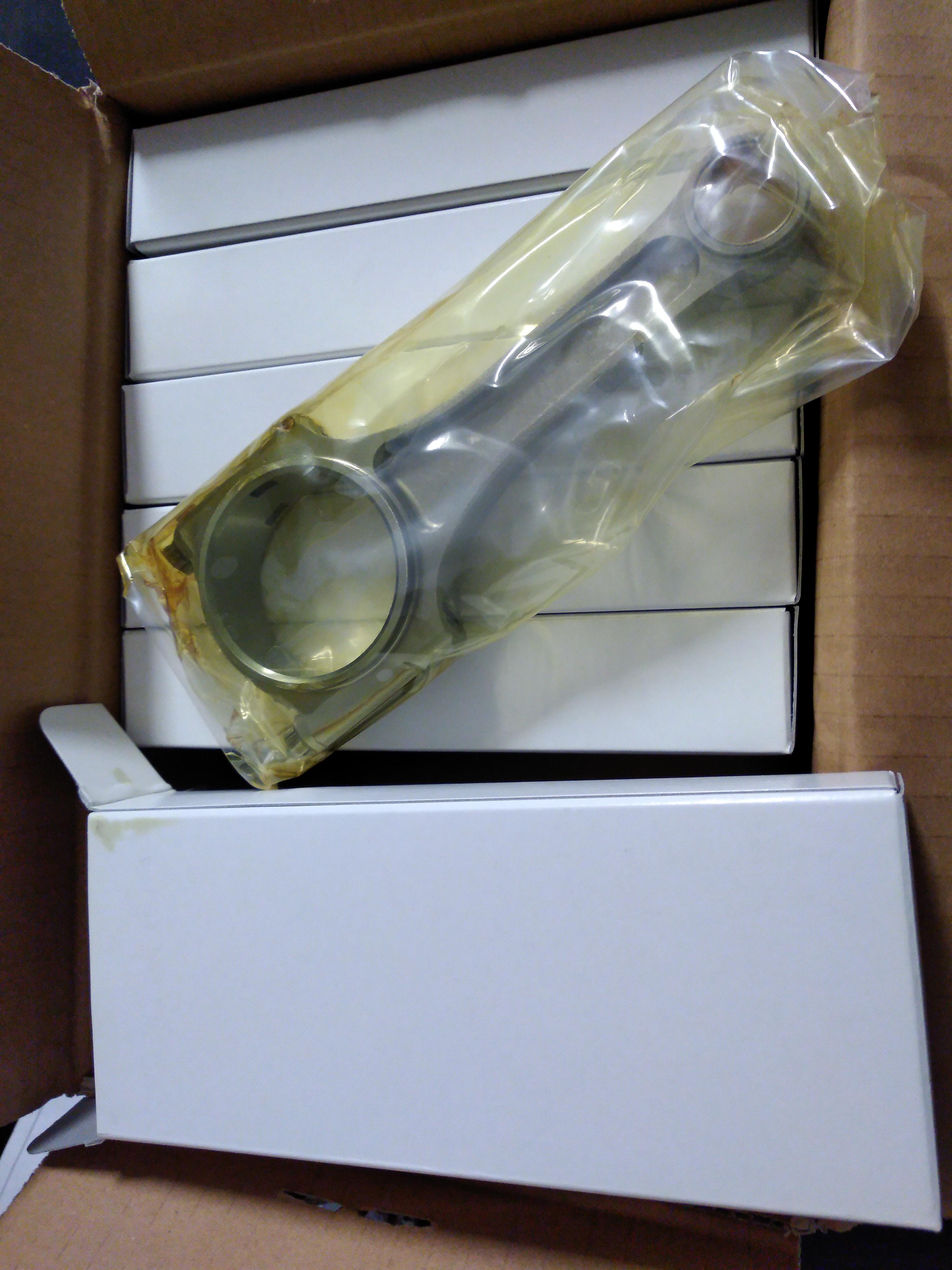

January 17, 20196 yr Author comment_566090 Will do, just waiting patiently (not really) for the new crank, rods and piston from Kameari. Unfortunately Christmas has delayed things. But will post pics as soon as they arrive. Link to comment https://www.classiczcars.com/forums/topic/49836-240k-race-car-gtr-tribute/?&page=6#findComment-566090 Share on other sites More sharing options...
April 15, 20196 yr Author comment_573348 Pistons here, crank arrives Wednesday, rods not far away, new pics shortly.? Link to comment https://www.classiczcars.com/forums/topic/49836-240k-race-car-gtr-tribute/?&page=6#findComment-573348 Share on other sites More sharing options...

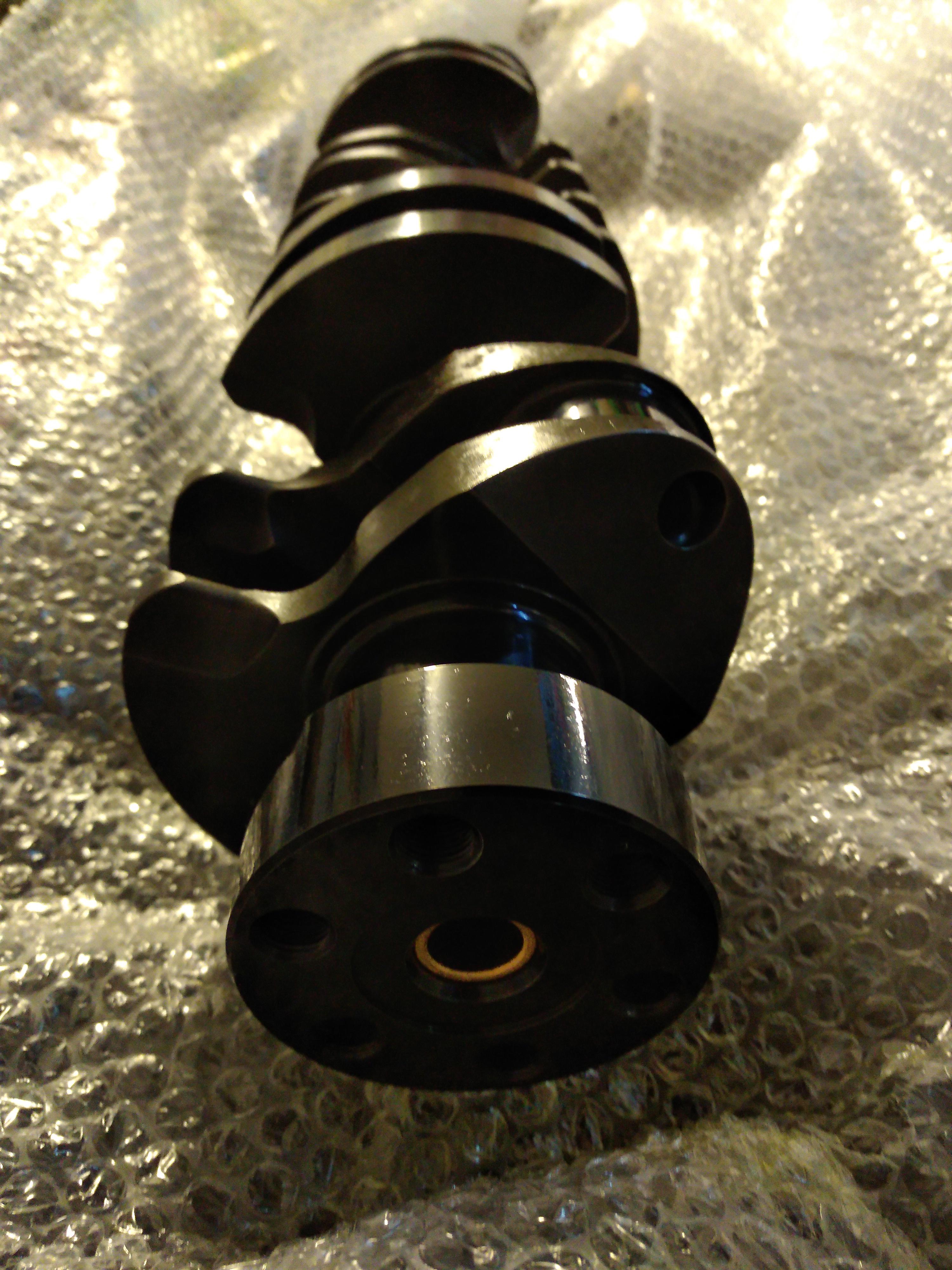

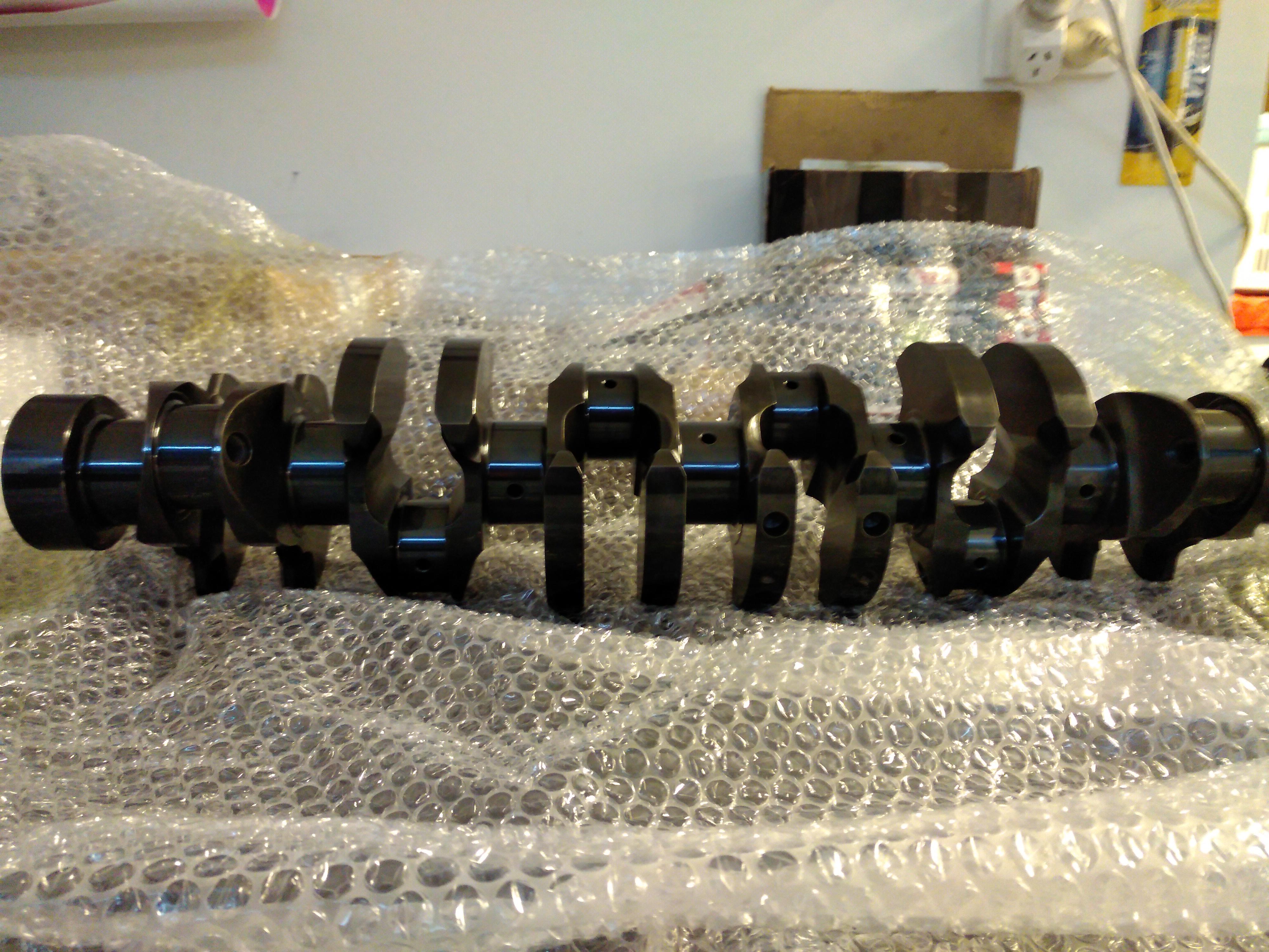

May 14, 20195 yr Author comment_575431 Just some pics, we have done some major head work which will discussed soon. Also upgrading the rear stub axles to 260z. More info soon. Link to comment https://www.classiczcars.com/forums/topic/49836-240k-race-car-gtr-tribute/?&page=6#findComment-575431 Share on other sites More sharing options...
May 14, 20195 yr comment_575458 Damn that crank is pretty, it's even aerodynamic on the edge of the balance weight to cut the air/oil. Don't even want to think of how much that set you back. Link to comment https://www.classiczcars.com/forums/topic/49836-240k-race-car-gtr-tribute/?&page=6#findComment-575458 Share on other sites More sharing options...

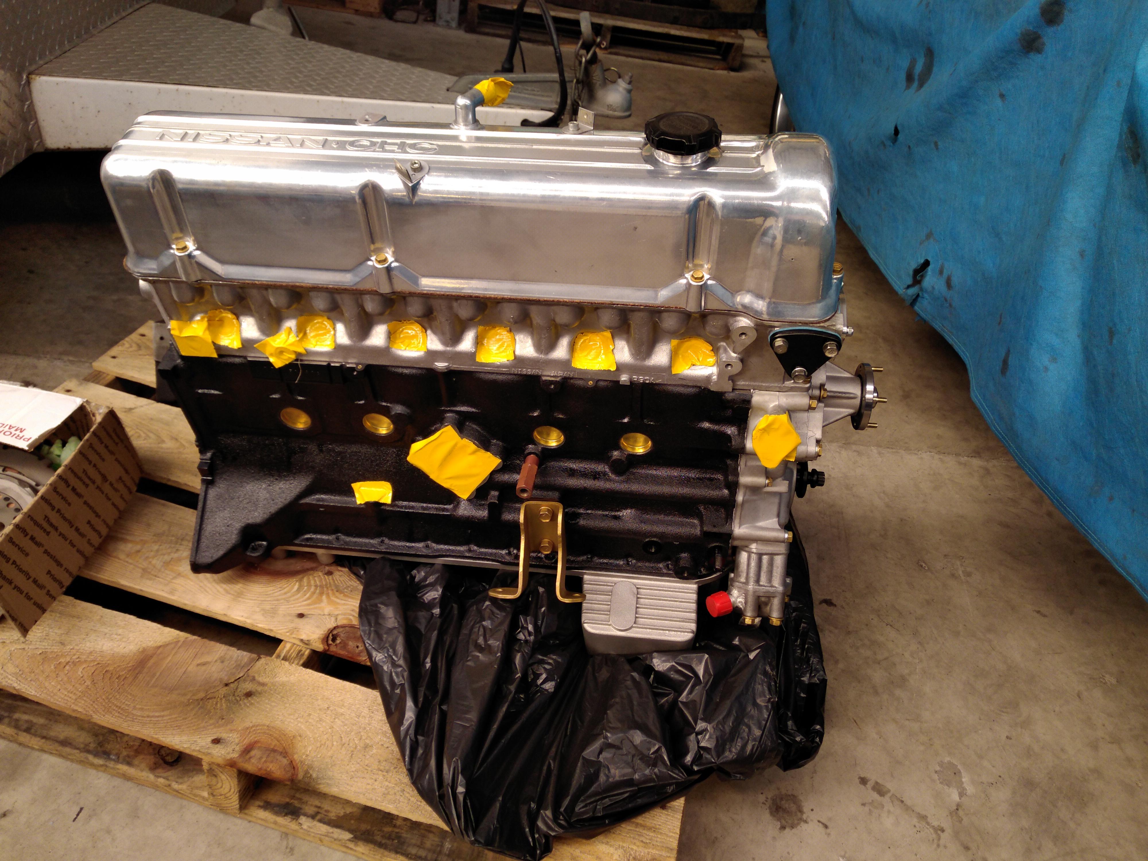

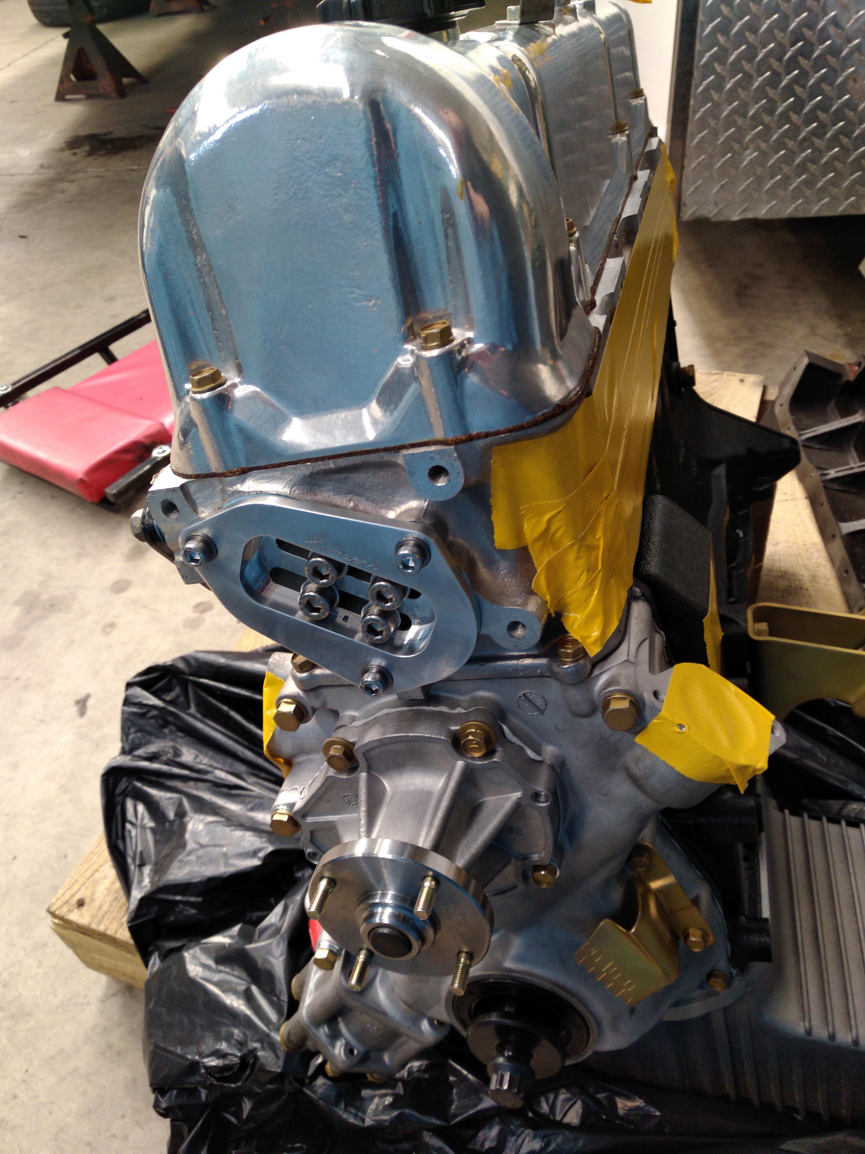

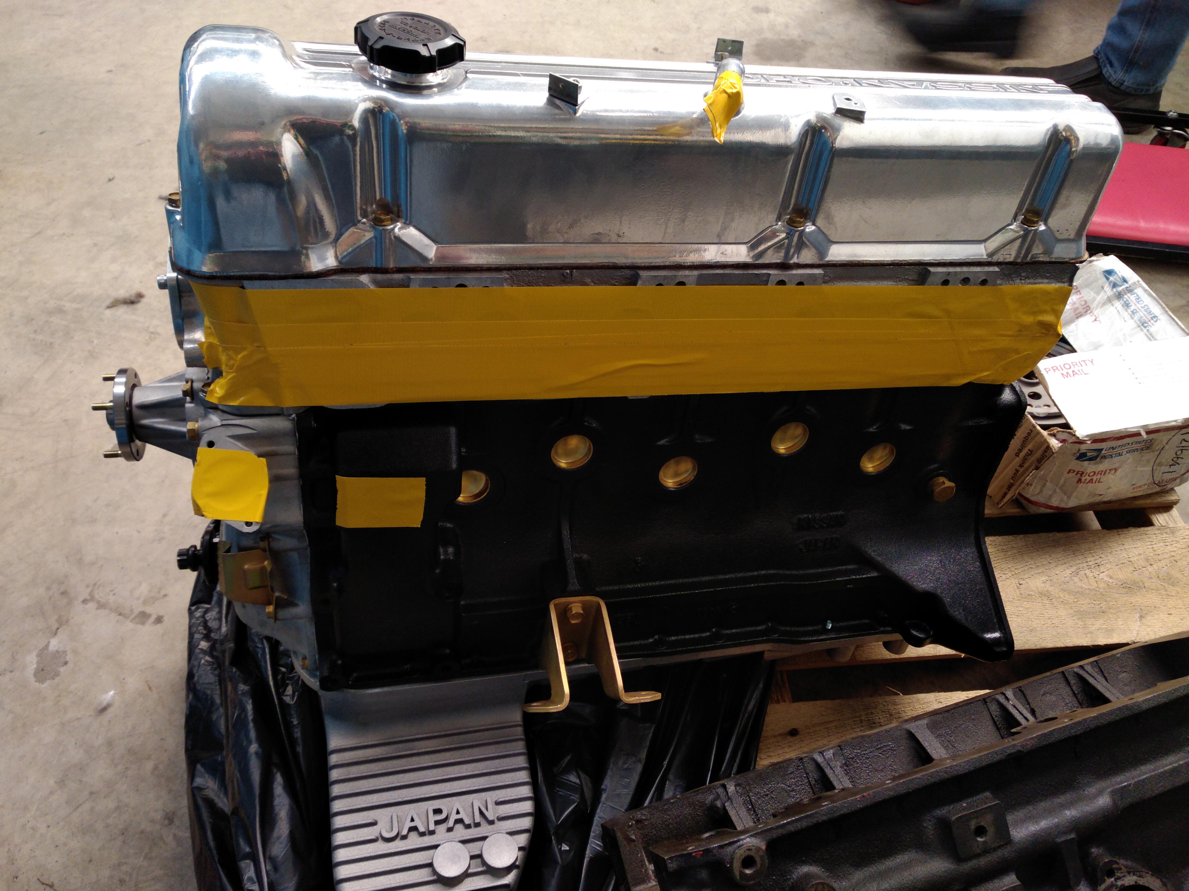

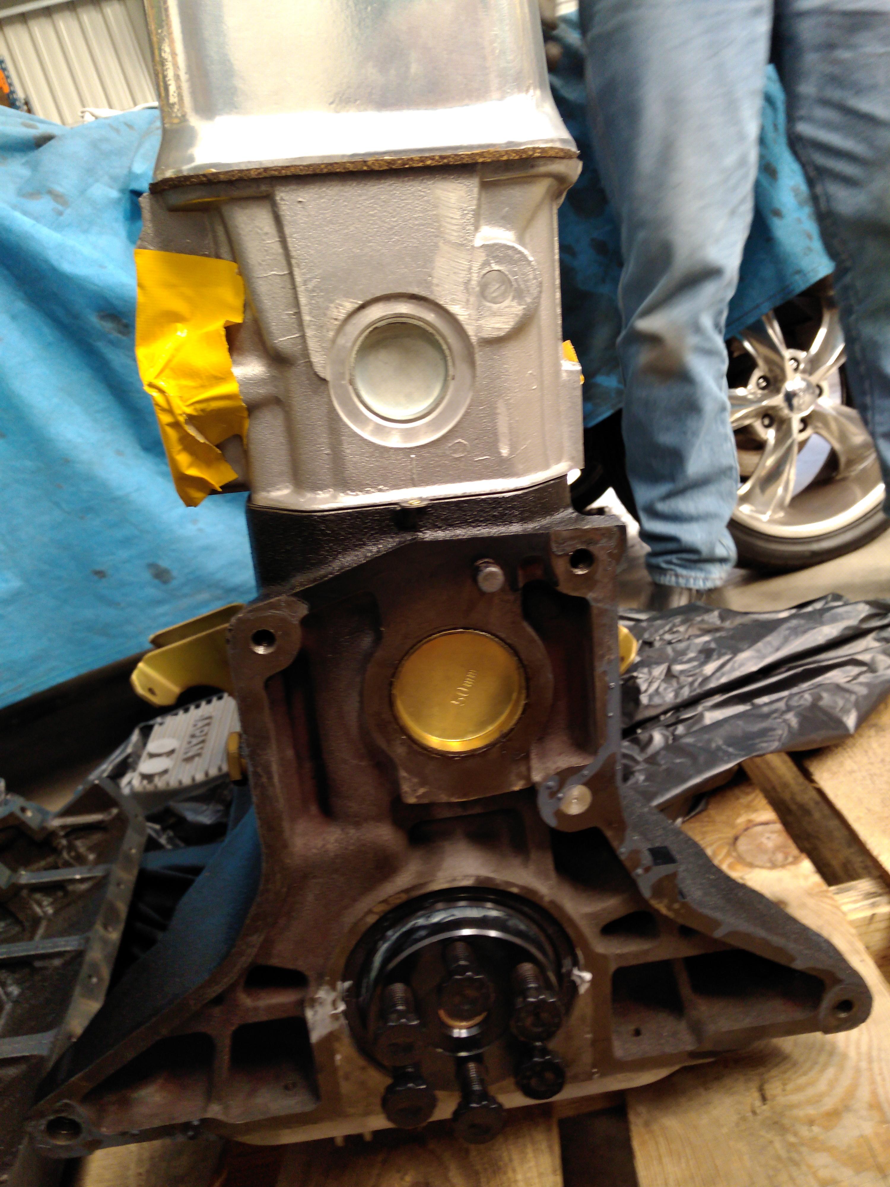

October 13, 20195 yr Author comment_585635 Well been a few delays and a few dramas. But finally the new engine is all together and back with my mechanic. We have to modify the sump, tweak the extractors/headers and make up new front pulley, but should be done this side of Christmas. Couple of pics to keep the interest going. Cheers Mike Link to comment https://www.classiczcars.com/forums/topic/49836-240k-race-car-gtr-tribute/?&page=6#findComment-585635 Share on other sites More sharing options...

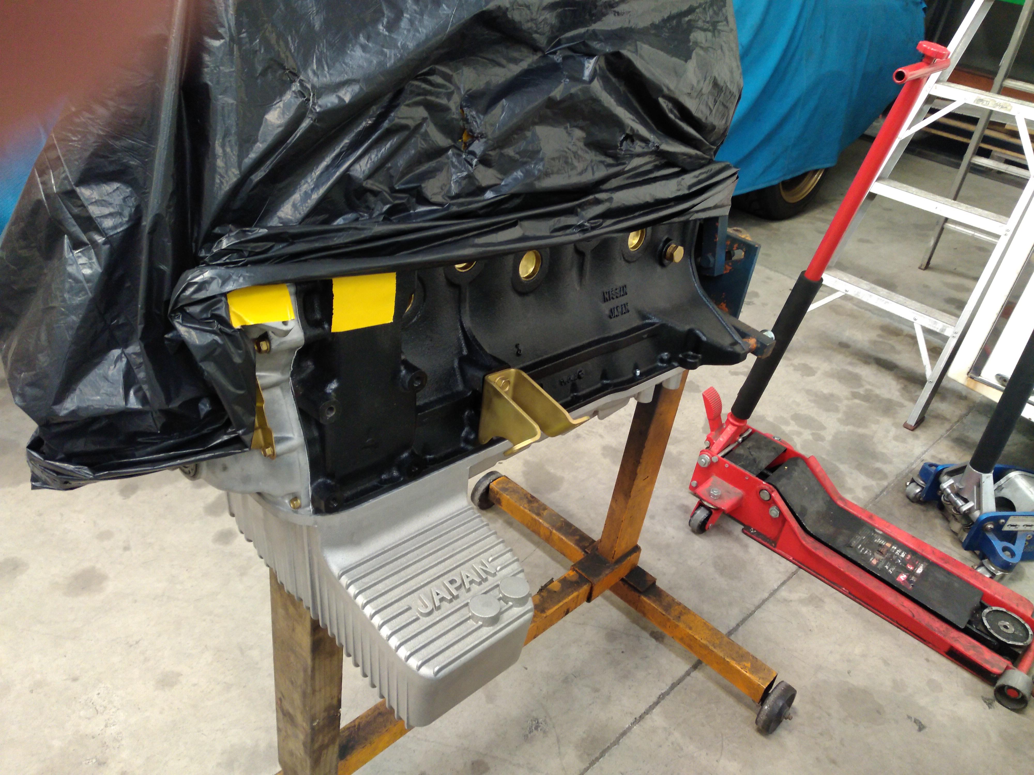

October 24, 20195 yr Author comment_586255 Progress is slow, but should be starting next week, at least progressed to engine stand ? Edited October 24, 20195 yr by mikec(nz) Stupid speelcheck Link to comment https://www.classiczcars.com/forums/topic/49836-240k-race-car-gtr-tribute/?&page=6#findComment-586255 Share on other sites More sharing options...
