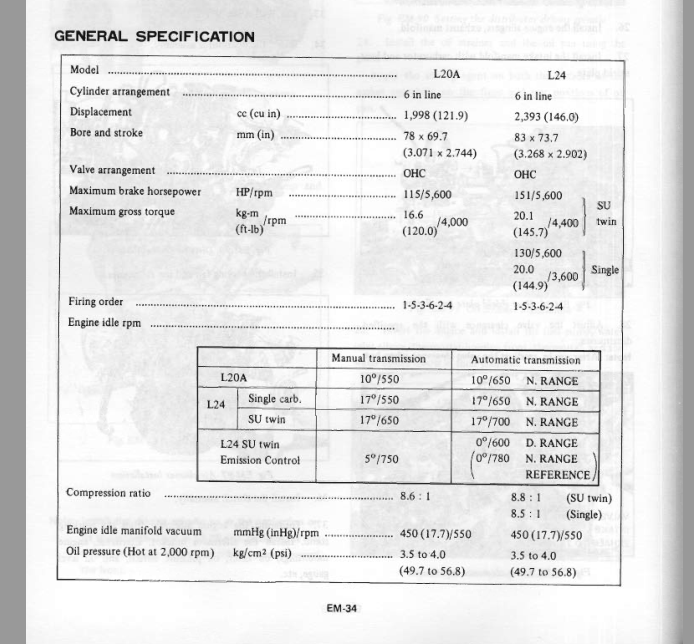

June 21, 201411 yr comment_450151 I think I saw some of the responses on your other thread. Some of the irritation might come from the fact that you're not including any of the helpful information from the other replies. You're ignoring what's been said and quoting Wikipedia. Maybe you could put some time in to compiling what you've learned so that people see their help being acknowledged. It seems like you'll keep asking the same question until you get an answer that you're looking for. "Describing differences" is very vague. What is the purpose of your question? Maybe someone can help you get their instead of citing differences. Tom Monroe's How To Rebuild Your Datsun Engine book says that the the L20A is a six cylinder engine that was not sold in the USA. There's a difference. The L20B is a 4 cylinder engine. The 1972 FSM shows an L20A as an option for the 240Z though, which seems odd if it wasn't sold in the USA. Maybe Canada got it. I included a picture of the L20A specs. I collected all of this in 5 minutes with my paper book and the internet. If you could do the same, people could fill in the gaps instead of starting from scratch every time you ask. What do you know and what are your sources. Just trying to help you out. Compile what you know and show it. Link to comment https://www.classiczcars.com/forums/topic/49478-engine-differences-about-series-1-s30-zs/#findComment-450151 Share on other sites More sharing options...

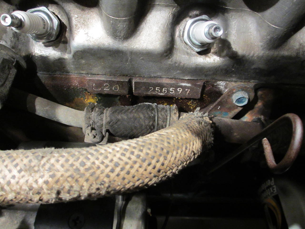

June 21, 201411 yr Author comment_450160 Wait .. hold the phone ... How can the 6-cylinder be designated L20 if the "A" was added to denote the 6-cylinder from the 4-cylinder L20? Man, I'm confused! Geeze, what am I not catching on to here?? Here is a for-real L20 6-cylinder dual Hitachi carburetored engine in the 1971 FairladyZ-L. Here's the stamp on the block. There isn't an "A" anywhere. Don't know what else to say, except "weird". Here's another good source - http://www.nicoclub.com/FSM/Engine-Specific/L20A,%20L24%20&%20L26%20Engines/L20A,%20L24%20&%20L26%20Engines%20EG.PDFI haven't seen any reference to an L20 engine anywhere yet. Only L20A and L20B. Your Wikipedia reference indicates that L20 and L20A are the same engine. So why would there be a difference? Seems like your real question is "where was the L20A engine used?" Again, just trying to help out. The answer to your question seems to be that there are no differences. They are the same engine. The A was added to show that it's the 6 cylinder 2 liter engine versus the 4 cylinder 2 liter enigne. Edited June 21, 201411 yr by Kerrigan more data Link to comment https://www.classiczcars.com/forums/topic/49478-engine-differences-about-series-1-s30-zs/#findComment-450160 Share on other sites More sharing options...

June 21, 201411 yr comment_450163 Wait .. hold the phone ...How can the 6-cylinder be designated L20 if the "A" was added to denote the 6-cylinder from the 4-cylinder L20?Man, I'm confused! Geeze, what am I not catching on to here??Here is a for-real L20 6-cylinder dual Hitachi carburetored engine in the 1971 FairladyZ-L.Here's the stamp on the block. There isn't an "A" anywhere.Don't know what else to say, except "weird".I didn't read through all of your other posts but I do see that you might having some "cognitive bias" going on. You're interpreting things to fit what you "know" instead of changing what you know to fit the reality. There's nothing written anywhere that I see about an "A" stamp. Why would you need an A or a B stamped on the engine, all you have to do is count cylinders. So looking for an A stamp seems pointless. The A and B seem to be for documentation and manual purposes.The number on the engine would match the number on the body plate, in the USA market. I don't know if they did that in Japan. Is that where the "mis-matched number" thing comes from? It could just be a replacement motor.From your post farther above it seems like you just have a plain old JDM Fairlady Z with an L20 six cylinder. What's the big deal? The FSM shows it as a stock engine for the car. What are you really looking for?Edit - seriously, I'm just wondering what the fuss is about. Edited June 21, 201411 yr by Zed Head Link to comment https://www.classiczcars.com/forums/topic/49478-engine-differences-about-series-1-s30-zs/#findComment-450163 Share on other sites More sharing options...
