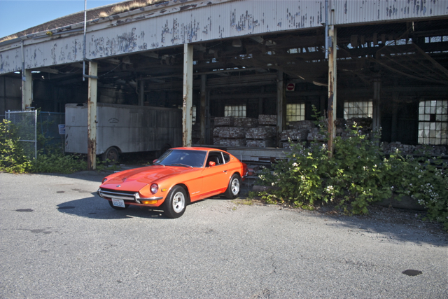

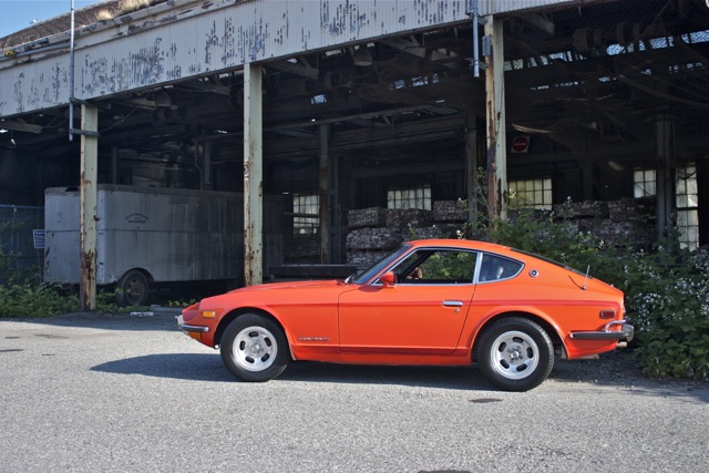

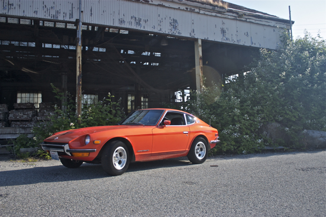

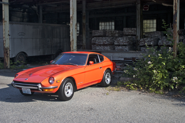

Well, today was the day I finally got to drive my Z. I was able to get a day permit to drive the vehicle to an inspection facility. I have imported the vehicle from the US (Yes, i'm Canadian Eh). I got them to take a look over the vehicle and give me a heads up on what I need to do to get the vehicle in a passing condition. It was nice to see the car up on the hoist. Overall they were really impressed with how clean the car was underneath which was great to hear. Obviously I took advantage of the day, and stopped for an impromptu photo shoot. I thought a theme of "coming out of the barn" was a good idea. Hope you enjoy the pictures.

For the experienced eye, does this vehicle look like it's the stock height? I find the ride quite stiff, a little more jarring then my BMW 325i with Bilstein adjustable coil over suspension in my daily driver. Since I've found upgraded sway bars, I can only assume some of the other bits and pieces have been tinkered with in the past.

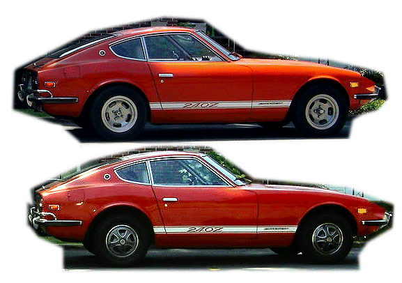

Your's looks good to me. Here's some pictures of mine with 14s and then 16s. Blue did the comparison photo shop shot for me. The 16s raised it up pretty good so I took them off and went back to 14s with hub caps. The aluminium slots need polishing.
I should add, my main reason for taking the 16s off is my struts a worn out and it rides too high.

Silly question, but I assume yours is stock height? I'd say ours look pretty similar.
